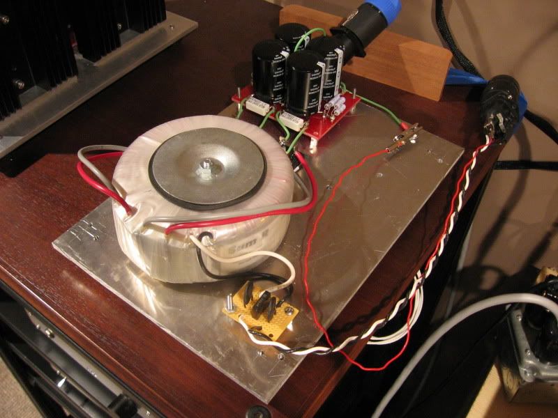

Nice! There is one thing to be concerned, though. One row of capacitors is really close to the heatsink, and if it gets warm, capacitors get warm as well, and they don't like the heat. On the other hand, heatsinks look large enough, so maybe they won't get so hot after all. :)
Simon. I have the same concerns. However space is at a premium, so I will have to see how it goes. I have very efficient speakers 97dB so it may not get too hot.
Rob.
It has more to do with biasing and Vds than the efficiency of your speakers.
This is a class A amp.
You still might be ok though, they are quite big heatsinks, and I am guessing the dissipation through each device is no more than 60W.
If it is too hot it wouldn't cost too much to buy some wider aluminium plate to make tha case wider. You can still use the narrower plate later on when you decide to buy another couple of heatsinks and build mono blocks.

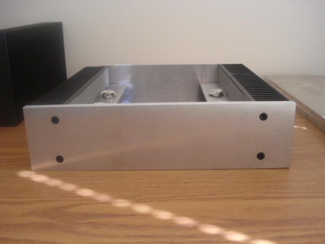

Skeleton of 1st monoblock bolted together. Only another 6 cases to go.
