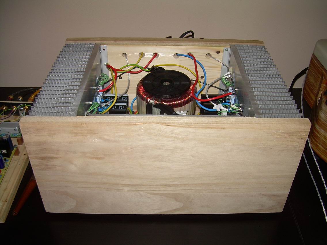

My F4, after two years still missing a back panel... :ashamed:

Hi culture,
Nice metalwork.
2 questions;
How big are your heatsinks.....(they look to be same as the ones i got for my F3 ( 295mm x 150mm x 80mm)) ?
How hot do they get on prolongued listening ?
...just checking if mine will take the F3's heat :cool:

Hi CeeVee
Thanks for the compliment, it a true kitchen table effort, drilling and all :)
The heatsinks are 16x23x7,5 cm. I don't know the actual temperatures. I can touch them for more than five seconds, hot but no problem and i have to confess the amp is not in the most well ventilated place.

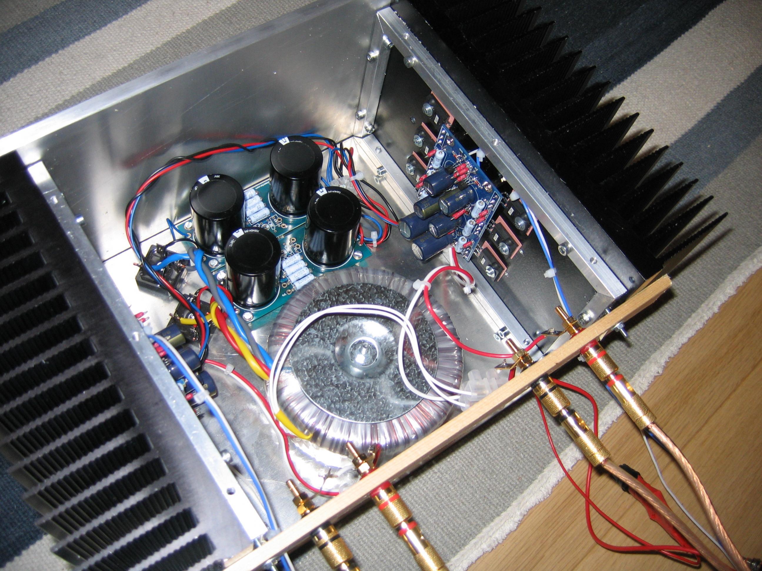

Andy, your amp in picture looks real nice
yet, a small note about transistor mount
transistors should ideally be mounted around middle of heatsink, or even better right below, vertically
to me it appears like you have them very close to top of heatsink
You may well be right. This was my first attempt at a Class A design. I solved the problem by reducing the quiescent current slightly and replacing the silpads with mica washers.
NEVER again will I use SILPADS, they are ABSOLUTELY USELESS at high power.

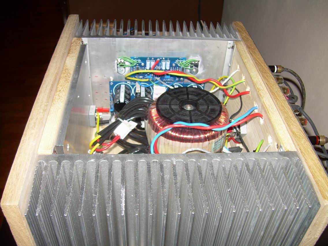

My diy F5
this is my f5 finished at the end of June.
Built around cviller ampli and supply board in a dual mono config.
Sounds very smooth with a special bottom end energy in my system.
Dc at output is always under 2,5 mV with a bias around 0,6 volt.
Thanks to Mr. Pass, Cviller and to all f5 builders :)
