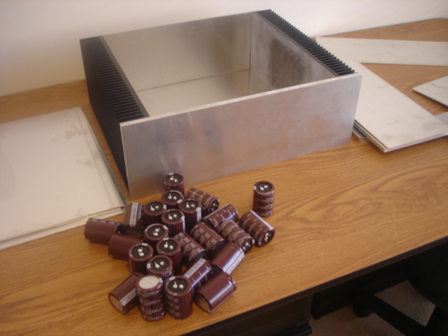

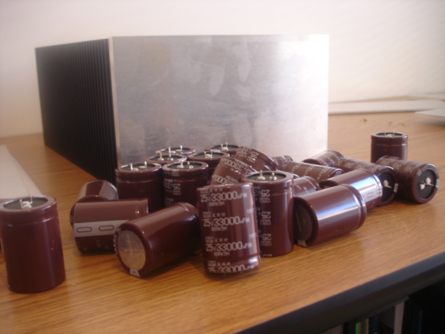

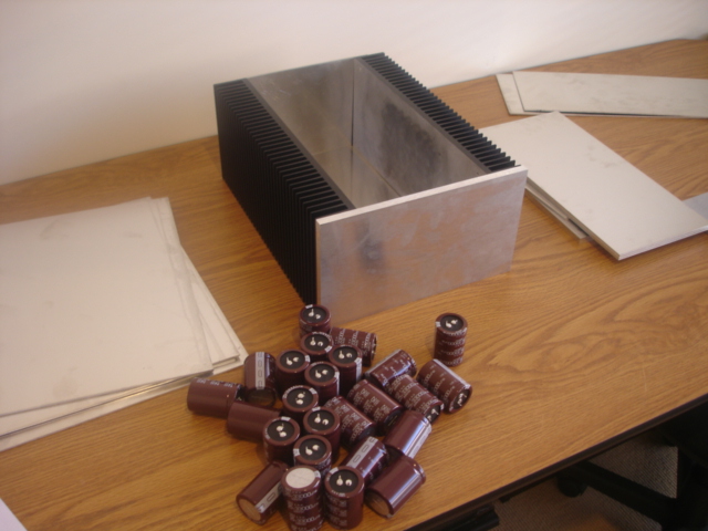

Case building
Ok I thought I would post some pictures of my case building efforts. I have cut up enough aluminium so that I can quickly switch between either two wide cases or two narrow cases (ie two stereo cases or two monoblock cases)

I'm surprised at your choice of capacitors for a Class A amplifier.
I'm using 12 x Dubilier Computer Grade 33000uF / 75V caps which actually test at nearly 90000uF each. This gives me approximately 300000uF per supply rail and nearly 150A of ripple current. I bought them on E-Bay from the US and paid about £6.00 each for them.
Personally I would just check the maximum ripple current. Computer Grade Caps are generally HIGH ripple.
There is a very good argument for using LOTS of smaller caps. I've seen a Gain Clone project with over 100 x Black Gates.
I'm using B&W speakers which do require a high current drive, therefore my PSU is designed to give just that. In the Aleph 4 I can happily peak over 150A if the situation desires it.
I do not remember the specs of the Aleph 4 but I am almost certain the Aleph current source would be lucky to deliver 20A/channel (in the Aleph 4) let alone 150A.
If you had a push pull output stage then that is a different matter (eg BA2). From memory the Aleph current source is limited to around twice the bias current. Eg If the bias current is 4A then the maximum output the Aleph current source will deliver is around 8A (could be a bit higher).
Obviously you could tweak the Aleph current source to put out a higher dynamic current, if that is what you wanted to do.
Just cheked the data sheet. The ripple current is 5.39A per cap.
I am not sure how many I will use at this point in time. It will come down to listening tests.
I have 24, so I could use up to 6 per rail per channel (if I decide to go monoblock).
In the end the ear will decide.
