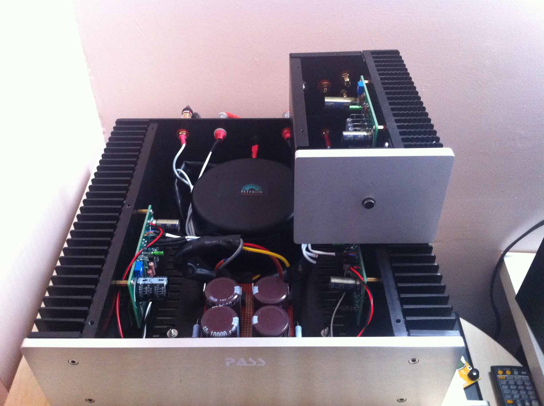

The covered transformer looks cool and solid.
Flyingsolo,
Very nice build indeed.
Quick question: Is that a cover on a standard series transformer or is it something
special? It looks super cool.
Thanks,
Dennis
Thanks Dennis. It's a Plitron, and below is the photo I took in my car imediatelly after picking up the transformer from Plitron factory, that's the transformer and that's all inside the cartoon. It comes with no screws and whatsoever, the cover was bought elsewhere. I got a couple of those covers for other DIY projects, and finally got a chance to use it...
The ACA chassis I use is kind of small(still a lot bigger than the diyaudio kit chassis), need the transformer cover to "organize/hide" the wires...so it looks neat and tidy.
The "Plitorn" label was a colour laser printout on Avery sticker, don't want keep the Plitron anonymous..

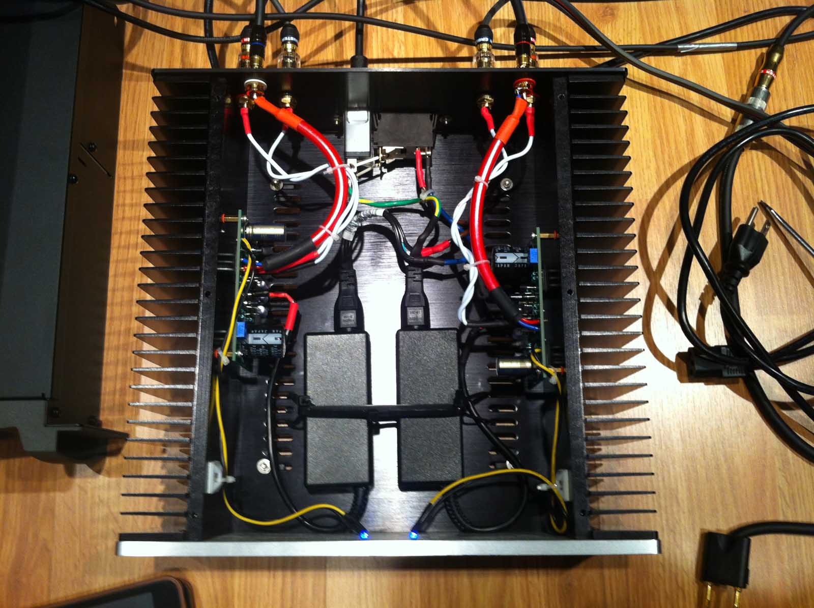

Flyingsolo, very nice construction! I thought about the dual laptop supply inside the chassis as well ...
Thanks Eric. It looks neat putting PS inside as wires are driving me crazy, careful though, putting laptop supply inside means more heat inside the chassis, and the heat dissipation condition is not as good as putting them outside, and heat is bad for the power supply.
I now use transformer power supply...

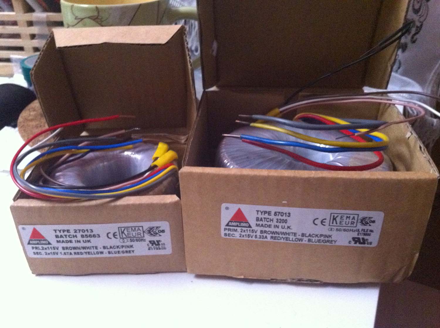

now I know Plitron and Amplimo share a designer
Hi Flyingsolo,
I'm wondering where you got the Amplimo transformers? Are they available
locally (GTA)?
Thanks,
Dennis
No, I bought Amplimo from their website, shipped from Nederland(Netherland). See below picture of the package..."PostNL"

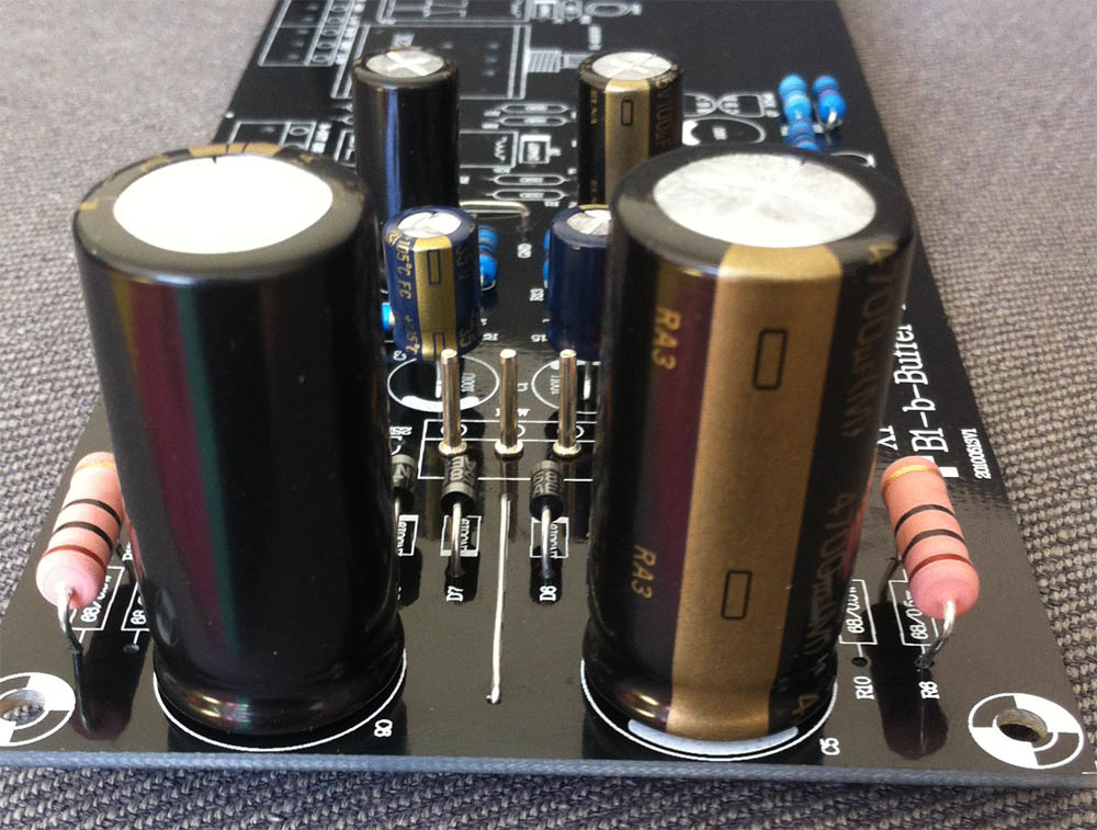

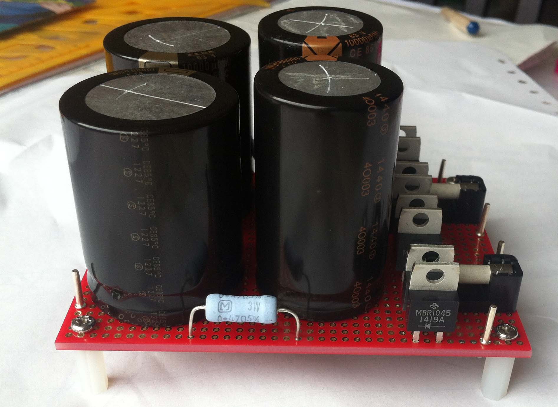

I use 15V x 2 transformer, after CRC the voltage is around 20V --- 15v*(125/115)* 1.25 = 20.38V(yep, Canada voltage is 125V, and transformer spec says primary is 115V), current is around 1A per rail without 2.2K patch, and around 1.6A with 2.2K patch.
CRC I use 10,000uf + 0.47R + 10,000uf per rail, and measured DC current through the 0.47R.
Another thing I love the transformer + CRC more is that if you use laptop PS, when turn on the amp, you will hear something like mosquito buzzing then disappear.(the 1000uf cap is buffering)..using the transformer PS will not hear anything when you turn on and off...
The stereo chassis is not hifi2000, it's strong enough, all aluminum 3mm panels, and I used big aluminum feet...solid
