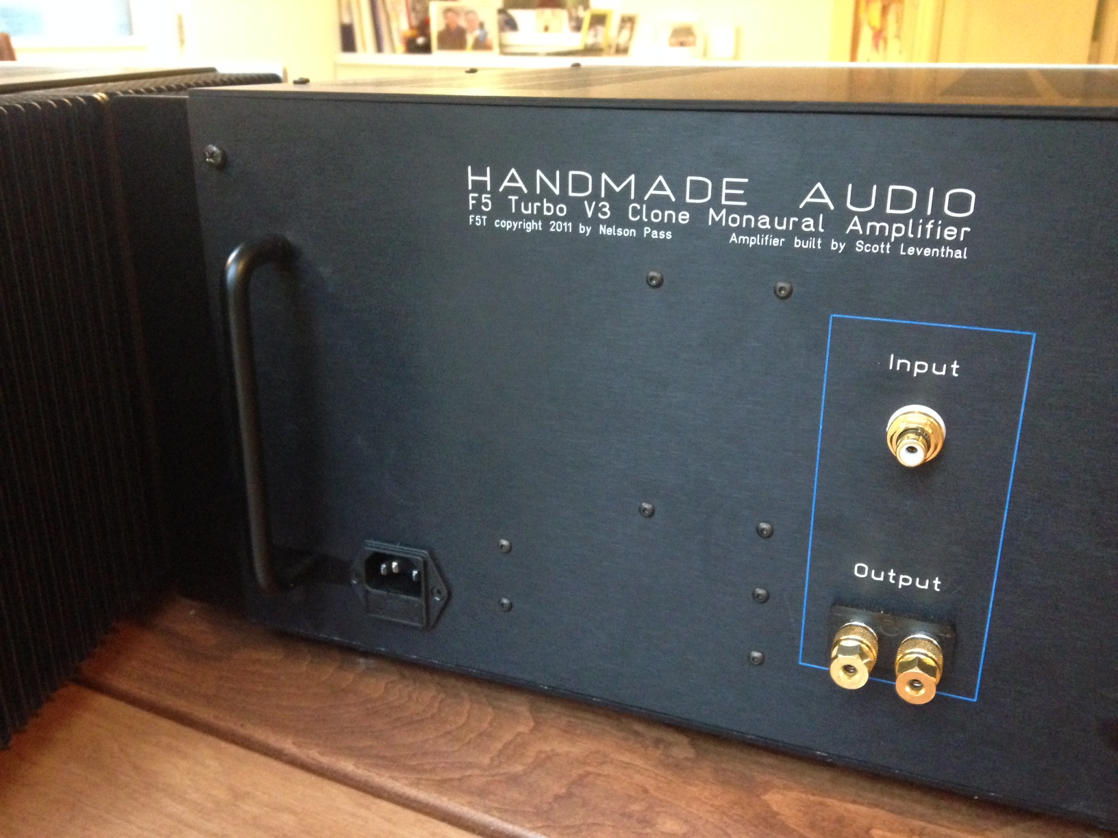

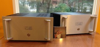

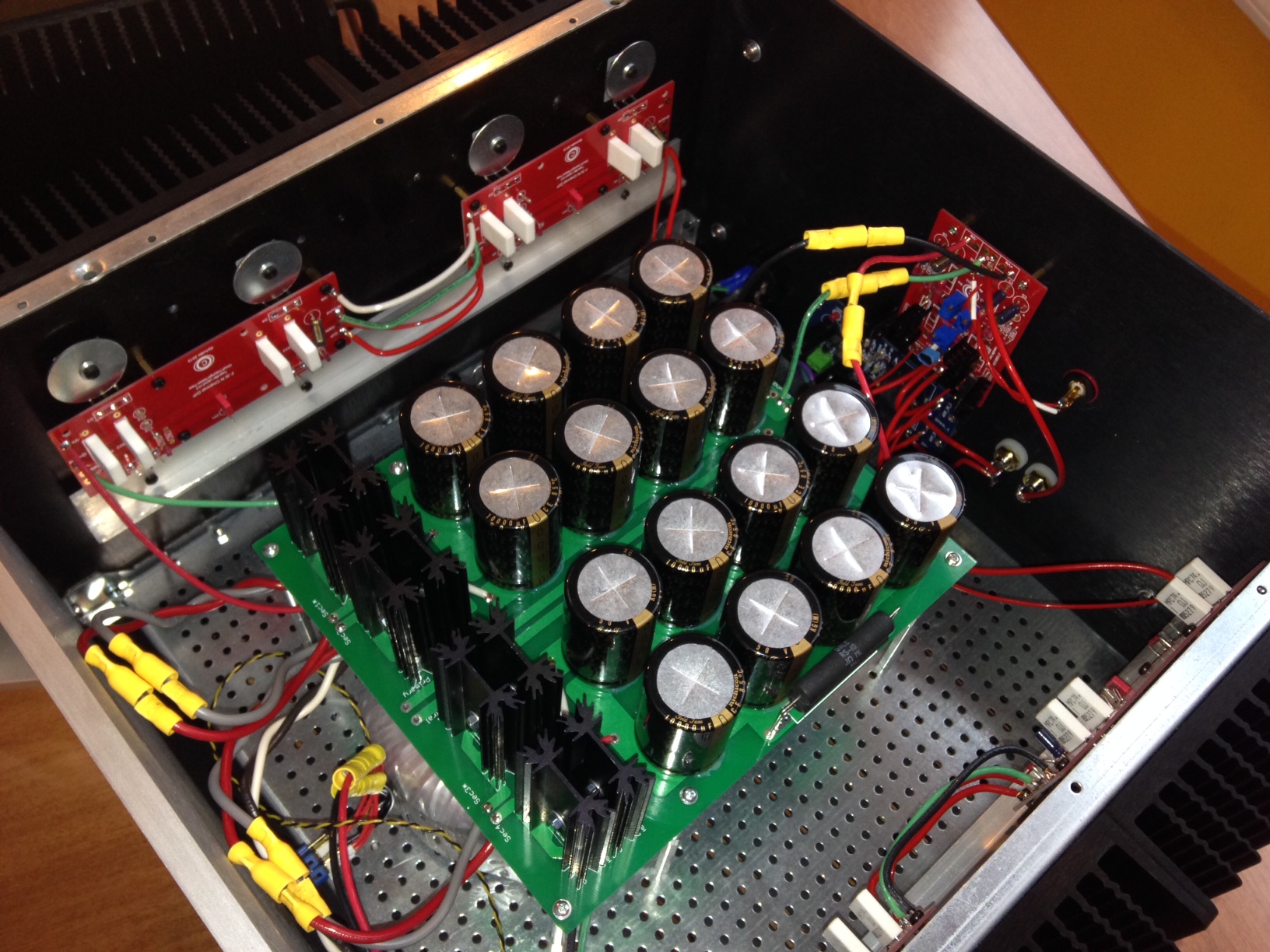

Folks:

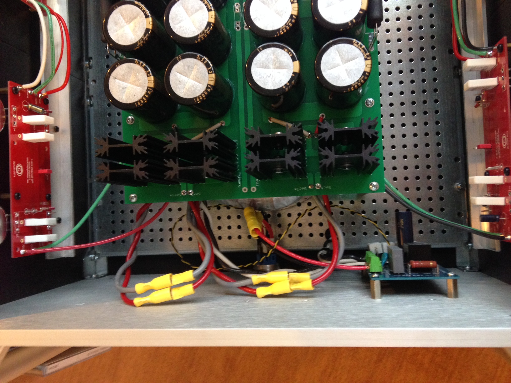

F5T V3 monoblocks, which were completed this morning. diyAudio store 5U enclosures, soft start, speaker protection and F5T boards (v2.2), 1kw SumR toroids (32 V secondaries), Nichicon KG caps, etc. Four pairs of MOSFETs per amp. The amps are biased at around .7 amps per MOSFET and I can comfortably hold my hand against the heatsinks for 10 seconds, so in time I may grow more fearless. Kudos and tremendous appreciation to Nelson Pass and much, much gratitude to Buzzforb, without whose help I'd be completely lost in the weeds. Thanks as well to UKToecutter, Zen Mod, Sir Byrd and petefrontiers, who all helped me debug an issue with the first monoblock.
These puppies sound really, really good right off the bench -- what'll they sound like when they've had a chance to settle down? One minor concern is some noise from one of the toroids; I trust it'll calm down over time.

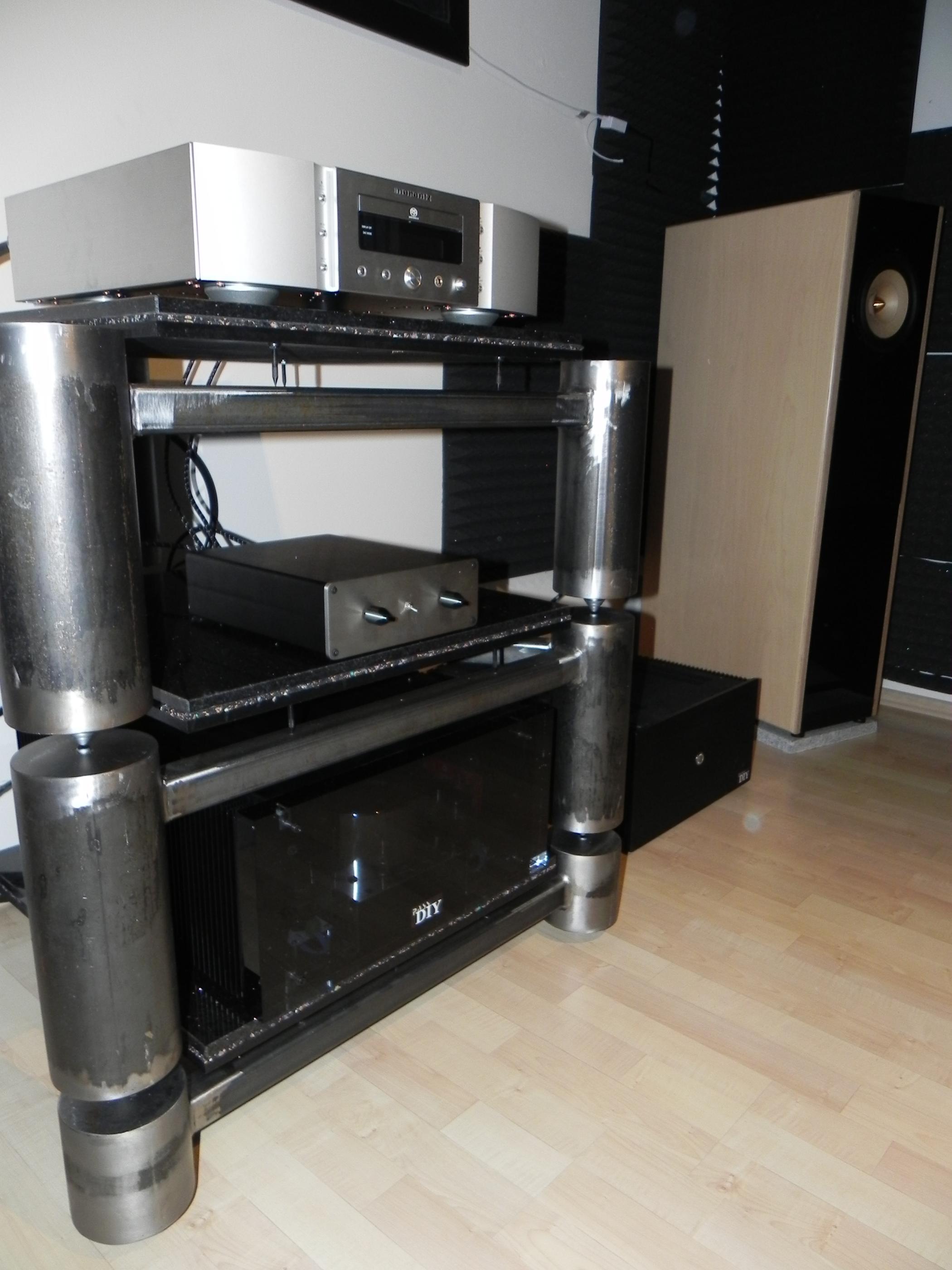

The last photo is of my basement listening room. Those with really, really good eyes will spot a photo of me sitting next to Nelson at a dinner a couple of years back -- a cherished moment. Between the F5T monoblocks and my Egglestonworks Andras sit a pair of Pass Labs Aleph 1.2 amps. I've loved those amps for the past 13 years or so and until Nelson released his F5T article, I thought they'd be mine forever. So double the kudos to Mr. Pass!

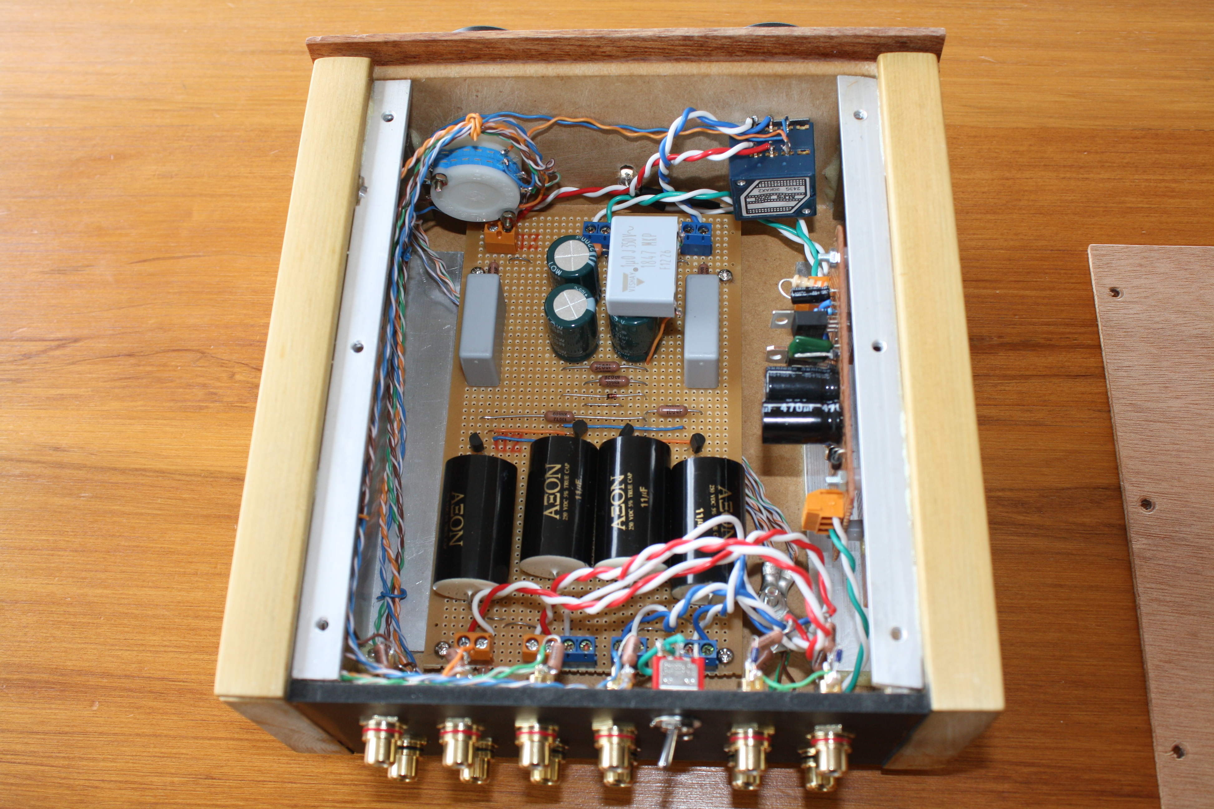

The capacitance multiplier removes all the ripple ( at least what I see on my scope ) even under load.
Clarkstuff: Nice heat sinks!
Removes ALL the ripple?! Can you put a mV number on the PS rail ripple?
If your toroid continues to hum, contact Richard at Primrose. He will replace it. Amps look great and they appear to be driving some serious speakers.

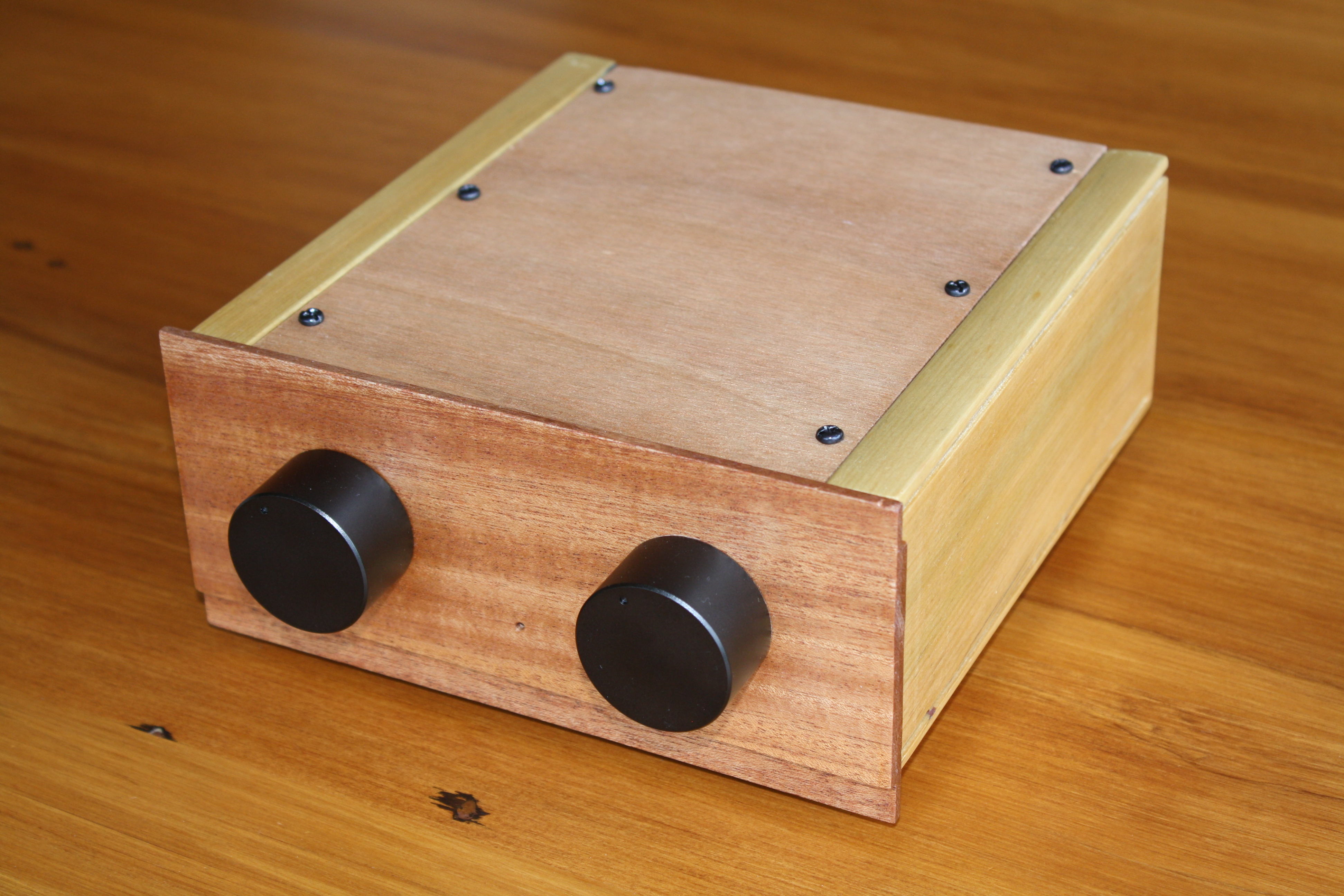

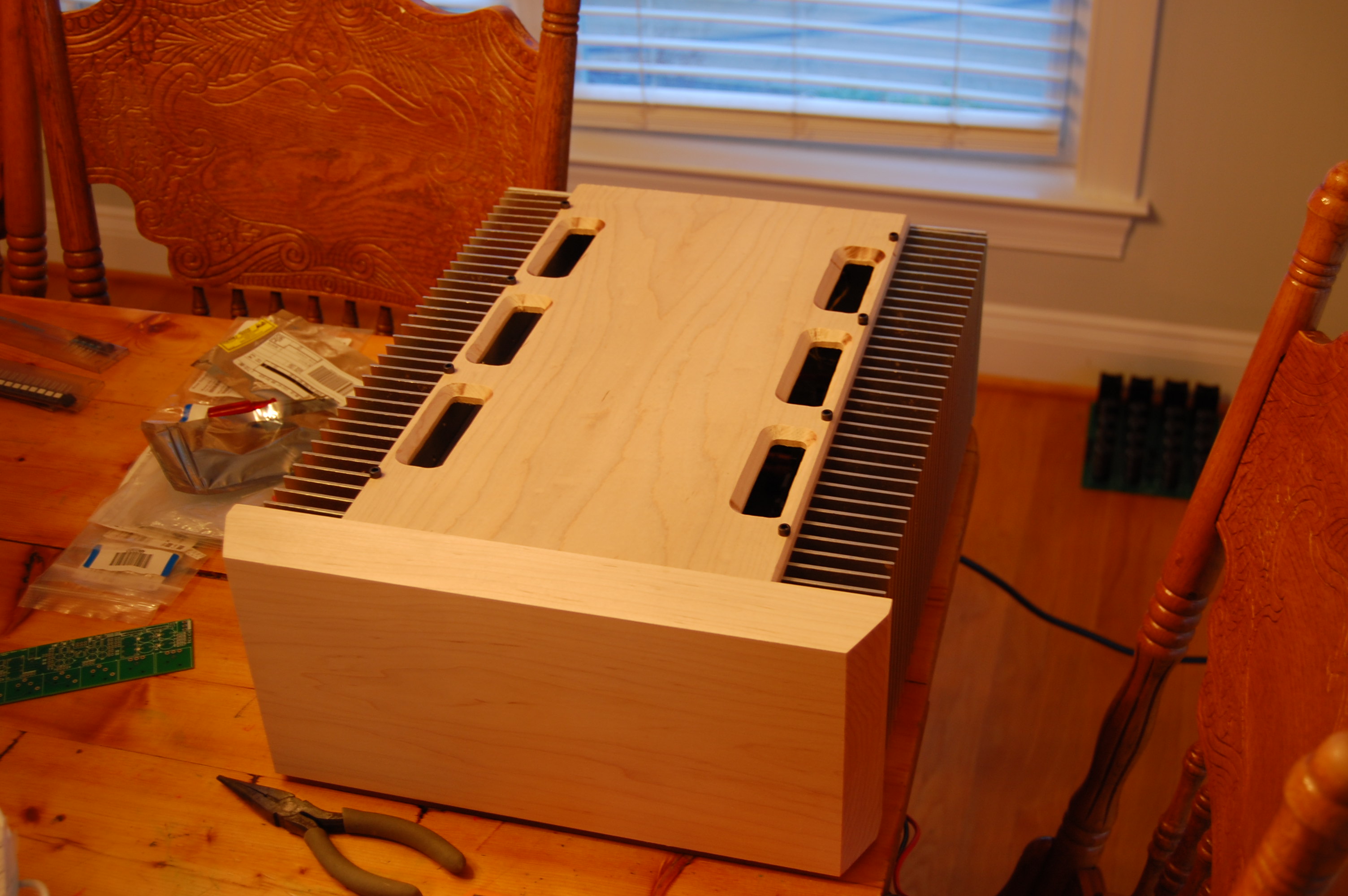

Buzz,
Very nice wood work !! Look like you finished the front panel piece (looked real smooth and shiny).

Wow ! Thanks for sharing, I will be using this in my next to build preamp for volume control
Where did you buy these excellent looking knobs ?

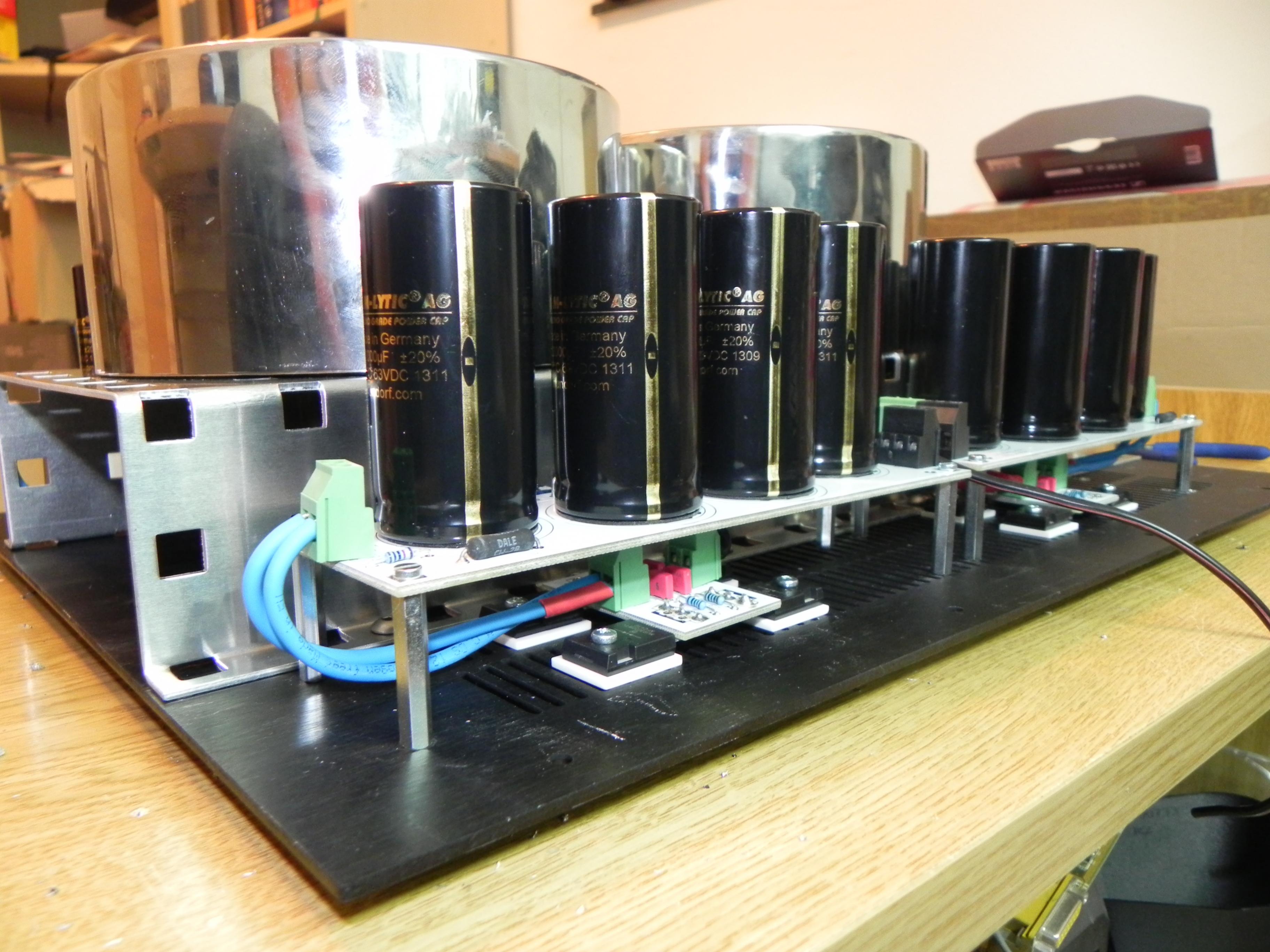

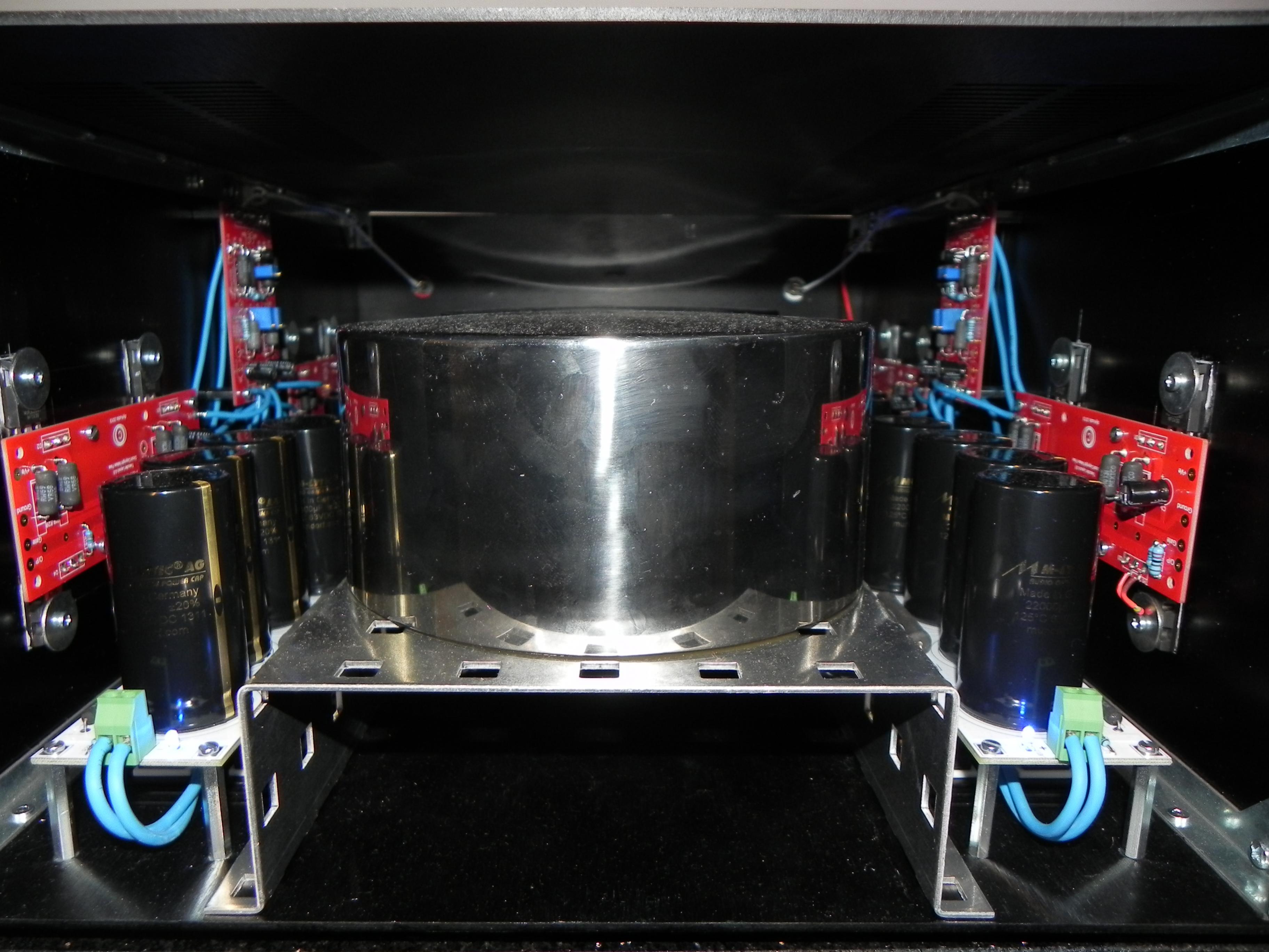

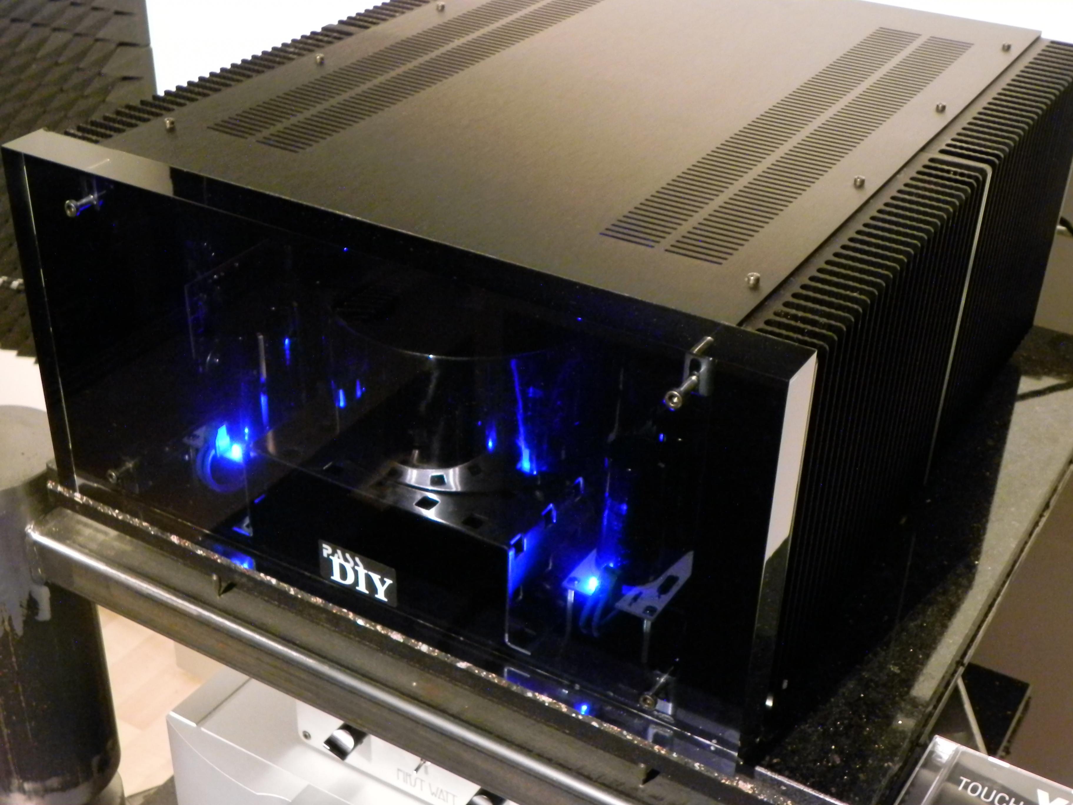

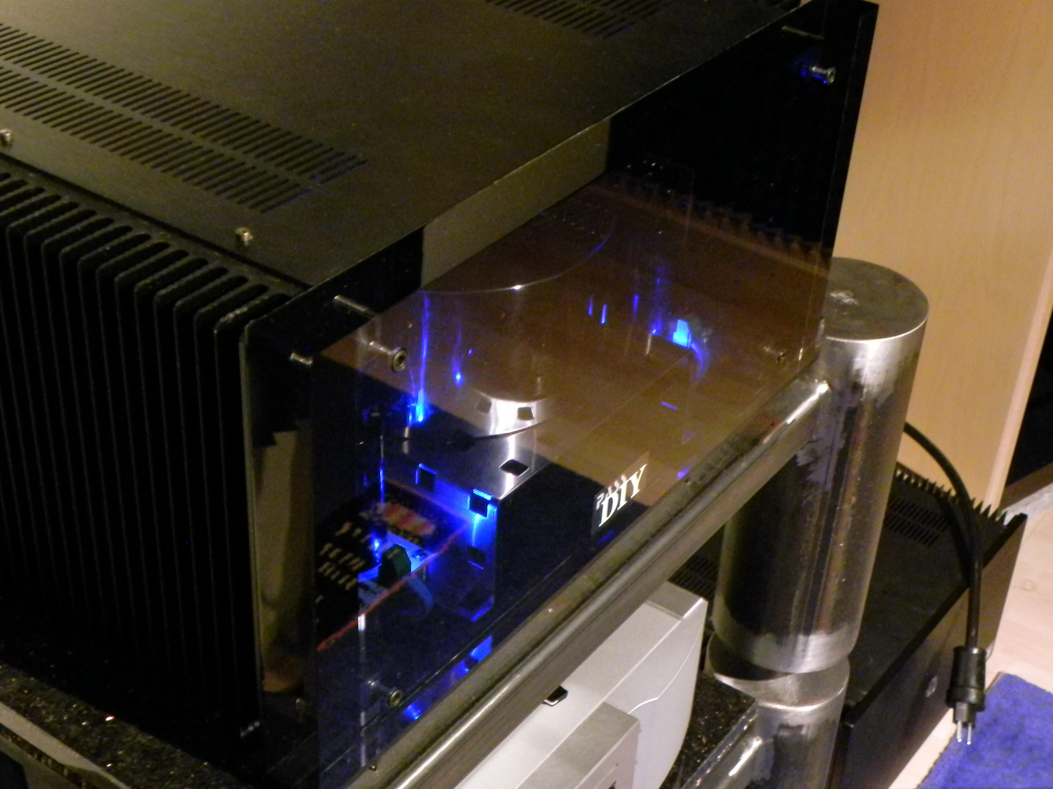

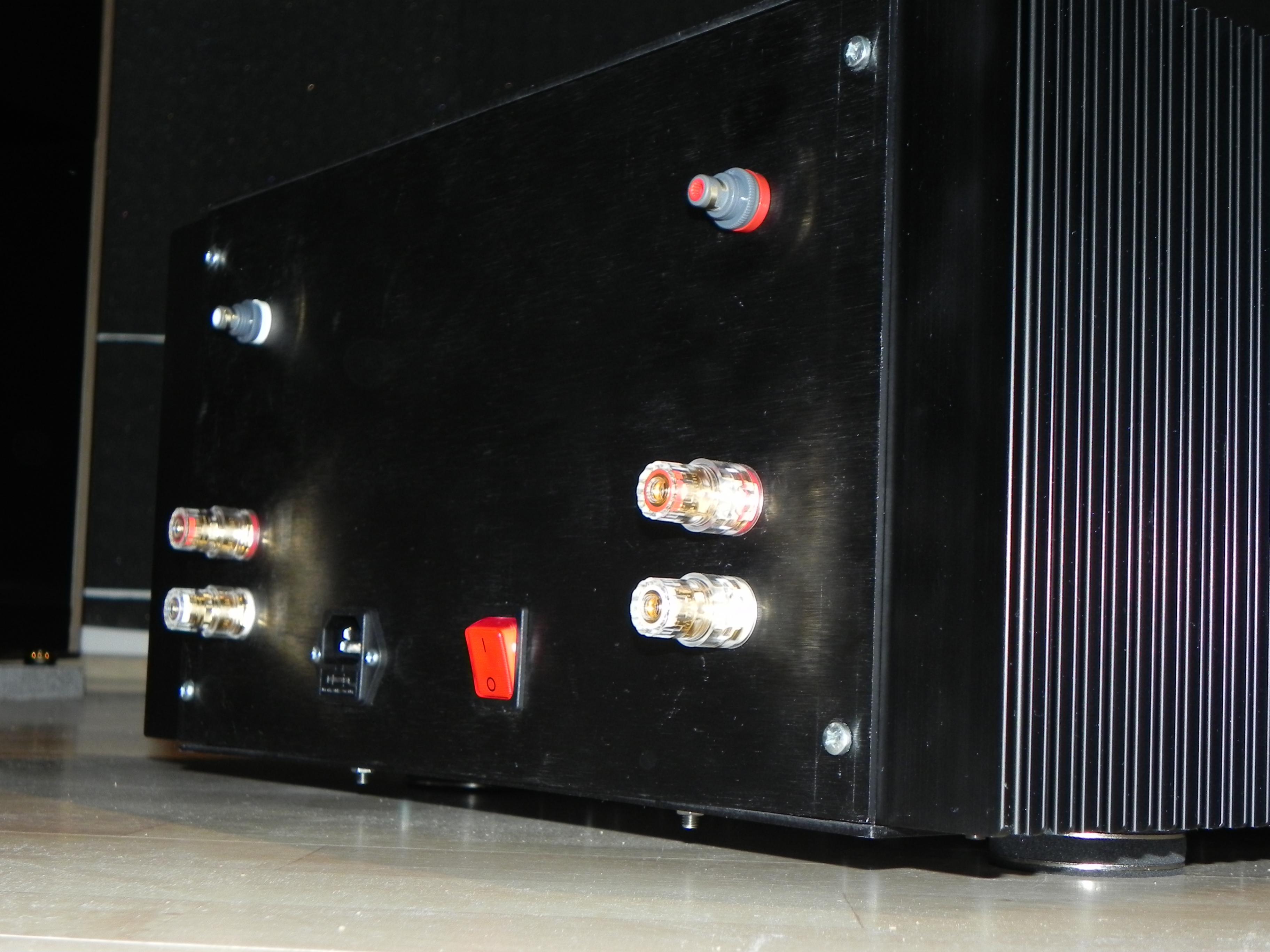

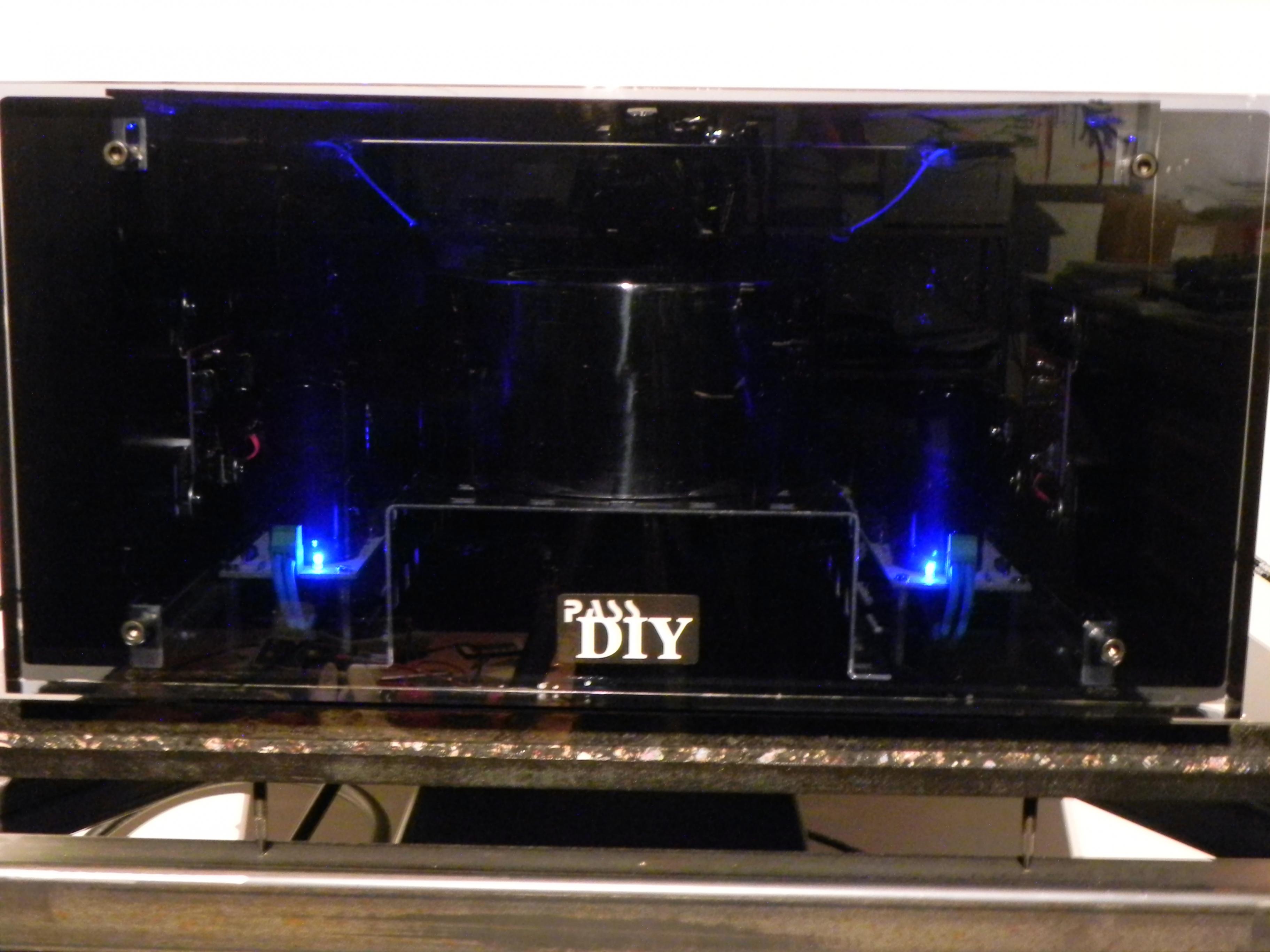

today I want to post the result of my F5T V.2.
Here some details:
Dual Mono Setup: 2 x 800VA toroidals from Toroidy + 2 x 176kuF Elko Capacity from Mundorf
I biased the amp at 2.35A per channel using a pair of 680mOhm source resistors at a voltage drop of ~400mV
Temperature is in the range of 53-55 degree
Offset DC: ~5mV
The housing I'm using is the very large one from Hifi2000.it it is similar to the one you can buy at the diyAudio shop but has a depth of 500mm instead of only 400mm
As you can see I also spent a decent front plate made of plexiglass. I needed to do so because I always want to have a look at the nice toroidals

Hi MallardHi
The housing I'm As you can see I also spent a decent front plate made of plexiglass. I needed to do so because I always want to have a look at the nice toroidals
And here are the pictures:
That one good example of one well made diy amplifier
All quality components and with Toroidy and plexy nice touch orginality.
Congrats and thanks for share .
Build more You have talent !

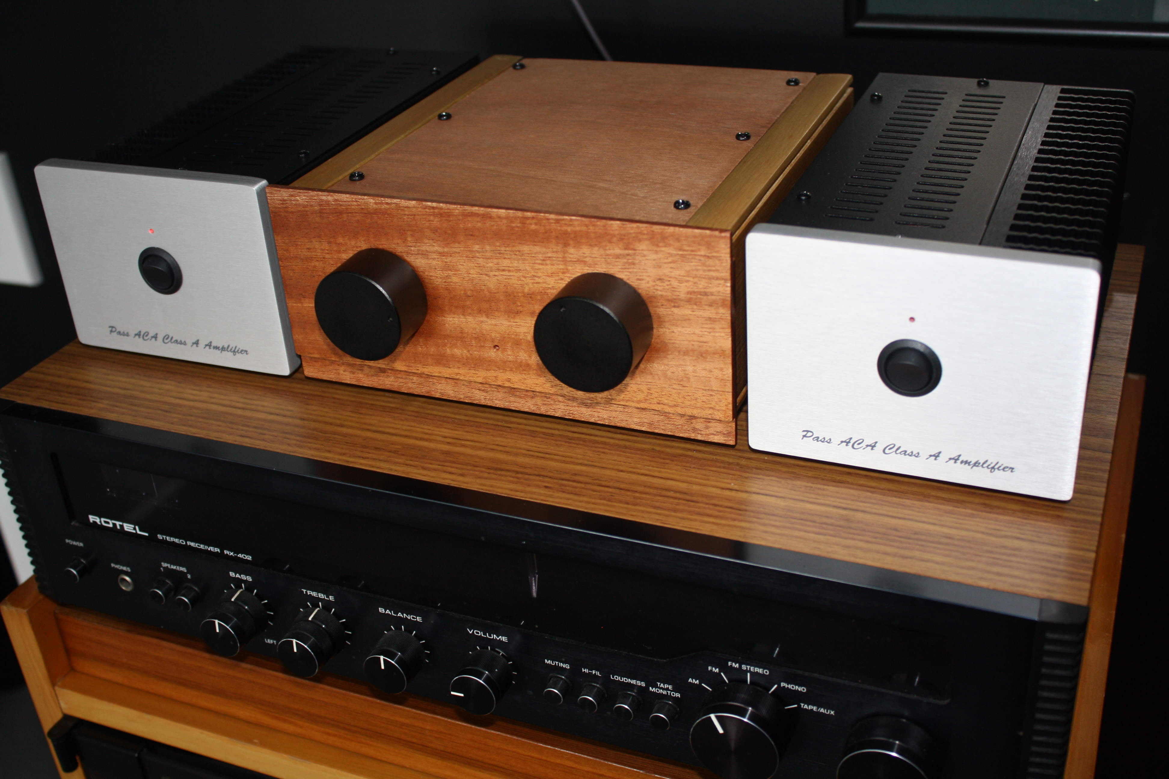

B1 and a pair of ACAs.
neat
