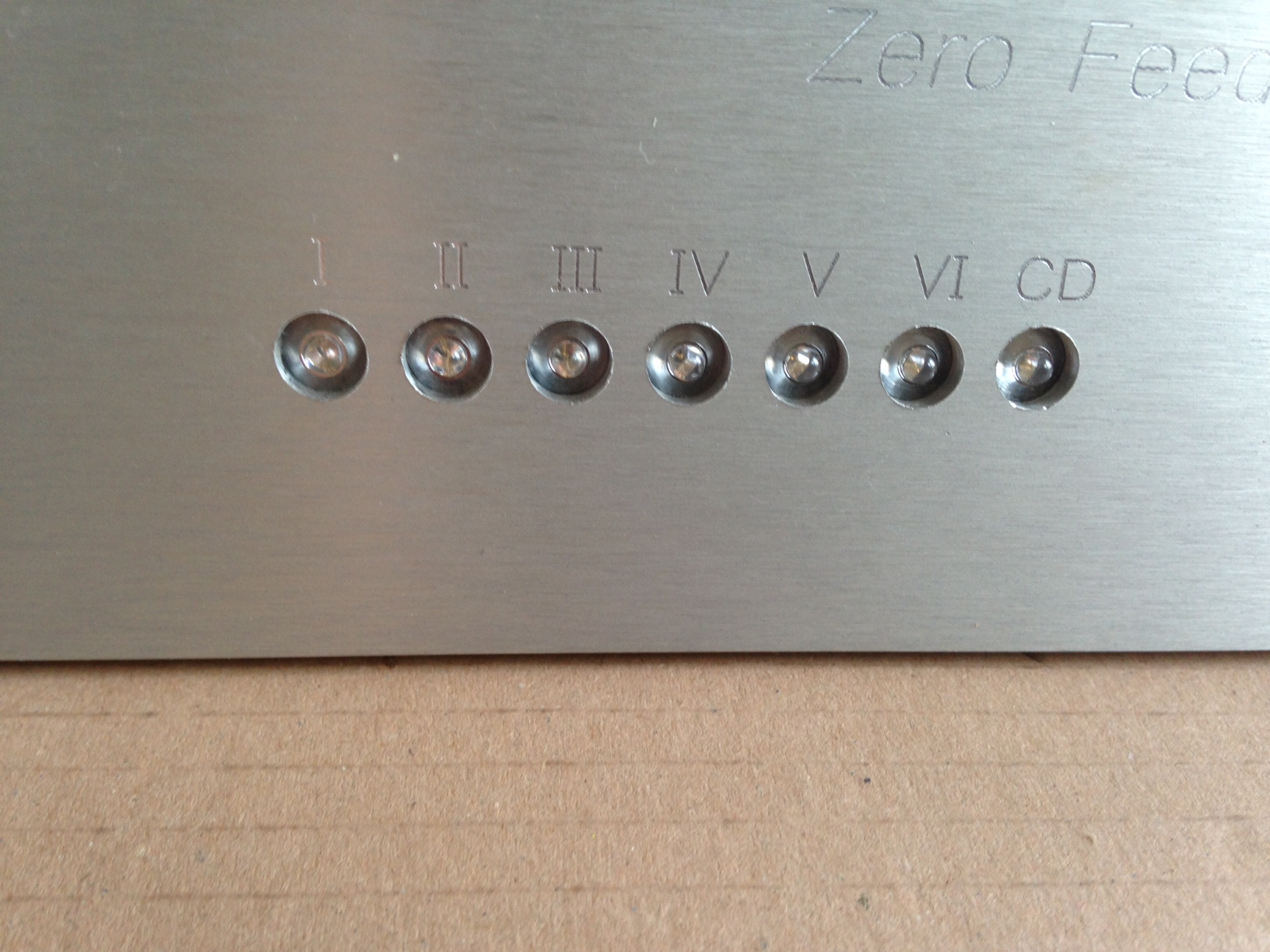

Today the enclosure arrived! Here some pics of my B1 build

It surprise me that you use a very high end rotary switch (ELMA, right?) to control the relays. Is not a bad idea at all, just that the point of using a relay board is to short signal cables lenght and be able to use cheap switches.
Switch
The reason for that is the following: I need 7 inputs. The switchboard has 6. The CD input will go directly through the switch.

I don't have the skill or the tools to make my own boards. So I have to do it this way. The PSU was allready bought so no need to buy an extra one If anyone can give me good and solid advice regarding layout and wiring, I would love to hear it! I'm new at this! The boards can go anywhere.... so any help is valued I could even only use the switch.... The selector board didn't cost much and I love the idea of nice blue leds But if the board is a bad idea I can discard easally.....

Hi Jacco,
I get it.... again, new at this. That board should be near the inputs right?
Maybe I should just use the Elma input switch? It's a 3 pole 7 pos switch so I could use the 3rd pole for switching LED's....

Hey, I love relays.
The LEDs really don't mind lengthy wires from the back to the front panel, a flat ribbon cable will do.
we must first make some fun , then give advice
nature of the beast , I suppose
relay pcb ditto to input connectors
then active electronic to it
attenuator - near relay pcb , with extending shaft to front button
buy cheapest (close or open case, irrelevant) switch for relay commanding , save Elna for something later

even , when using AVC attenuator ( instead of resistive one ) some other things are dictating layout - possibility of easy manipulation with xformers - they need re-stacking , at least once , to make them sing in best way ; that's why wires are longer than needed , usually

Guys,
I have been thinking about how to set up the components.Thank for all your tips!
I need 7 inputs, so discarding the Elma switch is not an option. Now here's my idea: I am going to get rid of the relay board and will use the Elma 3 pole 7 pos switch for the signal. The 3rd pole will be used to power the led's. I will get the power for the led's from the PSU's led's.
The attenuator and position switch will be positioned very near to the rear...(thanks for the tip Zen Mod) The signal wires are going to be as short as possible that way.
What do you think?
