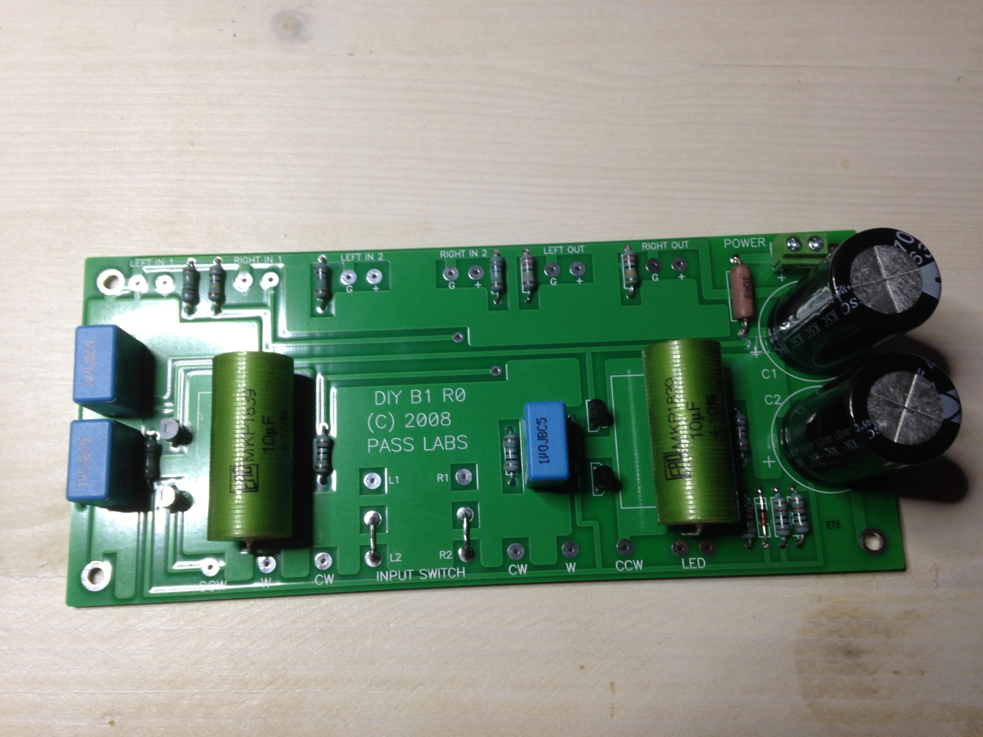

Since I'm currently building a B1 preamp, I would like to know what type of wiring is normally used from the RCA to the PCB? I read about really thin coaxial cable in this thread.... But can't seem to find the exact type.... Or is stripped CAT5 cable an idea? Help??

Whatever you have that will fit the holes in the PCB will be fine. It's not that important.
For this application, thinner is preferable to thicker, but use what you have.
Most people have an extra CAT5 cable that is not connected to anything, and stripping the twisted pairs out of that will give enough wire for many projects.
I have more than enough CAT5 available So I'll go with that!

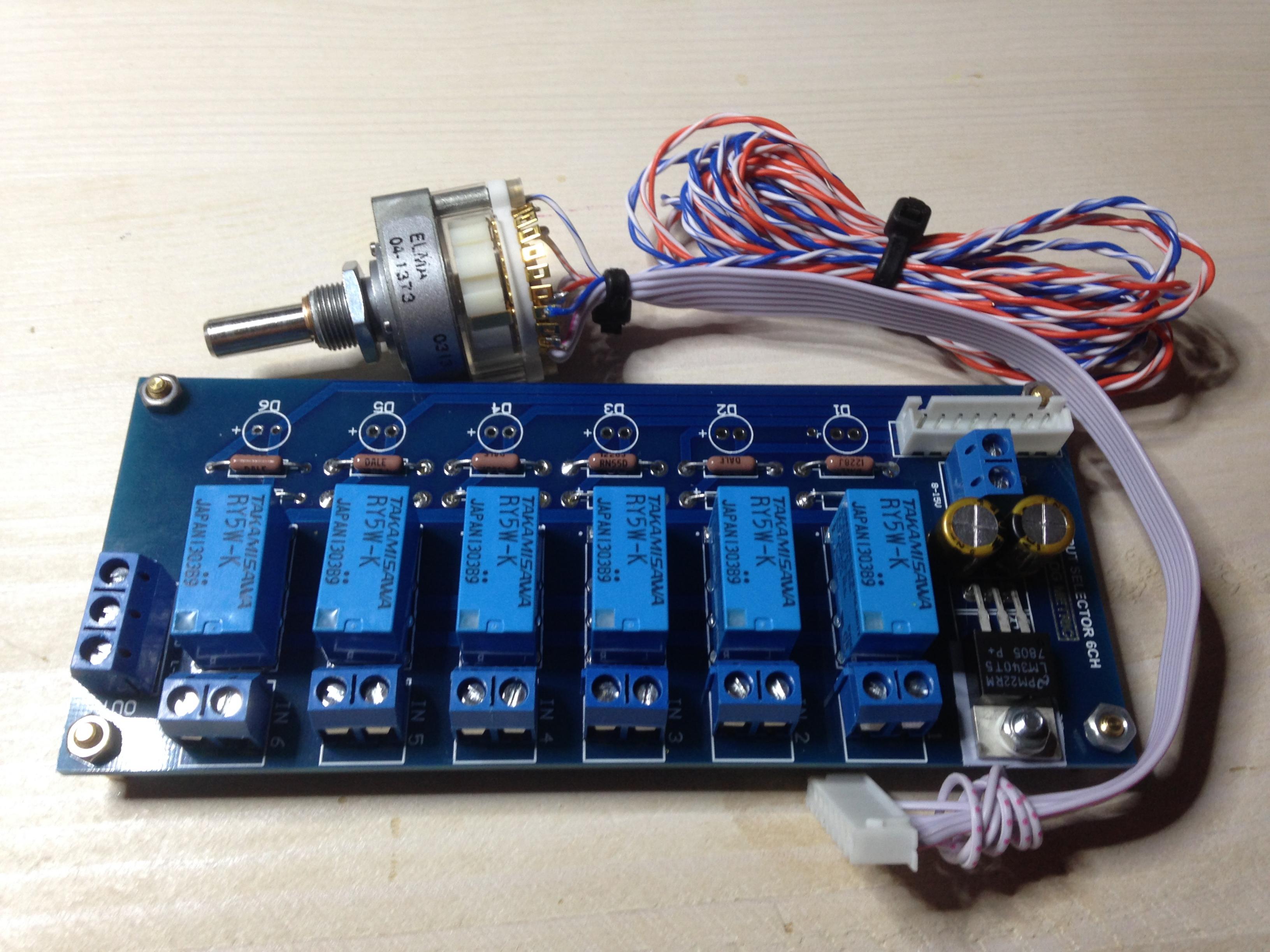

Because I need more than just 2 inputs, I use an input board in combination with a 3 pole 7 position switch from ELMA. The input board takes care of 6 inputs. And because it only needs 1 of the 3 poles, I use the other 2 poles for position 7. That one will be connected to my CD player.

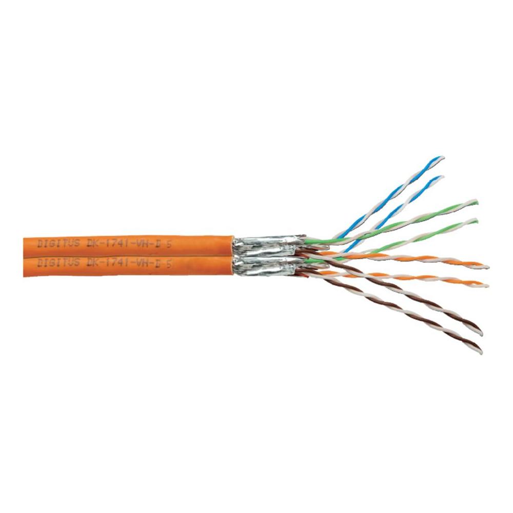

So the next quastion would be how long can the CAT5 wires be before problems occur?

Difficult to say, but keep in mind that it is used in its unshielded version for up to 100 meters at 100Mbps/s. So I would say you could use up to some meters without picking up noise. But it's just a guess.I have more than enough CAT5 available So I'll go with that!
