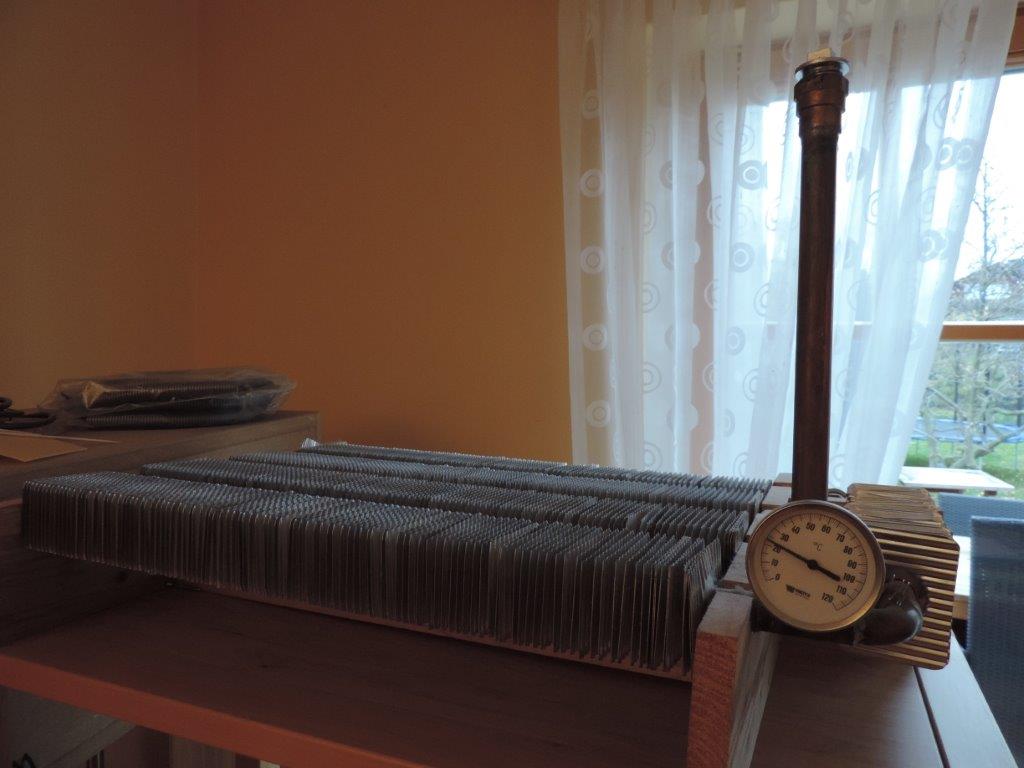

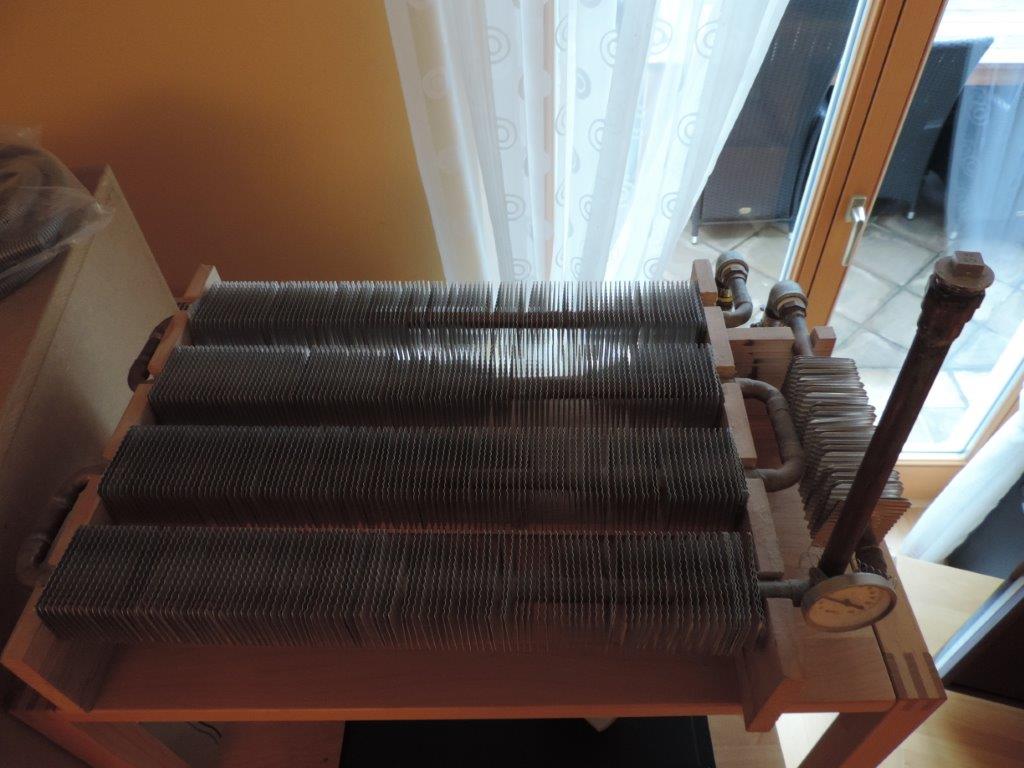

Very interesting James. Glad to see another member's approach to alternate cooling. Is the gauge for temp, flow or pressure? What's the function of the tall copper tube on top? I assume it's a fill port but it appears more sophisticated.
I think you are saying you believe not having a fan and/or pump is an advantage. I am using both to simply reduce the mass of the entire system. Did you try smaller tube/hose and still maintain adequate coolant flow?
Bob, your pictures impressed me and at the end you encouraged me to post.
The gauge is for temp.
The vertical tube is the fill port and acts as a buffer reservoir. When the system heats up the fluid expands a little.
My first setup used a pump and smaller hoses, but I dont liked the noise of the pump.
On the gravity feed system I did not try smaller hoses because the driving force of the system is the weight (density) difference of the liquid in both hoses. The most important thing is the available heat transfer surface inside the heat exchange block, since the flow speed is very low and you will see only laminar flow inside the system. With a pump you have higher speed and turbulant flow which gives better heat transfer.

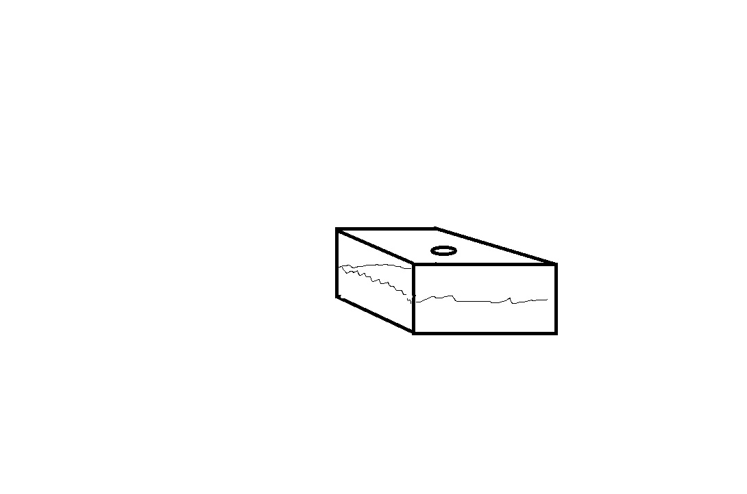

Thanks, Getting silence from the fans and pump is indeed a challenge. I'm on my third pump style and still not completely satisfied. The design I'm working on now with 24 output devices can easily boil water and mess up the pump. I'm working on auto control of system shutdown to prevent that, but your design clearly avoids that glitch completely. Can you post some temp details?
One suggestion if I may - consider determining the expansion in the upper tube and build a tank that accommodates the change. That would allow a lower profile case if you intend to do something similar to what you did for the amp and PS units.

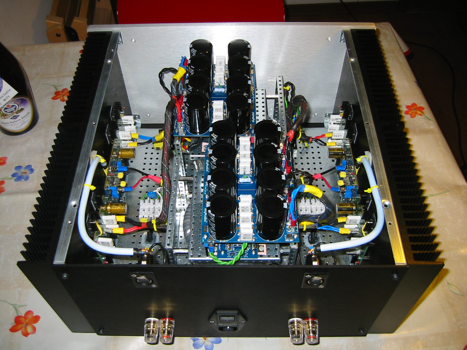

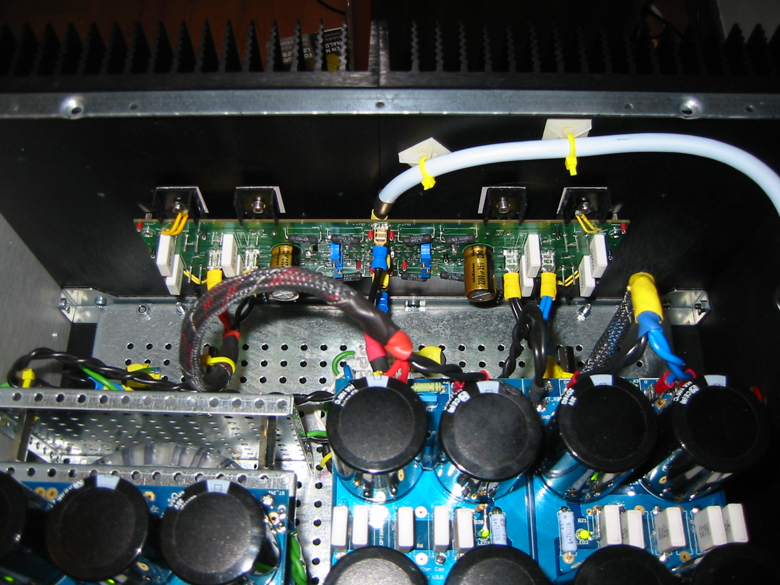

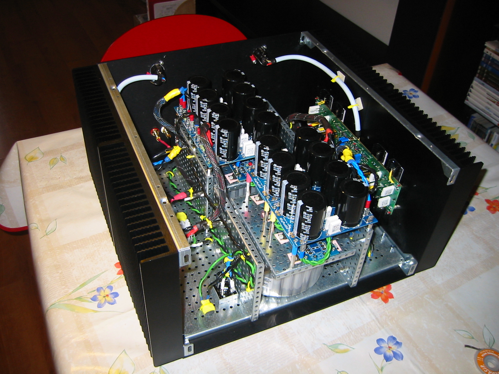

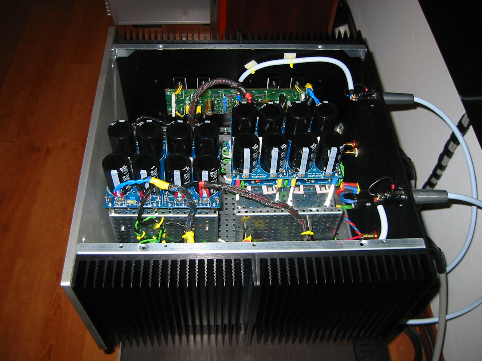

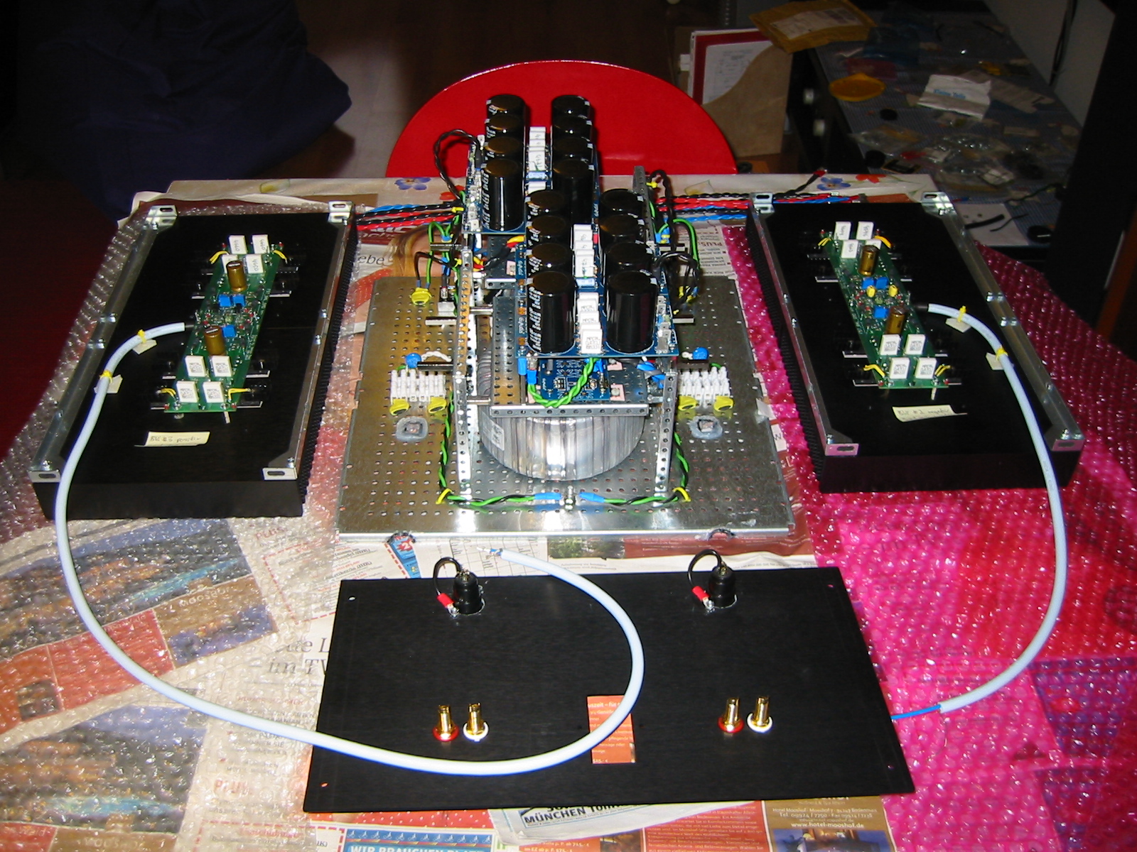

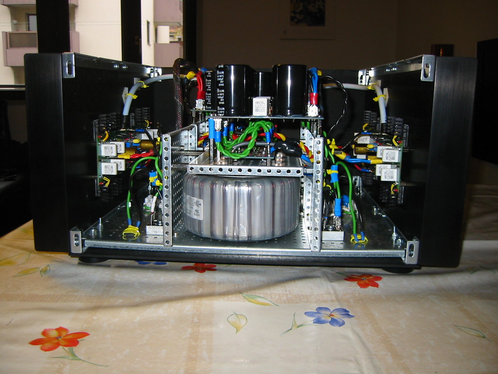

F5Turbo-X build
I have finally completed my F5Turbo-X build. Special thanks to Nelson Pass and all forum members supporting and inspiring DIYes out there!
-- xLoff

Hi ZM and emyeuoi,
Thanks for the feedback.
next time - put those Donuts one on top of the other , and you'll have place for cap banks , also put one on top of the other
or - using big additional plate , you can put both Donuts right behind front plate , "vertically"
- This was the original plan, but I was afraid the amp wold be too heavy at the front, possibly tipping over with ~70% of its 25 kilos at the front... I did follow your tip about hiding the AC mains leads though (link).

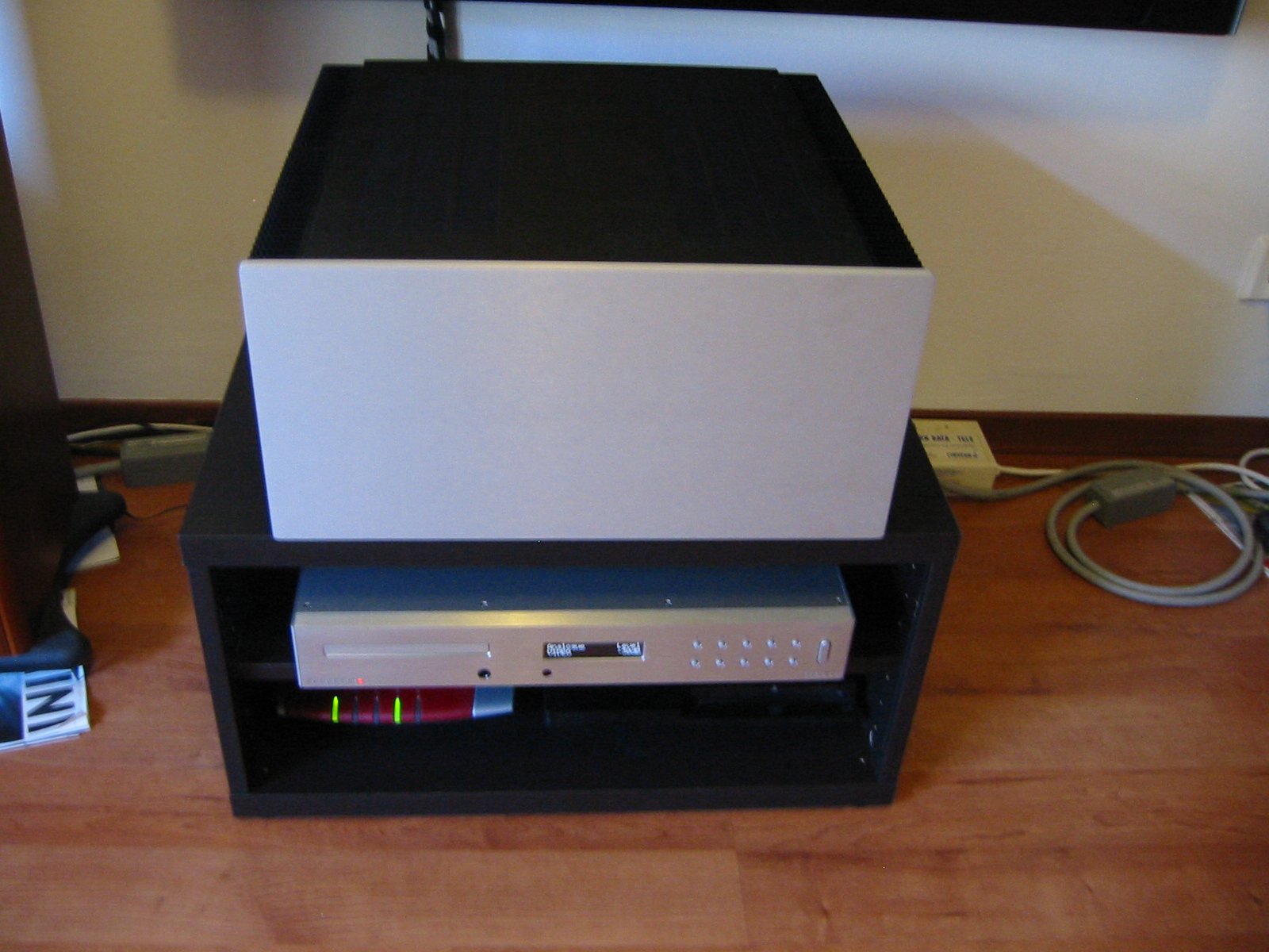

Xloff, That last picture prompts me to ask what you are using for volume control. Does what looks like a CD player have that function? I could easily be reading more into that shot than you intended
- Hi bcmbob. It's an Audiolab 8200 CDQ preamp with DAC (ESS 9018) and optional CD drive. One of the few decent preamp - DAC combos with analog inputs I could find.
-- xLoff
A power amp doesn't need a volume control. That function is normally performed by the pre-amp.
Quite correct, but a playback system usually does.:D
xLoff - Very nice combo unit. I have about the same functionality in what happens before the F5/BA-3 but spread across several boxes. As stated in the linked review, the sound shaping and control options are virtually endless - particularly with the 8200 PC union.
