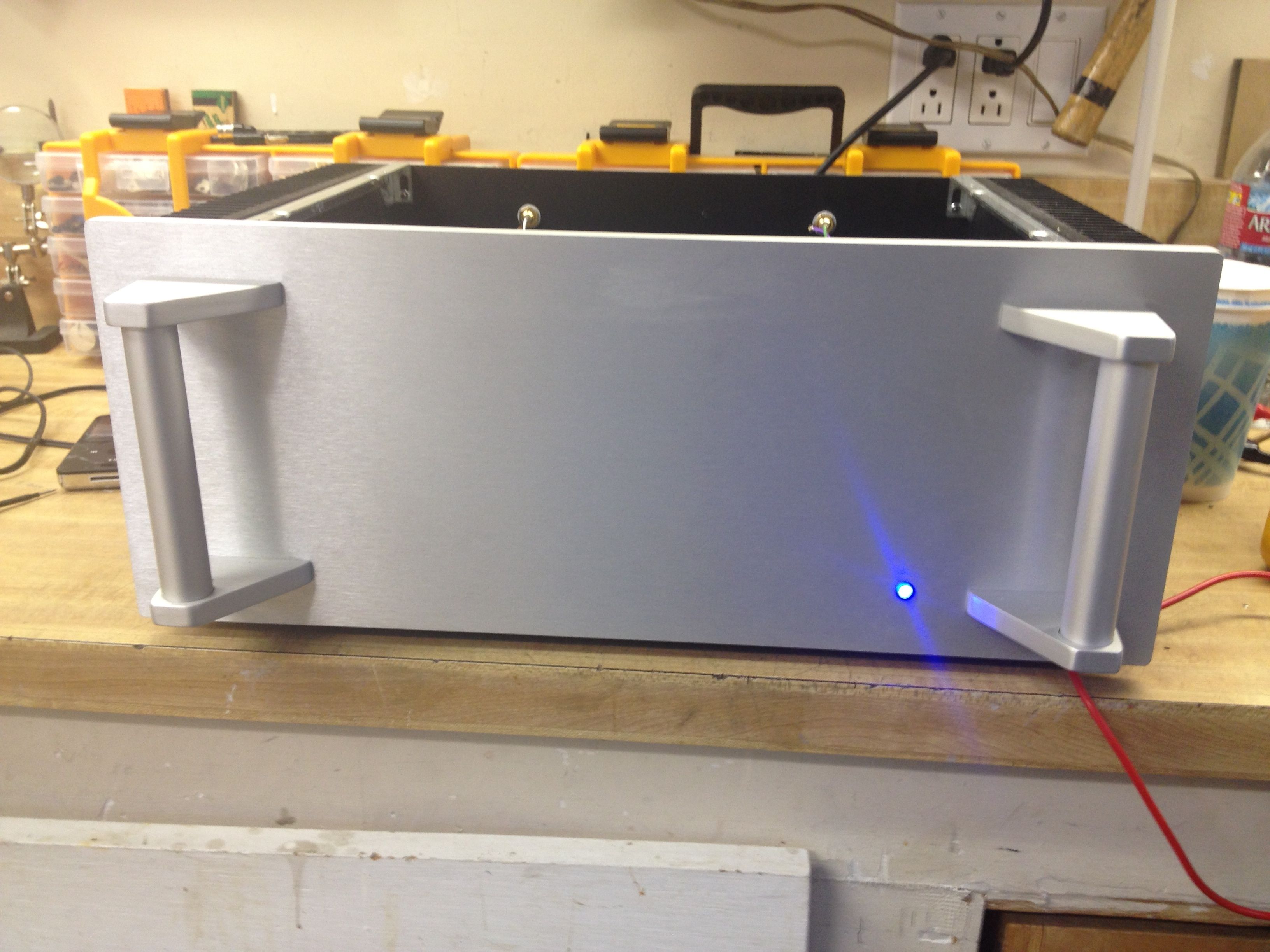

Here is the final pic of my F5 before I button it up and move to the listening room. DIY boards, 4U case, handles. Added hole for blue LED power light.
Bias holds steady after playing all day. Heat sink is about 22degC above ambient, all and all a beautiful and stable design. Thanks Nelson and fellow diy'ers.
Looks very nice ! Any pics of the inside?
Is it the finish you have on it or how the heck did you manage to keep the front so mar free?
That is an awesome build and nice handles to match.

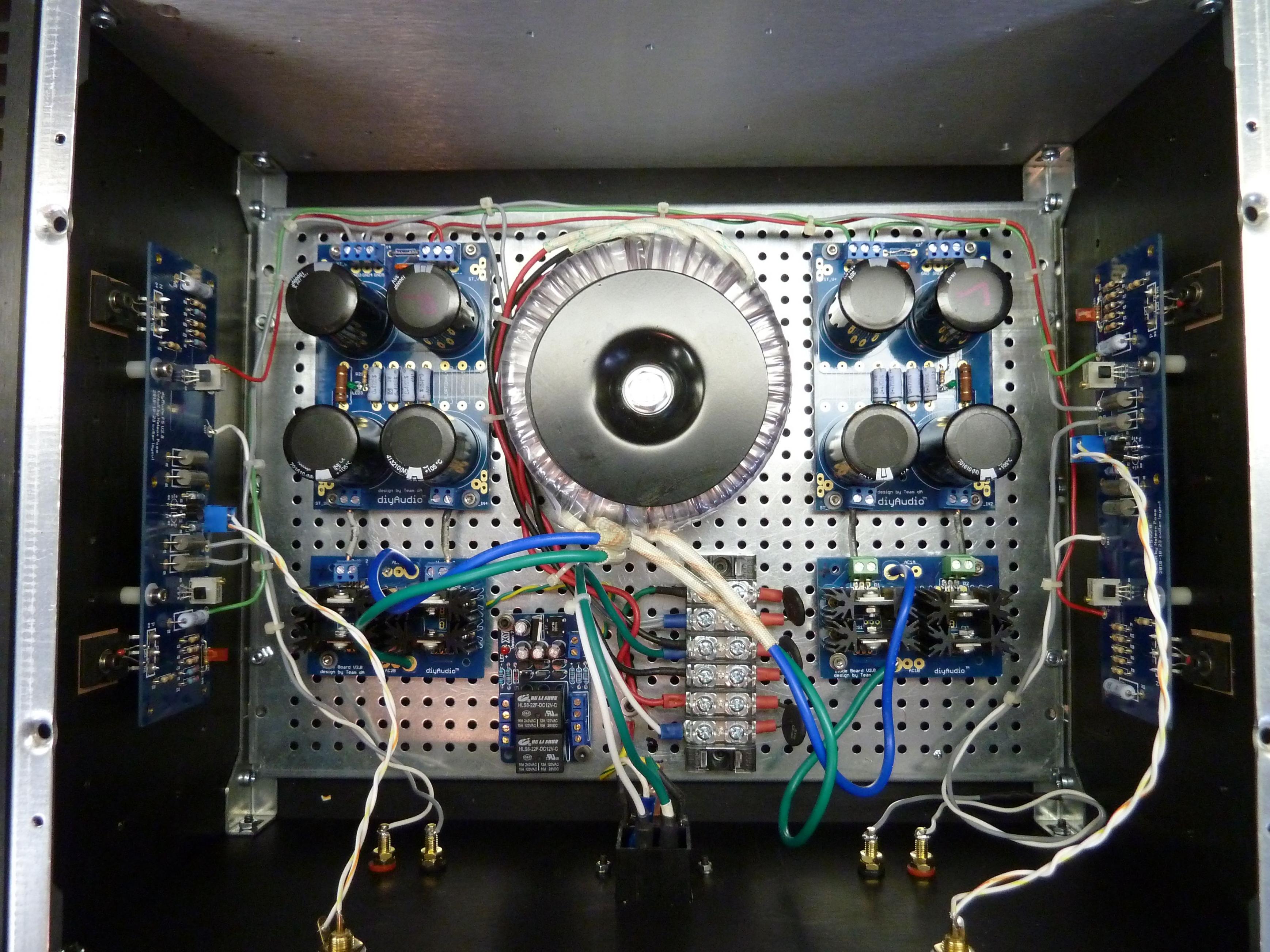

Here is the guts of the amp. Taken before handles and front LED added. Also, I had not twisted AC wiring yet. All nice and neat now. Note stable bias! Great design Nelson.
Small pcb at the bottom left is for speaker protection. Cheap eBay product. I have not hooked it up yet.
Thanks. Two tips on the case
1. Assemble sides and front, then back, bottom and top. DO NOT fully tighten screws until everything but the top is together. Tighten front screws first. Then, everything fits.
2. Keep shipping plastic on all parts right until they are installed. For front panel, I cut a piece of cardboard and attached to surface with painter's tape. After I installed the front panel, the cardboard and tape came off. It is REALLY easy to scratch the soft aluminum.
Regarding the handles, I would recommend using a drill press with new and sharp bits to drill through the holes for the handles. You will also need to very slightly taper the holes from the front just a fraction to break the 'lip' created when the hole was drilled through. The handles may not mount flat if you do not. You may be able to do this whole operation by hand, but I didn't want to.
The handle cylinders were a bit short, and rattle around. I used a sliver of cork in the bottom handle holes to stop the rattling. Check that the included screws actually fit in the countersink holes on the back of the front panel. Two of the eight included in my handle set were too big. Could not fit in completely. I enlarged the countersink slightly, but again, not something that I would have attempted without a stable drill press and very sharp bits.

I'm just about to build the F5T v.2 in a similar setup like you. Same pcbs for PSU and AMP with a dual mono setup. (2x800VA trafos)
May I ask you how bias the amp? And how did you set P3?

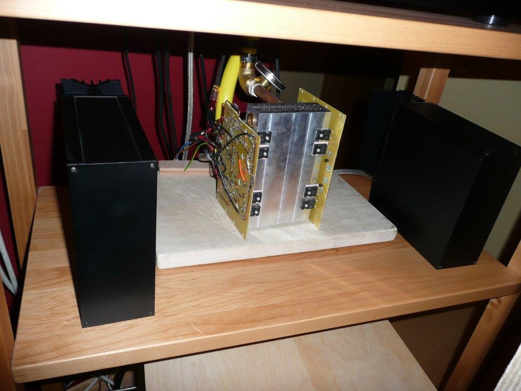

Is a dual mono V2 with 2 PSU and 2 Trasformers 600VA. Here some pictures during the building. I hope you enjoy the pictures as I enjoy the sound :wave2:

Hi Mallard,
Is a pleasure to know that after just "taking" information and help from this fantastic forum I can also contribute (maybe just a little) to help other DYIers.:)
Actually the bias is 360 mV. After various replies from Buzzforb and AndrewT they suggest to bias the amply very very slow and go to max 380/400 mV. In my understanding :)scratch:) the risk is that if the diodes in parallel to the FET start to conduct during the bias set-up, the bias become unstable and can run away destroing the FETs.
The P3... as suggested in the FW F5 Turbo article the P3 was set at the middle of his value before to sold them. I have no idea how can set him with only a DMM but anyway the ampli is sounding so amazing that I don't fill I need to touch it.
Enjoy your build

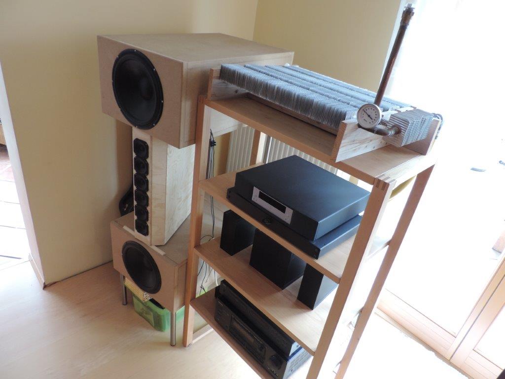

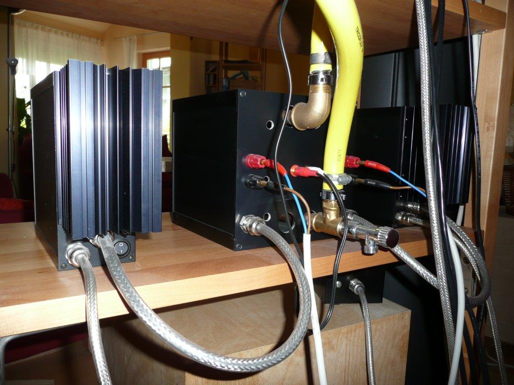

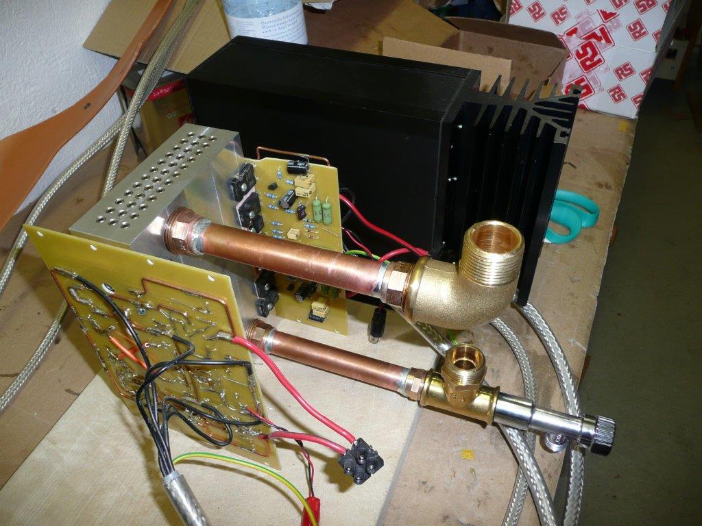

Liquid cooled Alpeh-X
I have built this about 6 years ago according Grey Rollins schematic, and it´s still in use:
The coolant circulates only by gravity. (without a pump)

Very interesting James. Glad to see another member's approach to alternate cooling. Is the gauge for temp, flow or pressure? What's the function of the tall copper tube on top? I assume it's a fill port but it appears more sophisticated.
I think you are saying you believe not having a fan and/or pump is an advantage. I am using both to simply reduce the mass of the entire system. Did you try smaller tube/hose and still maintain adequate coolant flow?
