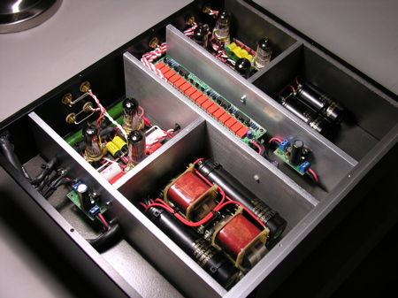

Here is my first DIY tube project. It's designs from www.triodedick.com The RIAA is the ''phonodude'' and the linestage is the ''Cleo6''.

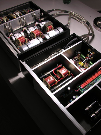

I have made is as a two box preamp according to the ''clean box'' - ''dirty box'' idea.
The dirty box contains the 3 transformers and the first stages of PS regulation. This box also houses the microprocessor board for the display, remote, volume, balance etc etc unit.
The clean box contains the RIAA and PRE of course, and also the final stages of PS regulation and the relay controlled input selector / volume control. The small circuit boards in the clean box are the 6V and 12V regulators for heater supplies and the PS for the relay boards...
I will upload a few more pics...

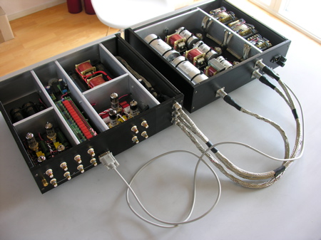

FastEddy said:Desmo: " ... The thin cable is the control ..."
USB ? ... Serial ? ... Current loop ? ...
Very nice looking stuff, BTW ... Let us know how it all sounds ...
Thanks FastEddy...
It is this design I'm using: http://eshop.diyclub.biz/product_info.php?cPath=85_186&products_id=405
I don't know the specifics of the interface. I have just made the thin cable as an extension cable because the controller is in the ''dirty box'' and the attenuator boards are in the ''clean box''...
I will let you know (if it does not explode, when I turn it on)

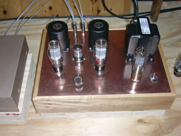

I recently built a 2A3 single ended Amp with James OPT's and a Hammond 302Ax power transformer.
The choke came from dutch manufacturer AE-Europe.
I have built the amp on request for an audio enthousiast. He uses it to drive a couple of "sonatines" which are built around the PHY driver from France.
It sound very musical. The schematic I took from http://members.myactv.net/~je2a3/simple45.htm
only difference is in the cathode resistor for the 2A3, I used 1k instead of 1k5.

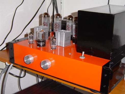

Another thing I did, based on Bill from www.triodedick.com
It uses EL34 as power stage, a 5687 as phaseshifter and a 6SN7 as first stage.
It has been sold recently to make room for other projects.
