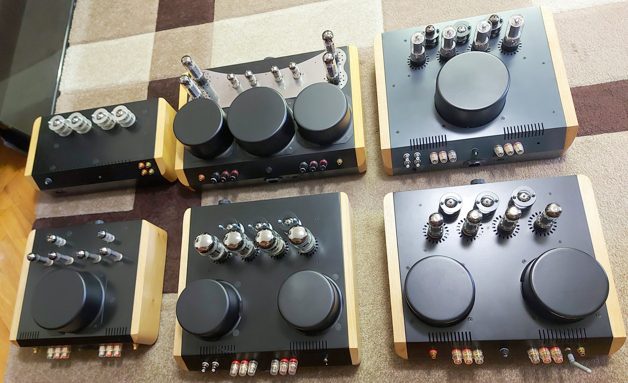

I recently got the itch and built another preamp which oddly enough I had the parts for laying around.
Due to it being the eighth one I've built on this design I tend to order lots of parts and have them stashed everywhere...

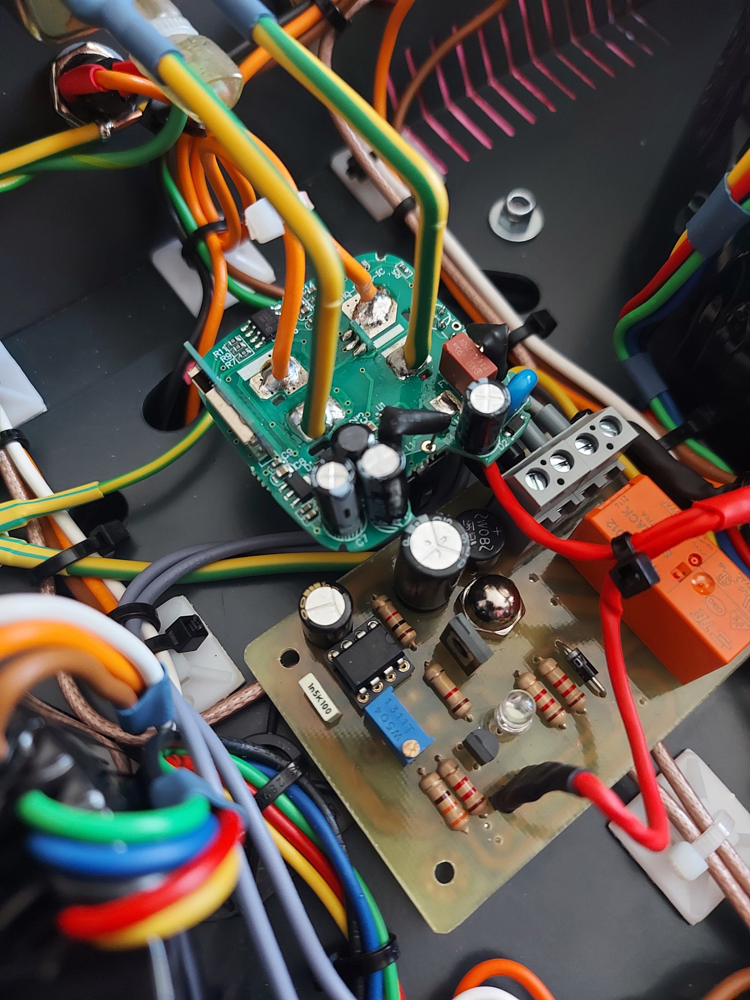

I've still got to wire the cinemag transformers on the moving coil phono input, but the rest should work...

I think that you use relays for switching between sources. Did you make the circuit board with the relays yourself or is that unit available for purchase?

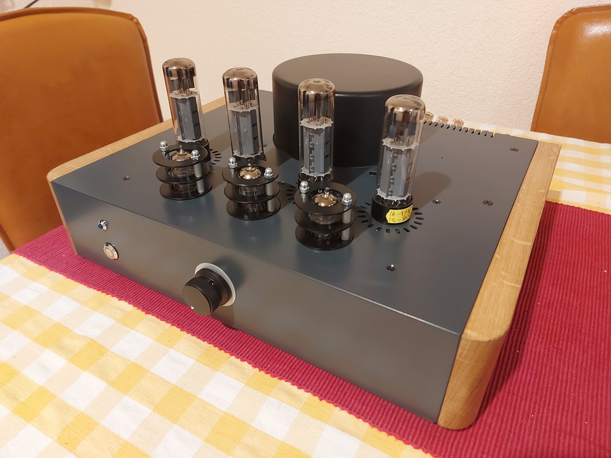

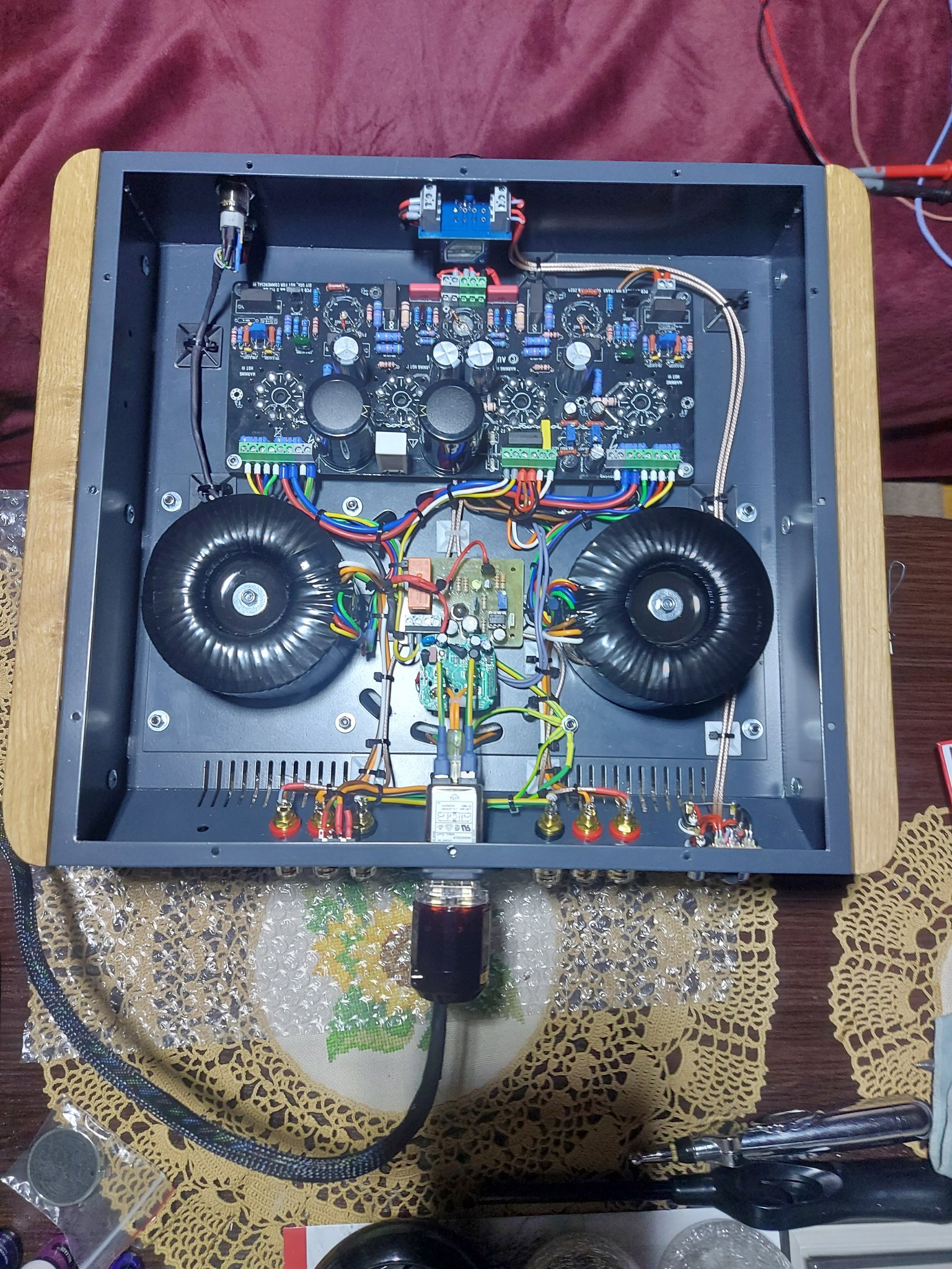

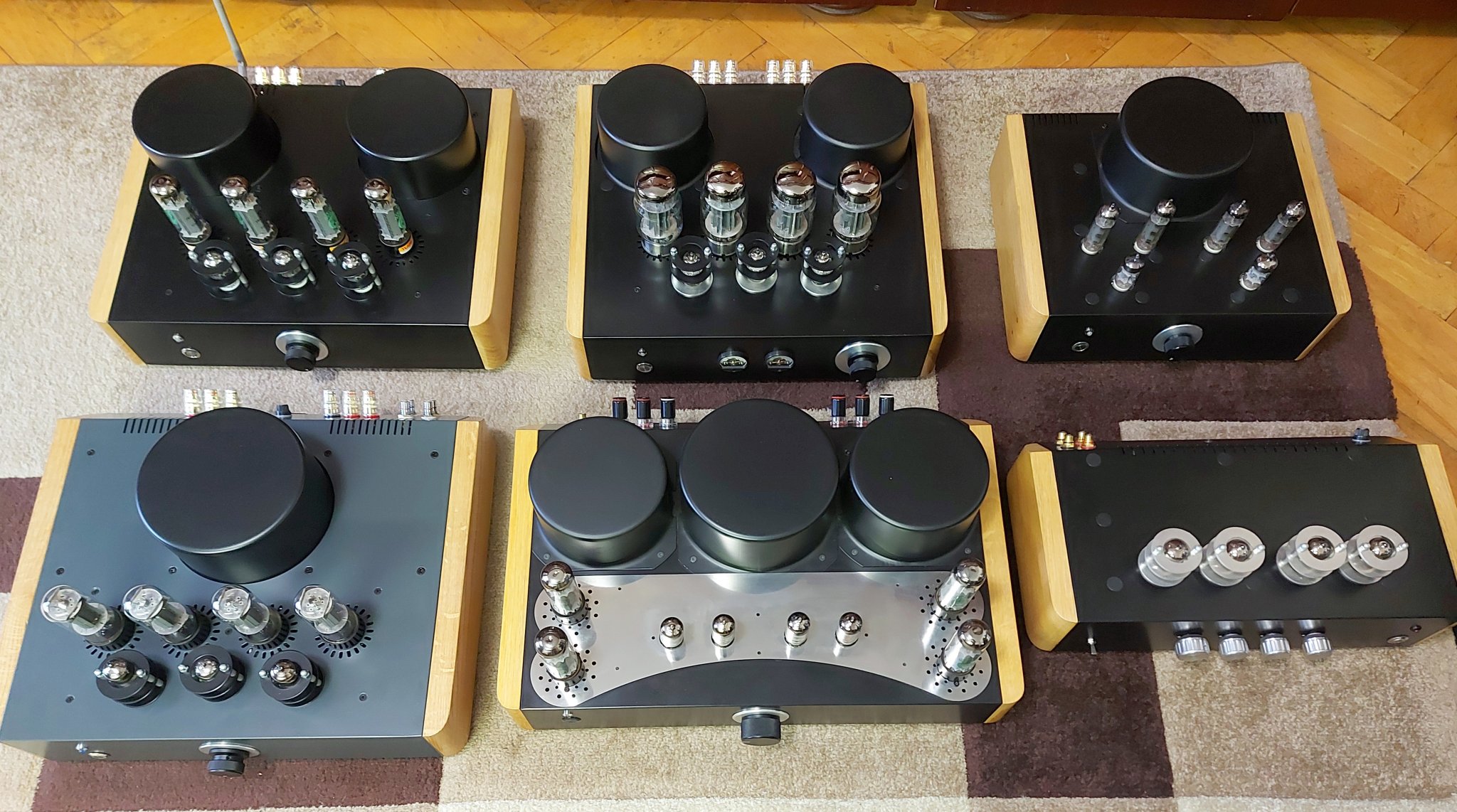

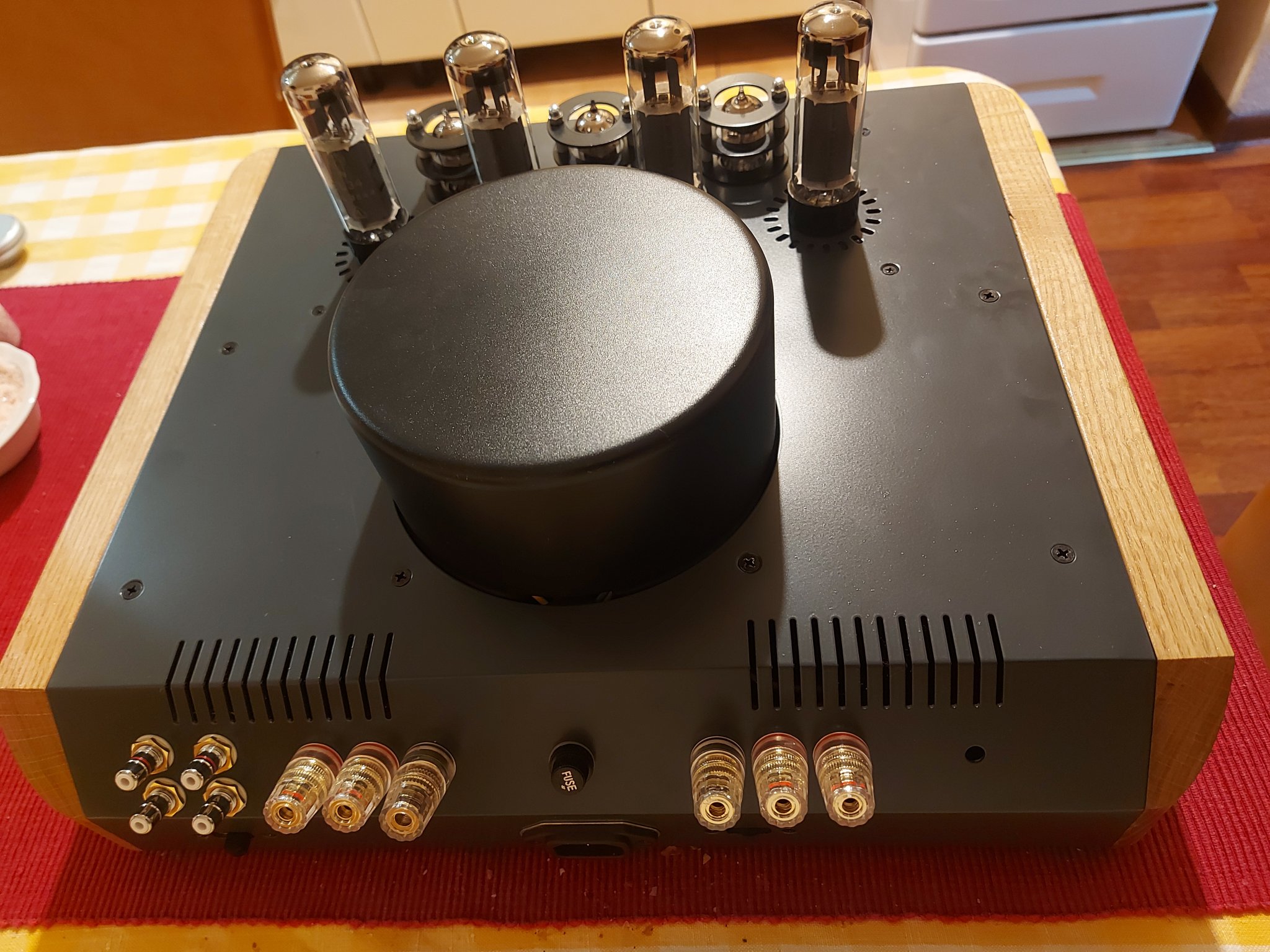

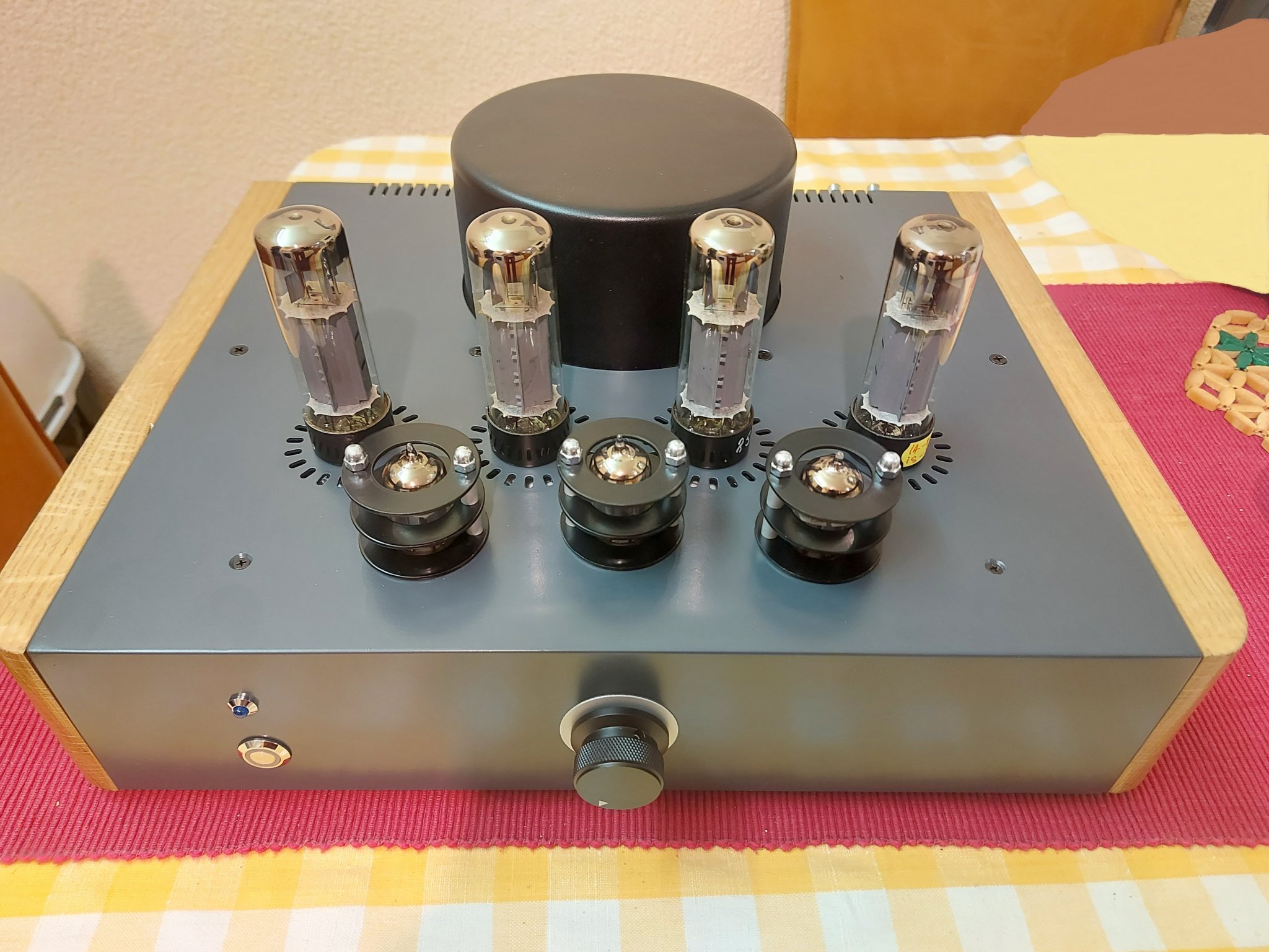

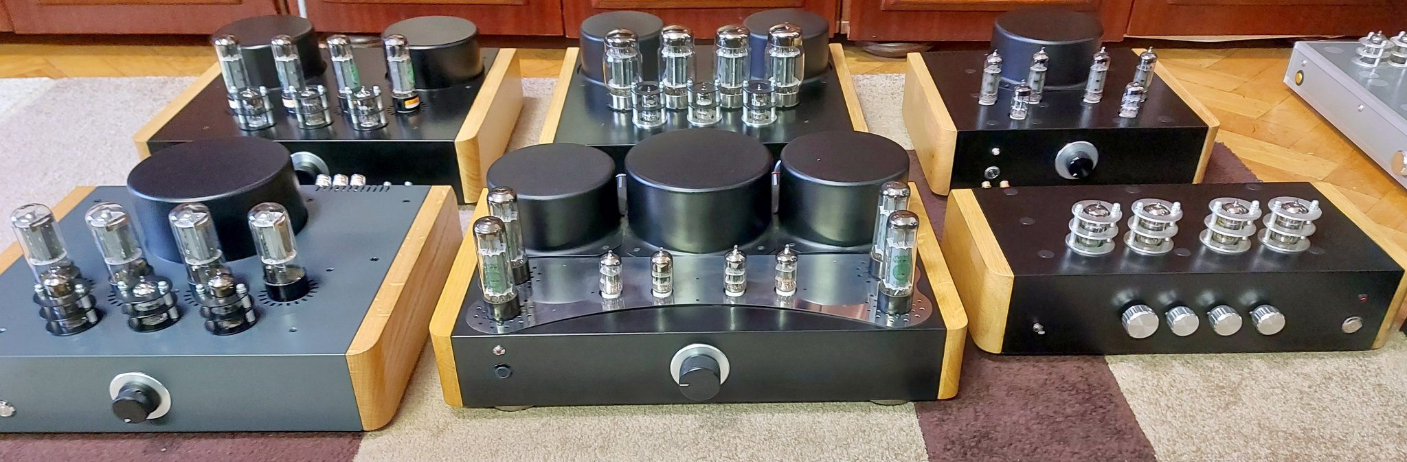

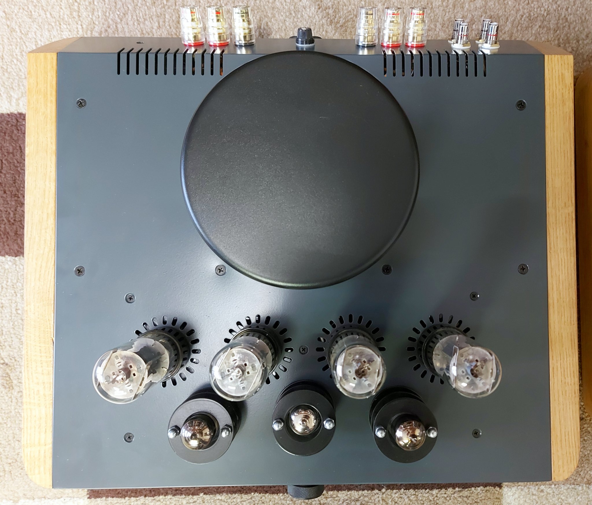

I also finished, the last amplifier, in the Dracon series, the number four. Same scheme, same PCB, same quality components .

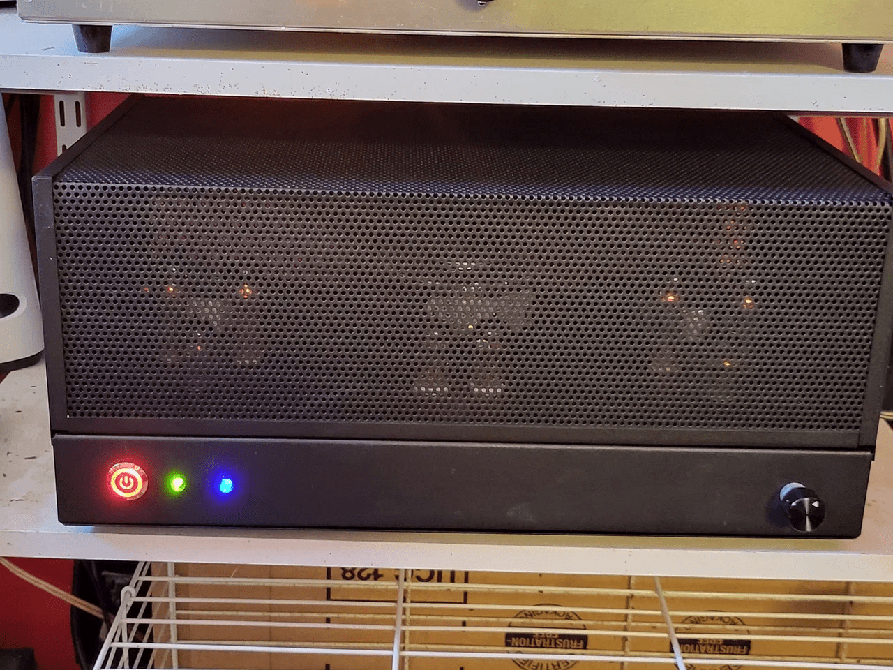

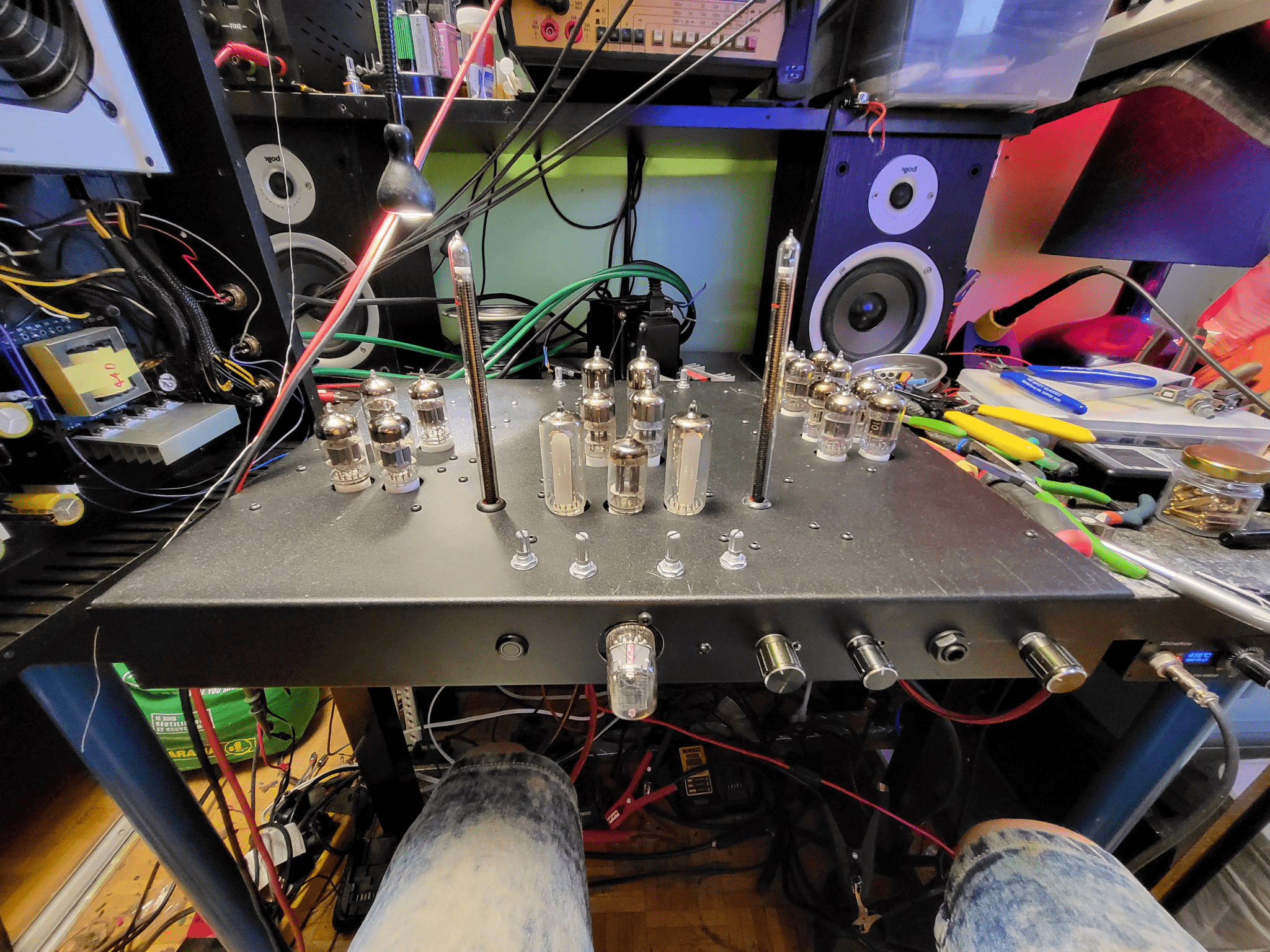

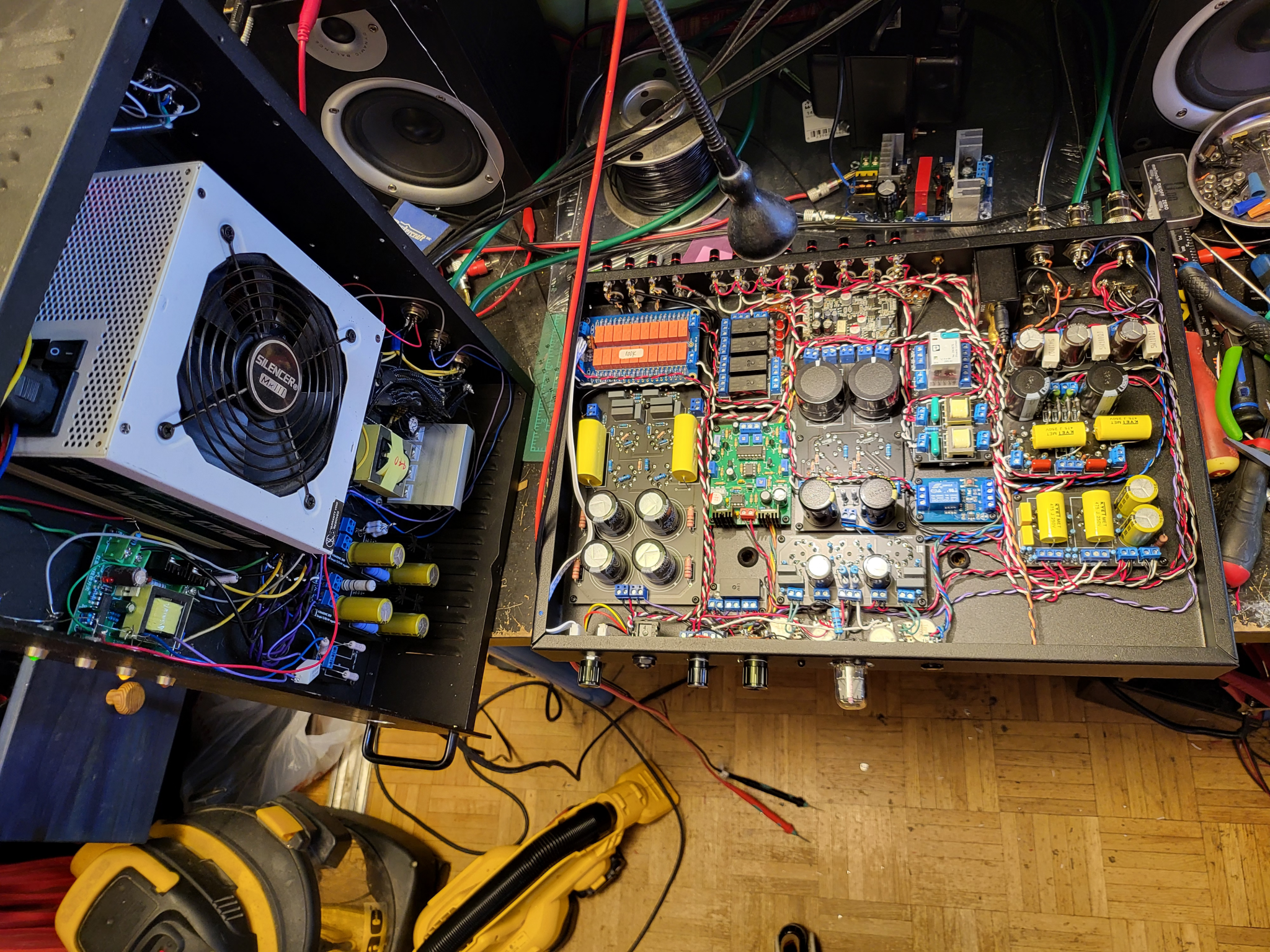

After a week of waiting for the volume board and a couple of pots, it's finally wired up.
No tubes installed yet, but it turned on so there's no shorts :)
I don't expect any 120Hz hum :) 12V SMPS to DC-DC converter to 400VAC to TL783 linear regulator boards for 340V for line/HP and 350V for phono, 280V DC boost for 6E2/IN12/IN13, 5V for volume and S/PDIF out, 12V for heaters, relays, and bluetooth.

Look, Ma! It Works! Just like it said in the encyclopedia! LMAO
Not sure I like installing the IN13 tubes with Crazy Glue but whatever, I'm using it not shipping it.
Now I have to make 2U of space in the rack for the damned PSU.

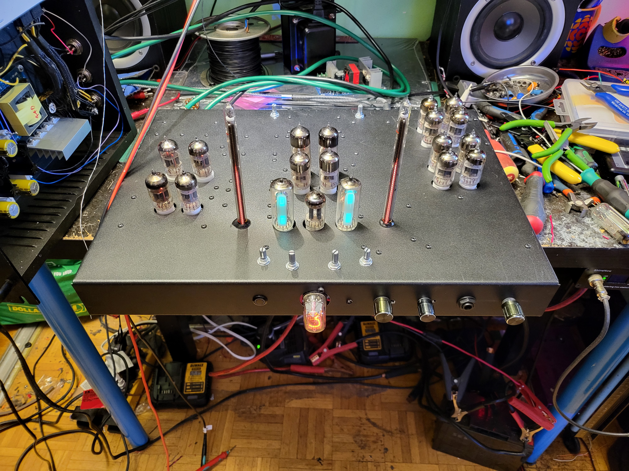

Here it is in the "rack"... I still need to adjust the IN13s - they are set too sensitive. Also, my "EQ" input has a misbalance I have to look for.
The phono stage is nice. Average noise is ~ -77dB. Majority of which comes from the 6N2P input. Next, I will mock up one with LND150 instead to see how that works :)
The IN13 circuit was a kit bought from a Russian guy on eBay who is now "Away" until December 2030
