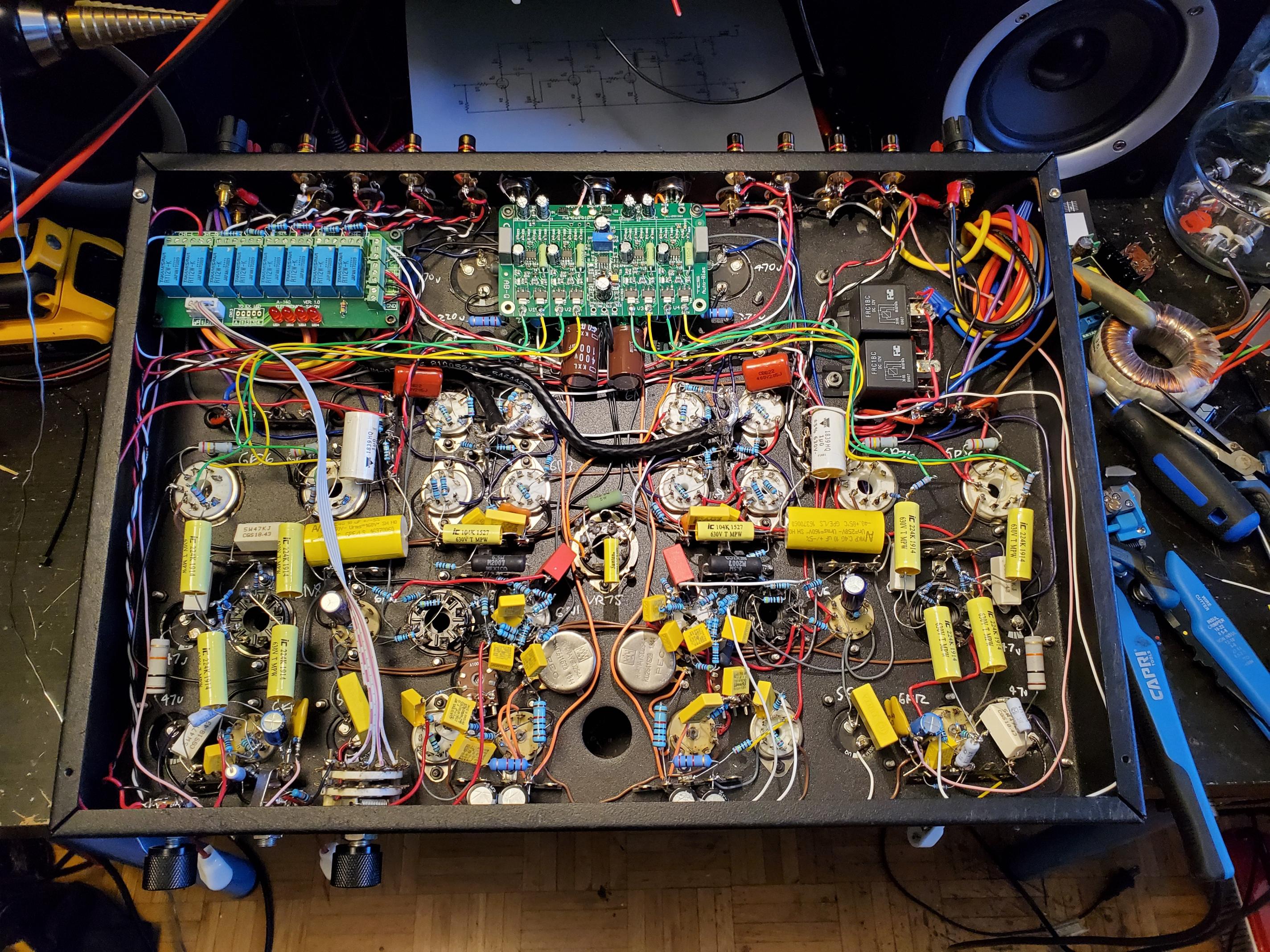

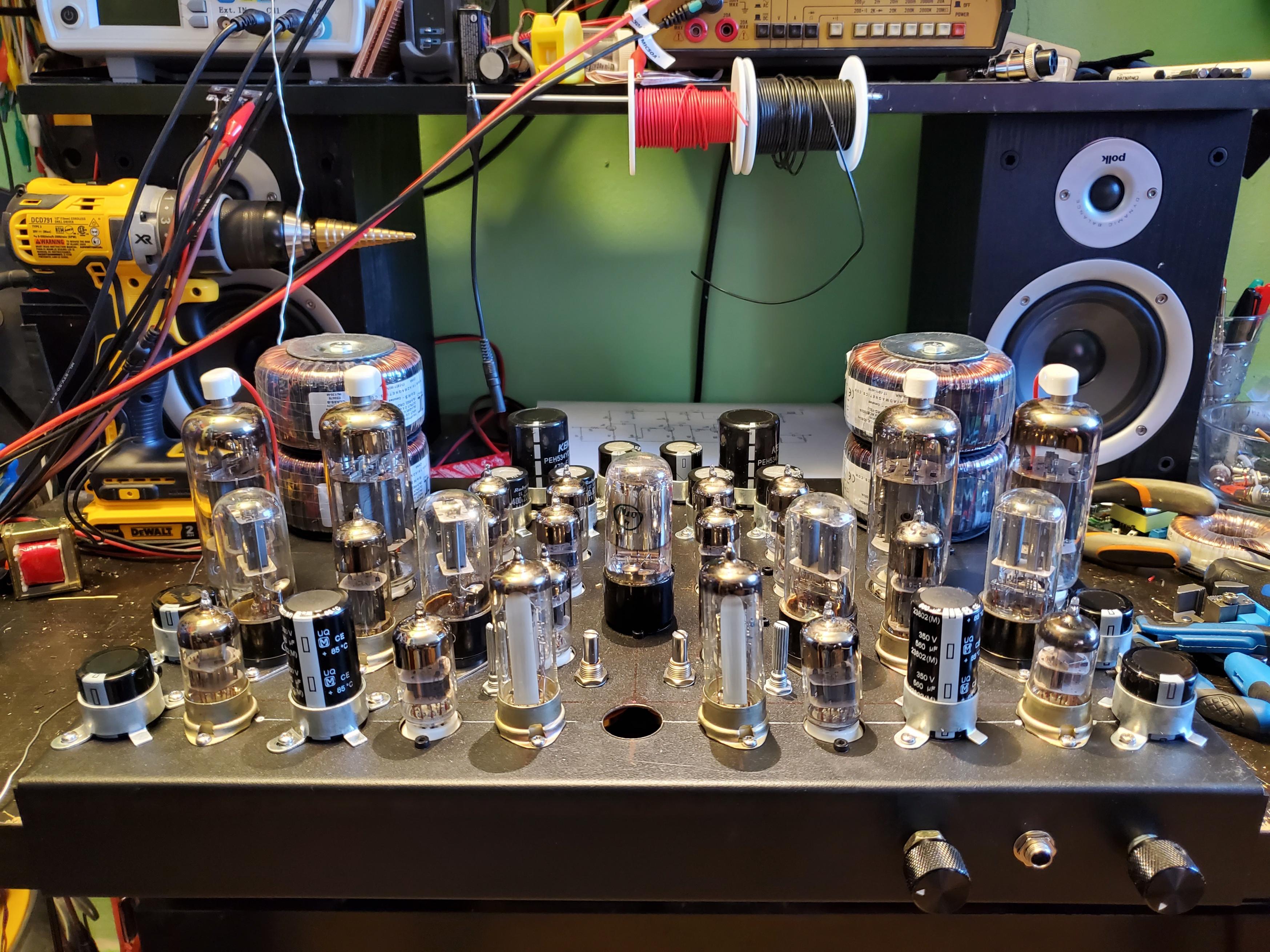

I'm just waiting for the nixie in the mail to plug that hole
It has phono plus 3 inputs, a 10Hz 4th order HF filter, 6E2 meters, an OTL headphone amp good down to 32R that doubles as the line stage, and a triode strapped output stage good for about 50W.
Power supply is in a separate chassis (obviously).
I decidedly like the aerial shot
The hardest thing about building this entire thing was soldering the shield wire on that damned RG6! (No I wouldn't have used it if I had ANYTHING thinner at all). I had to use my old school quartz 60W pencil iron. I must build a spot welder

Hi there,
better than my previous SE 300B, above all in bass region !
That's a beauty congrats, different approach on build but very classy...I also see you used CSA ClarityCap they are my favourite cap also love them, so enjoy the music.....all the best

Nice! Could you share some details?
Jim

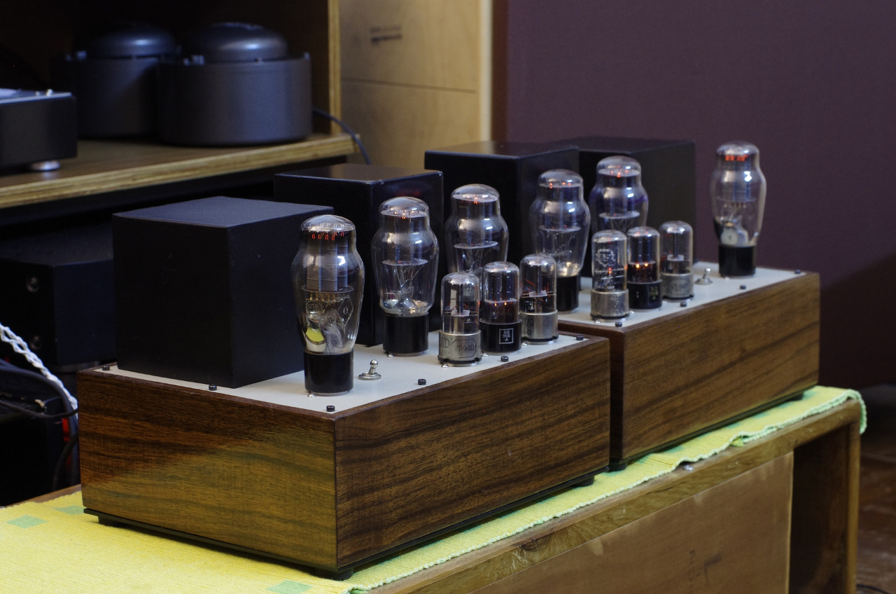

Hi there,
6336 A double triode in SE configuration
6SL7GT Driver
380V plate voltage
105 mA bias per triode
2 x 9 watts
Regards

Wow - that is amazing!! 27 valves! How many watts go to the heaters?
If everything is on (phono stage only lights up when you're set to phono, power stage is switchable, too so this can be used as a preamp for my other amps) it's ~100W for the heaters.

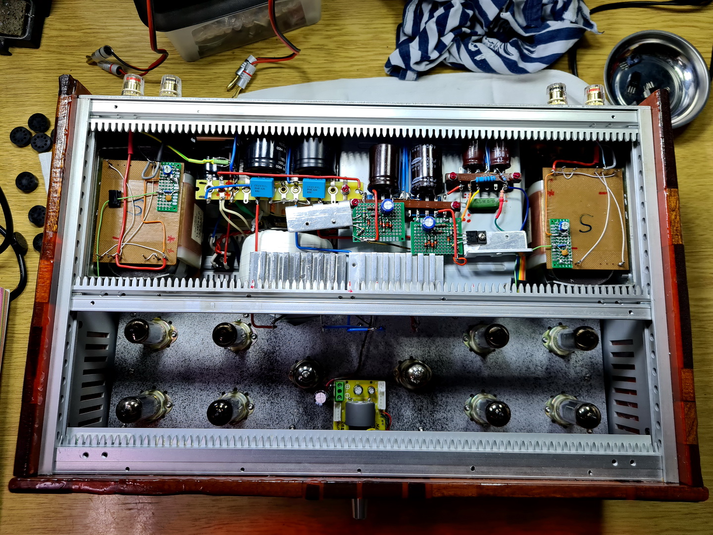

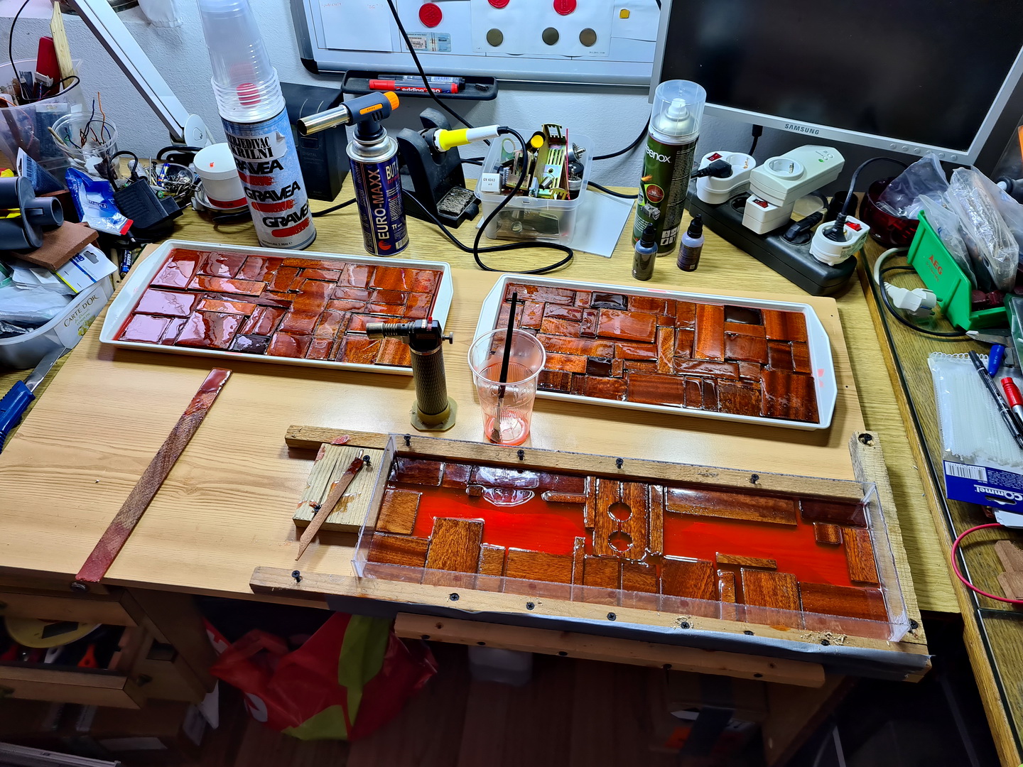

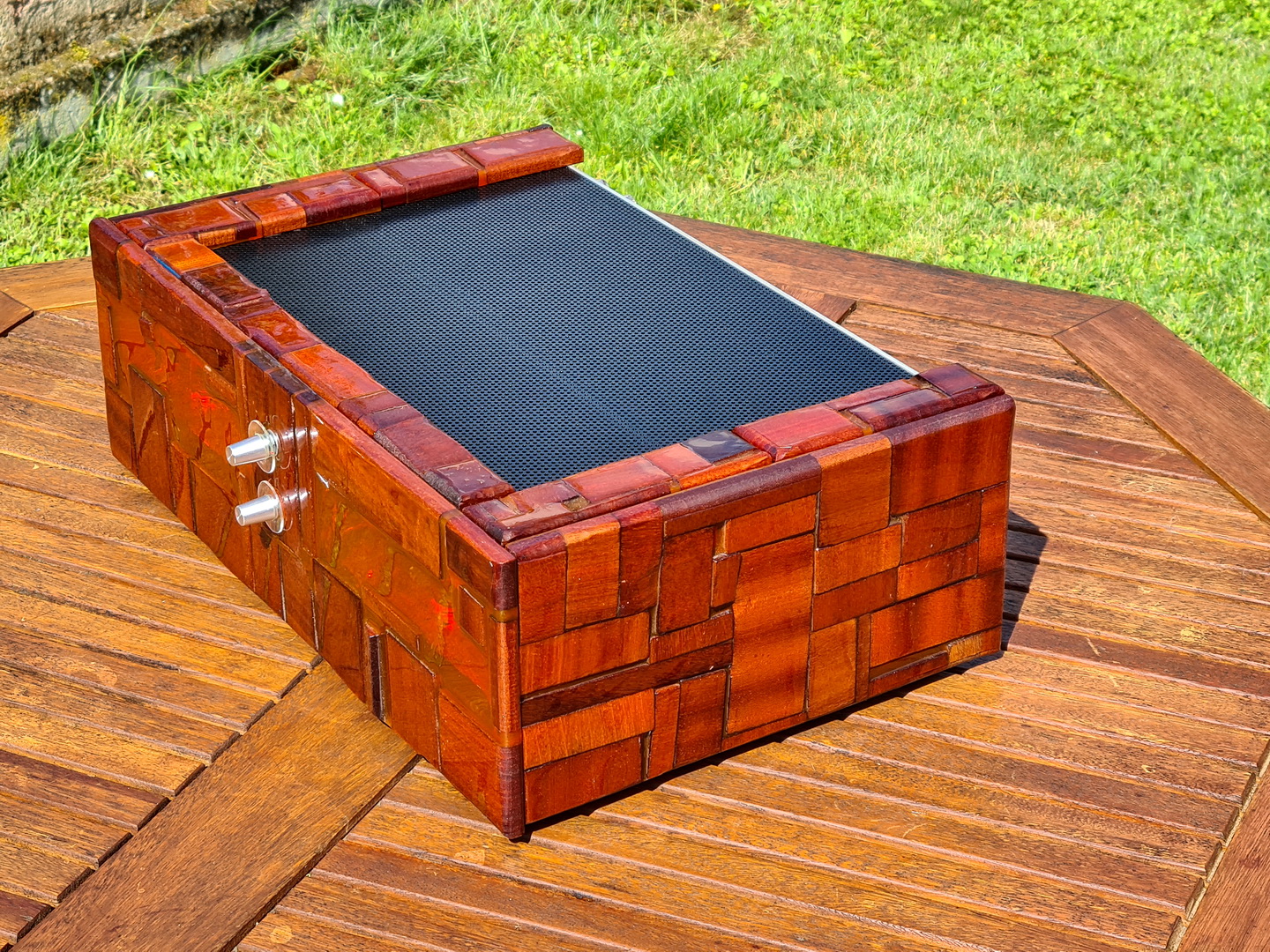

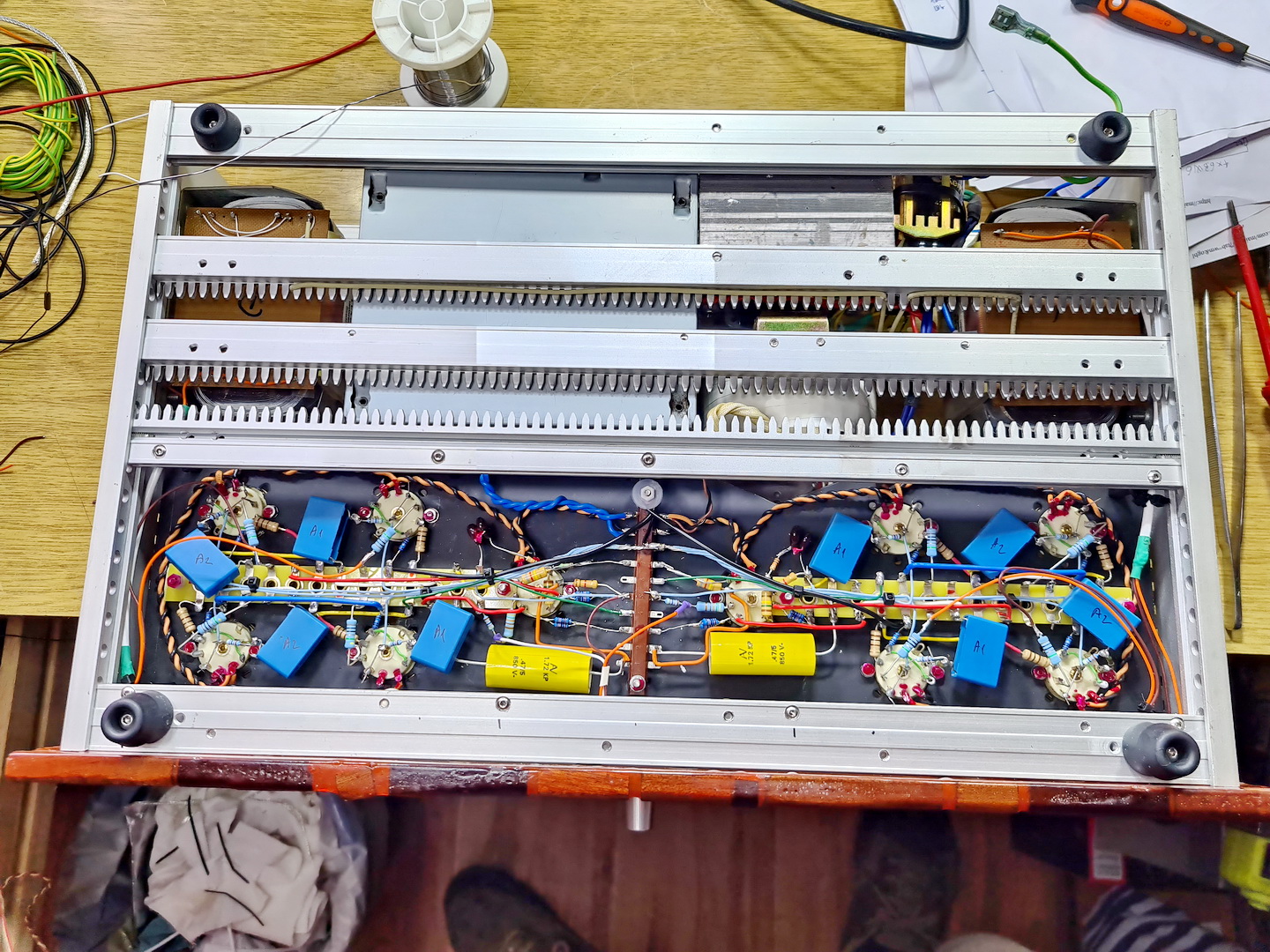

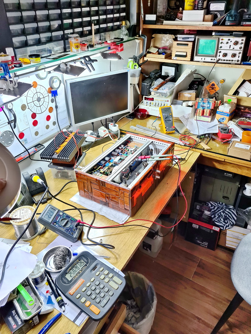

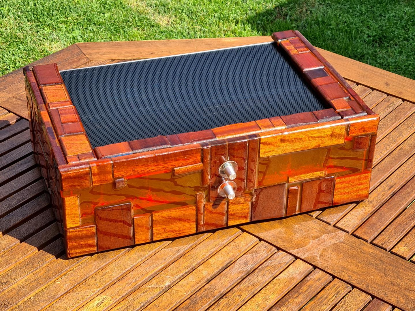

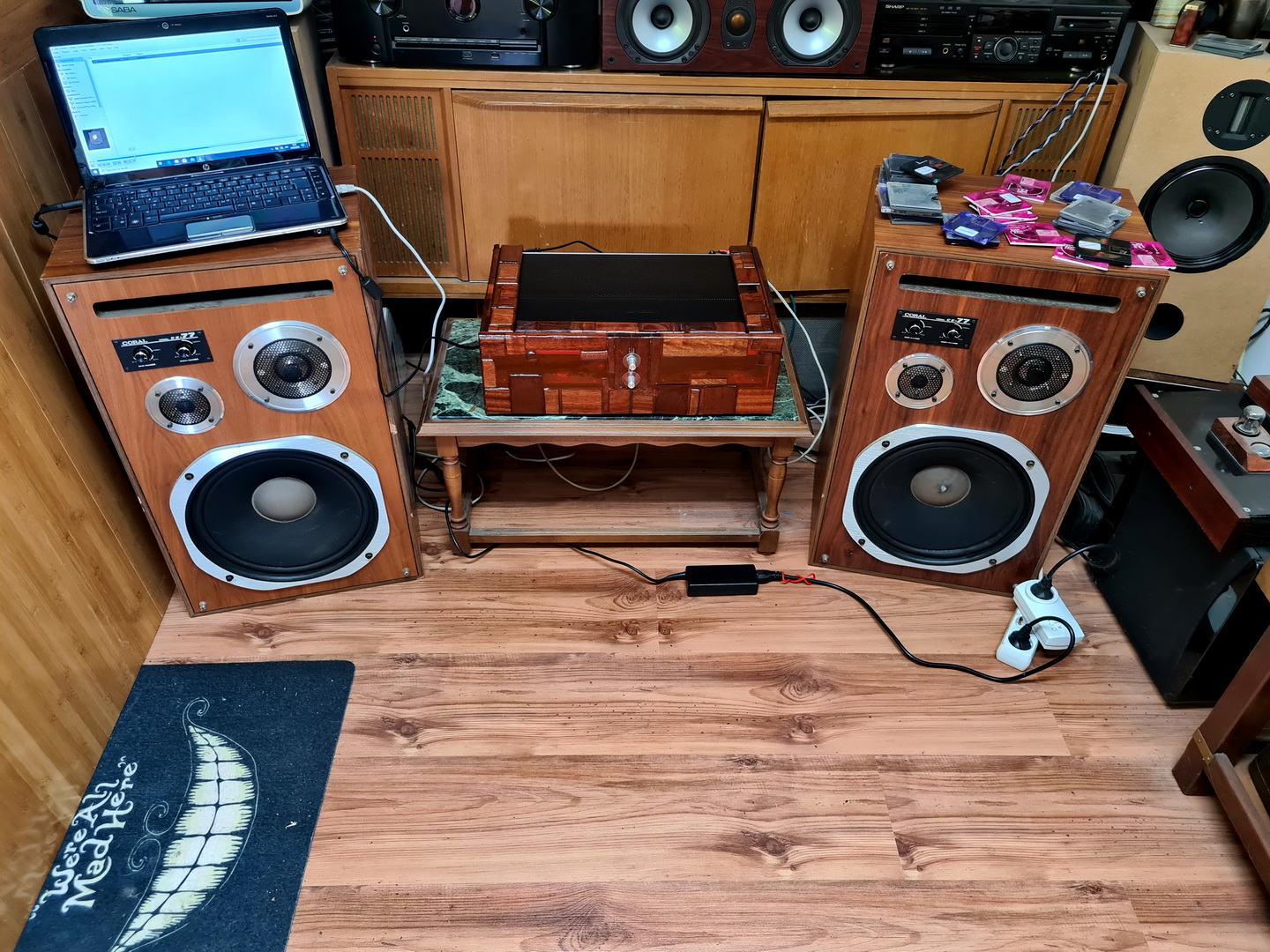

...new amp ... four CV4043 (6BW6) per channel, ECF80 in drive/phase splitter... Lundahls output... wanted to try the wood/epoxy combo, looks a bit turtle-ish but I like it... runs pretty hot though.... me happy
