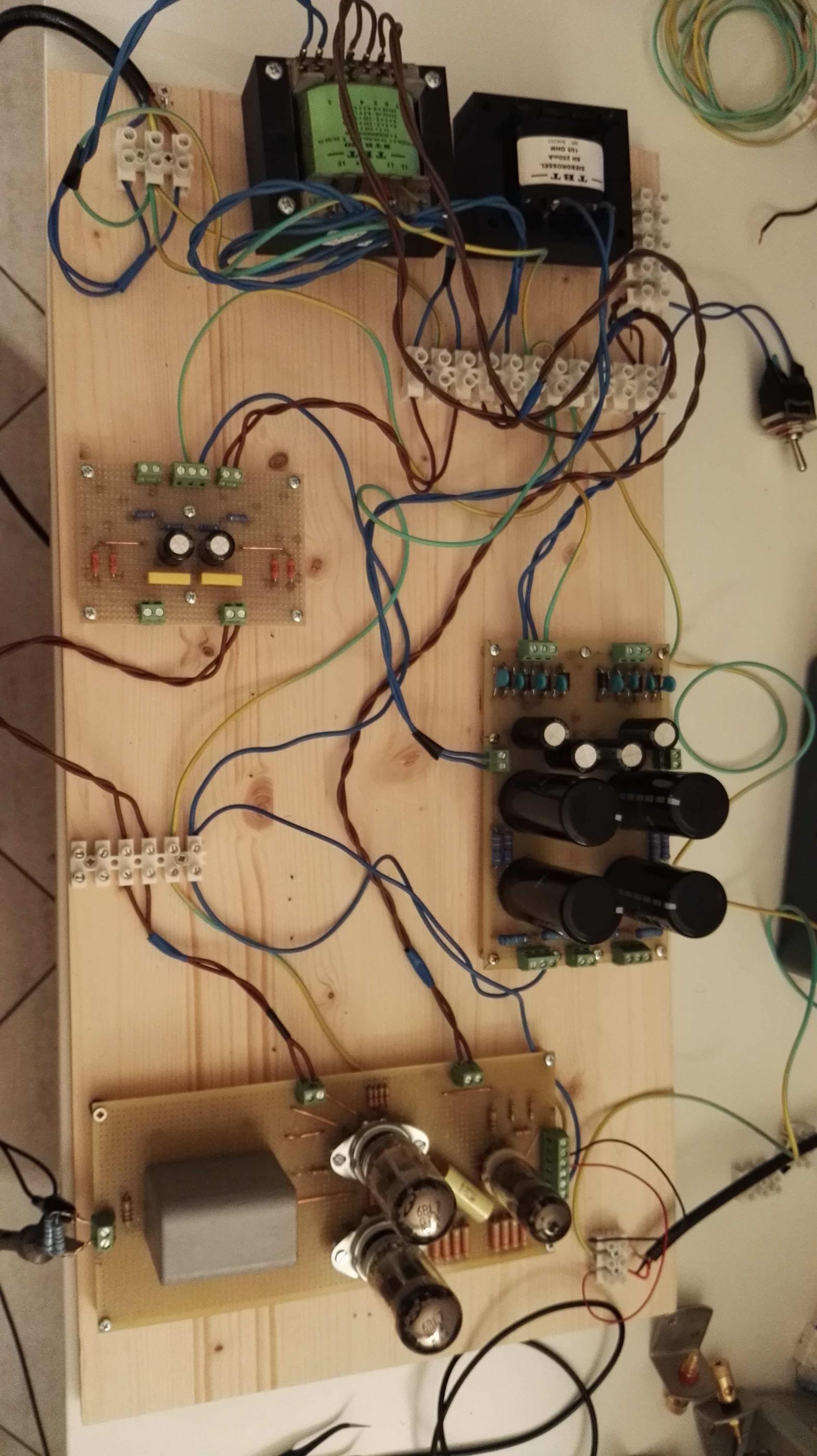

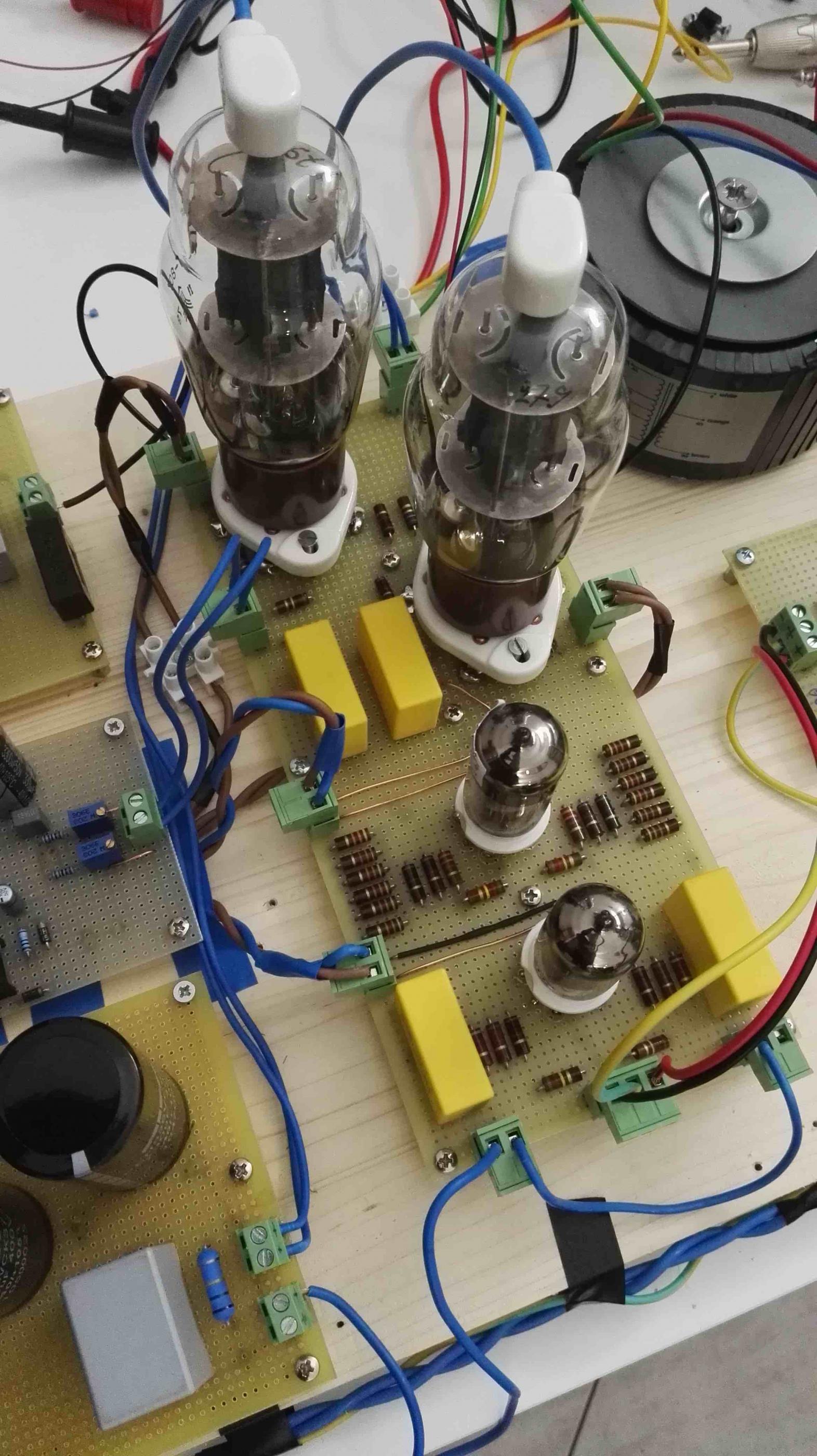

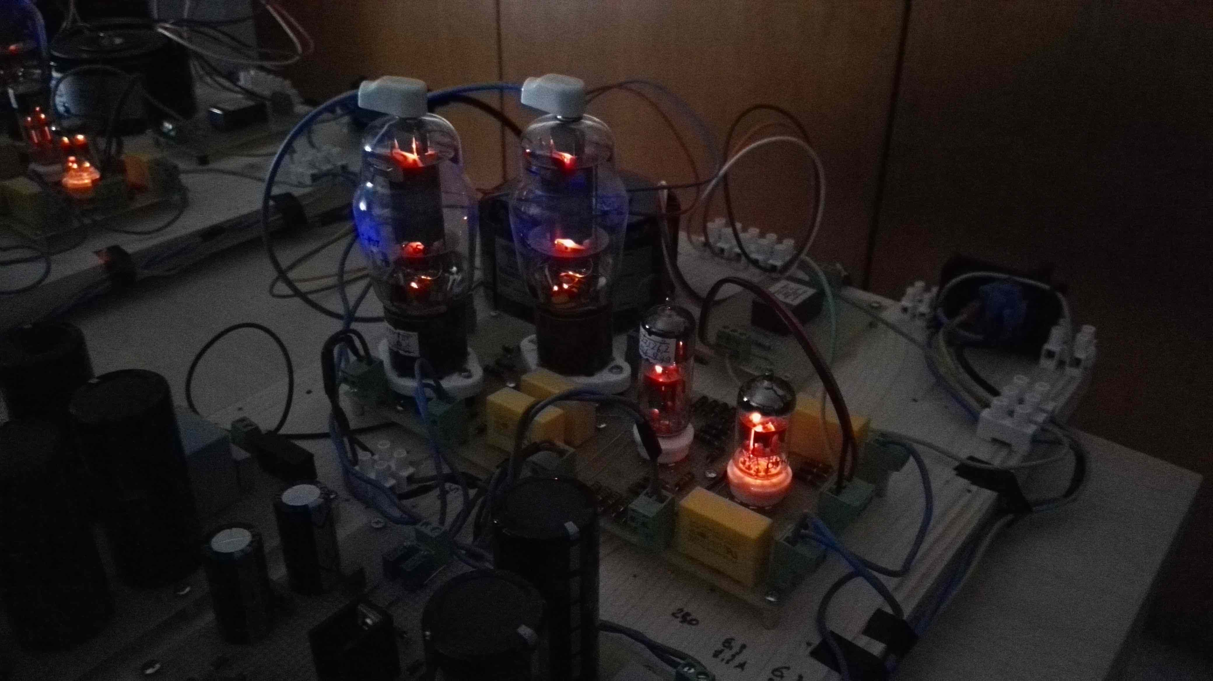

This is the final prototype for a 40w power amplifier.
Fully balanced configuration with Lundahl LL1540 input, 6N1P input, 6N6P driver and G-807 with toroid output transformer.
Power supply separated for input - driver and power stage with inductive filter.

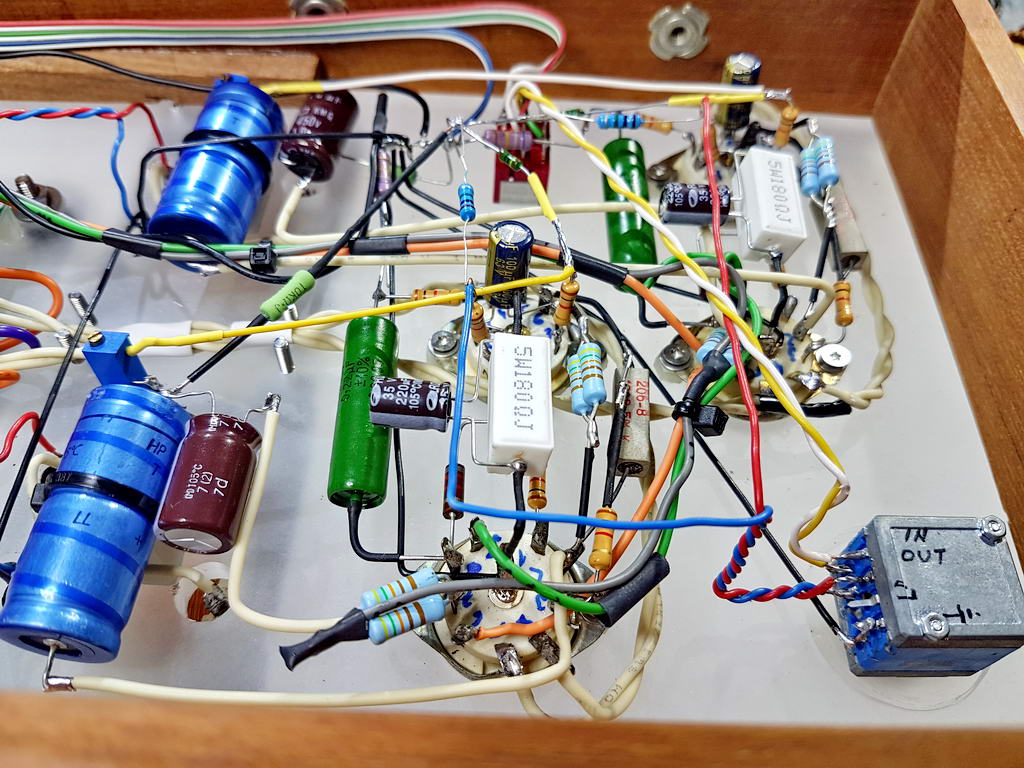

My PSE 6AS7 General Electric and 6J9P. output power more than 9 W per channel, pure tube amplifier, all components are only R,C,L, without pressing factors FBs and SS in amp. tracks, /Shotky diode rect/. Structure is two monoblocks in one closure. Two PTs. Common are wall AC PS and ground wire.
Nice, Azazello. Care to share your schematic for the PSE 6AS7? I'm in the process of working on a PSE 6AS7 and would love to see what you came up with. More importantly, what are your impressions of the PSE 6AS7? It's not an easy design to do well, from what I can tell. And parallel SE output tubes sometimes get a bad rap due to muddy sound and other issues.

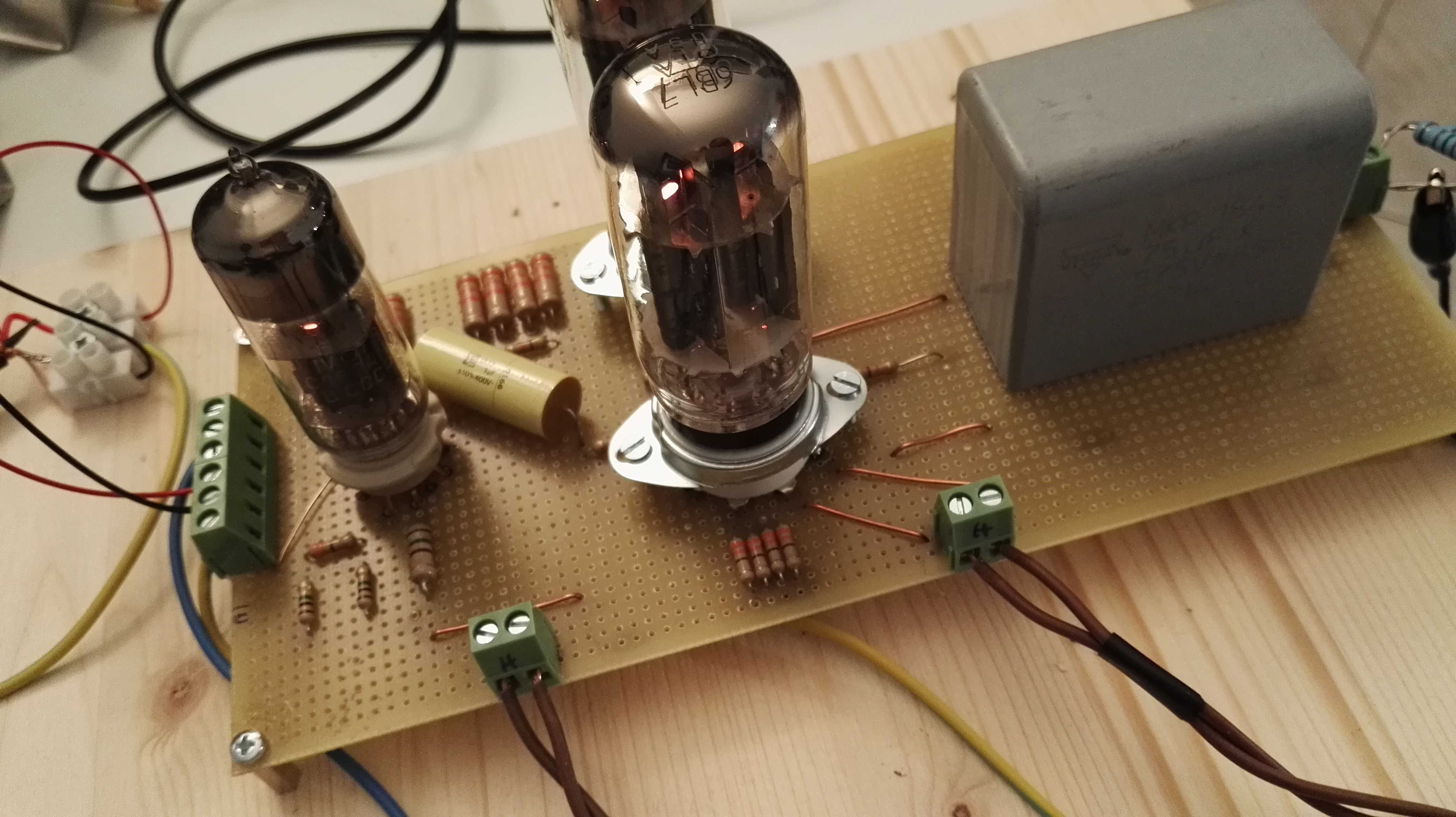

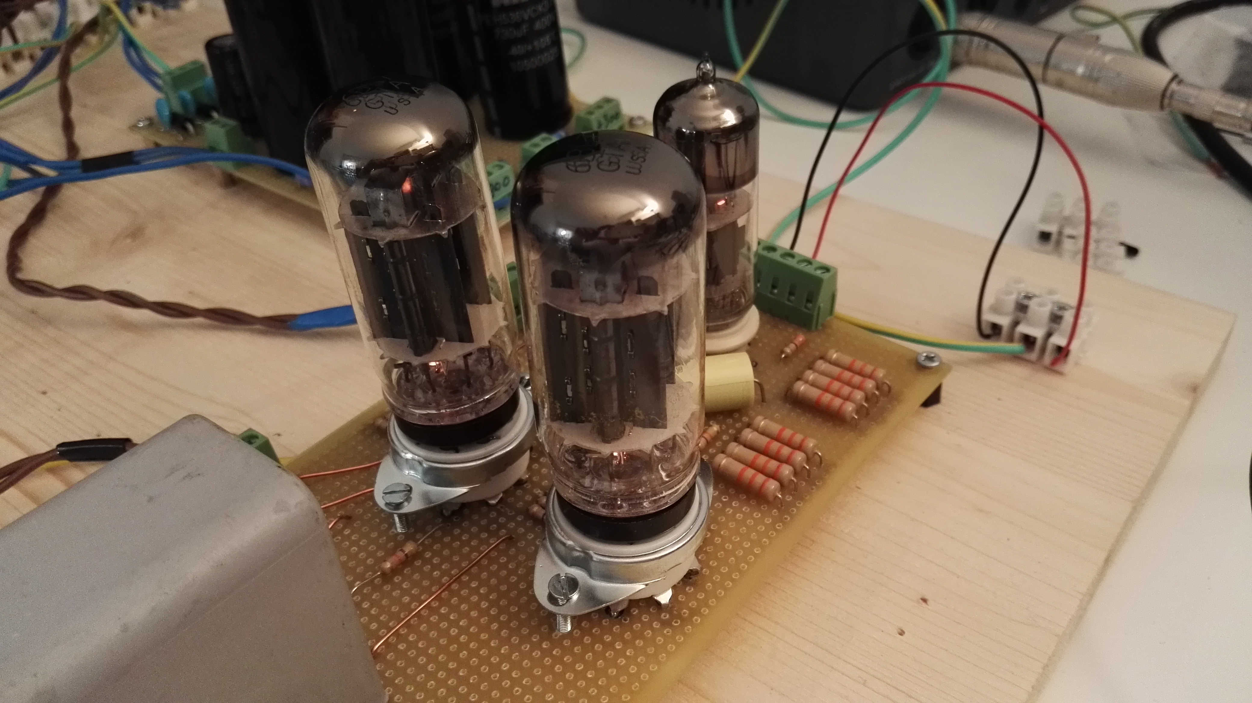

OTL headphone amp first test.
6N6P differential input 6BL6 paralleled broksie buffer output.
The amp is intended primarily for 300 - 600 ohm headphones but should be strong enough for 32 ohm too.
