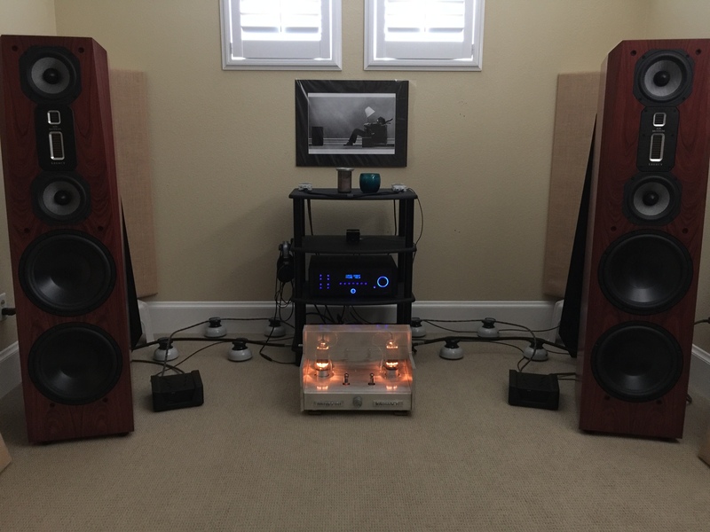

I am still alive :)

Hi sir anatoly, i have in me 2pcs of this tube from a russian friend. I plan to use them in a monoblock pp for sub around 200watts. But with your project i m thinking of a stereo SE amp like yours. I also have 6p15p tubes to drive. How i hope to build one like yours. What imp of opt u use? Thanks.

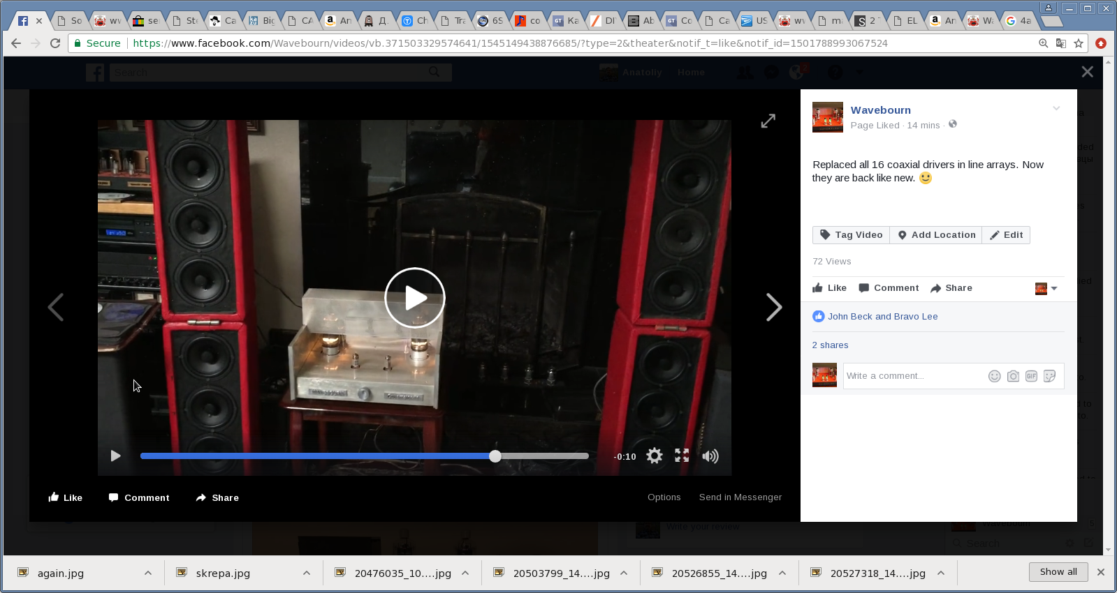

What is that humble amp behind the big boy?
Just a row of 4 FL-152 tubes on a perforated aluminium sub-chassis for 2x100W PP amp.

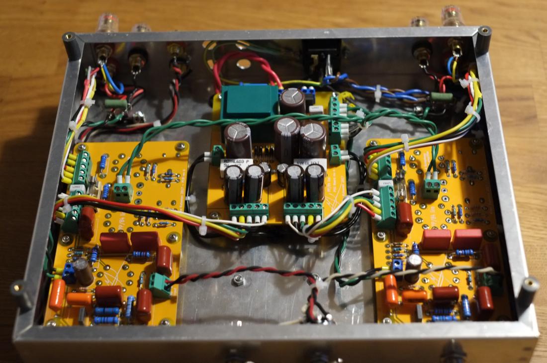

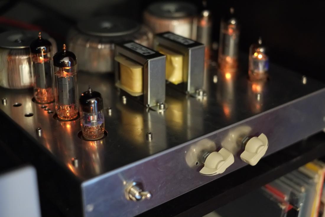

My latest creation: PP/84 Iiro. Nothing different, new or special. Just a class AB push-pull in a very traditional configuration, with a 6U8-A serving the voltage amplifier and phase splitting duties, and a pair of EL84's in ultralinear mode as the outputs, 12dB of GNFB. Bias is fixed, and the output tubes have a balancing pot. Not very unlike a Dynaco ST-35, then. Output power is 12 watts just before onset of clipping, and THD+N at full power is 0.78%, measured with AP System One.
The output transformers are from my old stash, made here in Finland and sadly discontinued a long time ago. These OPT's had been collecting dust for like ten years on my shelf, and I wanted to give them a new lease of life.
Power supply is CLCRCRC with a separate LCRCRC-chain for each channel. From previous experience I wasn't completely comfortable with the thought of using just a cap filtered supply for a push-pull output stage, so I gave both 'em channels a choke.
Wiring turned out less messy than I first feared, even though not up to the highest standards. Still have to finish the chassis, but having only tried this idea on a single channel lab prototype, I wanted to hear how this thing sounds in stereo before touching up the metalwork with paint, aluminum front panel and wooden sides.

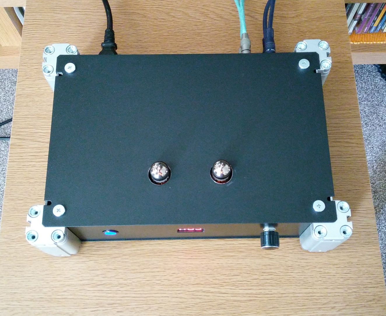

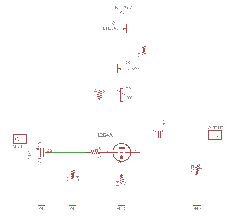

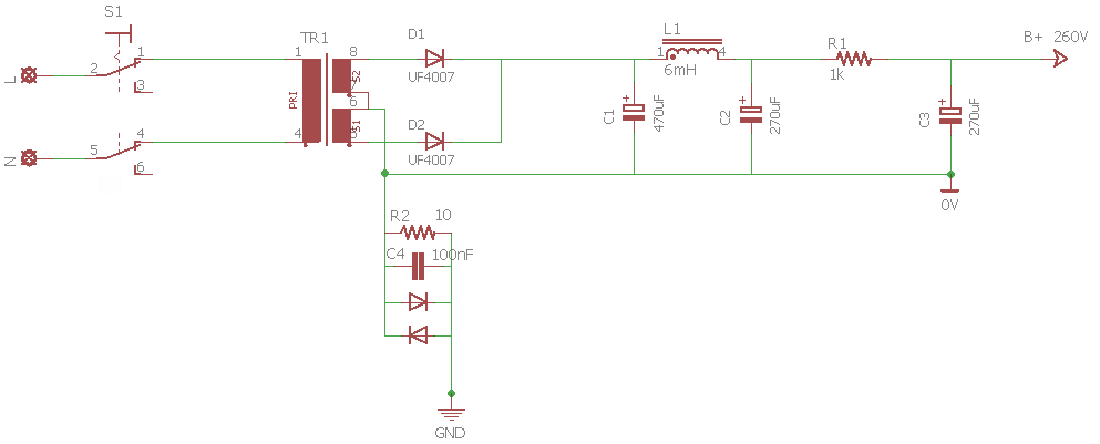

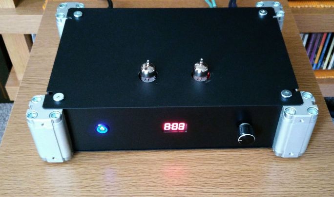

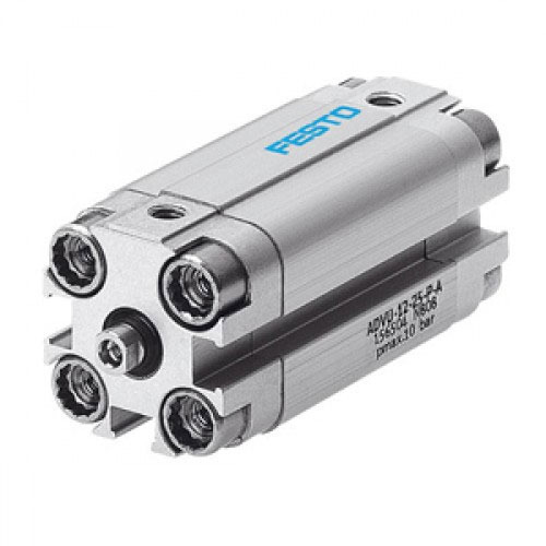

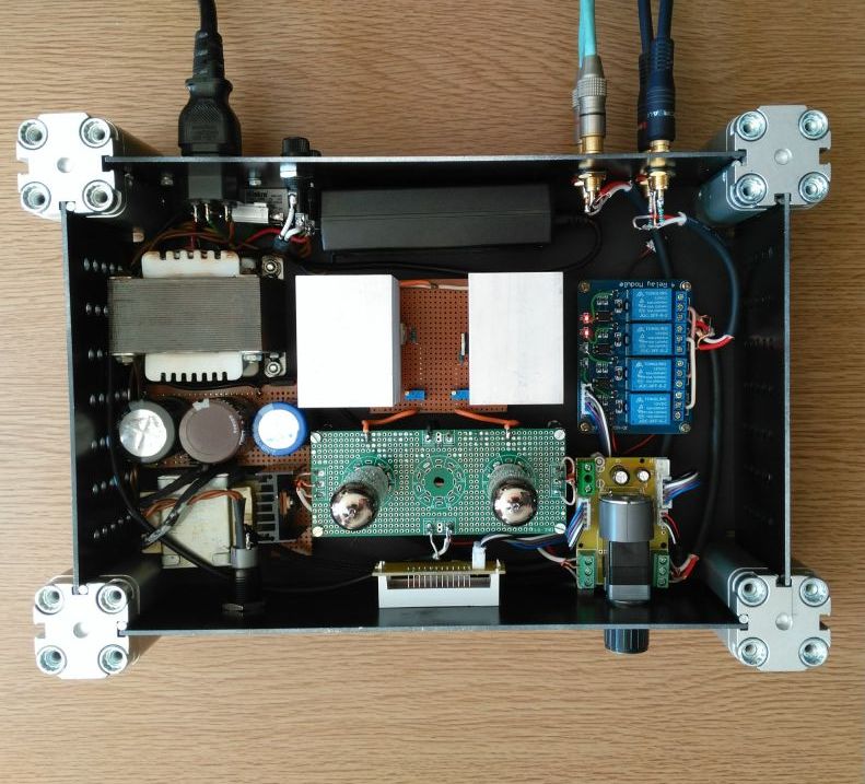

I had a couple of old Festo air cylinders which looked just too nice to dump, so I decided to build a preamp with them, the Fest-O 12B4.
This is the result. I 1st tried a LED CCS, which caused a lot of hiss noise. A straight resistor was dead quite but the DN2540 sounds the best (just a small amount of hiss)
Even with relative large heatsinks the CCS still gets to 38°C, which is acceptable to me.
Together with my Mullard 4-20's, and Fostex FE207's they sound fantastic. ;)

I recognise the motorpotentiometer, but the relayboard - your? or eBay-ish?
can you hook up the aircylinders to the amp and have the chassis wiggle to the music?! :tongue:
Realy board also eBay. Had it left over from another project, it uses spdt relays, thus I use 2 for stereo in/out. One set is for CD and other set is for an aux. source.
Maybe I should connect some smoke to the festos for some effects. :D

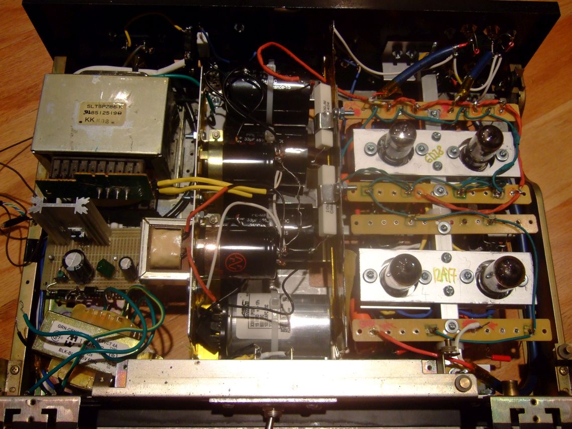

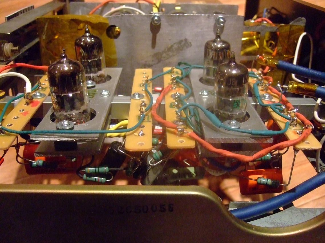

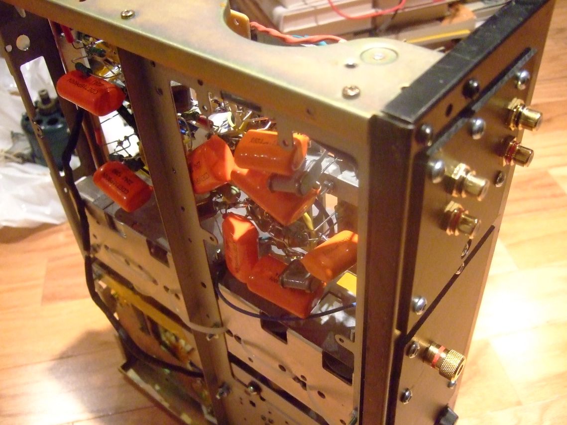

My PSE 6AS7 General Electric and 6J9P. output power more than 9 W per channel, pure tube amplifier, all components are only R,C,L, without pressing factors FBs and SS in amp. tracks, /Shotky diode rect/. Structure is two monoblocks in one closure. Two PTs. Common are wall AC PS and ground wire.
