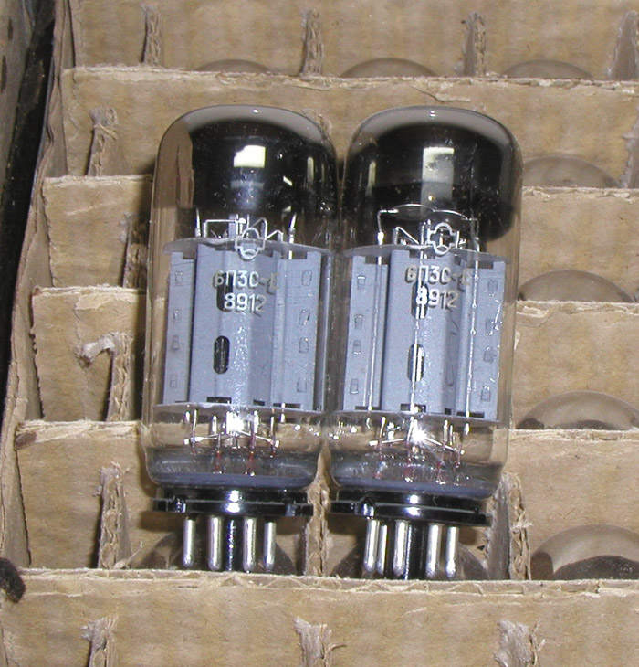

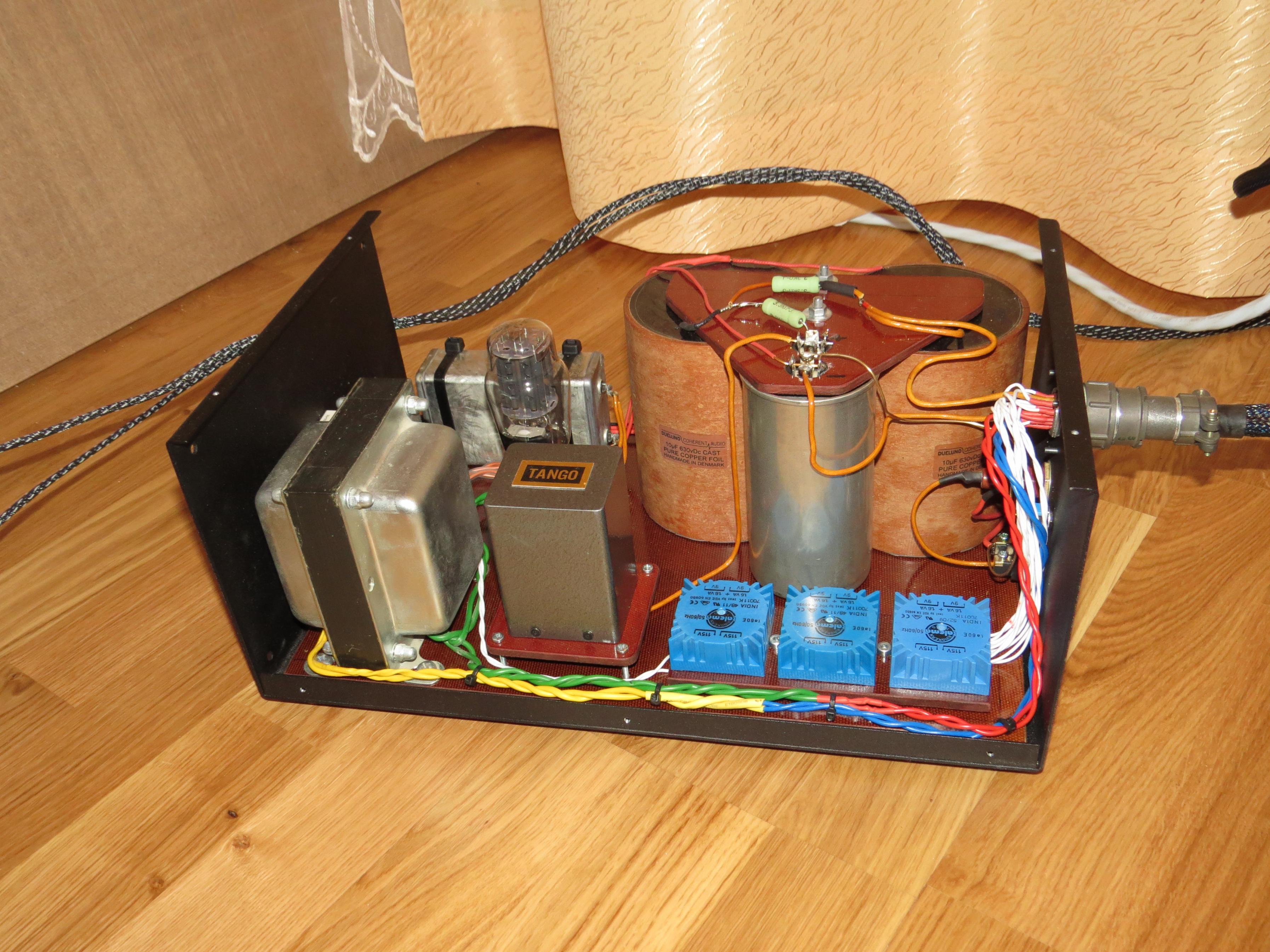

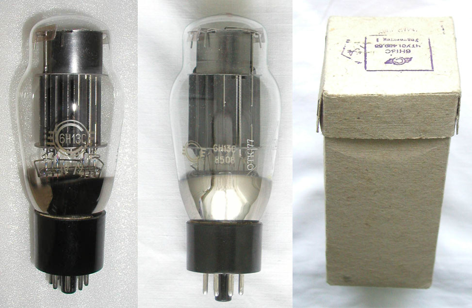

I have both curves, 6H13 and 6H5 they are not the same envelope. One is soviet the other Chinese.
The first is the 6AS7G, the other is similar in the aspect is 13watt, same Rp.
You can ask to atmasphere member, he has a lot of experience with this kind of series regulator valves.

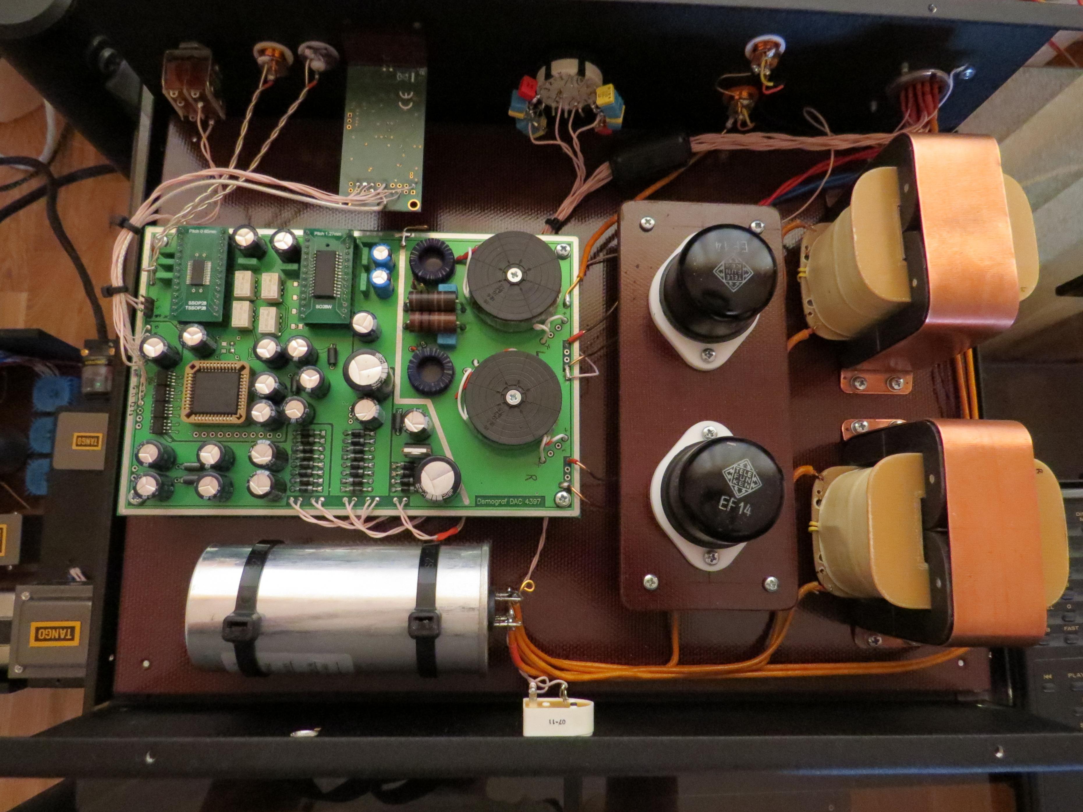

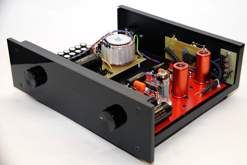

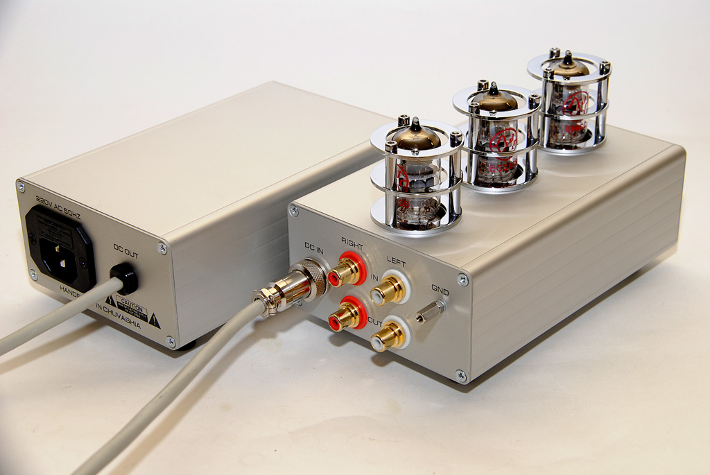

Fine construction Dimitri, could you explain what is the board in the preamp?
Best Regards
Best Regards

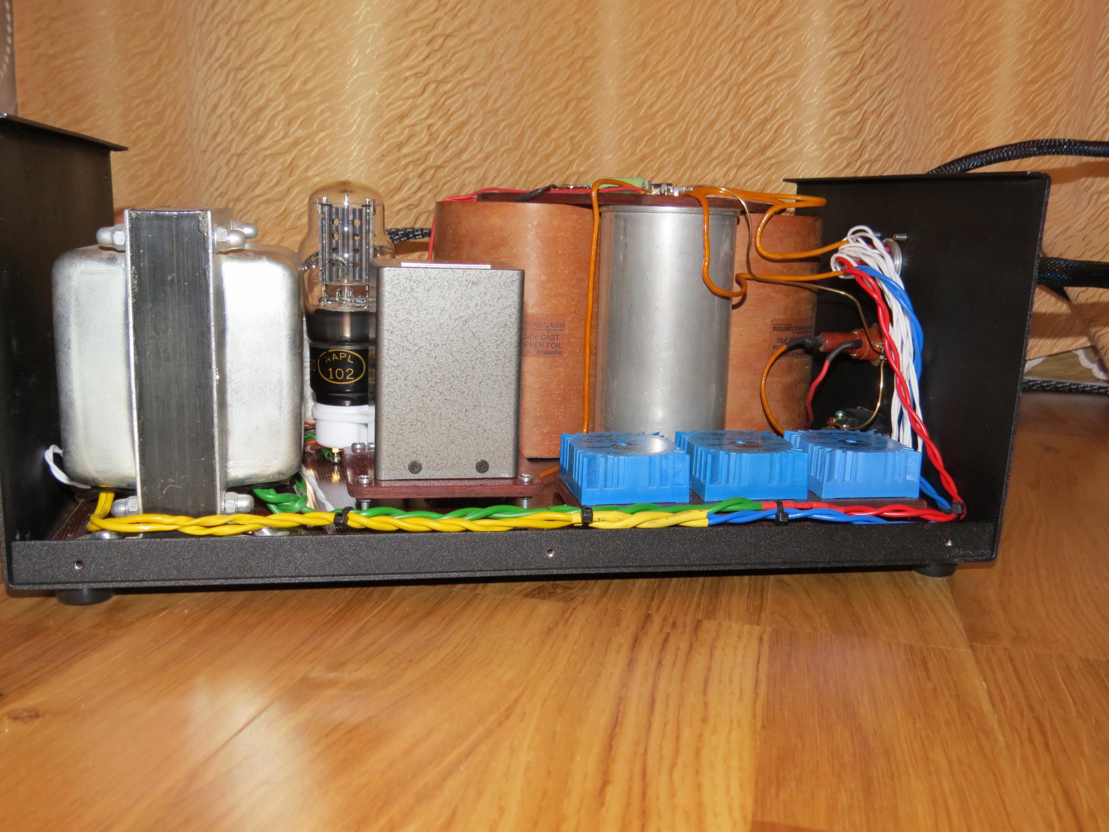

It not in front of the amplifier. This is the amplifier of power for earphones. the first cascade is made on entrance transformers which do a signal balance.the second cascade is made on 6H7C double triodes and on an exit stand 6H13C with output transformers under different loading.straightening works on two parallel 5Ц4

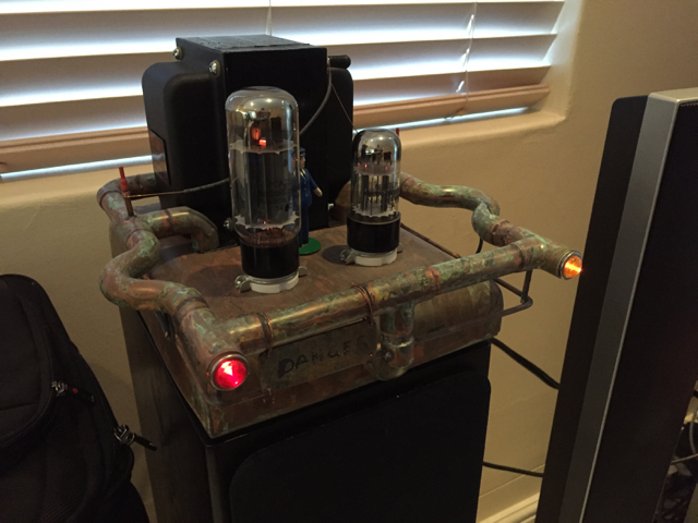

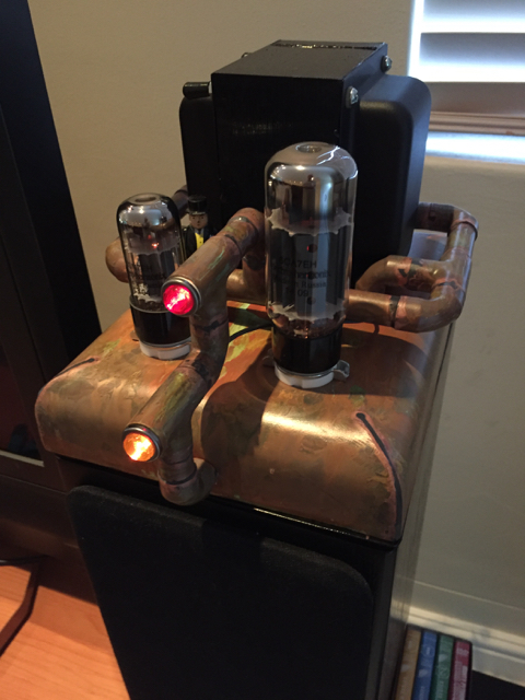

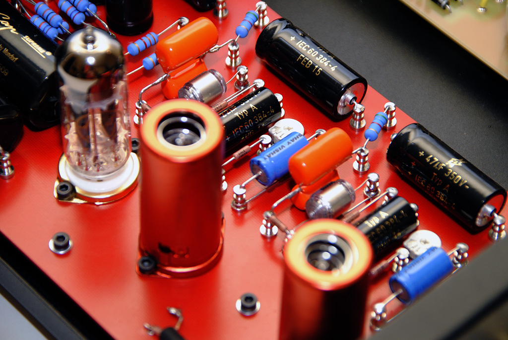

Just for fun: A set of SE mono blocks that fit on top of the speakers, no FB, conventional dual PSU. PSU switch is a key switch with off, filament pre-heat (2.5V), and HT/Filament on positions. Indicator are orange for filament volts and red for 6CA7 bias current. :p
Very nice build!
A little advise
You should remove your amplifier from the top of your speakers, those tubes will be grateful to you especially if you drive the speakers at least at medium volume
Tubes does not (happy) likes resonation :):D
@ djn - IMO they sound great, particularly for female vocals and individual instruments, surprisingly good low end & more than enough power for my needs!
@ gaborbela - thanks for the advice, I did not think about that! (but the volume is pretty low (no more than a few 100 mW...) and the speakers are quite solid) but I may well move them...
