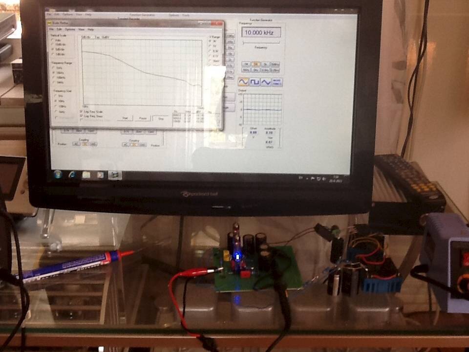

Is this the kind of harmonics you looking for?
I cannot tell, without knowing the scale.
Anyhow, the higher harmonics are quite prominent, relative to the second.
At what output level the measurement was taken? How much down are the second, fifth and seventh harmonics referenced to the first?

2nd harmonic at -50dbV
5th at -55dbV
7th at -60dbV
But this is with 4 triodes in the MM stage.
The noise is referenced to 0dbV.

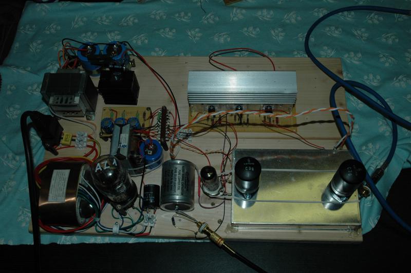

This is the breadboard prototype (see one channel).
There are too much hum and noise (from PSU). Separated PSU (and maybe Salas SSHV regulator) and metal box are necessary.
Referenced to what output level?
5th at -55dbV
7th at -60dbV
The fifth being 5dB and the seventh being 10dB below the second is a no go for me.
How does it look in the all tubes MC/MM phono stage that you referred to above?
Before you'll put it in a proper housing and before you'll sort out the noise problem, neither you nor me can possibly know how it may sound – both in itself and compared to other phono stage(s).

Output level was 2Vrms
I use 6 triodes in the complete MC/MM stage.
I have also Project tube box 2 se, phonedude and several opamp based phono preamps.
For me it sounds like a tubeamp, wider soundstage and fluid sound, a complete other sound as the opamp based preamps. No noise no humm. Just look the thread below. There are enought great designs in the analoge source section.
