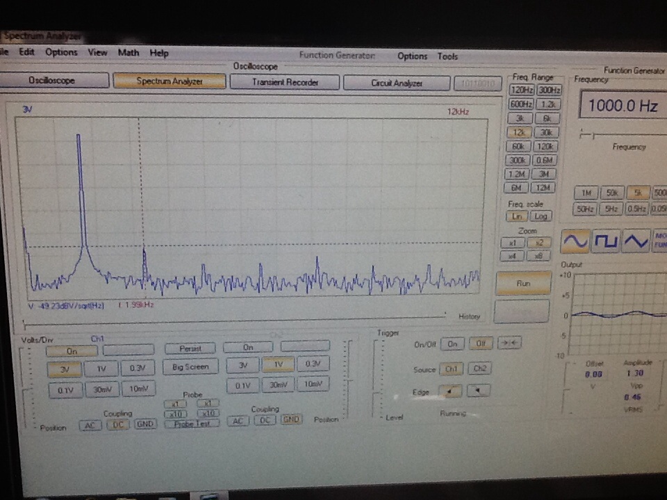

Is this the kind of harmonics you looking for?
This all tube mc/mm phono stage has tubes with very low millercap.(25pf), very low noise (-80db).
