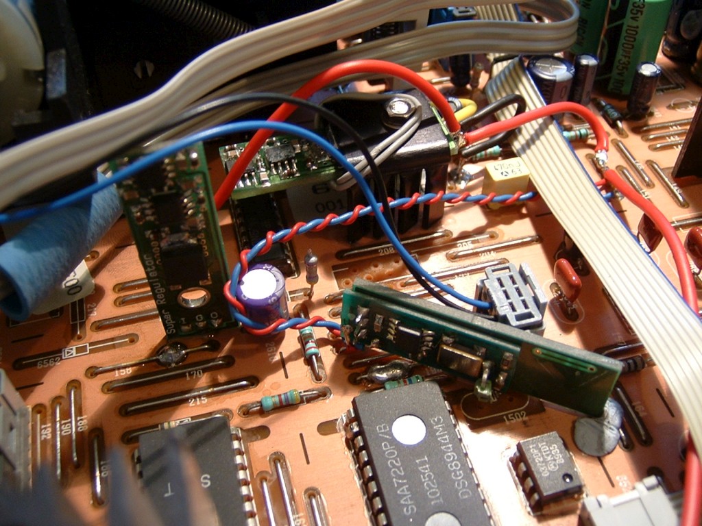

Just changed the -15V LM337 in this Alpha for an S Power - huge improvement. It does in turn feed the -5V reg and it also powers all the op-amps I think so it's affecting lots of areas. They're very hard to fit in with decent heatsinks, lots of tweakery needed!
If the Alpha 5 is anything like this the standard regulation is way better than some players so extra separation isn't as urgent as in some (e.g. CD63). You do, however, need separate regs for the digital filter and decoder. It doesn't matter who has listed this or not, you just need it :)

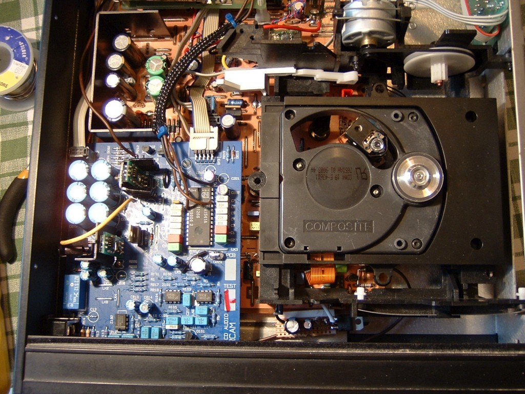

As an aside I have found upgrading those caps down there to make a large improvement in SQ on my CDM4/19 and a MASSIVE improvement on CDM2 (Philips CD650). On the latter I used Rubycon ZL and for that electrolytic filter cap a 1uF polyester box cap. I've put os-cons on my CDM4/19 (Arcam Alpha) plus some decoupling caps for TDA8808/8809 (missing in standard player). I did the same for 4560D (motor drive op-amp) and TCA0372 (focus drive/radial arm drive) dual op-amp. I put an os-con on the laser output and on the Vref decoupling on TDA8809.
A tip for anyone doing the same is make sure the mech will still fit afterwards. The arm needs loads of room to swing round. I had to mount most of these caps flat on their side.

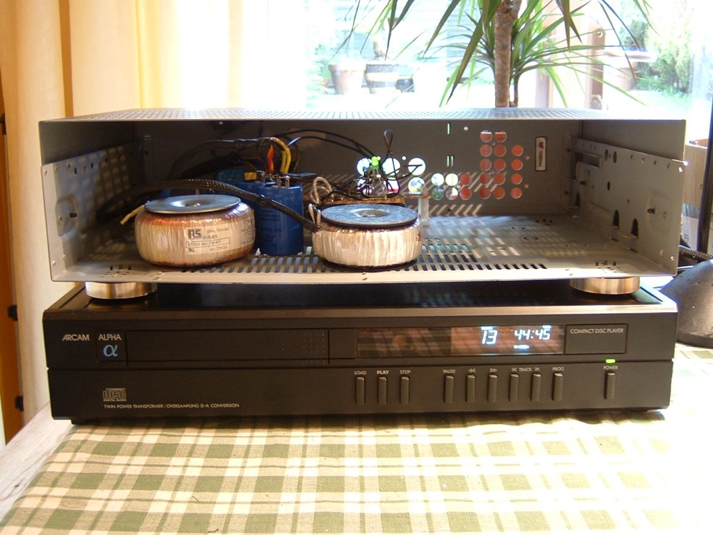

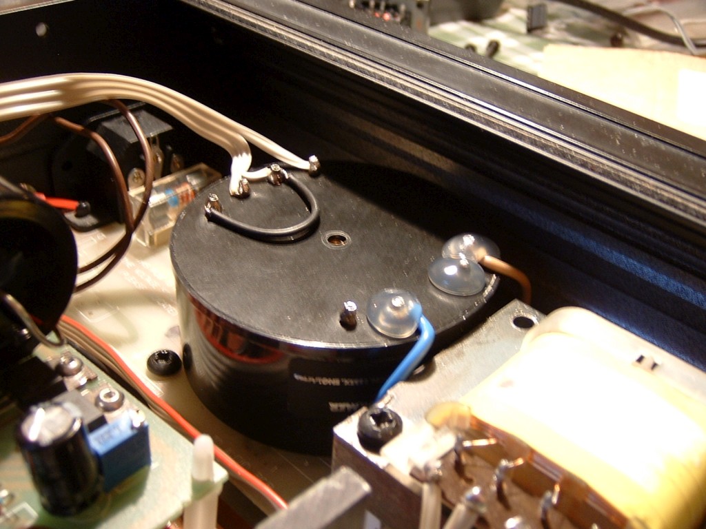

Arcam Alpha
The mods on my Arcam Alpha are getting fairly interesting. I'll start a new thread on it soon as I've not seen any of these with serious mods before.
Simon
