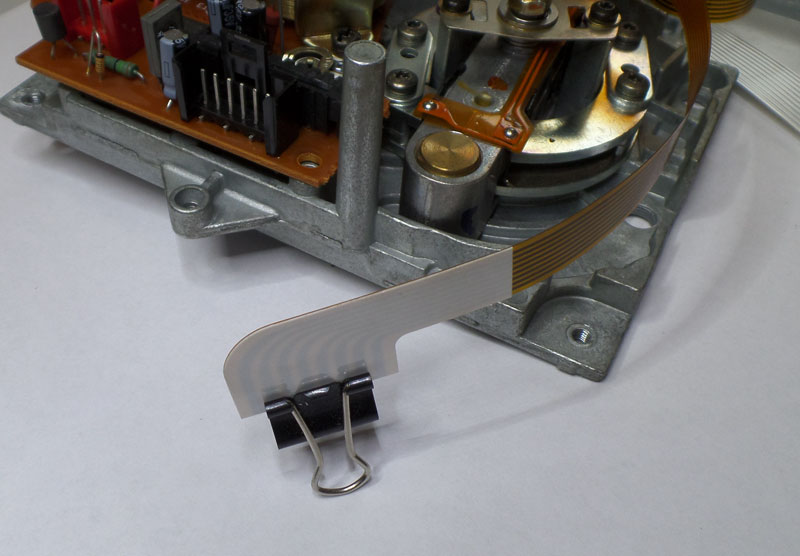

Some devices fail to work for a few weeks after such work. The death of the laser is often a slow process and sometimes does not happen immediately. The reason is electrostatic discharge during the work. The laser diode is the most sensitive component in the CD player. Synthetic clothing and dry heating air in winter is enough. To a certain extent, the charge can be discharged when the relative humidity is above 55%.
I only work on the CDM at an antistatic workstation, which is connected to the ground of the power supply. My wrist is also connected to this grounding. As I said no synthetic clothing et C. Close the end of the flat cable with a metal clip after disconnecting it. Makes of course immediately a defect if the device is still under power ...
To the capacitor question before, there I find the hint "Any capacitor that fits in there will do..." dangerous and stupid. I advise to use a reputable capacitor quality. And since even capacitors are counterfeited, to get them from a safe source. That such a capacitor 105 ° must be is nonsense. This says nothing about the quality. A capacitor with the imprint 85° can have a higher quality and temperature stability. This value must be considered in conjunction with the specified life at the specified temperature.
Otherwise here are a few tips: https://dindiki.com/?cdm1-laser-service

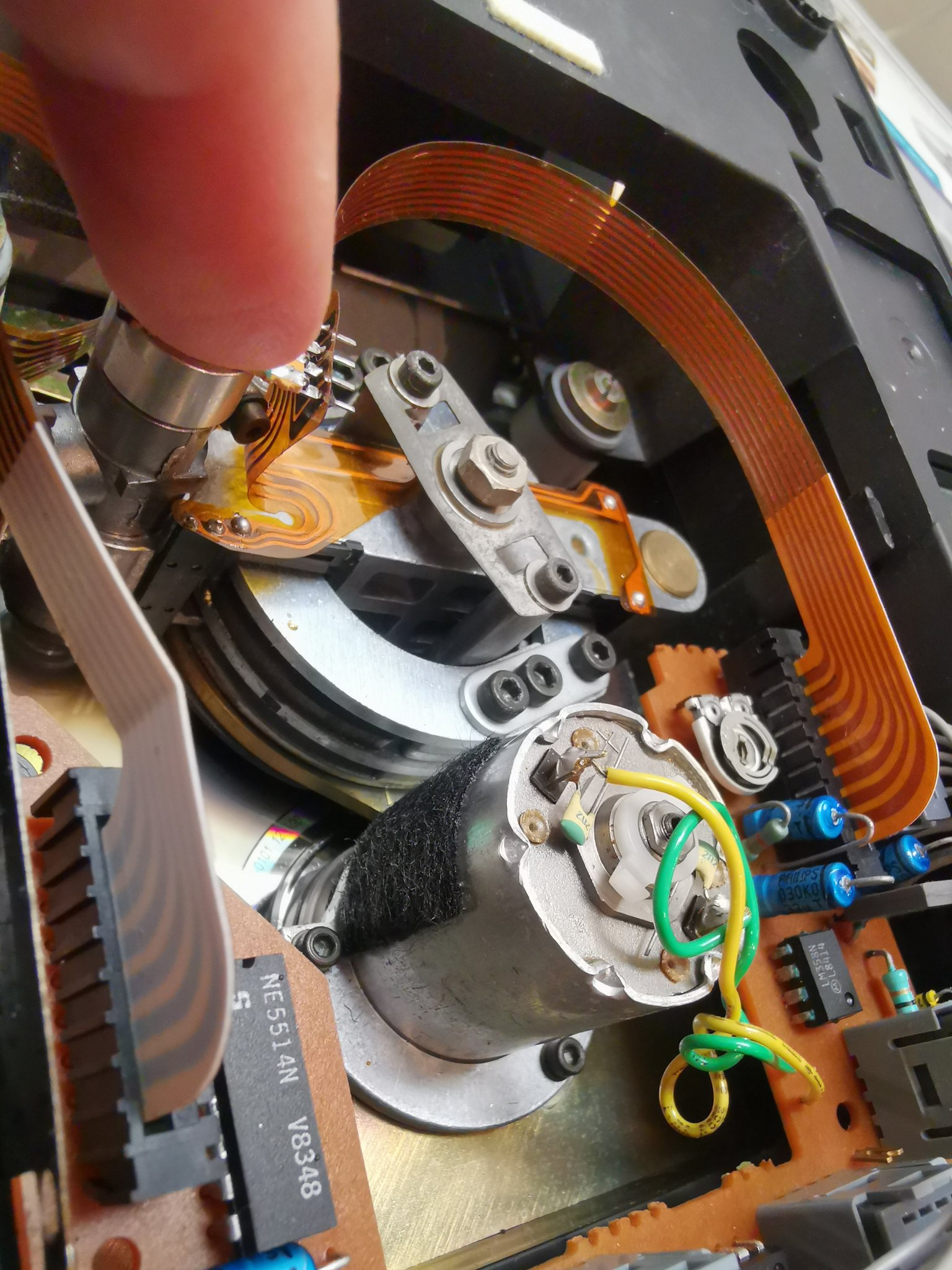

Hello guys.
I Have a CD104/00 With CDM0. All graplets are done with wire. Electrolytics on the servo board are done, and all electrolytics in the powersupply are changed to Panasonic FC.
As you see on the pic i just forgot to order those electrolytics on the focus board, will do it.
The problem: cant find TOC, but if i help the swing arm with my finger about 1mm out from the extreme inner it find TOC and play very nice. I did put a furniture sticker on the motor and now it works as it should, but what causes my problem?
The swing arm move really easy.
