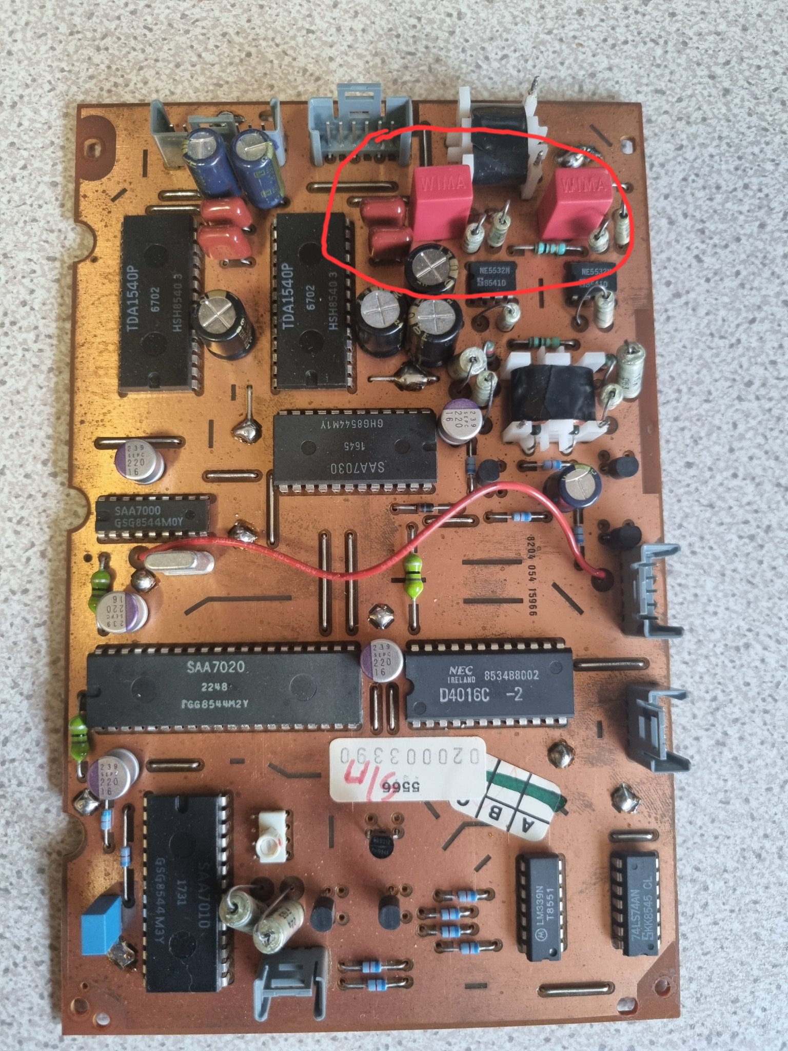

Lubricating CDM-0 drive and RAFOC motor spindles
This is an overspill from an actual lengthy track on troubleshooting a skipping CD-204 (see here: https://www.diyaudio.com/community/...ars-after-rebuild.394489/page-10#post-7251601).
Fully recapped (mostly 2020) with quality caps on all boards (including tantalums on servo board), through-board contacts re-soldered with wires, transistor 6118 replaced. Great RF pattern (about 1V peak-to-peak).
Skipping forward, unlistenable.
After suspecting an electrical problem without good results I put two tiny drops of motor oil into the groove on top of the motor spindle. Immediate improvement. Listenable again, but skipping not totally cured yet (skips on some CDs at some times, does not skip at other times for hours).
I have two questions for the CDM experts:
  1. How can I get the spindle/shaft out of the CDM-0 motor in order to properly lubricate it?
  2. Can I get the shaft out of the RAFOC in order to lubricate it (wish to loosen the nut on the underside and pull out the shaft just a little bit) WITHOUT needing to re-align anything?
I hope after a proper lubrication my problem will be cured.

I have not seen any CD104 with the CDM0.
I do not know the reason for the assembly of this transport model, if it was done by a previous owner.
Oh but you’re wrong!
Many very early CD104 used a CDM0-type brushed motor, it is most definitely original. Not really an original CDM0 as found on the very first CD100, or at least a slightly simplified one, with a CDM1 platter and clamp, but not yet a CDM1 either!
