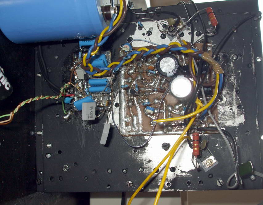

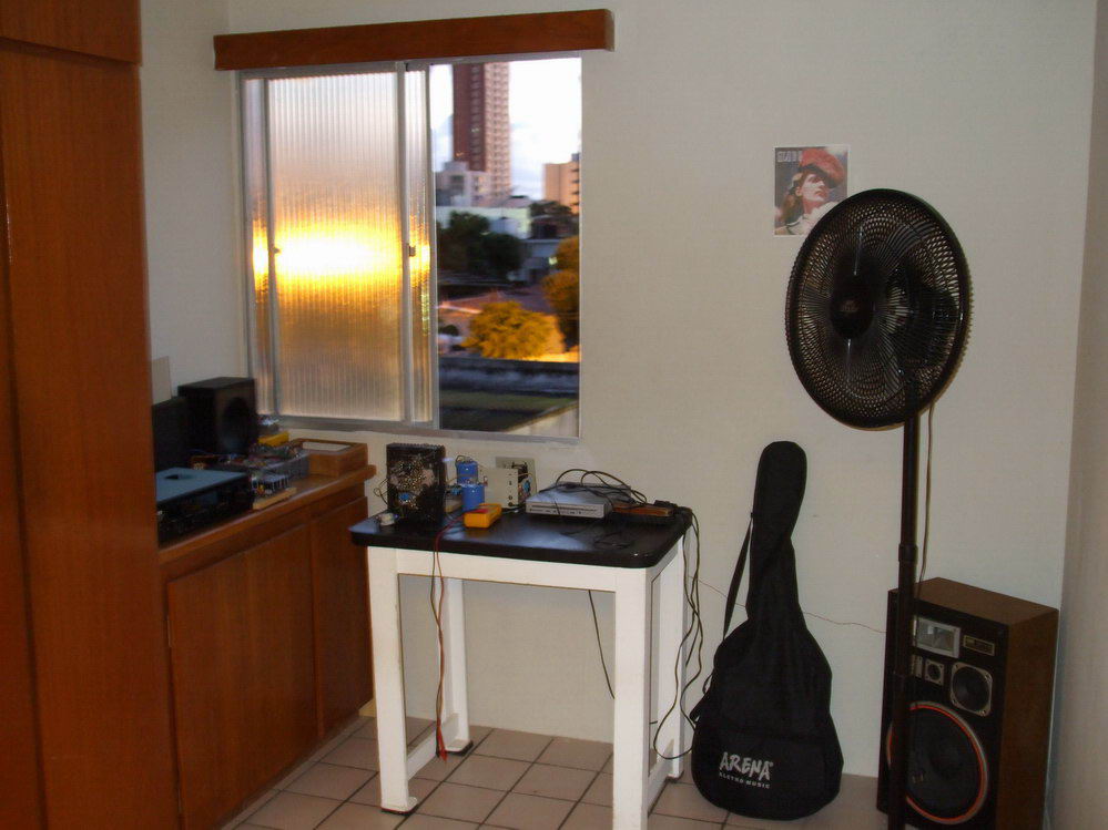

The amplifier, Circlotron modified....more Circlomanen than Circlotron
I do not loose time to build pretty things...i want to listen and to tweak for sonics...if really aproved, then i will think to produce boards and to assemble something less ugly.
Not made for beauty contests.... this is a real man amplifier.
regards,
Carlos

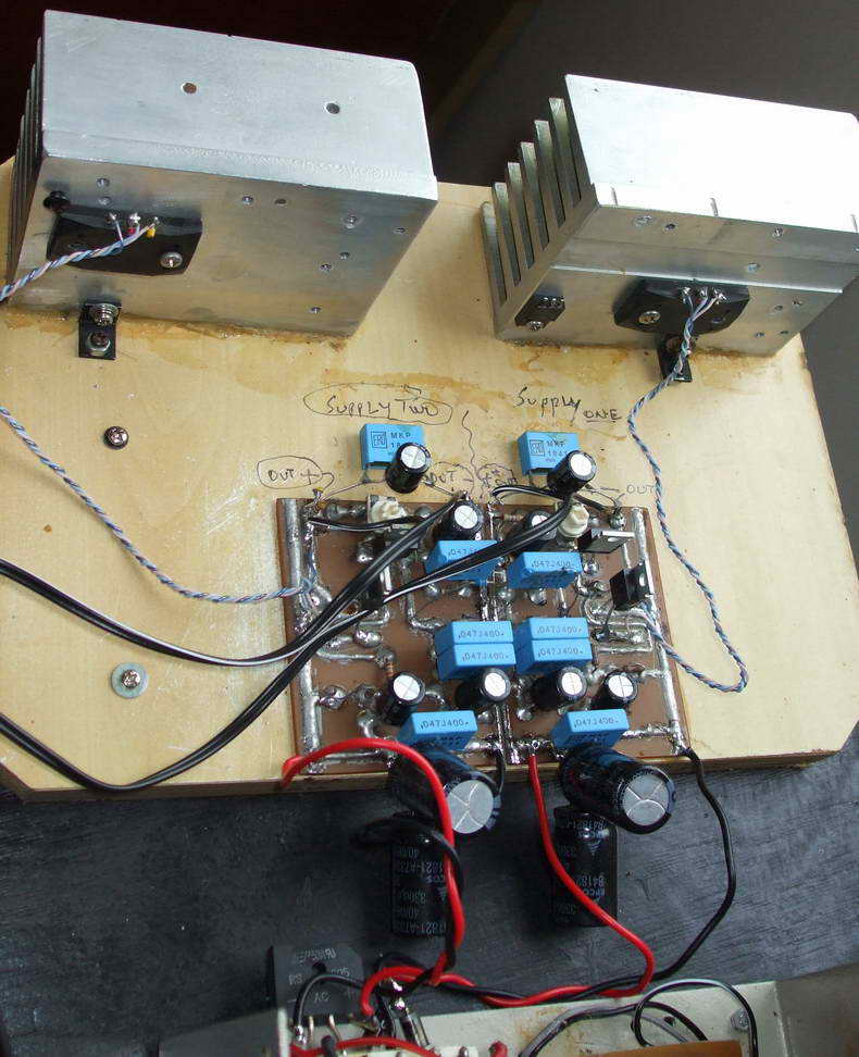

This is the Electronic, adjustable, stabilized power supply
It is a very old design from Ampex Video Tape..down the seventies...three transistors , one zener and some resistances... a trimpot to adjust voltage... some condenser to filter and to behave alike a capacitance multiplier... stable, around 5 percent losses of voltage...i am entering with 36 into one regulator (they were splitted..cutted into two halves to avoid common ground) and entering with 30 volts into the other.
The output was adjusted to 23.5 volts each one of those supplies.... 1.4 amperes adjusted each amplifier side.... off set is 22 milivolts.
The supply has only 6600uf each one of them into the input... the rectifier filter is this way...but the electronic supply cuts all possible ripple... the noises from mains disappear completelly...into the output i am using 22.000uf each regulator.
Works great.... i have tried 2.8 amperes and both ones have losses...voltage droped to 23.2 in one of them and 23.0 into the other... so..i have re-adjusted to the idle current (1.4 amperes) and them, adjusted under load conditions, with amplifier on, sucking energy, the voltage was the same both amplifier sides.
The input is a splitter...phase is changed from colector to emitter...then you have the audio inverted to feed one and other amplifier inputs (I hope i am doing correctly this)
The input circuit uses a single BC547 transistor... colector and emitter resistances the same value (470 ohms).... and 100K goes from the base to ground...VBE is bigger than 630 milivolts (good)... and the circuit is powered using 3 plus 3 volts battery, to simetrical supply... this is to reduce noises...the consumption there is small, so the batteries will last for monthes... the amplifier will not last for week.
regards,
Carlos

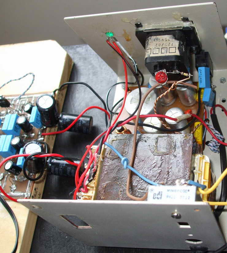

I have used the transformer normally used to my bench supply
Normally use as 36 plus 36 volts...but i have removed connections and used the 36 plus 36 that resulted 36 rectified and filtered.... three wires...two diodes into the rectificaton and the center tape as negative...so....diodes joined together i have as result a single supply.... 36 volts and zero!
Another coil, that has no connection with that 36 volts, only leaves into the same transformer, was rectified, this time using full wave bridge, because two wires coil..and them i have 30 volts.
These voltages received 6600uf of filtering each one and was sent to the adjustable electronic regulator adjusted to 23.5 volts each one or the supplies into the output terminal from the regulator..the energy to feed the amplifier.
Here is the transformer.... over it some plastic material not to have rust (not epoxi...it is something alike rubber)
regards,
Carlos

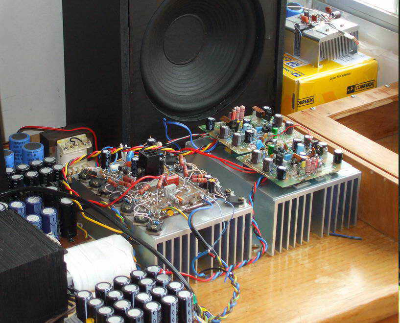

Well folks.... i go doing and doing...i just cannot stop to assemble things
curiosity is the hell of my life!
Today..or tomorrow, i will publish here the electronic supply schematic.
Very old, very good, very reliable.
Hiper Super, double Guaranteed!
If speed is good.... do not know!... no amplifier have complained to me since i started to use this...down the seventies.
regards,
Carlos

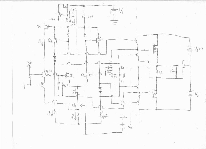

Hi Carlos
Before this thread dies and is buried in the endless pages of dead and rotting threads, I was thinking.....a bit outside the box……and have an idea to run by you. The question is, 'will it work?'. The idea is to use common mode error correction to create two balanced signals, with gain. Then use source following outputs with gate drivers.
Theory: When a signal is applied to the + input of the differential, there will be two outputs. The + output is fed back to the - input and the - output is fed back to the + input, i.e. added (subtracted) to the input signal. The + input has 9/10ths of the positive phase signal, and the - input has 1/10th of the positive phase signal as feedback from the positive output. Since the differential amplifies the difference, the ‘negative output’ becomes the negative phase. But, the magnitudes will be unequal if Ra = Rb. If Ra is a smaller value than Rb, the positive output Z becomes lower, requiring more current for Q3 than for Q4. This will produce a varying common mode current in the VAS differential, related to the difference in current out from the + output wrt the - output causing the voltage across the current source at the top to vary proportionally. This change in common mode voltage is sensed by Q5 and fed back to the bottom CCS, Q6, actively balancing the common mode current in the VAS differential via the first LTP (Iy) so that the common mode current is always equal to the CCS at the top. Since the - output is smaller in magnitude, the modulating drive it receives at the source of Q2 will increase the - output wrt to the + output to the same voltage level as the + output, with the right value resistors. Follow each output by a buffer and the difference in output Z disappears, or rather becomes insignificant to the transfer function. If the common mode error amp has good GBW, it should be able to keep up even with frequencies well above audio band. By having the top CCS slightly variable aught to set the DC output voltage wrt the VAS collector resistor values, close to 0 VDC. As far as transistor count, :rolleyes:, but you certainly need a lower Z drive for the gates of the output fets, IMHO.
This is all bit of speculation….
This is a variation of a certain bridge circuit that I made and to be fair it's gain is only 5 instead of 10 or 20.:) In the bridge, the CCS needs no pot, as the CCS current does not define the DC output voltages. I haven't built this version yet:, I just thought it up.:smash: If I do (don’t have the time now) the top CCS current would be defined by the collector resistor values and supply voltage. I think the output stage arrangement is neat....if it will work.:dodgy:
EDIT: THen again maybe I just had too many beers to the head, eh?:D
Oh yeah, don't forget the zeners to protect the mosfet gates.
:2c:

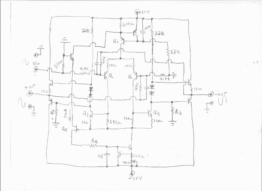

Hi Carlos:)
The circuit shows the idea, but the values depend on your specific component measurements. So is the way with J-fets. This may be a reason people don't like them.:whazzat: I don't see a reason why you could not use BJT's for the input transistors, Q1 and Q2. Also the dependent source, Q6, could probably be replaced by a 2 transistor CCS. BUT Q5 is required to be a fet because it must be a voltage controlled current device. BJT is current controlled so the base current will interfere with the set point of the adjustable CCS. If P-ch J-fets in Brazil are made of unobtainium, it should work both ways, i.e. reverse polarity of all devices. Could be fun to play with.:)
For +/- 35V, the collector resistors would have 35 V for output to be 0 V. If collector resistors are 22K, then each side conducts 35V/22K=1.6mA. If Q1 & Q2 are BJT's that bias 1mA each, the -CCS would be set to 5.2mA. For the positive, dependent CCS, 0.6V/2mA + 1mA for the J-fet, would have 200 Ohm resistor. The J-fet would have to be measured for Vgs @ 1mA to find Rc. Then Vgs/1mA=Rc. A very simple rig can be made using a 741 to measure Vgs.
I have to leave town for a few weeks but if you do decide to try it, my procedure for the bridge version is to set Ra = Rb until you get the DC bias correct and that all currents are within reason to what was calculated. Also a large gate resistor on the J-fet will help to keep the J-fet from reverse biasing until you get it balanced but isn't needed for operation. Input a signal and verify that you get 2 outputs, + phase and - phase, and that the - output is smaller than the +output. Then place another larger resistor in parallel to Ra and the -output should get larger wrt the +output. A scope would be handy, but if no access to one, maybe you could use 60-100Hz signal and DMM?
The PCB's for the project that the other circuit is in should be here today or tomorrow and I already have all the parts.....but I cannot do anything with it because I have to leave town.:bawling: Maybe I will get to build it next month....:apathic:
Hopefully it will work, at least as good as the UGLY AMP version does, but I won't know until then.
