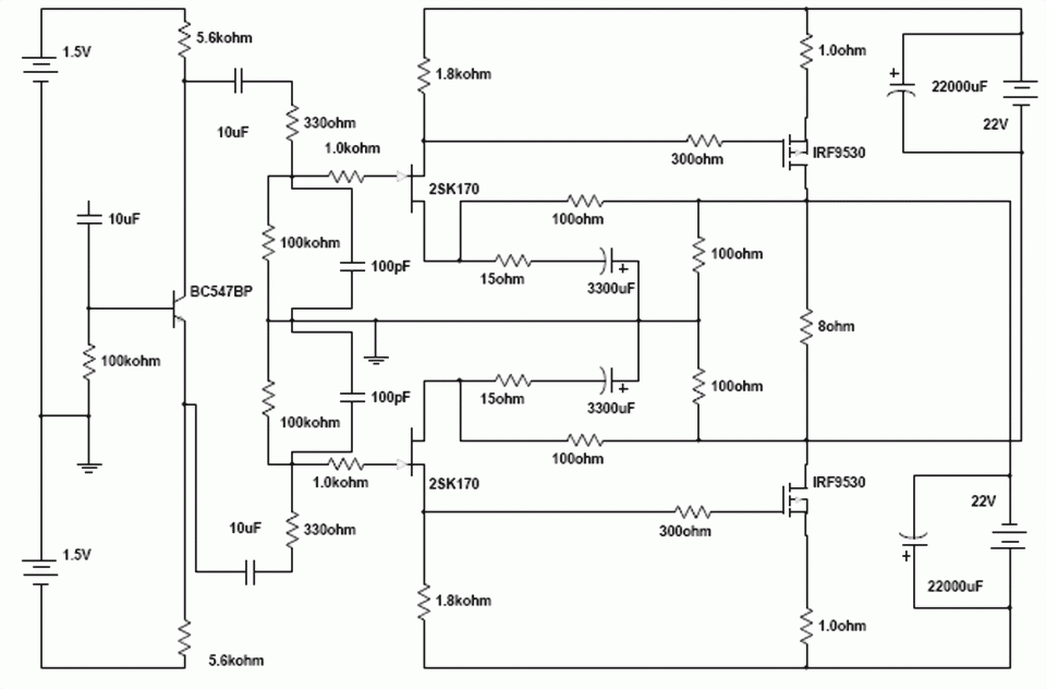

Dear Carlos,
Please allow me to share some ideas cooking in my head for some time. From your posted circuit, I was just thinking of using the LTP differential input? This way the 2 outputs are perfectly symmetrical and inverted in opposite phase so this way maybe we don’t have to think about the different impedance and phase? But believe the input and feedback must be lifted (biased) just as the other stages since noticed the circuit utilized single supply and without grounding.
Thanks,
mannycc
Will not be interesting anymore my dear friend
Mannicc
Will be another three stage amplifier.. alike thousands of others.... the advantage into this design that made me interested on it was because was simple.
If i need to use differential, or phase splitter or gain one phase inverter stage...then the circuit will not be interesting anymore.
Using differential we gonna have three stages.... there's a lot of three stages amplifiers buzzing around... i have created several.... i want to try different things.... and was surprised with this problem into the input...will try my way... also to listen will use an inverter small transformer... a battery charger chinese small transformer.... a 110 volts to 4 volts.... trying primary or secondary...having three wires, i will be able to invert the phase entering the audio sinal into the middle transformer wire... and my audio ground will go to the virtual audio ground we have into the circuit input...well... will try.
But really... will not be happy..... using transformer the sound will be worse.... this circuit, for sure will be assembled (because i have produced special supply, and now i have already started and have to finish)..... and will be abandoned... transformers are audio killers... even sounding fine, i will know, in advance, the transformer will be killing sound quality.
Each stage you use, each capacitor or resistance or inductor... each part you use produces some losses.... so... i was "in love" with this schematic because very simple, so, may have special audio quality...but... if i will really need to use transformer...phase splitter or a phase inverter single stage..then i will be introducing parts and one more stage... the advantage the circuit has will be lost this way.

Hi Carlos,
When I suggested differential input, I was thinking of replacing the input transistor on your posted circuit that’s why I thought the number of stages should still be the same except that one transistor will be added (pls correct me if I’m wrong) :). I’m interested with the approach and simple design of the amp so I would appreciate if you can send me the schematic with parts value pls also include the volume/tone controls (only if possible)…my email add…

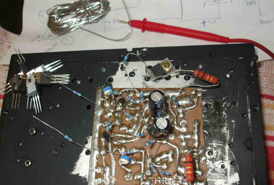

I have built the Circlotron and listened.... i have made recording and uploaded the one to Youtube:
http://www.youtube.com/watch?v=OhcuGzPg1qc
I found the amplifier good.... treble not so mufled compared to DOZ and others i have in my home.
I found it stable but too much hot..poor transistors are yelling for help... current adjusted into 1.5A plus 1.5A.... voltage was filtered and i have used electronic stabilizer.... voltage was adjusted to 20 volts and 20 volts and dropped to 19.8 Volts when iddle current was adjusted to 1.5 A upper side and 1.5A lower side.
I have tried several inputs, transformers, phase splitters, inverters, transformers inverting and transformers non inverting... i have used condensers, i have coupled directly and worked fine.
Seems to me that will be a very nice amplifier if you use the pré amplifier people suggest to it.... with the needed 180 degrées phase inverters to positive and negative inputs.
Will be dismounted... despite very good... too much hot to my environment temperature.

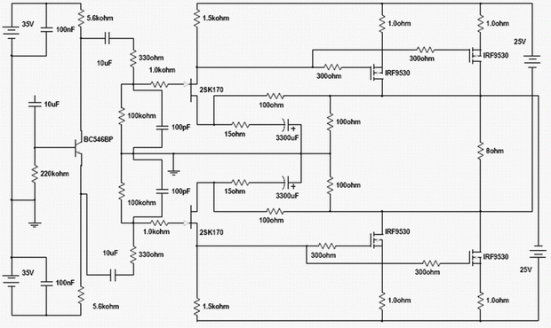

Will assemble once again... the Circlomanen, Circlotron.... no modified
But very small modification...i want to try this idea...to 35 watts RMS into 8 ohms..... do not know if will work fine... also the current will be very high.
Curiosity..... yeeessss!.... just curiosity.
Will assemble once again tomorrow morning... more 12 hours i will have results.
I cannot wait to see how will sound....simulator is fine...well... everything is fine into simulator.
Stand by current will jump to 2.5 amperes...reason why i have introduce another FET.
Will be hot... a hell hot!

1.5 plus 1.5 amperes and 25 volts plus 25 volts
I will try... gonna see what will happens into the next exciting chapter...unless it is a hell exciting to me... i just cannot wait the new day to come!
This Circlotron was an old Electronic Tube Amplifier.... a Valve unit..... Michael Rothacher have adapted to FET... redesigned.
Nelson Pass have aproved and made something alike.. also has published something about.... Circlomanen has made simplified one, the one i have tried.... now i am tweaking.... last try.... terrible curiosity.
Maybe will produce 35 watts RMS... and i feel this power the minimum power we can feel good.... and to each channel.... 35 watts undistorted.

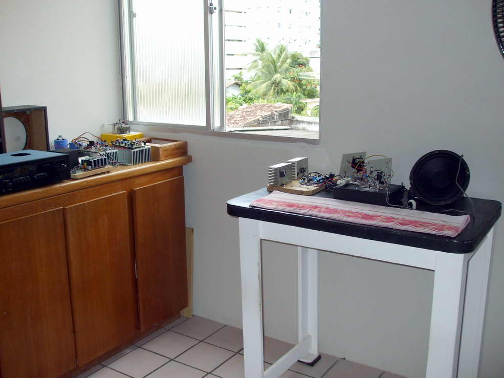

here is the yesterday picture.
