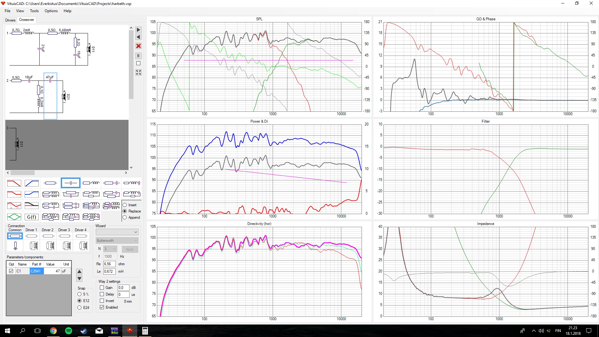

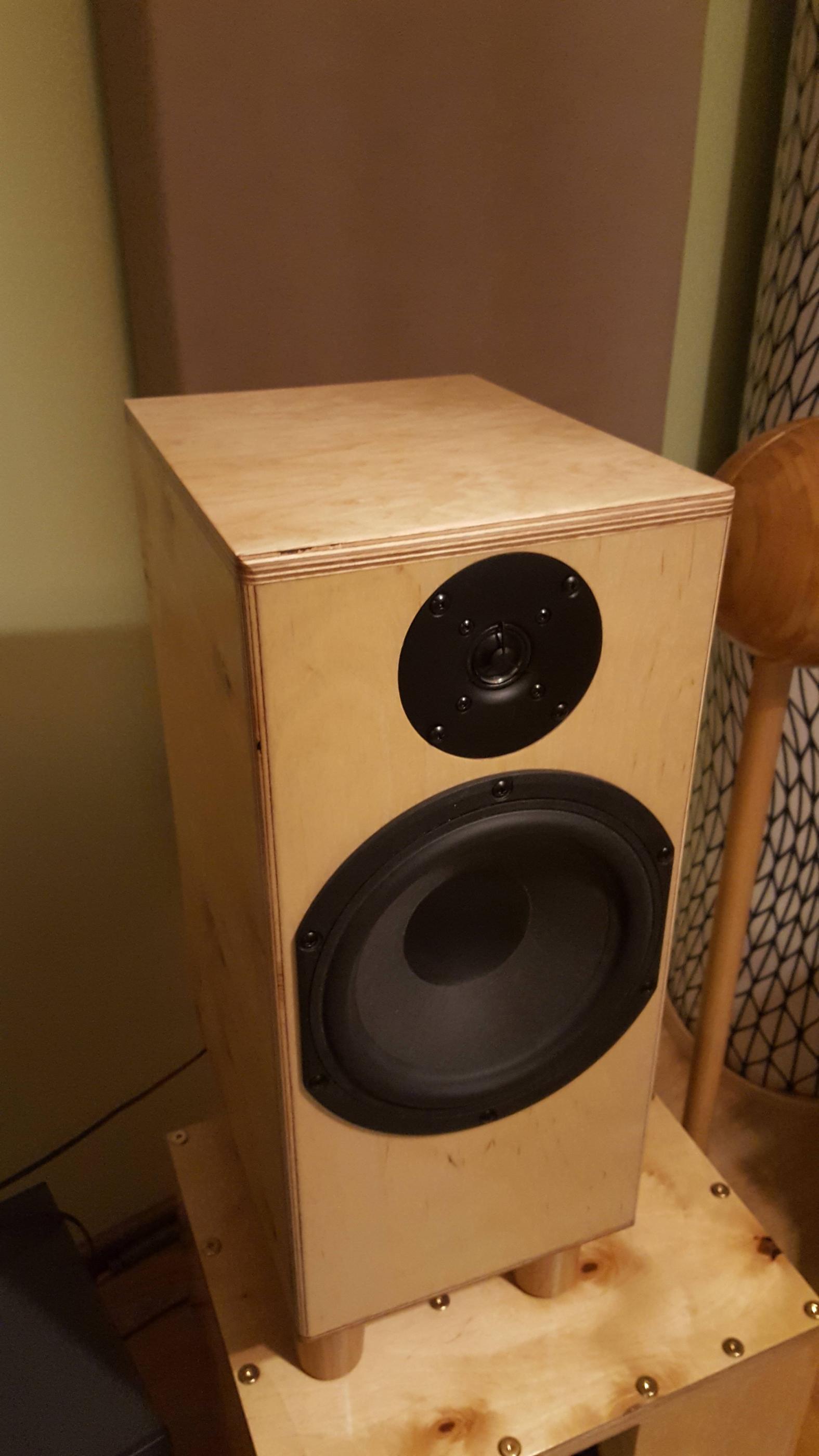

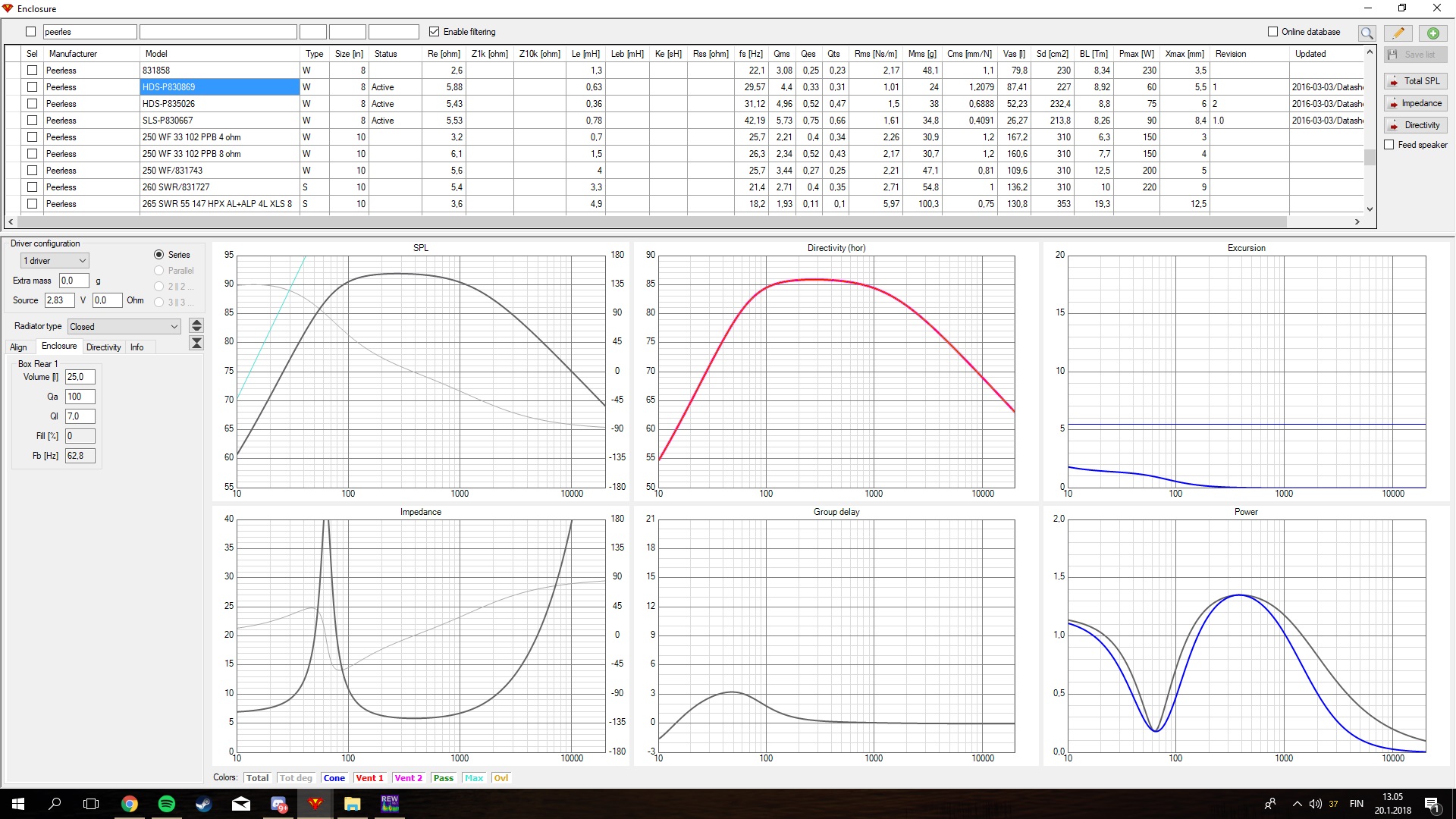

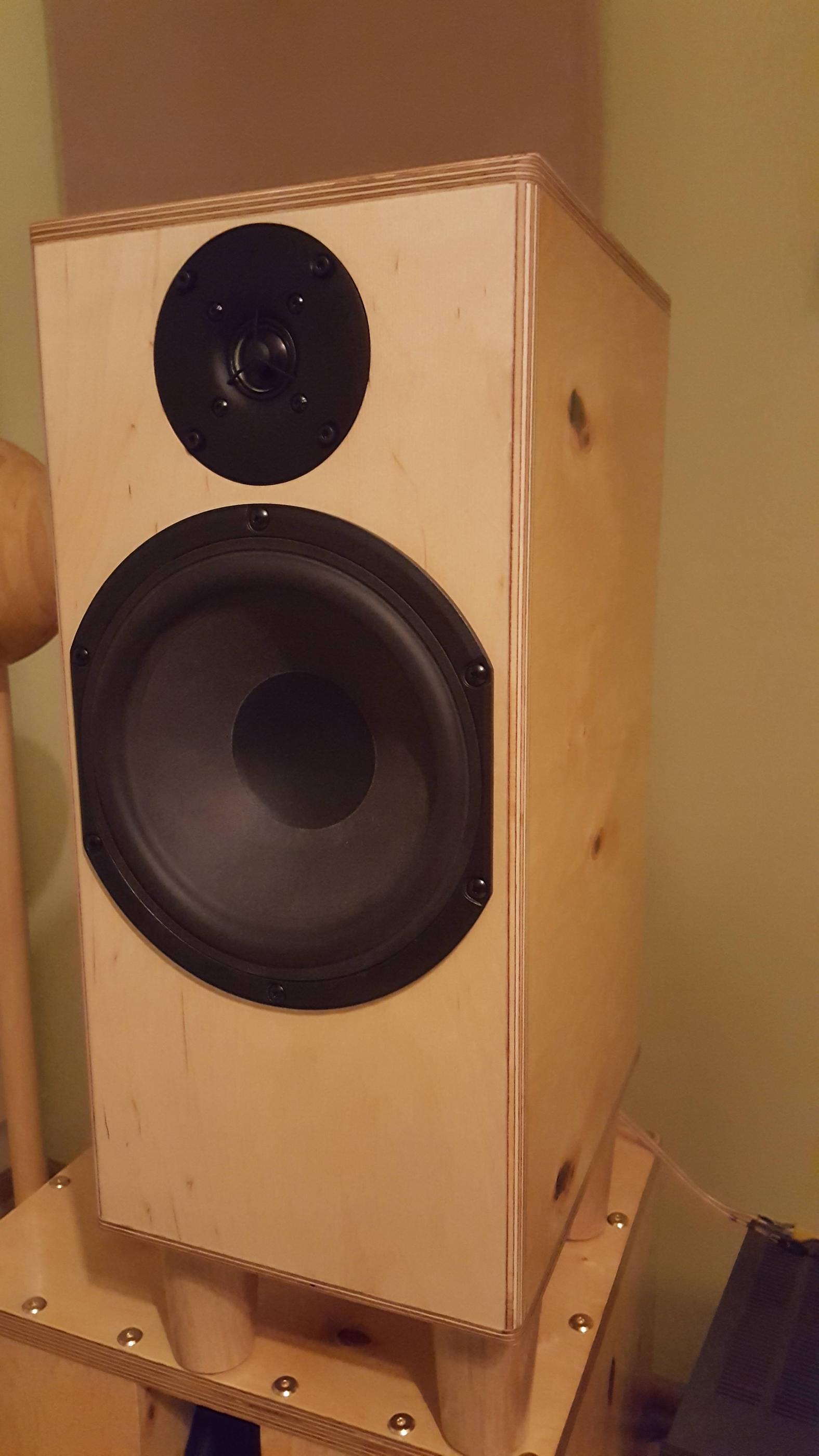

I've been building a speaker out of Peerless 830869 woofer and SB26ADC-04 tweeter. They are in a sealed thin-wall style cabinet made out of varying thickness of BB plywood. For example, the side walls are laminated out of 4mm BB ply, 3mm MDF-style board and with 18mm of bitumen damping (a bit overboard maybe). The enclosure is 230mm wide and 490mm tall. Driver CTC is 170mm. They are finished with beeswax atm, but not very happy about the finish. Probably will lacquer them with high-gloss.
But onto the point. I am seeking advice in crossover design of this speaker. I measured the drivers separately at 25cm and 60cm distances with 0, 20 and 45 degree angles. All of the measurements + impedance files provided by manufacturer are in the .zip file. The naming goes that for example 25@0w is mic 25cm from woofer at 0 degrees. The distance from floor is 100mm if one wishes to gate the measurements (5,6ms gating). Measurement height is between the drivers. I also attached one of my versions of the crossover.
Unsure yet, but I have a long weekend ahead of me, a big stash of components and some wire clips
That's why I started the thread, maybe we can figure out a nice crossover with even freq. response and good phase matching. Everyone has got their preference on the topology. I'll try the best looking ones posted here (if I have the components) and measure the results.
I also simulated 3rd order Butterworth which also gave good results. The Peerless is a very smooth woofer with easy breakup, it might be even usable with a Bessel. I have a hard time integrating the phase with lower orders however. I am aiming for crossover point around 1,5k.

Acoustic offset between drivers is about 40mm (determined with moving drivers until you get phase dip at crossover freq). This hasn't been taken into account because simulations show I actually get better phase tracking without matching the offsets. I actually forgot to add the offset in the simulation I did with VituixCAD yesterday, need to re-do them today...
These will be used with subwoofers, so bass is of no importance. What I'm after is natural sounding vocals and instruments.

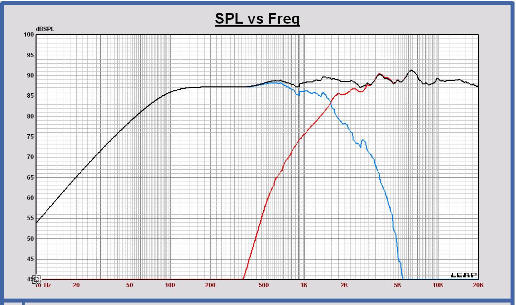

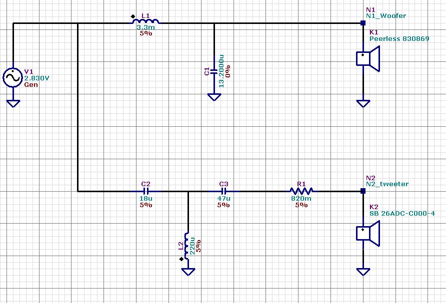

Yes, the acoustic offset is now included. Sorry for the mistake, simply forgot about it yesterday Here is simple Bessel on woofer, BW3 on tweeter. Seems to work well, I will try it later and post results.
As a bonus it uses parts I already have, so no need to buy new crossover parts.

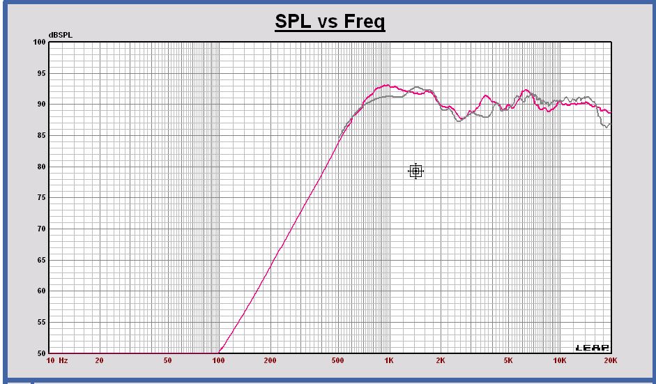

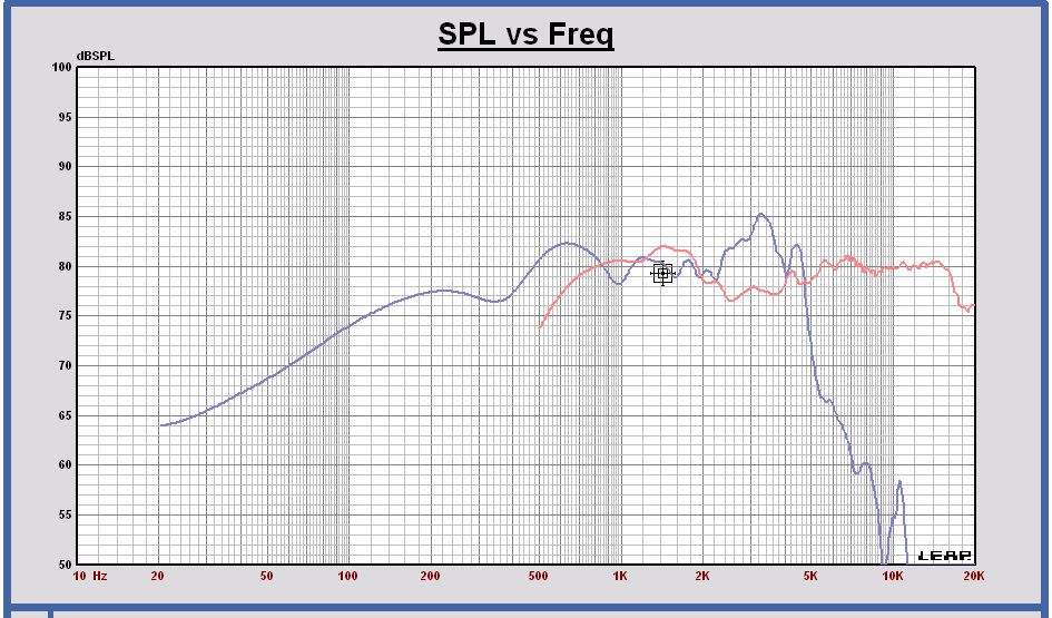

I had a look at your REW measurements at 1m. To eliminate the room reflections I have chosen the IR window only 3.5ms.
These are your REW measurements imported in Leap
From my side I have made driver models in Leap using the driver specification.
This is SPL of the woofer model in Leap compared with your REW measurement.
Model in blue and REW measurement in grey.
And the same for the tweeter.
Model in red and REW measurement in grey
To fit, I gave the measurements an SPL offset of 10.75dB.
I had to increase the woofer SPL of the model with 0.5dB.
You can see some differences.
For the woofer, below 700Hz the model is more correct. Your woofer shows a break up at a higher frequency than the specification shows.
For the tweeter there are some differences at 900Hz and 3500Hz. It is not clear now if these are driver SPL or diffraction differences. I think both.

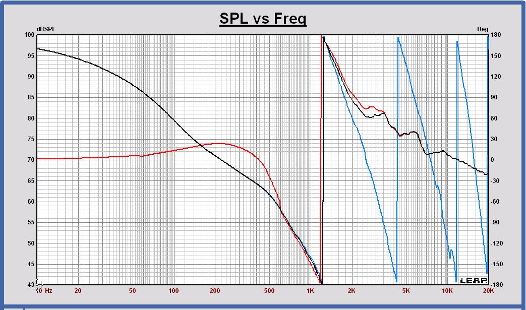

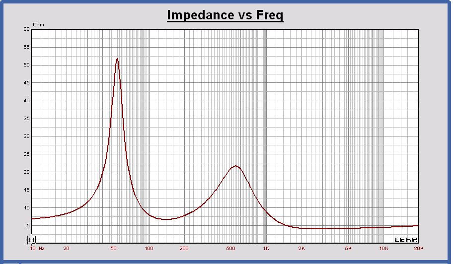

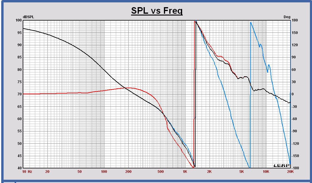

For the curiosity I already simulated your last filter with the Leap models. These are the resuts.
SPL 2.83Vrms 1m
Phase
Impedance
IMO the filter has to be adapted for more low frequency extension. Now the sensitivity is 87dB at 1m. It should be better to make it about 84dB to have more compensation of the baffle step in that way.
Also the SPL flatness and phase alignment maybe can be better.
At first I will improve now the models for a better fit on your measurements.
And after that I will have a closer look to the filter. Do you prefer LR4 at 1500Hz?

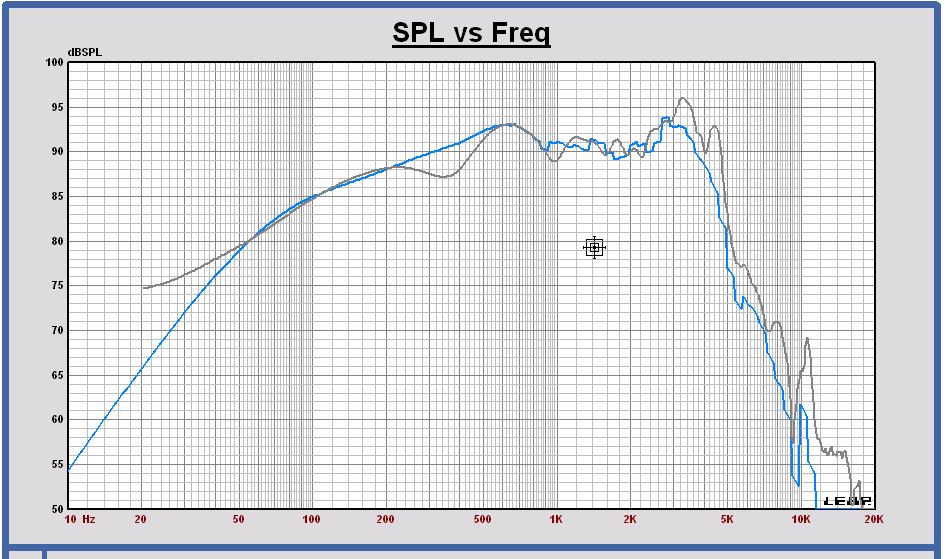

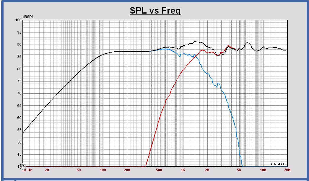

I prefer a filter that works 3rd or 4th order is a must for the tweeter, but I think the woofer can work with a lower order, maybe even Bessel.
When you attach files for your message, if you don't use the [ ATTACH ] tag, they will show a list like in my messages.
Out of curiosity, can you also simulate with the tweeter coil being 0,22mH?

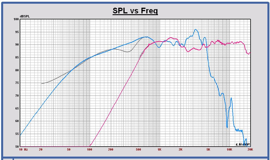

Mayuri,
I have done a data splice in Leap in a way that the REW measurements are used for the model above 700Hz. Now the SPL of the drivers are correct from low to high frequecies. These curves can be used for further filter design.
In the plot you can see the SPL of the models in color and your REW measurements in grey (almost hidden now ).
Do you have a calibrated microphone for your measurements?
