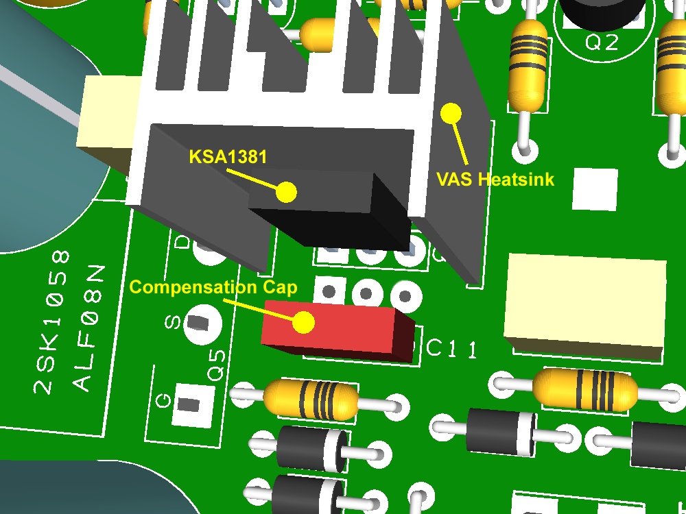

I have a question about your layout. Do you have places for compensation caps? My breadboard Peeceebee is an oscillator using the higher voltage transistors. I am wondering if there should be places for compensation caps on each pair of transistors.
My heavily compensated VAS stage continues to oscillate but at <1Hz. Obviously there needs to be some compensation somewhere else. It could also just be the breadboard has outlived its usefulness and I need to get the amp built on a well layed out PCB.

Yes, good question. I already had pads for compensations caps, but some caps did not fit well with larger heatsinks. In the revised layout, I allowed more room around the VAS transistors, for bigger heatsinks, and two sets of pads for caps. I hope this time, there is enough room to experiment.... Do you have places for compensation caps? My breadboard Peeceebee is an oscillator using the higher voltage transistors...
However, both the caps and the heatsinks need to be close to the transistors, one can't have both components with the largest possible footprint. Some older types of Silver Mica caps are just too big. Most people can probably use fairly small and inexpensive NP0-type caps.
