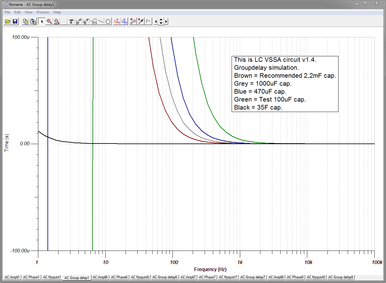

There's small problem.With high power,when bass kick,there's slow move of speaker cone,cca 1Hz.This will ocur on any trackWhat is problem,maybe my phone?
My amateur guess is thermal tracking problem. Are your input transistors glued together?
Second guess would be instability. Have you put a DMM on bias points and watch for drift?
Hi Acca, i guess this is problem:There's small problem.With high power,when bass kick,there's slow move of speaker cone,cca 1Hz.This will ocur on any trackWhat is problem,maybe my phone?
You get subtones delivered before the audioband 20-20K, about 64ms before audioband arrives. It is because you use only 100uF cap in feedback position, least recommended = 1000uF but better get 2200uF, it only needs to be 6,3V because DC/AC standing there is about 0.85V/2,44mV.
I attach simulation with different caps for graphic view.

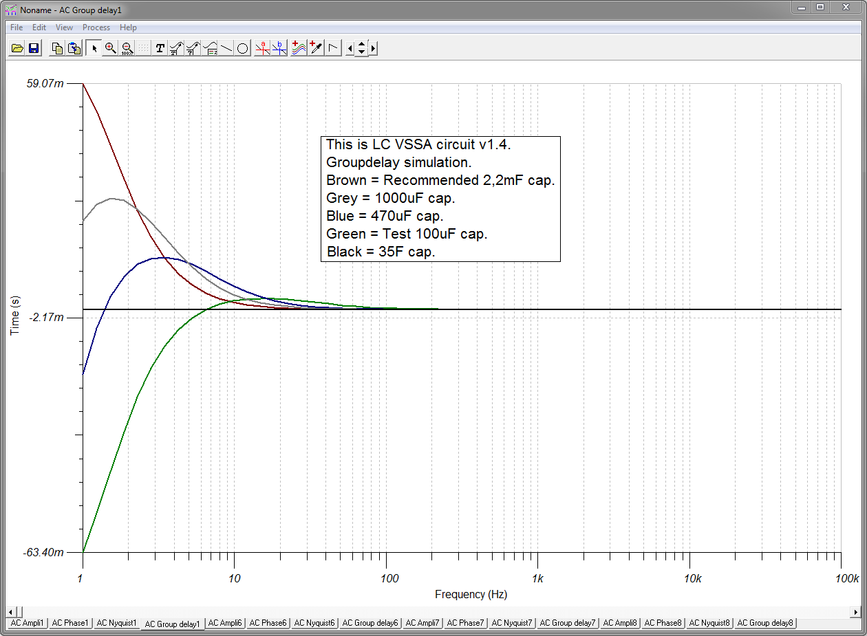

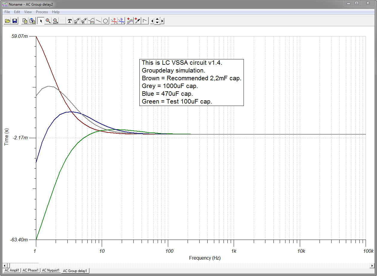

If someone is interested i attach two more images of groupdelay coursed by this cap in circuit.
To show what happens if you put one 35F/2,7V cap in there. If you are high end freak or have sound studio it would be preferable for precision.
I will try it later with this huge storagecap, but drawback can be if it has huge induction too then high band gets lost or circuit can be unstable.
First picture is same as post #1186, but with 35F cap plot, and second picture is zoom in to 0,1ms, where even 2,2mF is little bad looking.
Regards Ricky

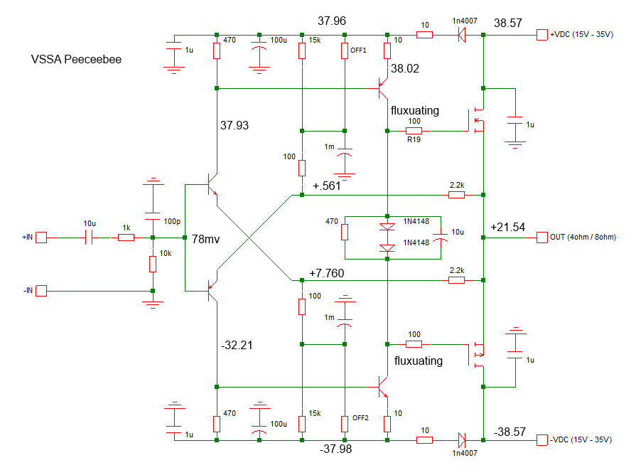

I have created a schematic that I will post below with the voltages I read.
Hi Terry.
Check the NPN input and PNP VAS transistors. Looking at the voltages I think one or both of them are either malfunctioning or just dead to an emitter-collector short-circuit. I particularly suspect the BD140.
What Pete said about oscillation is also a possibility, and faulty components can introduce a plethora of mysterious problems.

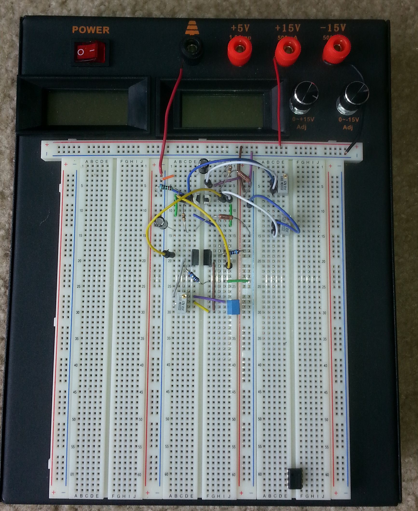

Sorry guys, I shouldn't bother you with this. It was mainly something to do while I waited for the rest of my Honey Badger pars. It looked like it would be fun and I had most of the parts in my parts drawers. I'm not sure I want to go through the work of fixing it when I am planning to build a nice one once Pete is ready to order more boards. (hint, hint) I may toy around with it some more to get a better grasp for when I build the next, but I'm not into trying several different parts until it works. I should have know when I first saw there were no pots that Bias and offset were likely going to be tricky to get right.
Hi woofertester.
Congrats. I love the noodlework!
Lookin' forward for more...
Its a laptop amplifier. I did a lot of the wiring sitting in an Ikea chair. The breadboard is self contained +/- 15V. I don't have to be anchored to my power supplies in my workshop.
Yeah, I might pull the transistors and test all of them. I probably hurt something when I got a couple things in backwards. This is a pretty simple layout. Even if I hurt the foil it won't be hard to run some jumpers. I am looking forward to building one on sanitary boards. These were a bit of a mess from the start. It was even difficult to do the drilling with the poor results I got from the transfer. Compound that with no silkscreen and I just made too many mistakes. I'll probably keep tinkering with them. I had better read through the entire thread. Seems there were changes along the way that I didn't know about. I'm sure I will learn something new before I'm done.
