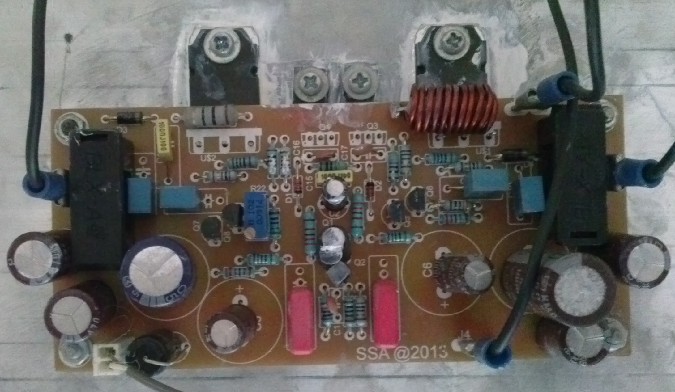

I have built two different versions, so far, and I also have Lazy Cat's modules from the GB in his VSSA thread. The one I listen to almost daily is the one closest to Shaan's original schematic (with compensation caps added, and a highly filtered power supply). I am still experimenting, but I do believe that this amplifier benefits from a clean supply, more so than others. I also hope to try some of the other versions, like Marc's (well, Borys/Marc's anyway... )
That one is one good looking and smooth amp! Well done.

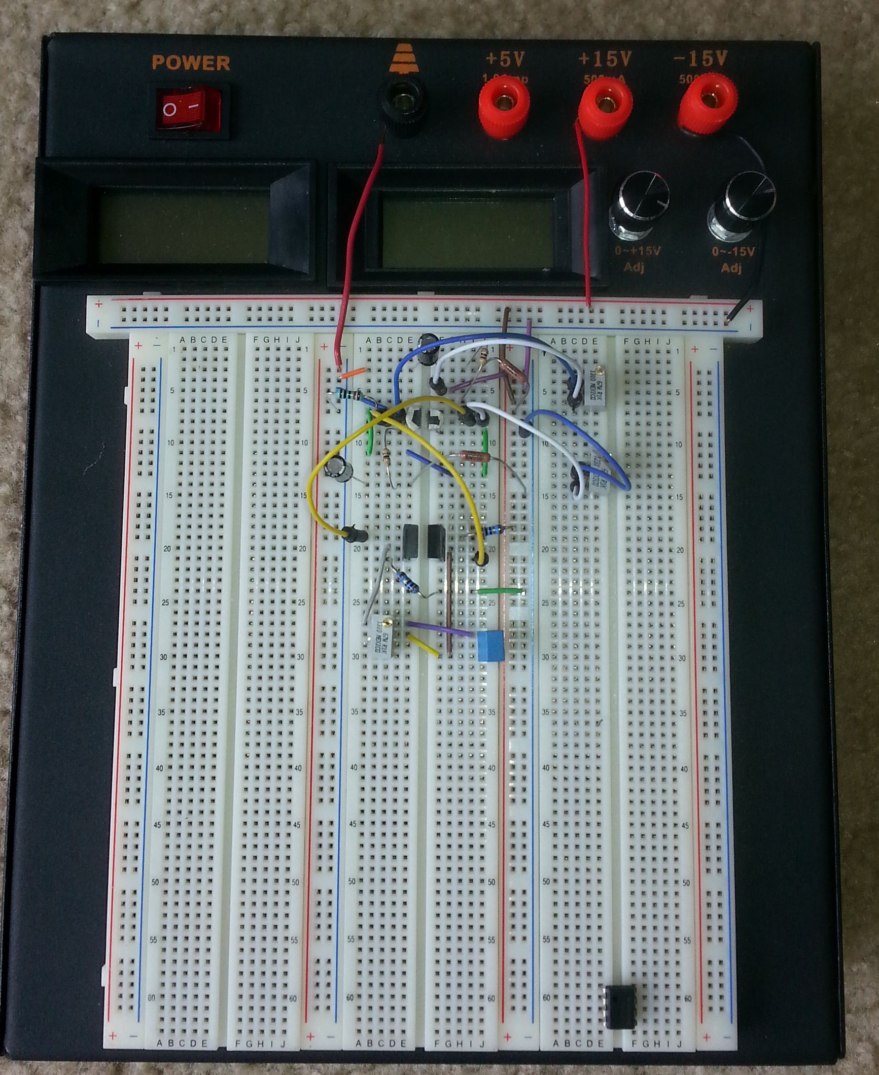

I have started my Peeceebee. I am using Rev 1.3 of the VSSA schematic. Input transistors are KSA992/KSC1845. These are the only transistors that I could get to match.
VAS transistors are BD139-16/BD140-16. Again these are the only ones I could get to match.
The LATFETs are in hand but not yet connected. I just want to understand the front end and driver biasing before I proceed.
My voltages are +/- 15 on the proto board. I changed 15K to 5K. All other passives are as per the schematic.
2.8mA through the PNP emitter. 3.0 mA through the NPN emitter. I changed the 470 ohm resistors to 1k pots to set the VAS transistors. Stock 470 ohm resistors caused 50 mA in the VAS transistors. I am dialing the 1k pots for 100 mV across the 10 ohm resistors.
Transistor pairs match are 1% to 2% at 30V and 2 mA for inputs and 10 mA for VAS transistors.
Question: In the V1.3 schematic, what should be the DC voltage to ground at the capacitor pair that grounds the connection of 47 ohm and 15k resistor?
Comments are encouraged.
On my board, that voltage is around 0.75V, with +/-35V supply, and 100R/2.2K....

It is the sum of the drop at input BJT emitter (~0.7V) and the drop at the 100R connected to its ground(will vary depending on input bias current if gain setting resistor is fixed). I biased the inputs in my boards a bit higher, so I have about 1.2V at the capacitor(s).
Correct. If you are making the effort to match your transistors, you should measure/match the opposing pairs of these resistors also.2.2K is your feedback resistance and 100R is the resistor from emitter to capacitor junction?
Since the feedback is effectively two parallel feedback circuits, a difference in the resistors will have an effect (I am sure Shaan will correct me if I am mistaken about that). In my next (and I hope final) build, I am thinking about using some kind of temp-stable resistor in place of the 2.2K 1%. (Assuming I ever get close complementary Transistors... )

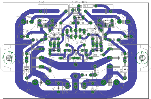

I´ve been lurking in this thread from the beginning and few weeks ago I built my own peeceebee. The schema is according to shaan, but the Rail caps are 1000uF for the fets and 100uF for the front end. My vas transistors are 2sb1109/2sd1609. comp caps were needed and with 22p the amp is stable.
I also have slight hum when I put my ear on the speaker and it used to be much louder because of the pcb design. The pcb itself is a shameless copy from PMI:s work but not as good since I had hum.
The difference between the current implementation and the attached image is that I had to connect the input ground with a separate wire to the power ground to get rid of the hum.
I am drawing a new pcb soon...
This is one of the best threads on the forum at the moment. Real diy spirit!
Sounds good to me,I would be happy to trade some matched transistors for blank boards when you have your next batch fabricated.
Imitation is another form of compliment......The pcb itself is a shameless copy from PMI:s work but not as good since I had hum...
The hum could be noise picked up on the input leads from the transformer secondary winding and leads. If I make a longer input lead with a half-loop, and hold it closer to the transformer, the noise I can see on the 'scope gets bigger. If I get close enough to the toroid, there is audible hum.
The circuit is fairly susceptible to this, in other words, it may not be the layout. Couple other people have noticed the same thing.
