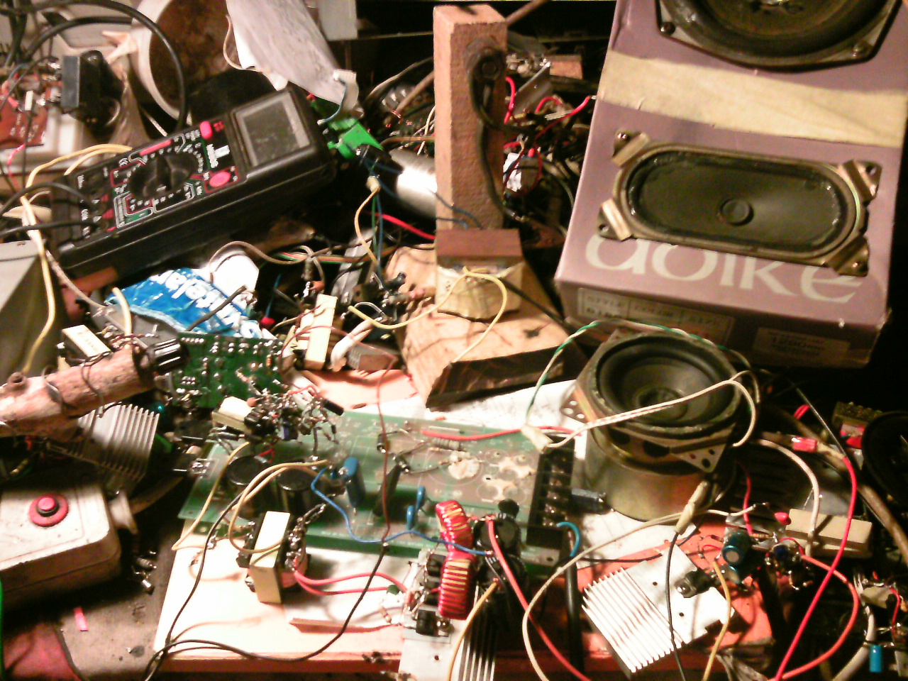

Your job is wow! I love the mess with those hanging parts and am amazed that you made it work without any problem. :up::up::up: :eek::yikes:
Darlingtons are nice, but due to positive tempco and low fT they were avioded in the first place. I suggest you use a Vbe multiplier with them and fix the extra transistor to the main heatsink.

Because it's good amp,it works ok ;)
I use parts from old TV.Only darlingtons are boughted.
For class B Vbe mult. is not needed.I can make it,but i like simple things.
Ok,when i finish.I'll post pcb.

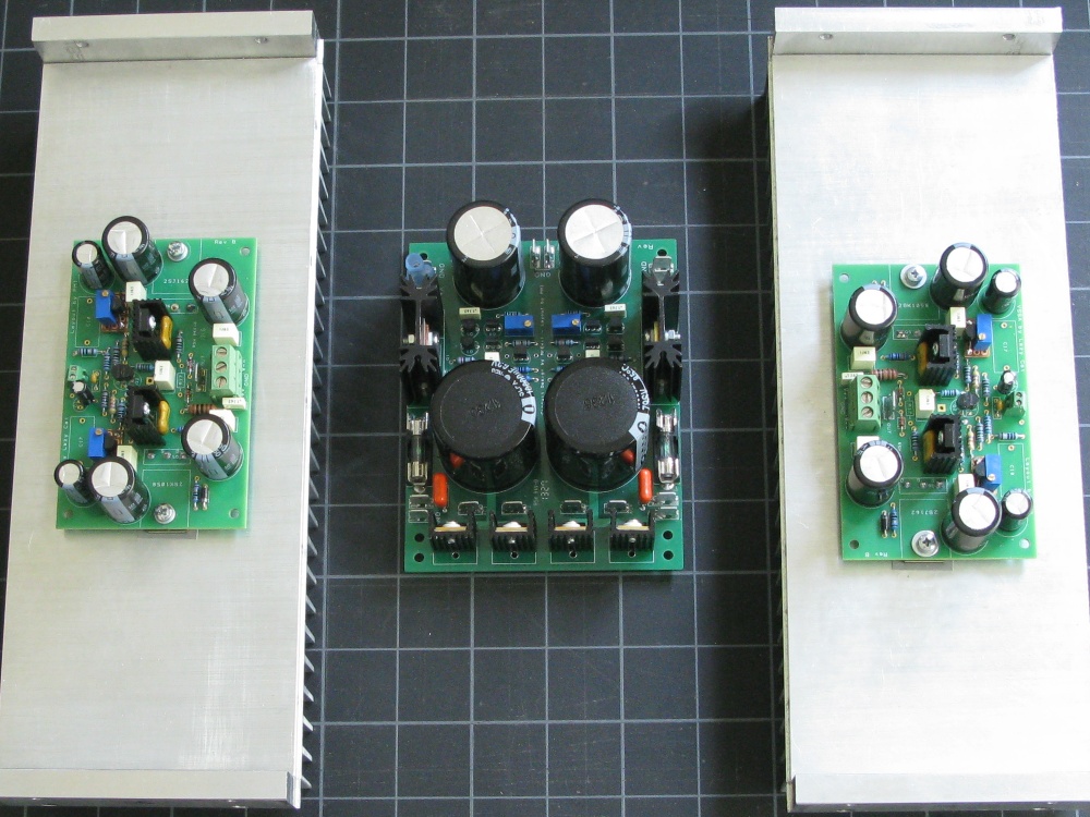

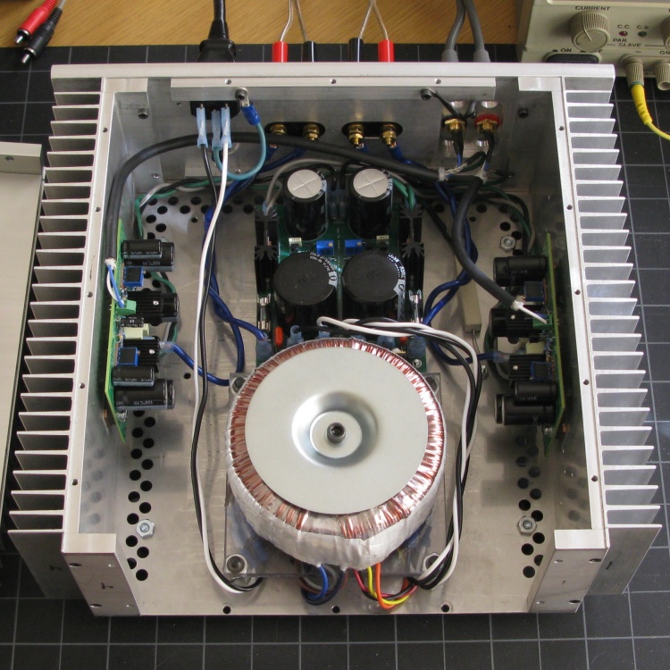

I have built two different versions, so far, and I also have Lazy Cat's modules from the GB in his VSSA thread. The one I listen to almost daily is the one closest to Shaan's original schematic (with compensation caps added, and a highly filtered power supply). I am still experimenting, but I do believe that this amplifier benefits from a clean supply, more so than others. I also hope to try some of the other versions, like Marc's (well, Borys/Marc's anyway... :D )

You can say borys one as i just customise layout. I don t doubt shaan version is good, i will try 2pair later as i have matched sk1058 and sj162 from my dismentle zenquito, but i have compare vssa and bg1 in differents evolutions and you know results...

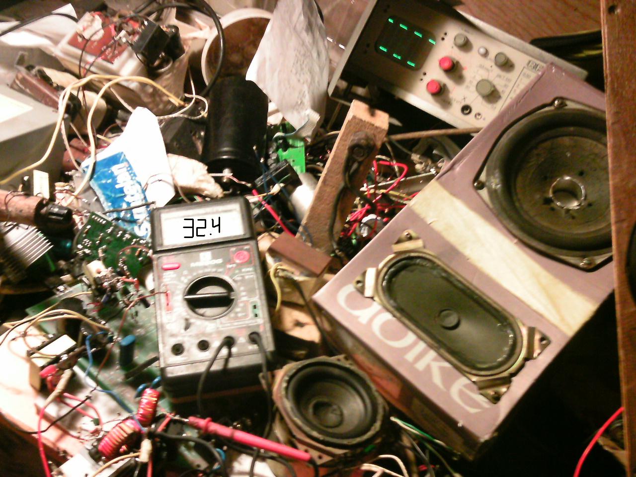

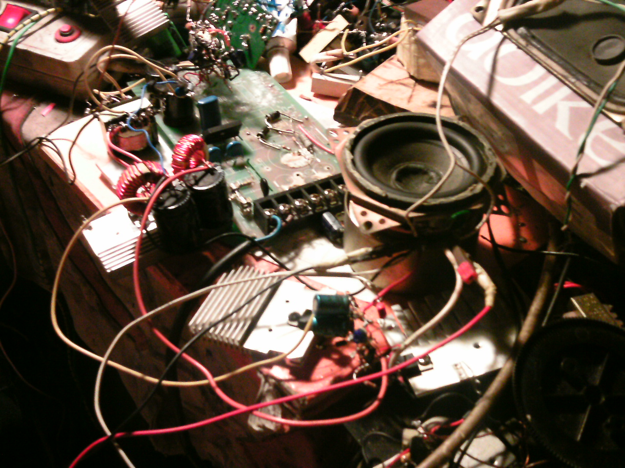

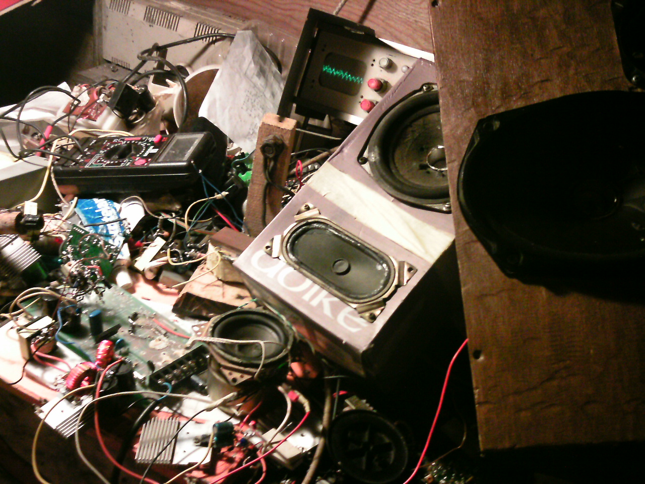

In theory.
Practice,it's better than voltage feedback (quality) but worse in ofset.
I make another one amp with voltage feedback,and with small volume quality is worse than your amp.On small volume your amp sound's very good.You can try make comparison like me.Bias it in class B and see difference.:eek:
I can't make offset to 0V.In 0V region it changes from + to - 20mV.When heat up,it change to 1V:confused:
But quality is very good,even on small output voltage ;)
I used different darlingtons :D (BDX33C + TIP125)
I tried it with SMPS.Works very good,but i must change few parts to get better DC ofset.AC ofset ok.Maybe to try all trans. on same heat sink.
