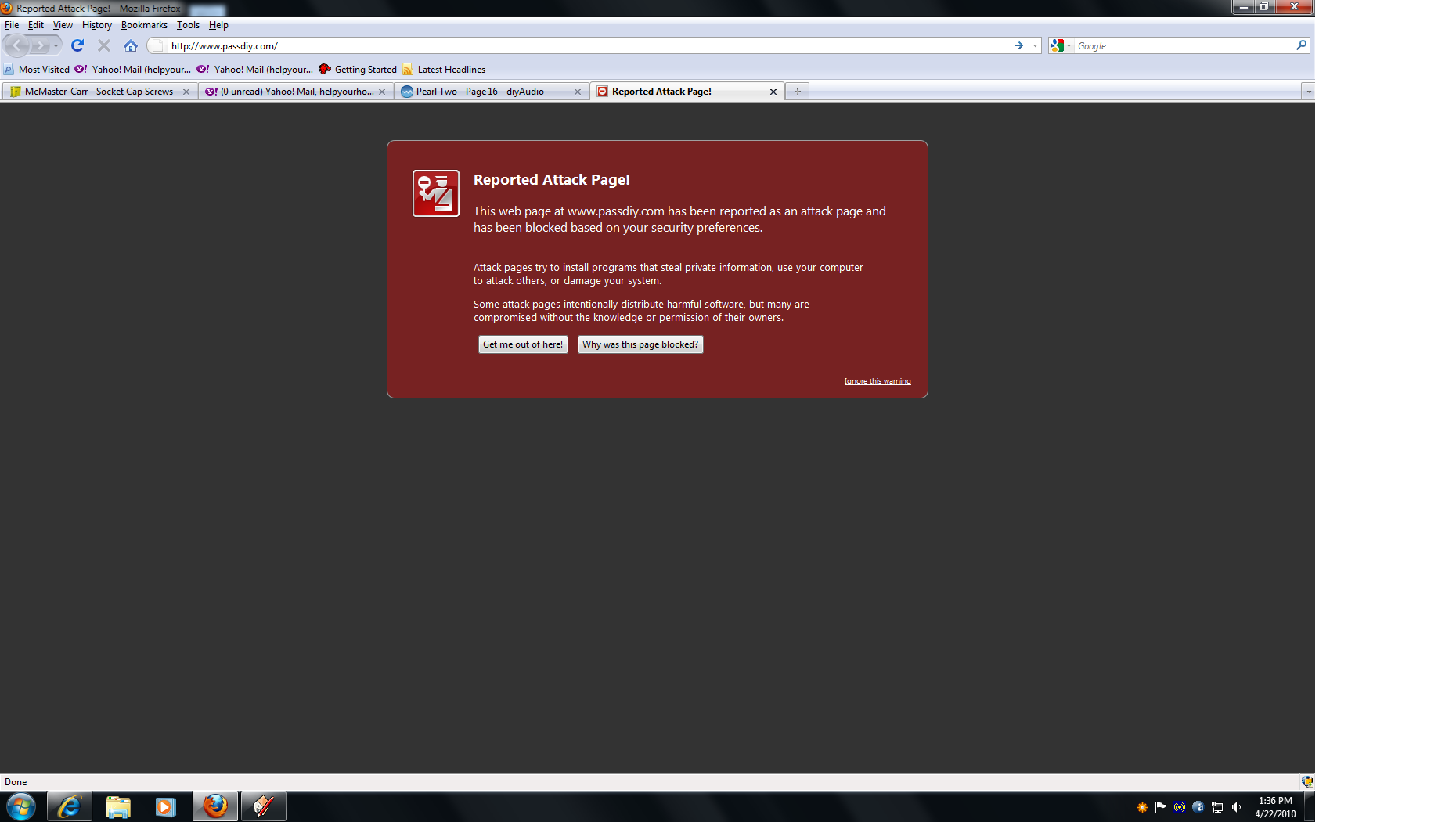

Still Down.... :(
But I'm in for a set of Pearl 2 boards.
2 for stereo yes?
Ron
