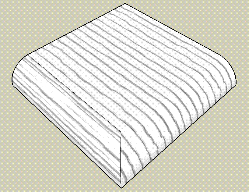

MJL21193 said:
Also, the round over should have been on just 2 edges. It's next to impossible to veneer round overs that go both ways - I've seen attempts, they weren't pretty.
R-Carpenter said:
Veneering perpendicular round-over edges is quite possible. I've done it successfully more then a few times.
I should have phrased that: "It's next to impossible to veneer round overs that go both ways and make it look good.
Veneer is meant to look like real wood, and a real piece of wood has end grain - veneer does not. You either wind up with what looks like a mitered trim corner or what's shown in the picture below.

BTW you mismatched the grain on the joint on your picture very nicely. If you take a 45* cut and have a good glue line, lines will actually flow in to each other, mister artist.
Disabled Account
Joined 2007
What are you talking about? The quick sketch I did above? The purpose was to illustrate what I was talking about, not to make it look nice. What's eating you?
