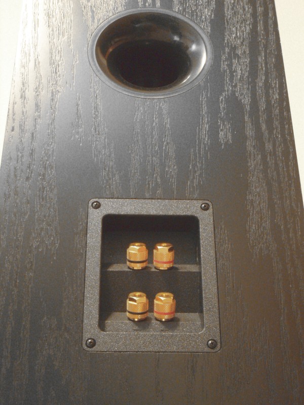

But I have a question. The ports that came in the Madisound kit (I'm working from their no-enclosures kit) have two different ends. I received two pairs of these (two of each size):
I had assumed from the Zaph website that the smaller one went outside, as shown on his site:
This is clearly the smaller of the two I have.

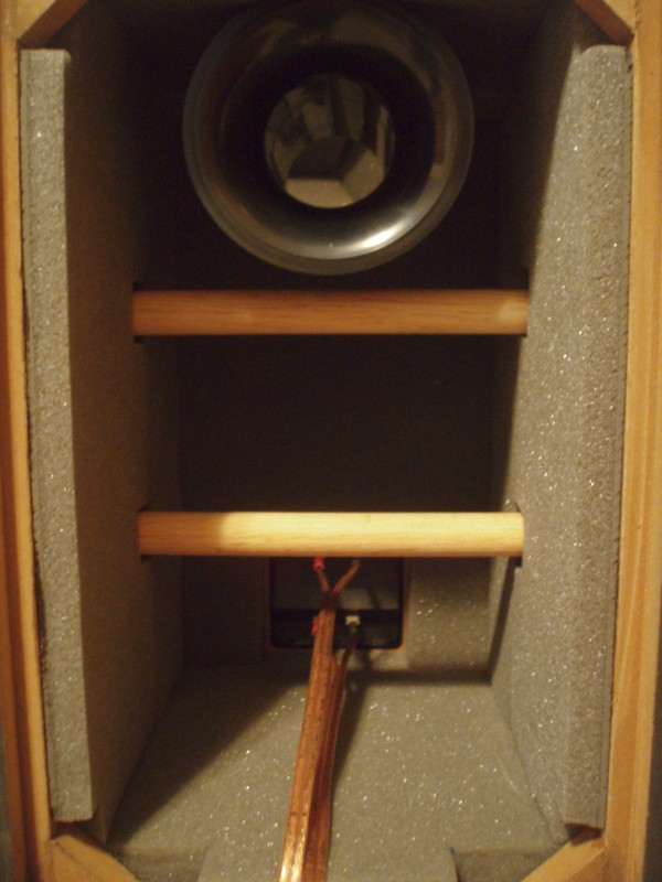

But then I looked at the interior and saw what looks like the same port:
So now I'm not sure what was intended. Which end goes on the inside, and which on the outside? Anyone know for sure?
Stew looks to me that the kit in Johns pictures have two small ends. I know if I were faced with tht dilema Id call the supplier to see what gives. If that failed Id break out the dremmel to cut the large one down. Having one inside the cabinet does have one advantage if you do choose to cut the large one down it will be hidden. Just a thought. I see you havent drilled out your baffle bolt holes yet. Have you completed the enclosures yet?
Update: stew after looking at the madisound site their picture of that kit includes two small port ends and you recieved one small one large.
Madisound said to me in email:
Larger= outside
Smaller= inside
Josh for Madisound
I'll need to experiment again as I had done my test holes with the smaller in mind. No big deal.

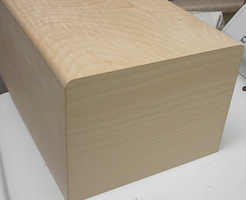

Roundover on front done
Roundovers mostly went well, after a practice run:
Although I did make one mistake that's likely going to be visible.
Is it just me, or is it hard to keep everything level when you're far out on a corner like this? Is there some trick to doing this? I've been directly working on clamped wood - is there more to this? A better way to work?
I would have chamfered during the same session, but I mistakenly bought a chamfer bit with a 1/2" shank at Home Depot which I'll need to return. (My router takes 1/4" bits).
I tried Home Depot & Parr Lumber, but neither sells veneer, so I ordered some online, along with a veneer roller. In the meantime I'll likely glue the backs on, and start sanding in preparation for finishing.
And again, I'd like to know how people think I should attach the front baffle. Should I bolt it on? Glue it on? What's typical?

Are you going to veneer the baffle? If so, those round overs are going to be a problem. Depending on the type and thickness of the veneer, it can be a problem turning a tight radius like that without cracking. Also, the round over should have been on just 2 edges. It's next to impossible to veneer round overs that go both ways - I've seen attempts, they weren't pretty.
Since you driver mount from the front, there's no reason to make the baffle removable, so just glue it on.
No, I'm not going to veneer the baffle. The designer is firm about needed a roundover and I'm trying to hew as closely as I can to his directions. I think I have seen some finished DIY works that feature veneering over roundovers, but I figured it was beyond my abilties for a first attempt. I can't remember if they featured two edges or just one.
Therefore, I'm expecting to paint the front black, but I'm not sure of which exact black, the finish, etc. I want to veneer all other surfaces besides the front, which is why I'm waiting until I've veneered to cut the back holes for the port and speaker terminals.
I also checked and I can get the crossover through the woofer hole, should that be necessary.
But OK, good - I can glue the front as I expected. Great.
