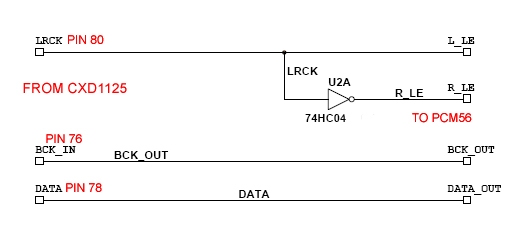

There has been posted this schematic to connect PCM56 to decoder, I have not tested it, but it should work. There will be l/r phase shift but that's not so bad for the beginning.

Hi Bernard,
Thanks for that NONOS schema.
I checked out the PCB and derived a schema, it would imply bridging connections on CXD2551 just almost done on the SAA7220:
  1. BCK_input from pin 76 on CXD2551 pin 6 goes to pin 13 - BCK_output and then on to the pin 5 CLK of both PCM56's.
  2. LRCK clock from pin 80 goes to pin 1 of the existing inverter chip and the output of the inverter pin 2 goes to R_LE (the right channel PCM56 pin 6) while this also goes to the the left channel PCM56 pin 6. The output on pin 8 of the string of three inverters is not used any more.
  3. DATA_input from pin 78 on pin 7 goes to both pins 15 & 16: DATA_L and DATA_R.
The MC74HCU04 inverter is already on the PCB, so this is easy, and there are three spare inverters. I'll use #1.
However I am a bit confused :confused: on the DATA. This is because the CXD2551 has a separate DATA_L and DATA_R output.
I just want to check: is this correct, as far as IIS logic goes?
The CXD2551 datasheet (I refer to the CXD2550 datasheet) mentions:
* pin 15 called DATAR at 8fs (RCH serial data) but at 4fs it is WCK output
* pin 16 called DATAL is LCH data at 8fs but LCH+RCH time shared serial data when 8fs is selected.
Pin 2 is high (+5v) for the 8fs selection.

I can not follow you. Does it have the 1125 decoder ?
If yes, cut the 3 input traces of one PCM56 and connect as in the schematic and see if it works.
Maybe make a drawing of decoder, osfilter and dac for data, LE, bclk.
