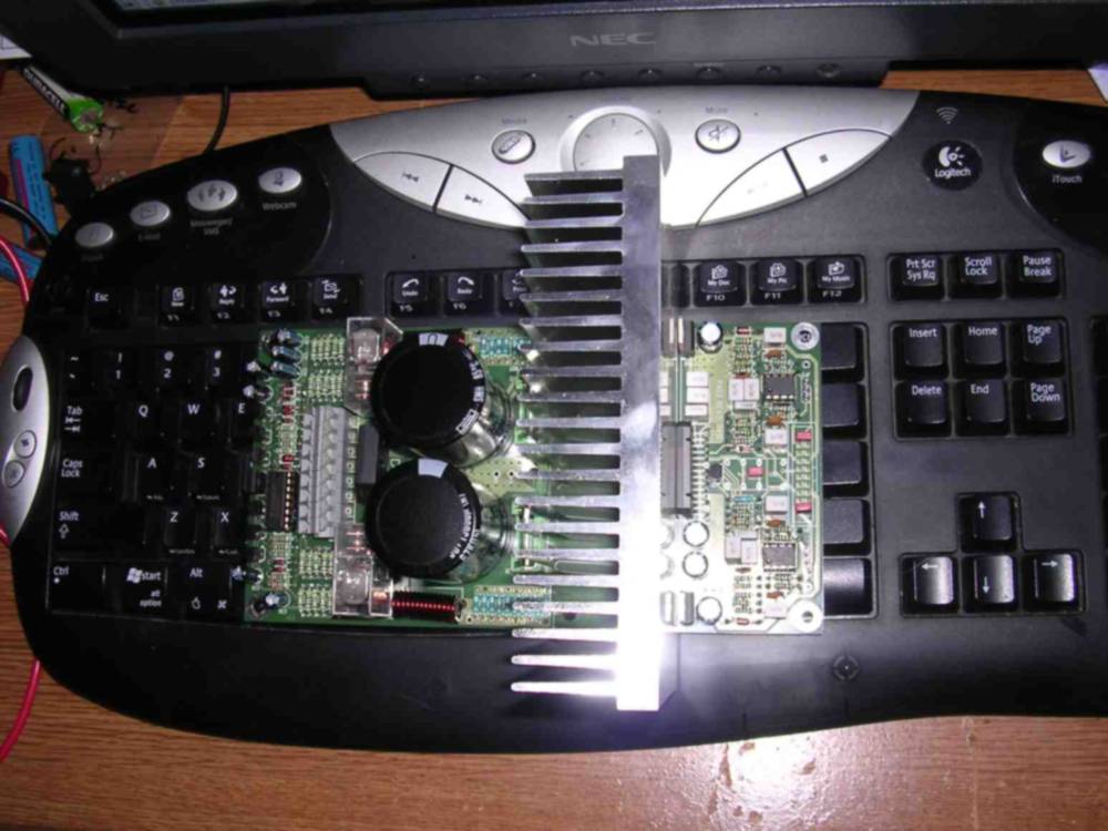

Well here is my PA03 99% completed, all but the heat sink being attached.
Very well done design, I have to admit for someone who just likes to solder and put things together. This design was a lot of work, but so well designed and documented I had NO problems with anything, thus far...
Mine is now about 90% done, and it has been easy so far.
I now have to attach the heatsink to the chip. Sorry but I have some very basic questions here.
Do I drill some holes in the heatsink and tap a thread in these holes, or do I just use some cement?
Also do I need to dril holes in the base of the heatsink, to atanch it to the pcb?
help appreciated

Chalkandtalk,
Drill 3 holes in the heatsink and tap a thread in these holes for the 3 devices and drill 2 holes in the base of the heatsink and tap a thread in these holes for connecting the heatsink on the PCB.
In case of metric thread, you can use M3 as well as M4.
Easy to do and perfect connection.

what??? Does that have to do with insulating washers for the LM4780
I do see what u mean though if u speak of my picture and C11 , C15. As far as that goes, this is what came in the group buy kit, so I just soldered them on. ex007 was the one who made all the choices.
I will re-read the instructions and check the BOM for more info... thanks
Have you looked at the closeup pictures, or checked how the LM4780 look like? The package is all in plastic (the anser is no).jaybombalous said:what??? Does that have to do with insulating washers for the LM4780
Dear all, couldn't you study the material, look at pictures, get datasheets and try to get a grip of this design. The answers for many questions are rather clearly written.
