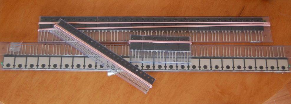

My order came from Digikey. Lots of goodies!
Look at my new outputs and VAS----

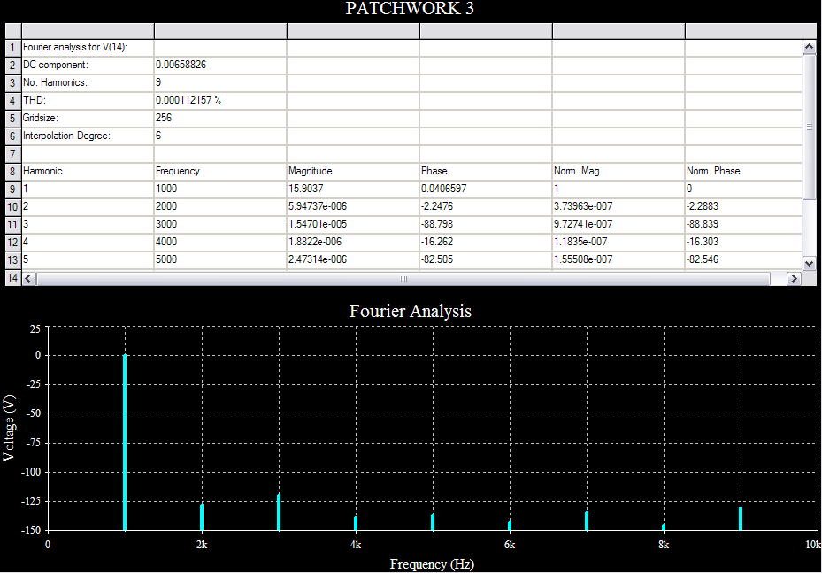

ferencz said:I simulated your circuit in Microcap-9.
I'm getting ~0.1% THD at 20kHz with 1Vrms input. Mostly first order (40kHz) distortion.
megajocke said:Are you sure the period of the signal, the length of the simulation, the length of the FFT window and all that stuff is setup right?
Try measuring distortion of the input signal to see if it is working right.

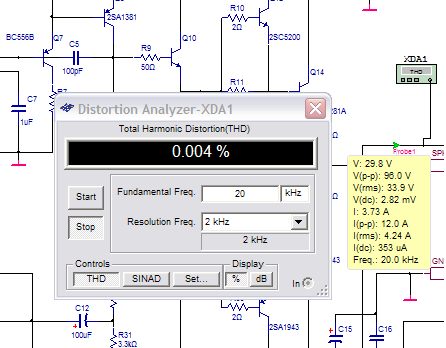

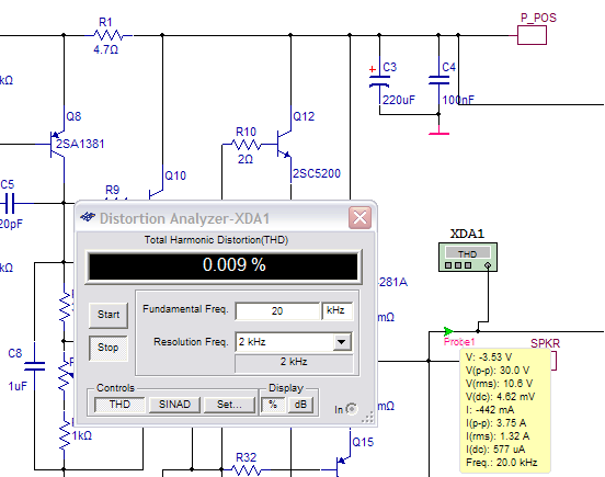

Hi ferencz,
Like mega said AND also check idle current. Best results at 50-60mA per device.
Also, as mentioned, models make a huge difference. I have known good models that I'm working with. I have updated quite a few in my library and download from reliable sources (like Fairchild).
Here's what I have at 20kHz. Input signal 500mV, output power ~14 watts. At full power (145 watts) I get .011%.
Since I can't hear much above ~12kHz anymore, it's not a big deal for me. Still, given the test results from the original amp, these figures are very close to actual, and truly as good as they need to be.
Nico Ras said:
I confirm your findings. At 1kHz it is 0.0084%. Also Q3 and Q4 worsens matters slightly and could be omitted.

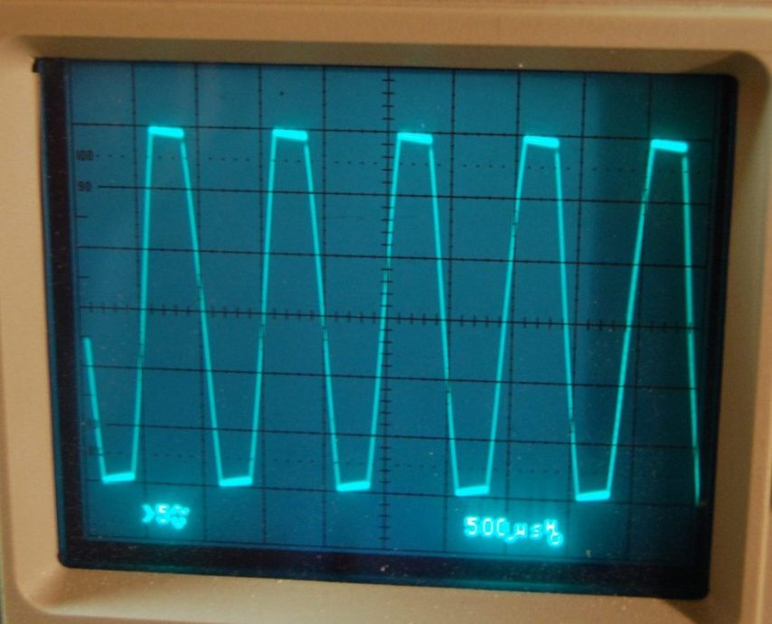

More like this. This is at full output power. Fact or fiction, it's what the machine says.

I have registered at B&D and found the 970/2240. When I get the chance, I will order some of these excellent looking units.
No, Digikey doesn't sell the 2SA1011, I bought those last year from AmpsLAB.
I did get the 2SB1011 (Panasonic) 2SA914 (Panasonic) and the new ones - 2SA1381 (Fairchild) at Digikey. The outputs are Fairchild 2SC5200/1943. 25 of each.

I changed the outputs and the VAS in the prototype. Stability is awesome. Base stoppers for the outputs are still shorted, so I'll be getting rid of those in the final design / board layout.
I won't show how it looks handling a 100kHz squarewave, because I promised...
But, I do have a clipping pic to share. This is clipping at +/-30V rails, my lab supply maximum.

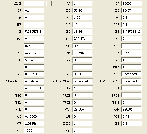

homemodder said:Bad models probably, try these

Those are different from the ones I have.
The ones I have were downloaded from Fairchild and are excellent models, giving performance equal to or better than andy_c's models.
TRY them

MJL21193, thats strange my models also come from fairchild, why are they different.

homemodder said:MJL21193, thats strange my models also come from fairchild, why are they different. [/B]
Just a final note, no two manufacturers make identical parts. That is why an engineer will specify a particular manufacturer for a particular part.
If AndyC has optimized the On-Semi part let me assure you that it will not be optimized for another manufacturer.
Anyone assuming that a BC550 from Philips is the same as a BC550 from another manufacturer lack experience.
Nico
homemodder said:
One quick look at the last the last models that MJL21193 put up, and ll tell you straight away they are offspec. For one I doubt a power transistor like 2sa1943 can have a early voltage as high as 100 and its less likely that it will math the voltage of the npn counter part. What is useful with a model in a design is that you can play around with certain parameters to see what effect it has on a design, like decreasing cob on a model and verifying its impact on say a vas. Again its only a guide on how certain parameters are going to influence the design.
Hi homemodder,
I don't know why they would be different, the models come from here.
I believe these are good because when used in their dedicated purpose (outputs) they don't increase distortion in the simulation, over using the MJL models from andy_c. In fact, distortion goes down slightly with these models. My logic is that the device, if well matched to the purpose, should not be a source of significant distortion, therefore lower is more accurate. Am I wrong in this assessment?
Changing VAF and VAR to another value seems to have a negligible effect on the simulation performance for this type of device anyway.

First the design on this thread - Patchwork:
Next is the venerable Krell50:
SYMASYM:
And finally ESP project 3A:

Hi Nico,
There is some validity to my tests, even though I picked a fixed input signal which has each amp outputing different amounts of power.
I re-did the tests, making the output power approximately equal in all four (15 watts into 8 ohms). The results were not much different. Tests at 20kHz, 3 harmonics.
Patchwork: .00272%
ESP 3A: .03627%
Krell 50: .00281%
SYMASYM: .00769%
Tests at the same power output at 1kHz, 9 harmonics.
Patchwork: .000112%
ESP 3A: .014476%
Krell 50: .001407%
SYMASYM: .003651%
