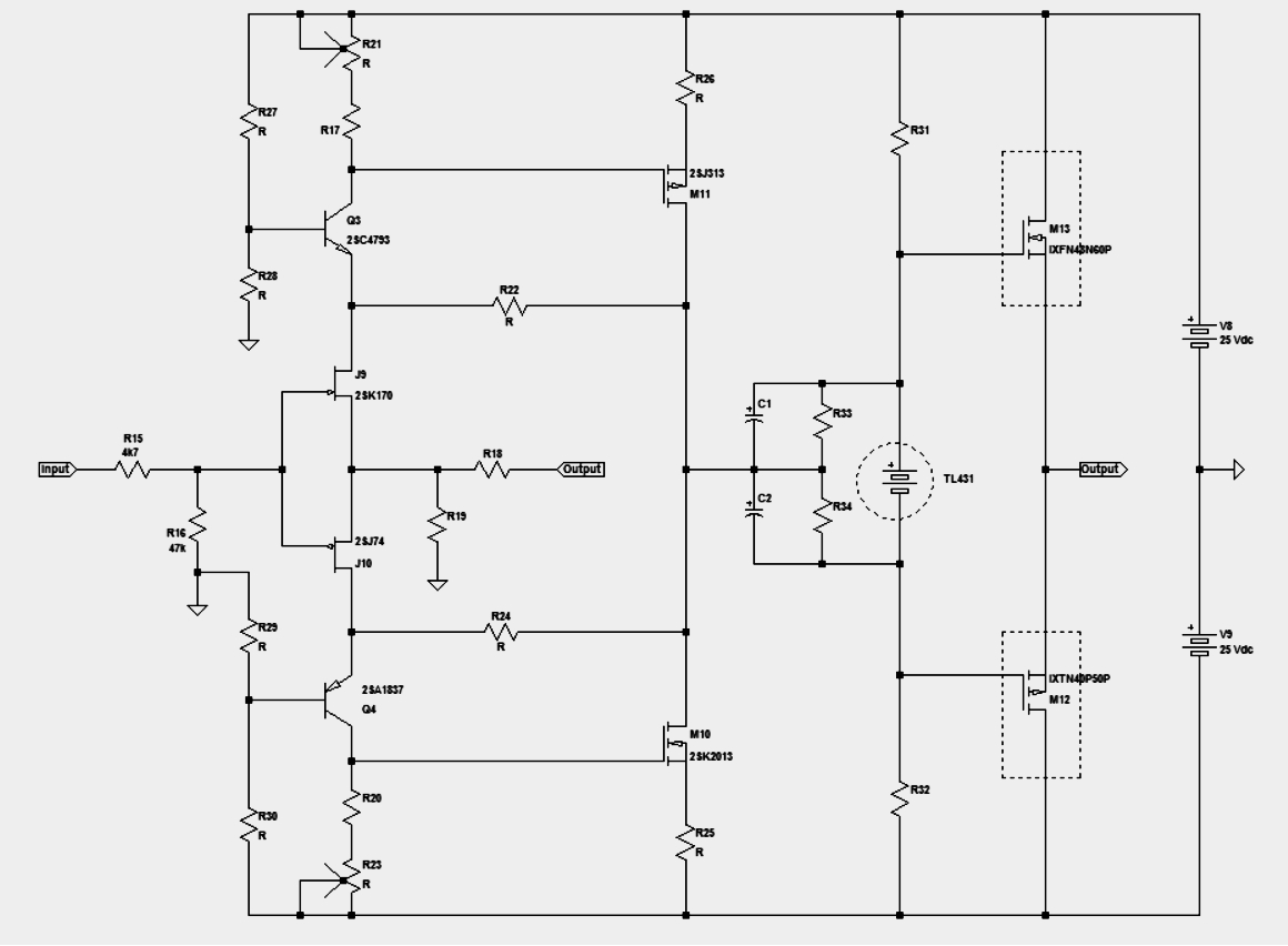

Thank you Zen Mod and Mr. Pass for your help.
Ok, so the bias generators are floating with respect to the Front End AC output.
In this fashion. it is indeed possible to get amplitude of the output signal to swing very
close to the PSU supplies with very little headroom loss.
Is the Front End AC- or DC-coupled to the Followers?
OK, Interesting info from Mr Pass and Zen Mod.
Please look at the schematics below:
- The TL431 is used as a differential variable Voltage Reference, biased by resistors.
- The two resistors connected in parallel with the signal capacitors (unavoidably electrolytic) make sure Front End is DC coupled to the Output Stage.
- This is the most simplified arrangement I can think of that probably works well.
- In this fashion, the headroom loss, due to the combined Vgs-threshold voltages of the output complementary-pair transistors are eliminated.
What do you all think??

understanding of all published info is that there is no source degeneration anywhere
so - toss R25 and R26
also - with that simple biasing mechanismus , prepare plenty of heatsinking and expect pretty big difference between cold and temp equilibrium
I believe that in other thread you'll find few interesting implementations of small sized NTC around TL431
though , I'm almost 100% positive that there is no single TL431 in XA25

Well, I have thought about it, although there is no engineering justification for it - specially in reference to the XA25 design, but I guess it would be possible.
Yes, this is just a "conceptual" schematics. The details might not be there.
If more than one Voltage References are used, then it would be possible to adjust and tweak the n- and p-channel bias voltages independently.
On the contrary... I have looked at this for sometime and in some detail. Degeneration in a gnfb amp is sometimes a necessary evil, but it's evil all the same. If you can avoid it, so much the better.
I hear you, but please elaborate.
Otherwise I stand firm on the fact that there are no engineering justifications for it, as there are
no advantages in a complementary VAS stage design, particularly in a commercial amplifier, as in Pass XA25.
Unless someone from Pass Labs comments otherwise, I am willing to bet that degeneration resistors ARE USED in
the XA25 VAS stage (2nd Voltage Gain stage with the MosFets).
I believe by stating in the XA25 literature that degeneration is not used, Pass Labs is referring to the fact that the OUTPUT pair Q's are not degenerated.
That is of course a possible design decision since there are two important advantages of not using degeneration here.
So my guess is that in the XA25:
- the JFETs (input pair): are NOT individually degenerated
- the MosFet pair (VAS): are indeed degenerated
- the Ouput MosFets (follower stage): are NOT degenerated.

I don't think it's that big a deal esp if you use relatively little degeneration, but the 'engineering" effect is there for sure, it's not voodoo :D
And other than output fets, smaller ones don't tend to run away (thermally) and explode when you don't use a source r.
Anyway like I said, it's not that big a deal and sometimes I have to use them to get to a convenient Dc operating point. But I always try and do without if I can.
The one and only
Joined 2001
The justification for going to the trouble to avoid degeneration is that
it sounds better. In the case of the output stage, it also increases the
Class A envelope for a given bias.
Actually it is not difficult to work the VAS without degeneration if you want
to use the right parts, heat sink them well, and adjust them carefully. It
takes more time and money, things that most manufacturers avoid.
Keep in mind that if the output stage bias networks are driven by VAS
current, variations can create issues with the output stage bias.
