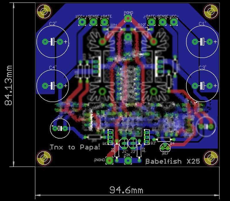

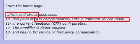

--------------------------------------------From reading entire theme:
1. front end is common source, not output
2. from picture it is obvious that output is common drain
And a little of ideas for biasing

I am sorry, but your circuit proposition and comments do not make any sense, specially in reference to the XA circuit description (XA manual).
Have you simulated it? What is the basis of your idea?
Why do you ask me did I simulate if you think this does not make any sense?
No I didn't simulate this, not having intentions on building this amp, nor its iteration, just curiosity on used topology is driving me thinking of it
Don't think you did get wrong the image with output FETs - it must be common drain.

however ... blurred part is still blurred
regarding original topology - not so hard to decipher for Papaland residents
though , as always with Papamps , Natura in minimis maxima ........
there is tricky part , instead of TL431** ......

Oh no the secret is loose 741 on the bottom side
I think the cap screw plating gave that away too.
as I said in beast thread ..... I had few (pretty damn precious ) breadcrumbs** , tossed by Papa , without these my cogs couldn't start spinning , stuck in front of myriad options
**as always he's succeeding in confusing me even more ,deliberately tp question replying with question or , in best case , simple one - liner
result is that I'm understanding exactly what he said ..... years after
anyway - conclusion - even if I have "just" Babelfish of original circuit (it must be different ... enough) , I can't share what I have without giving up those breadcrumbs . They simply aren't mine to share.
and , yes , amplifier is DC coupled ,it has no DC servos or frequency compensation ......

ZM: Could you explain what you consider to be or not be a DC servo? A broad definition might include any feedback mechanism that senses a signal such as bias current of voltage offset to adjust those currents of voltages. A stricter definition might narrow the class of circuits to ones using opamps. And what about thermistors? The broadest definition might also include them.
ZM: ...yes , amplifier is DC coupled ,it has no DC servos or frequency compensation ......
....A stricter definition might narrow the class of circuits to ones using opamps. And what about thermistors? The broadest definition might also include them.
An interesting point...
Pass XA-25 feedback network probably consists of two resistors, setting the Closed Loop Gain of the whole amplifier - starting at DC.
So you might say that it certainly contains a "DC servo".
One that has equal "gain" to the rest of the frequency spectrum.
In the case of XA-25, with the gain devices used and their arrangement in the final circuit, I believe
there has to be a reactive component in the feedback network (usually a fairly small cap).
of course it's having DC servo , intrinsic one , or circuit will go berserk
agree with you about terminology , let's say that DC Servos are any sort of OP amplifier used as output DC offset correcting circuit , while no having influence on gain stage linear operation
these OP amps being either chip , or as simple as diff pair
I would say that NTCs can be sorted as simple current/voltage correcting devices , thus not falling in circuit category , so can't be Servos
