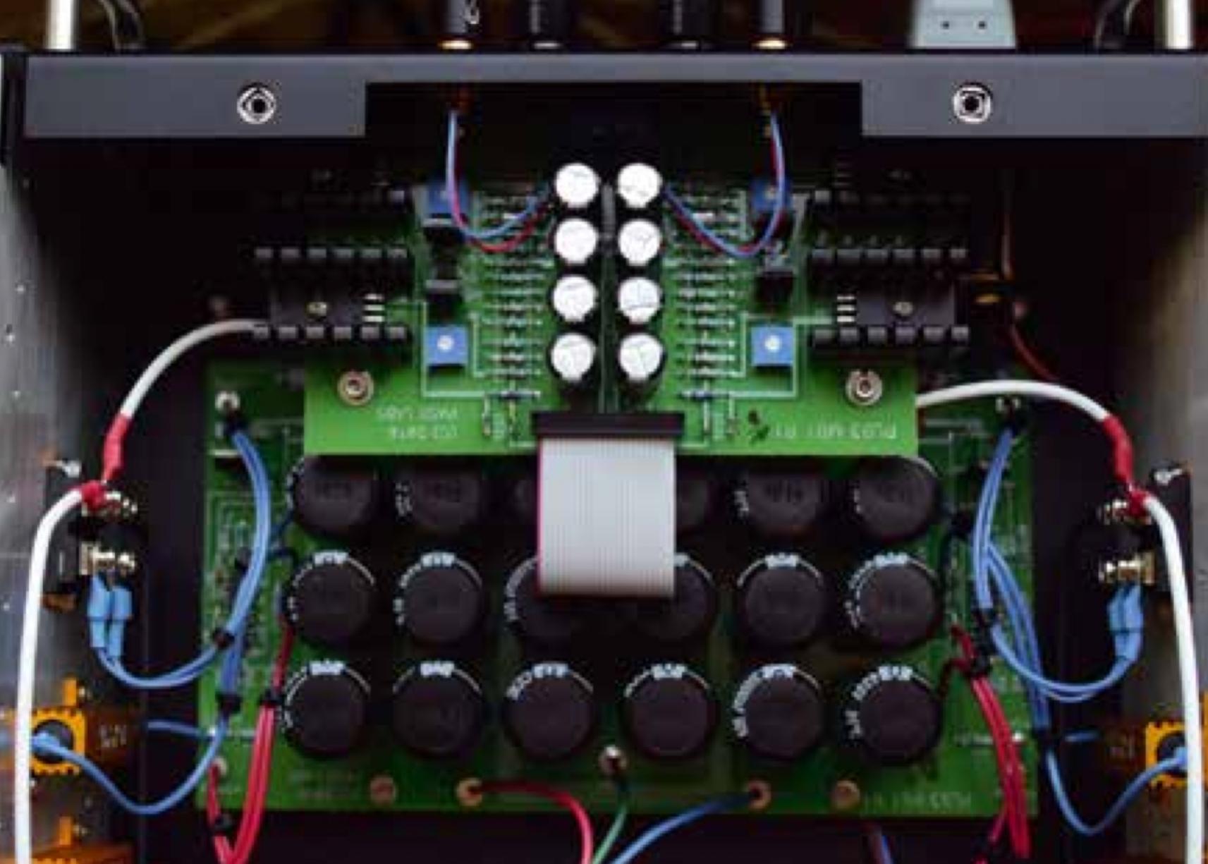

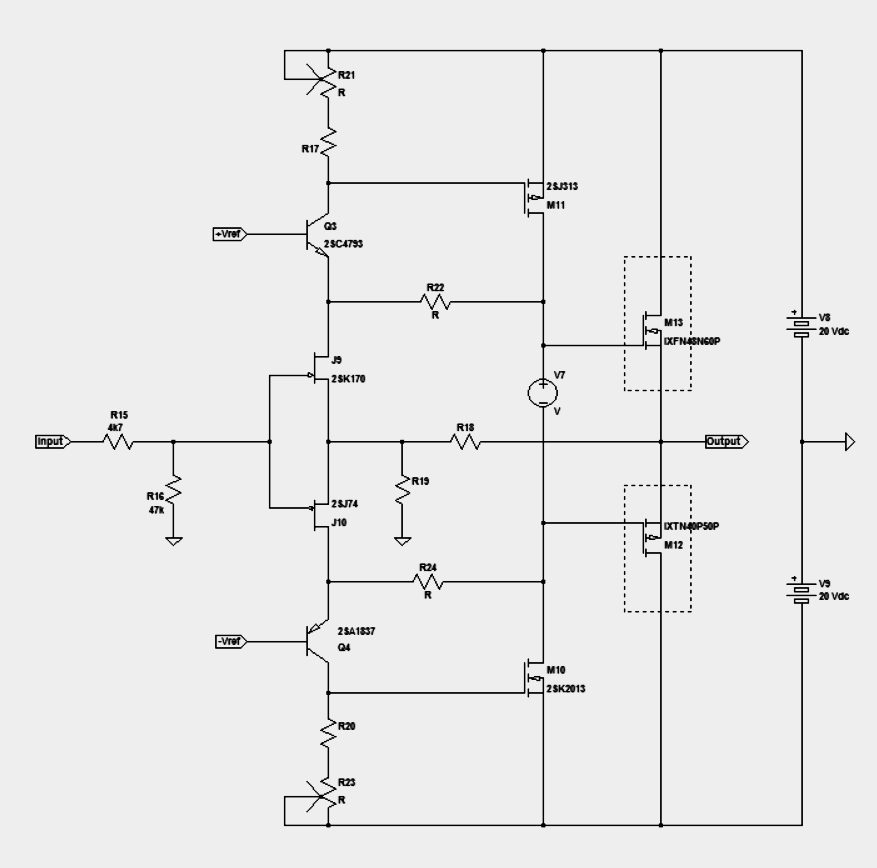

Well, I looked carefully at the picture downstairs (see the attachment) and it appears there are 2 pots for
each channel, very close to the Input Cascode Q's.
By following the PCB traces on the picture, it also appears Pass Labs has applied the so-called "Cascode Feedback"
enveloping the first and 2nd stages. But I'm not 100 on this as the picture quality is really low. Please see the schematics below.
What needs to be figured out is the electrolytic caps on the main PCB:
Are they in the signal path? or are they PSU/Voltage Reference decouplings.
Any ideas?

I would like to know more about the electrolytic caps on the main (upper) PCB.
What are your thoughts?
Looking at this picture, I noticed some circuitry on each side of the bottom PCB.
Those might be the bias generators.
I do not see any degeneration resistors for the 2nd stage Q's.
However they might be there, since it would be very difficult to keep the bias fairly constant without them.
The electrolytic caps are still a mystery. I do not see any TL431 on the PCB, so the reference voltages for the Cascode devices might be
done with resistors or zeners, but it is not possible to decipher it from the attached pic.
Would appreciate any comments.

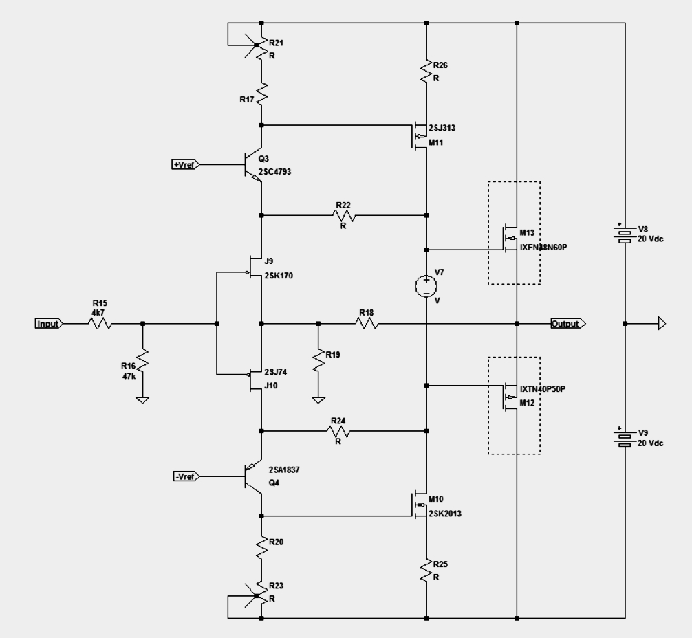

Anyways, back to the circuit:
I have thought about it a lot and I am almost certain degenerative feedback is used in the 2nd gain stage.
It would otherwise lead to serious (and unnecessary) drift and function instability.
So the proposed schematics is once again modified to this:

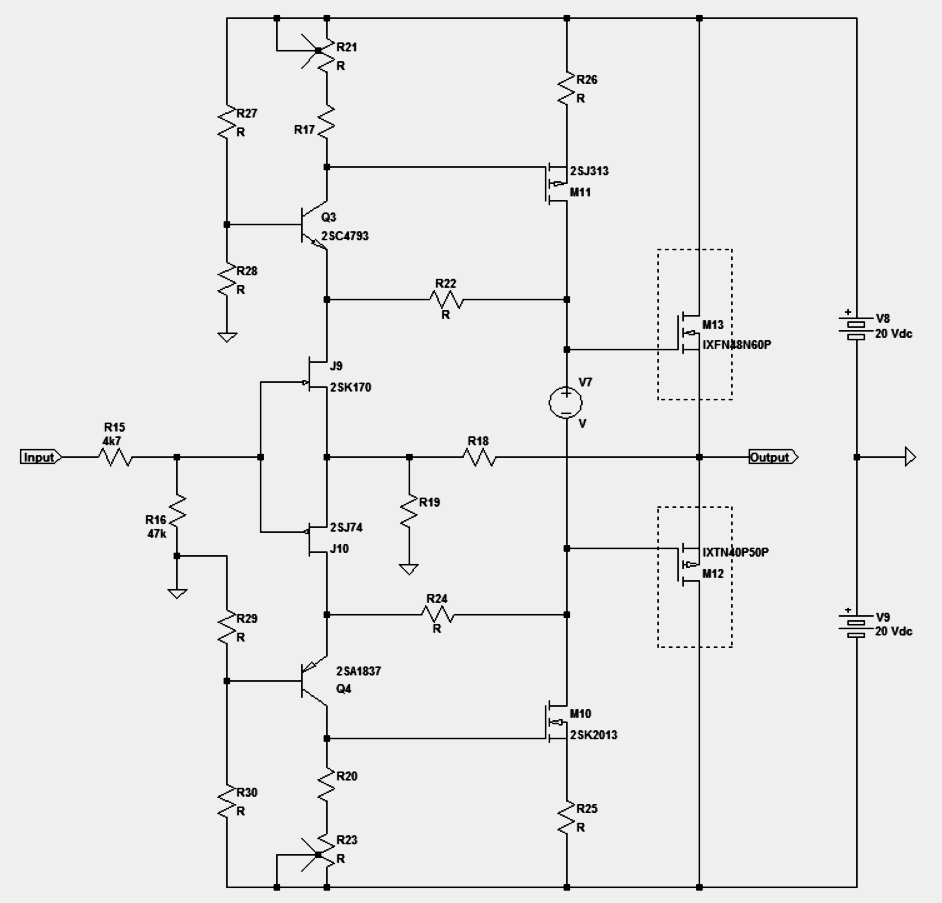

The way the output followers are connected to the FE and biased in the F4 Beast thread is (according to my opinion) not the way XA-25 is implemented.
Therefore I think the electrolytic caps on the main upper PCB are PSU decoupling caps, as I do not find anything else to contradict that theory.
There seem to be no TL431s or any IC references on the board.
Being somewhat familiar with previous designs of Mr Pass, the voltage references might be comprised of
zeners or resistors.
Let's go with resistors for now.
The updated schematics is:
