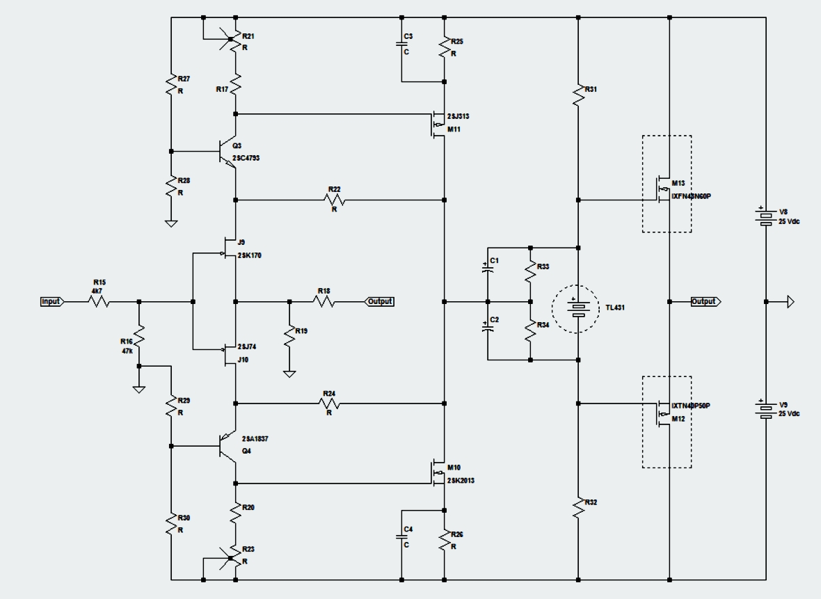

Radule, please take a look at the schematics below.
There are two resistors that are now bypassed by capacitacnces in the Source circuits of the MosFet VAS.
Is this how you mean? thanx

The open-loop gain will increase dramatically with the caps. That must be considered.I heard the version with 3300uF Silmic II caps parallel to my 47R source resistors in the second stage.
I prefered soundwise the version without caps in parallel.

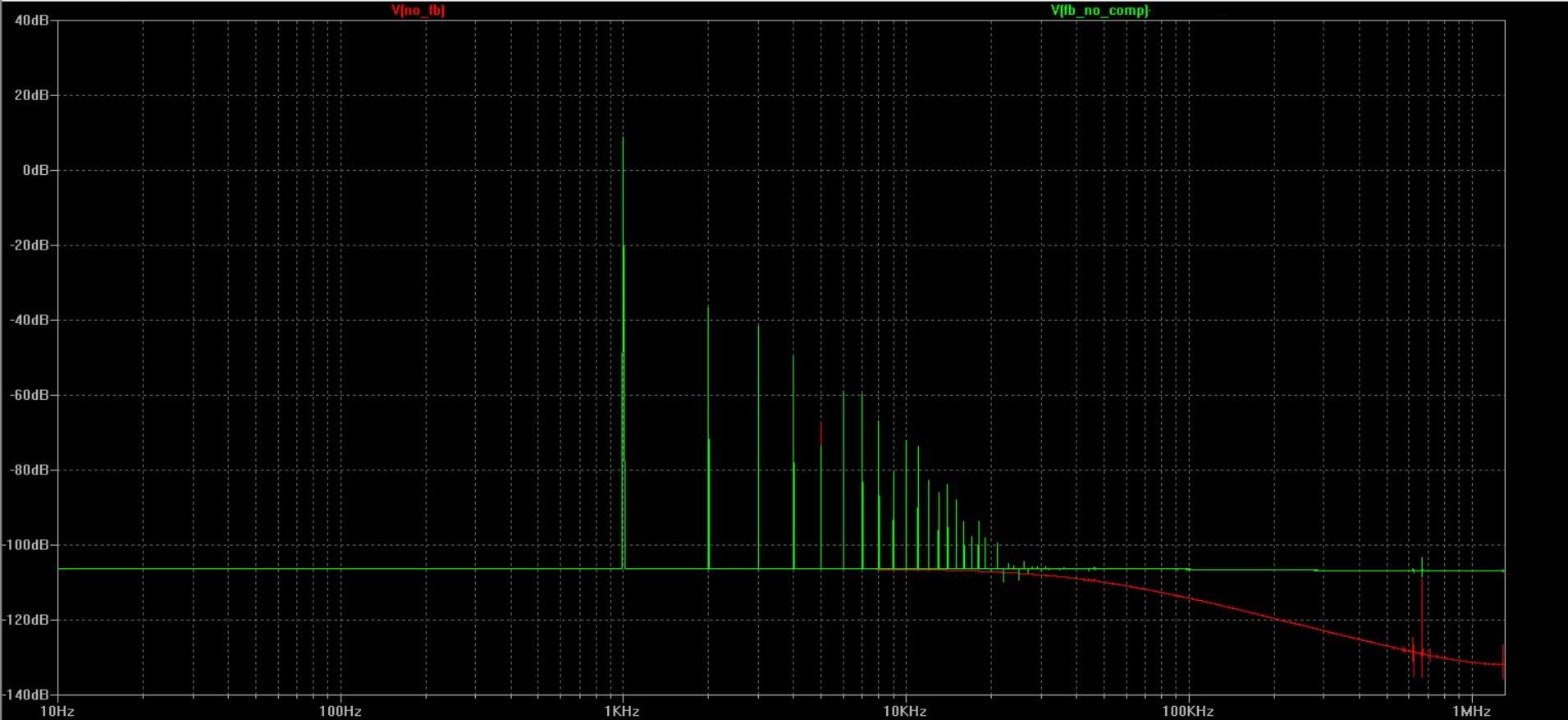

I could not find any info on the gain stage used to produce those sets of measurements, and its Open Loop
characteristics, that is, the amount of available Gain vs Frequency.
If you are referring to figure 10, it is a reprint of the graphic offered by
Peter Baxandall many years ago. I recall that it was a bipolar device, but his
full paper is available on the net, and was also incorporated into John Linsley
Hood's book on linear audio circuits.
If figure 11, it was as stated - a Mosfet operated single-ended Class A at
1 watt into 8 ohms with varied Source resistance. It is only intended as
an example of the altered distortion complexity with degeneration.
------------------------------------------I heard the version with 3300uF Silmic II caps parallel to my 47R source resistors in the second stage.
Fascinating....
This is exactly what I experienced myself when I bypassed the
Source degeneration resistors with a pair of 470 uF Rubycon ZA series caps.
The sound slightly lost its clarity and air.
I tried many other caps and values and
anything smaller than 50uF dramatically altered the sound.
I preferred the sonics with the degeneration in place. Strange....
--------------------------------The open-loop gain will increase dramatically with the caps. That must be considered.
You are absolutely right of-course.
However it is very much device-dependent.
The gain of Vertical MosFets vary considerably from sample to sample.
Without degeneration you will have - exactly as you said - unpredictable Open Loop Gain variations.
Everything from low to very high. Specially without a stabilizing bias arrangement.
But the increase will not always be as dramatic.
Particularly in the case of the XA circuit in which I suspect Cascode-Feedback is used to linearize the Aol to an optimum value.
Nevertheless it is an interesting design decision, from one of the leaders in
Audio amplifier industry. It will require a lot of adjustment and matching in production.
But one can equally question why God created the Heavens and the Earth....
...He certainly had less headache without them.
Anyhow, the bypassed Source resistors was not a (sonically) good idea.
So I think my version of the XA25 concept will feature Source degeneration.
I am going to try to build one without degeneration altogether and see what happens.
My problem is that I am using slightly older Harris parts with massive Gain. They runaway instantly, making them
difficult to use in a real circuit with no degeneration. Mounting them on a huge heat-sink did not help either.

....a Mosfet operated single-ended Class A at
Very interesting result.
Applying series-degenerative-feedback in a Single Stage Fet Amplifier with an 8 ohm load would lead to
alteration of Vds across the Gain device and the output impedance.
That might be the cause of the increase in higher harmonics.
Have you had the chance to perform THD tests with the above-mentioned parameters kept constant?

Simulations
Let's run some simulations on this.
Let's create a circuit as follows:
A single stage, Single Ended, MosFet (IRFP240) biased by an 8 ohm resistor, having 11 Vds and 2 Adc through it.
Then we create two versions of it:
- One with no degenerative feedback applied,
- The other with degeneration feedback amounting to approxiamtely 15 dB.
According to Mr. Pass paper, there should be higher amplitude on higher harmonics components on the FFT
analysis of the output signal.
Let's see:
Let's see:
- Pass XA25?
