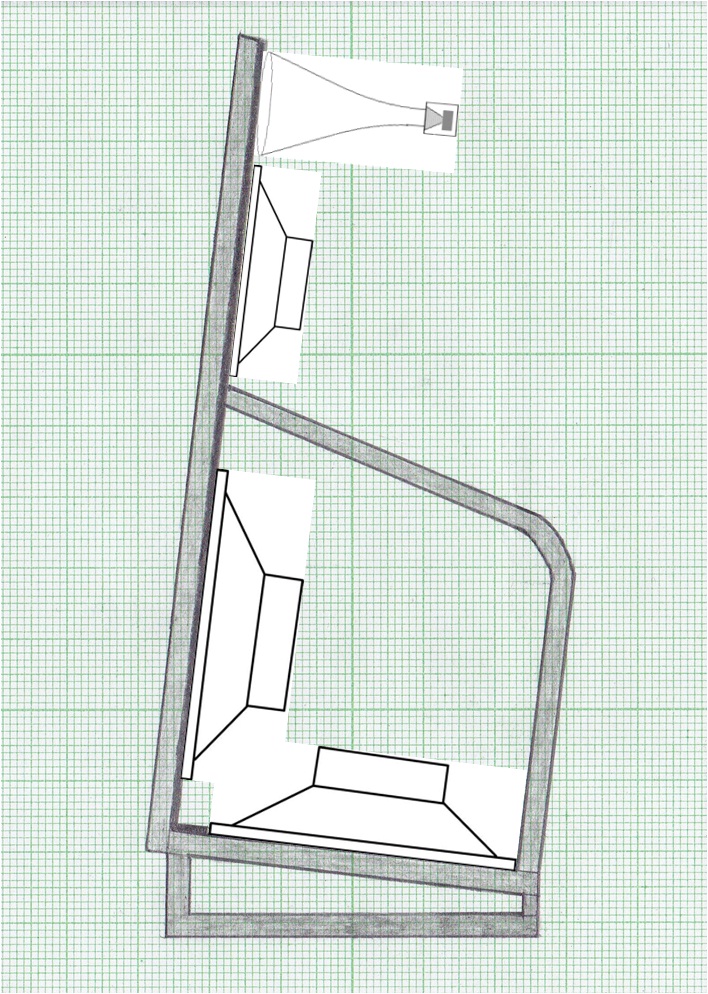

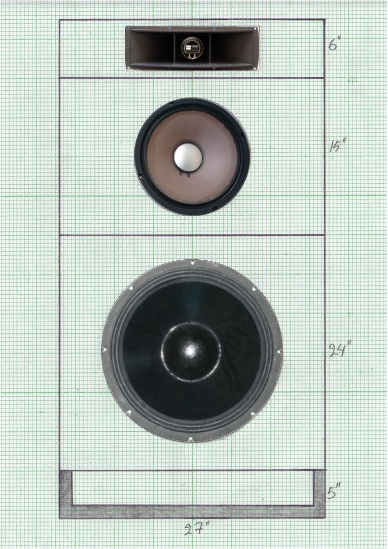

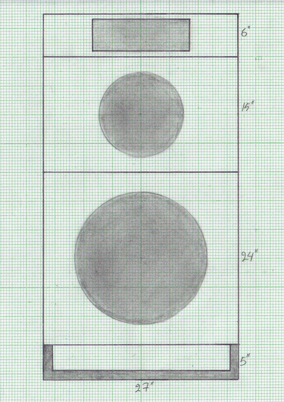

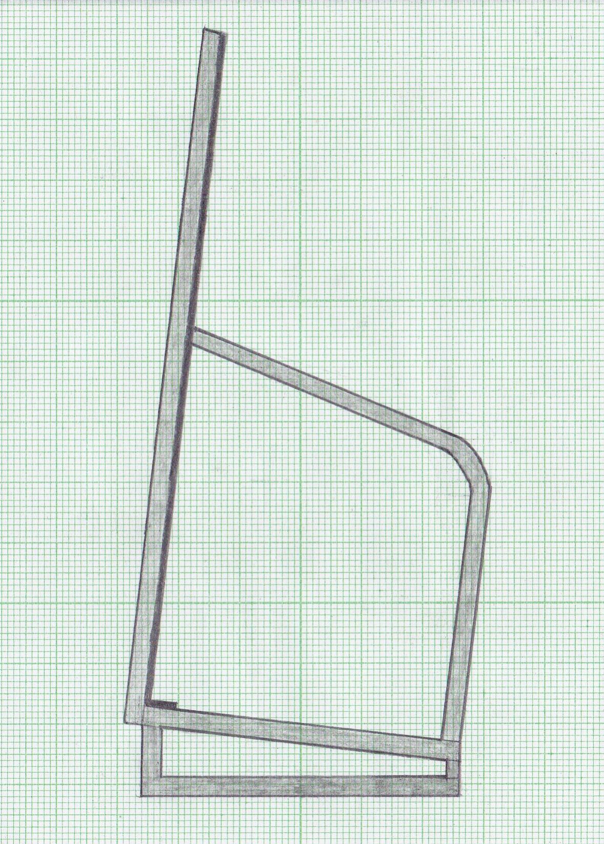

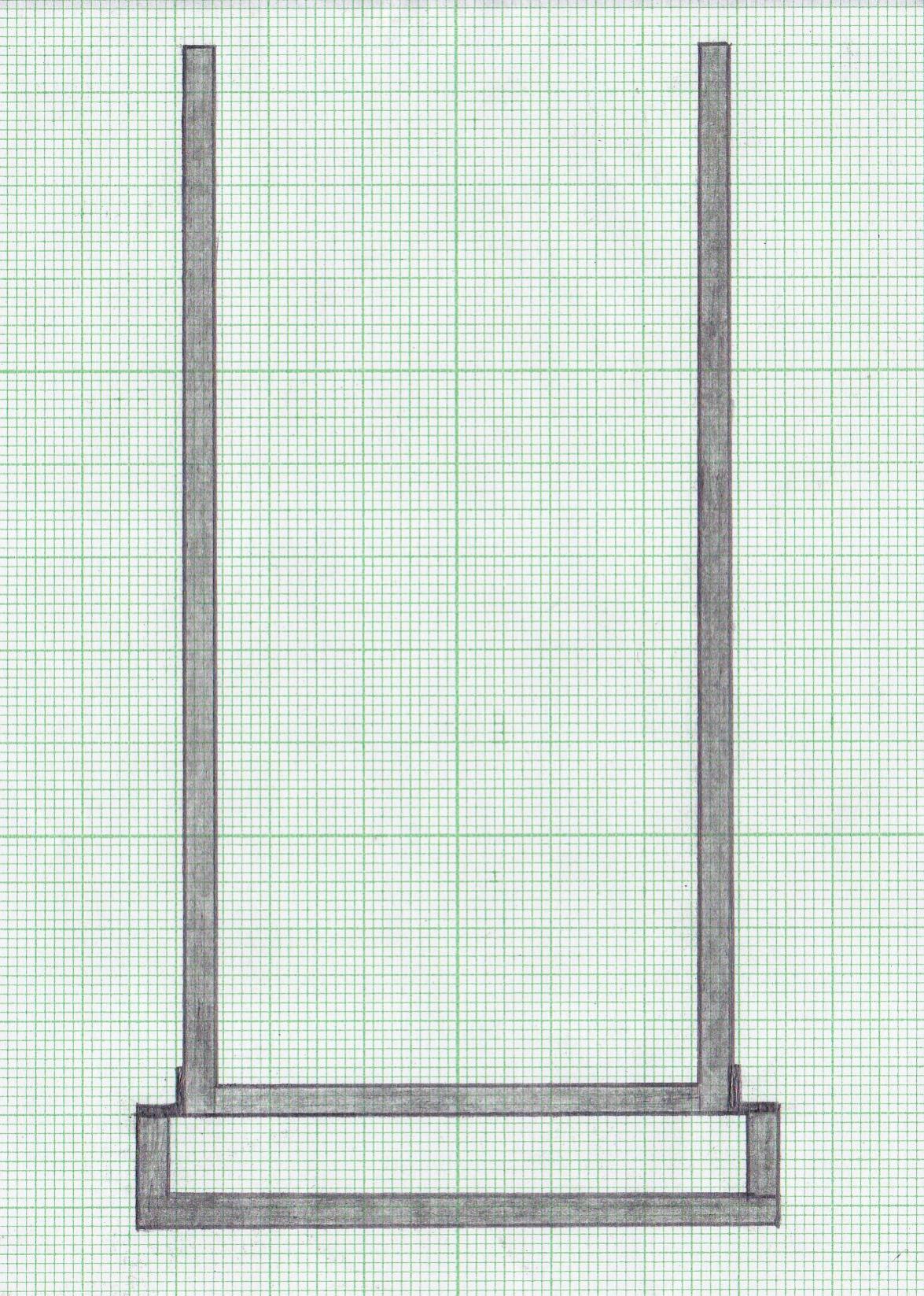

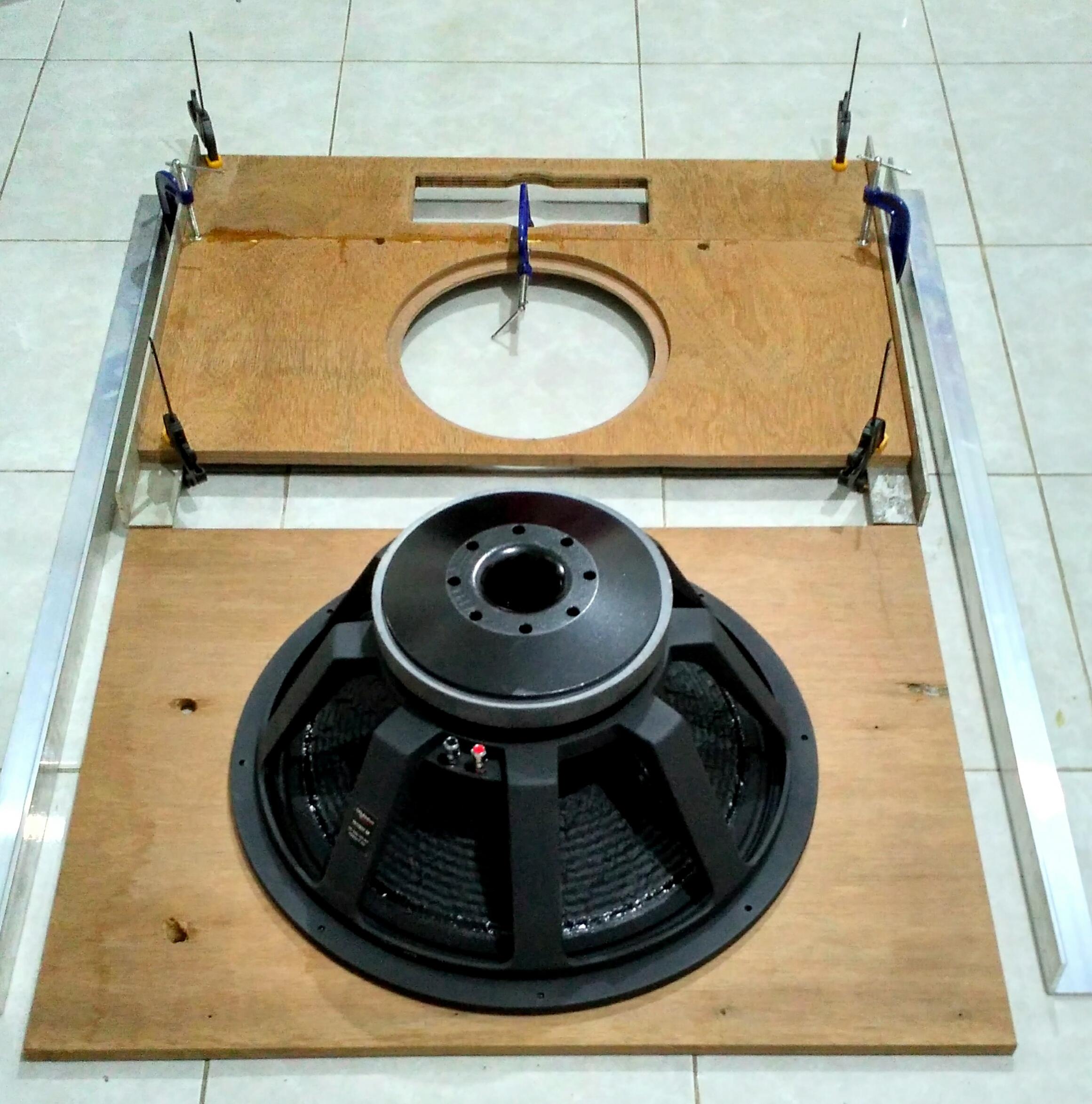

Finalizing my layout this morning on milimeter paper, editing and combining those pictures takes longer

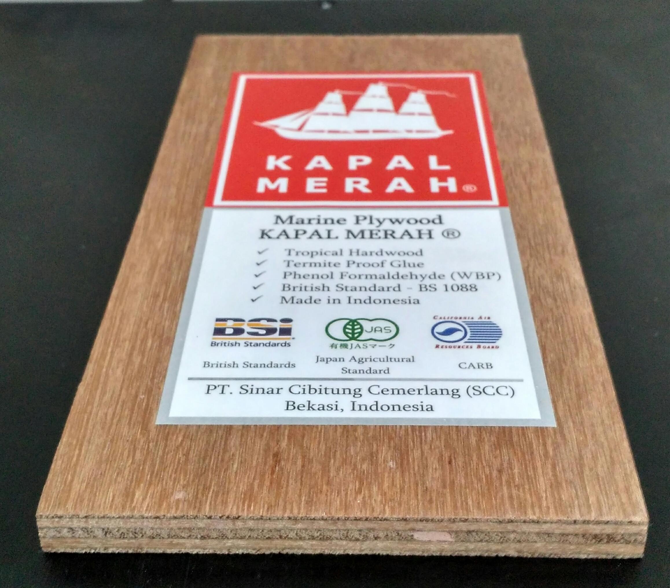

Using red meranti marine plywood 9mm with stacking 3pcs should be strong. Bottom slot, wings, and front baffle will be modular, connected by aluminium L plate 50x50x6mm. Front baffle 27"x45" will be separated into 3 sections in order to make easy FR & HF driver rolling.
2x ACR Fabulous 100185 18" subwoofer
Fostex F346 12" fullrange
Fostex FD600 & H500
I'm looking at some finished speaker as my reference for finishing, it seems sonus faber elipsa is fabulous wish me luck..

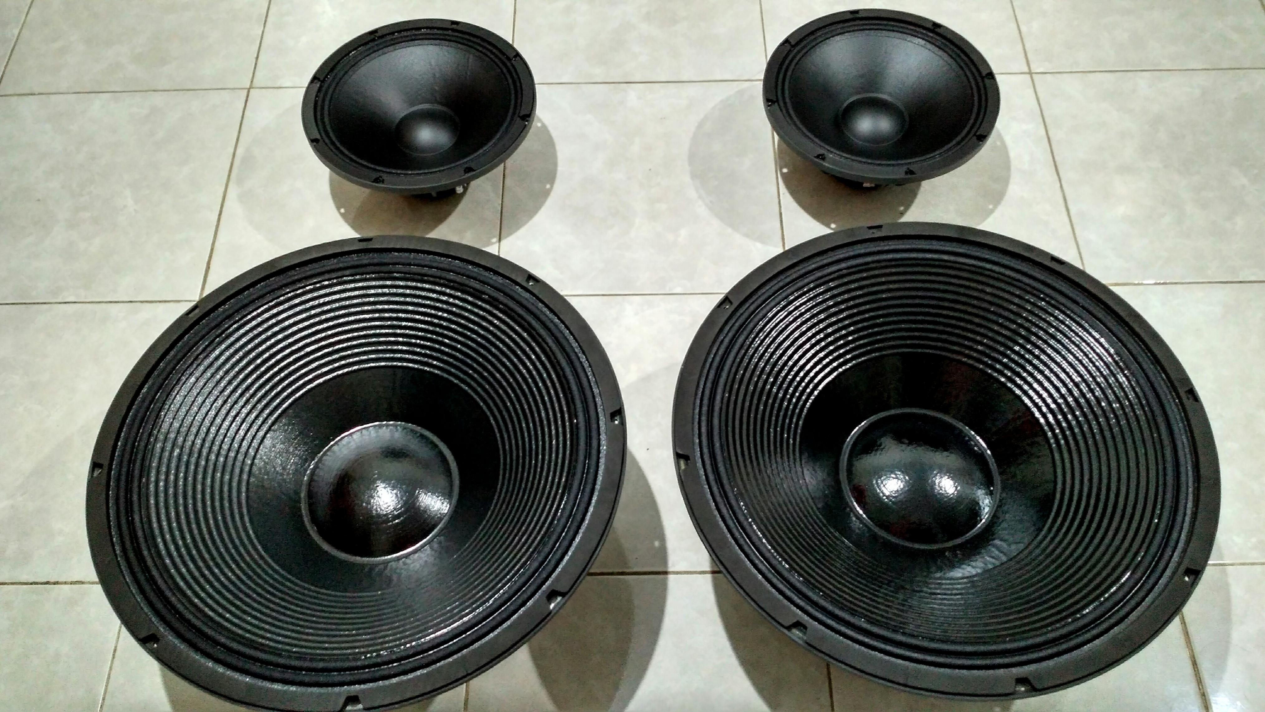

Just visited Sinar Baja showroom in Jakarta, i was like a kid in toys store all Satori line up in the show case is so tempting to test but it was not my intention.
first objective to get 12" for mid, it was easy choice to choose this one which has neo magnet, nice cast frame
12? PA- 75124 W-N FABULOUS BY ACR | ACR Speaker

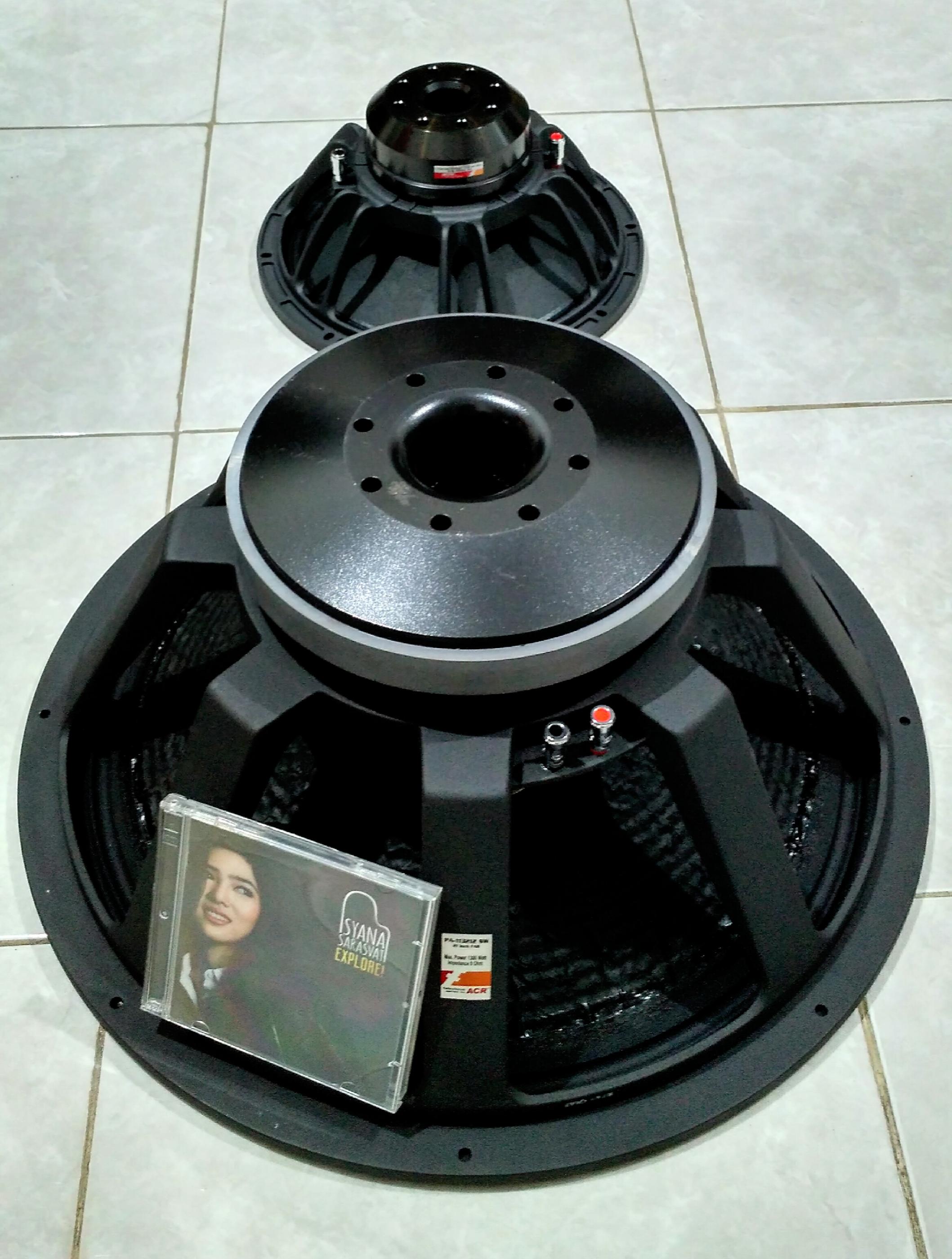

However it was hard to pick which sub for my OB, after testing some 18" and 21" then absolutely my choice is 21"
21″ PA 113212 SW FABULOUS BY ACR | ACR Speaker
this beast with big oommmpphh on free air, 18kg weight, strong magnet, seems perfect. might need to buy another pair in next few month.
12" neo is $315/pair, 21" is $440/pair
now my 20" wide baffle seems tiny and those entry level 15" woofer might not be used anymore.
it's time to build 30" wide baffle and bottom slot loaded

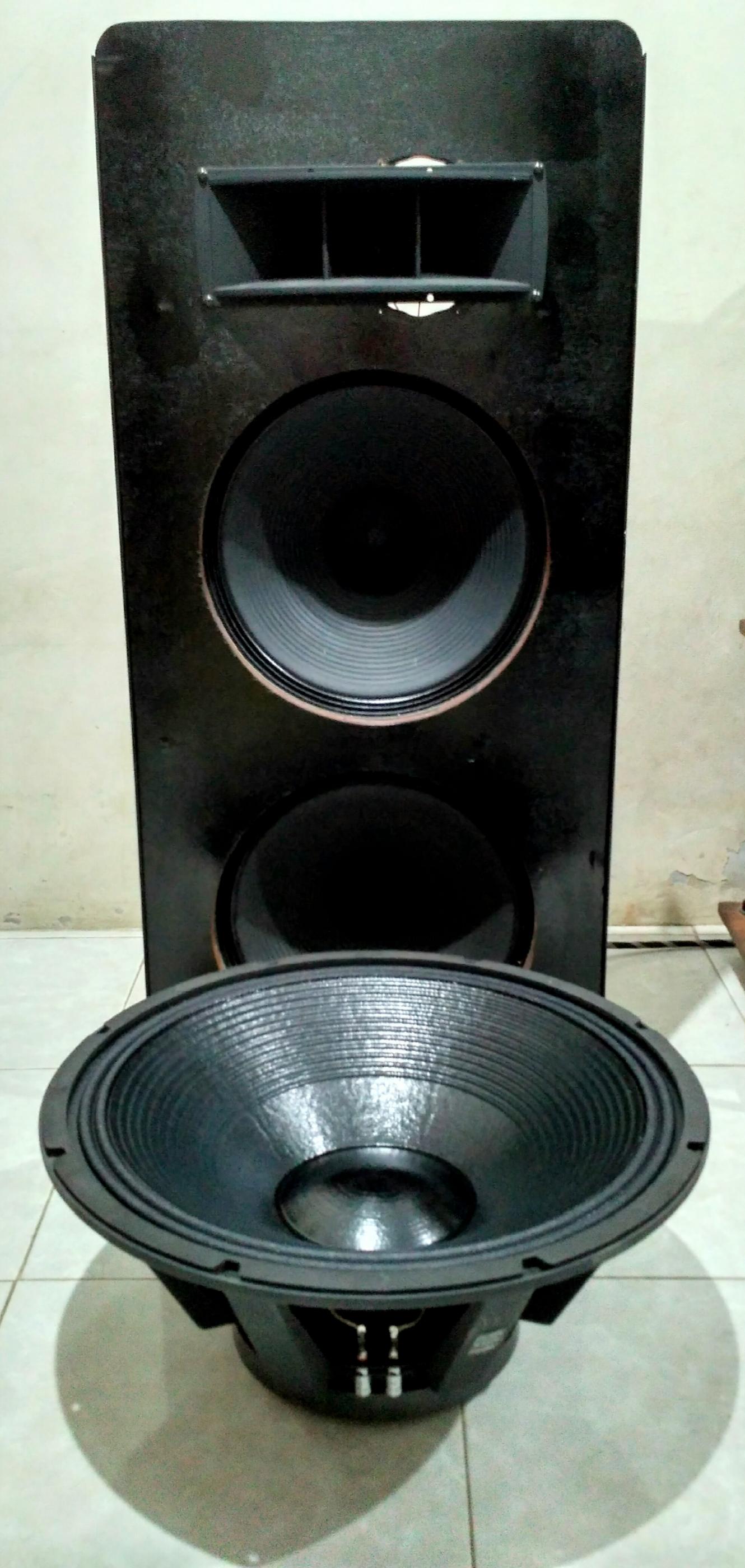

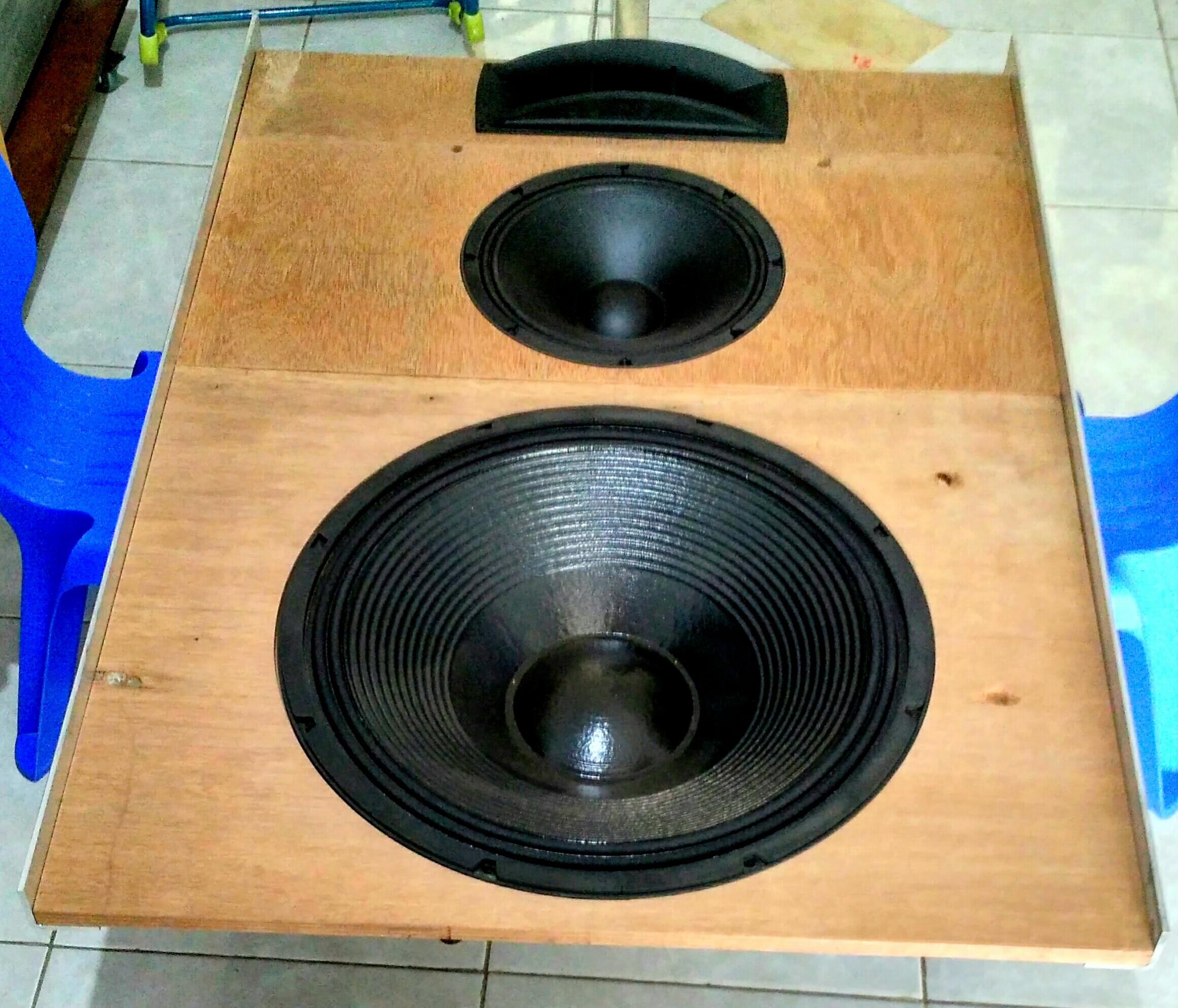

bought my first jigsaw, trimmer, sander and started cutting wood. watching youtube guide for dummies woodworking help alot. since i'm afraid to use circular saw, and table saw is not an option, i have to cut with jigsaw first (extra 3mm) and clean up with trimmer. takes time but precise cut. making those flush mount hole was also a big challenge
my original plan was to make 3 separate panel and connect them with aluminium L plate, but later i think that making them into 1 panel should be more solid. now i have to glue 1by1 since not many clamp that i have. it will be repeated with 2nd layer to make 2x18mm plywood. still long way to finish.
it's fun for me, but not for the family members. loud noise and dust on backyard should be compensated with my wife lovely hand bag and my twin boys want extra toys too
already in shape now, just tested those 21" with gainclone, eventhough had given extra bass boost on windows setting and wmp equalizer, it seems it requires an amplifier with extra muscle. while my laptop dont have enough gain to drive aragon2004. another adventure to get proper amplifier, maybe i should build PA amplifier with 1kW rating.
testing 12" mid and horn with passive 2nd order filter @1.6kHz with class a amp gives me another AHA moment
need more weekend to complete them
