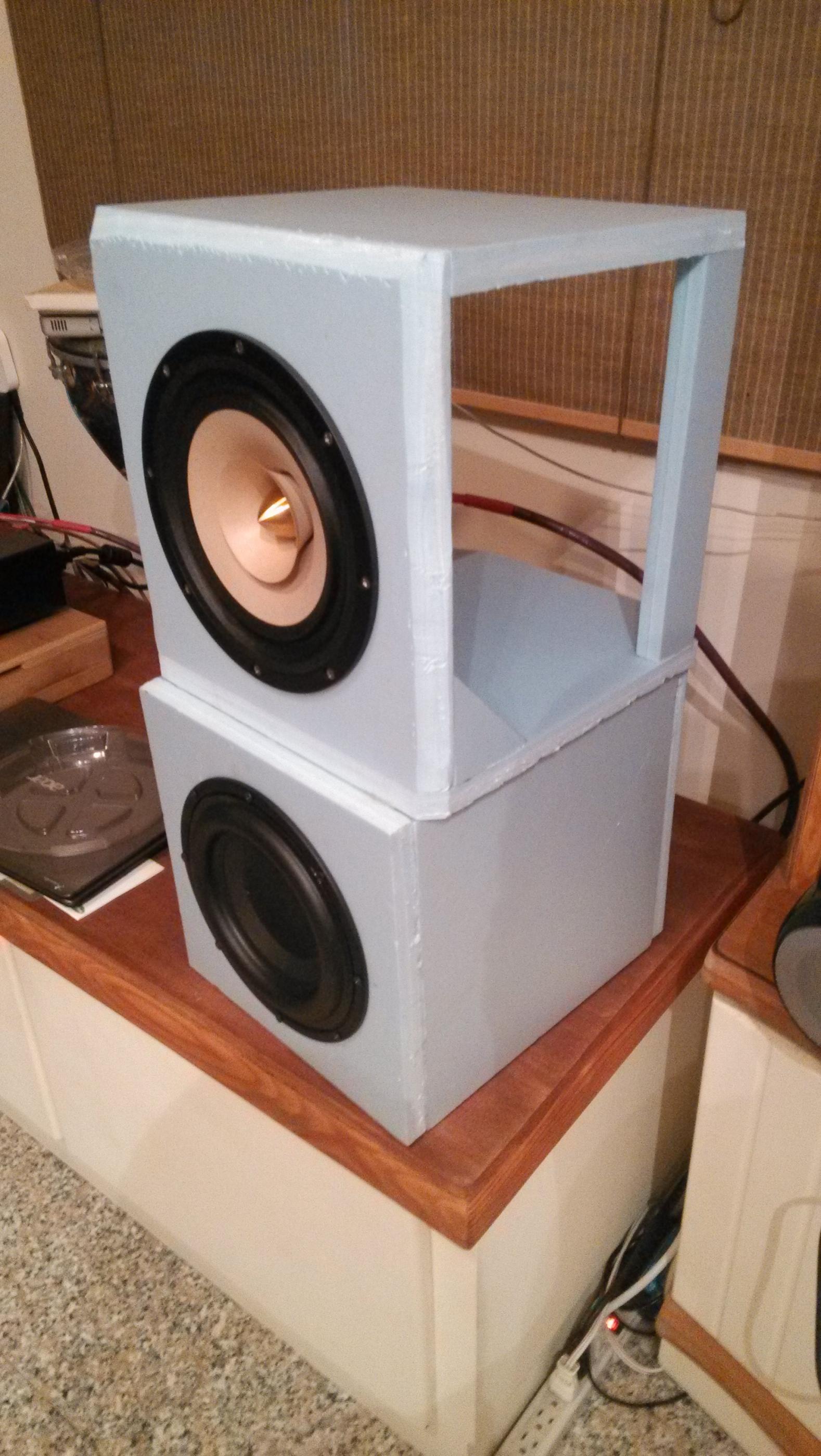

This what I came up with. Really enjoyable.
They will get real enclosures soon. The foam boards are for quick design experiments.

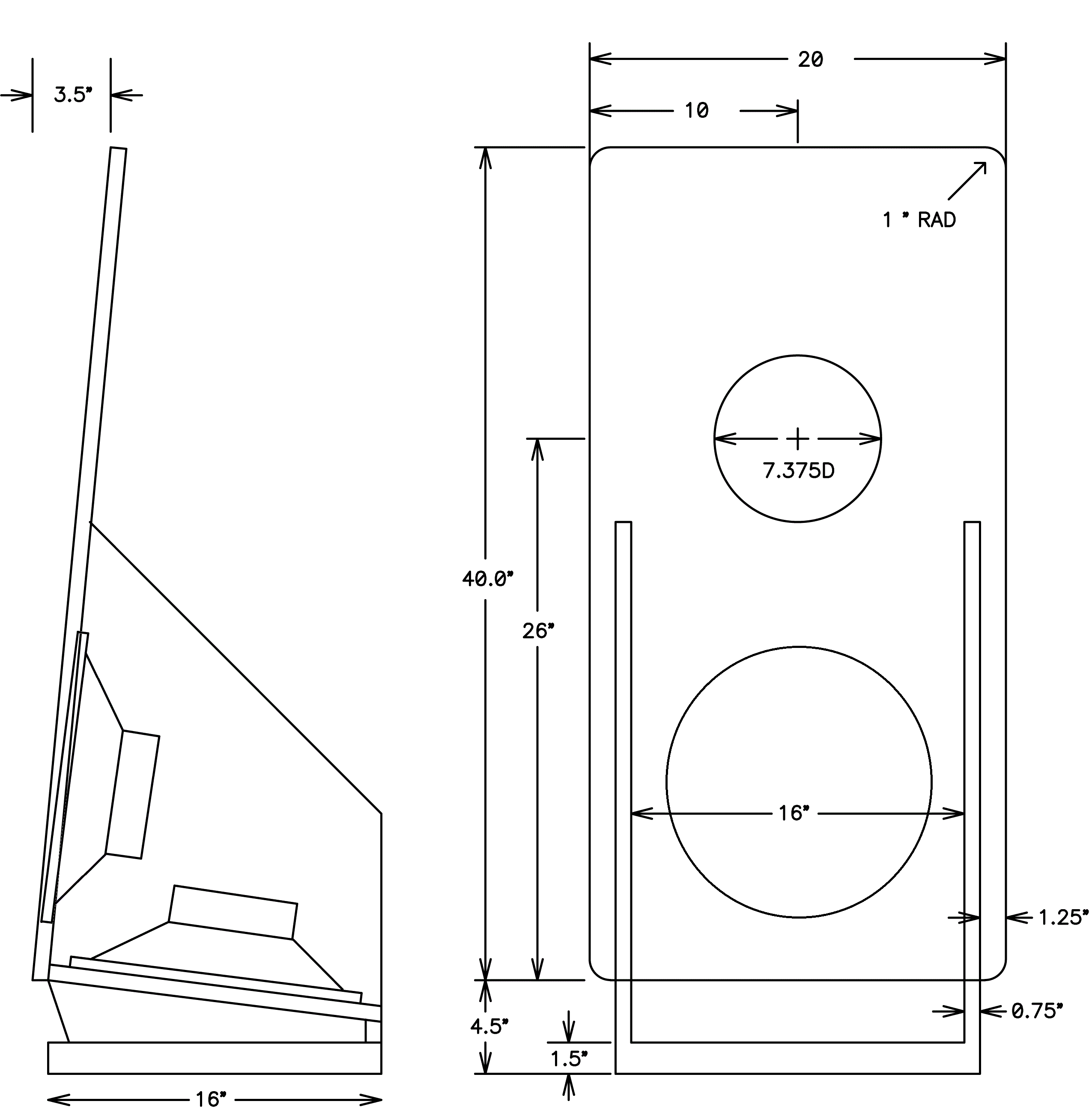

but... now I feel that 15" woofer and 20" baffle is small, so new plan comes. It will be using 24" baffle and two 18" woofer from top class of ACR, not like my current 15" woofer from low grade one

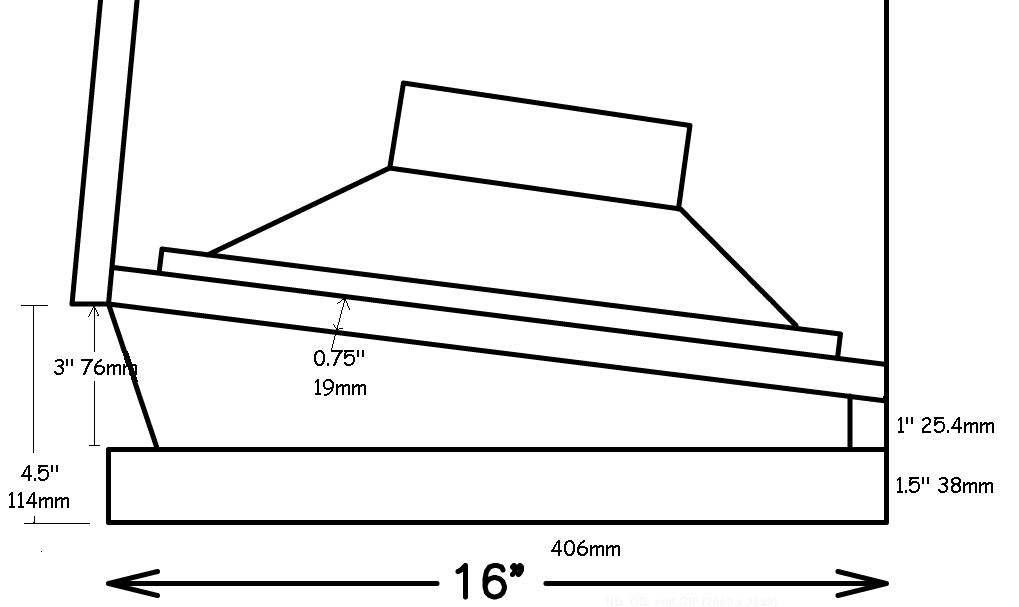

is there any formula to design the slot for 18"? or can use same slot as original Papa design with additional width?

The cross sectional area of the slot should be 1/3 the cone area of the woofer.is there any formula to design the slot for 18"? or can use same slot as original Papa design with additional width?
