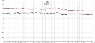

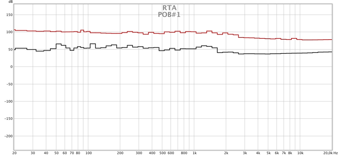

Some more feedback from day#2: I toyed a lot yesterday with B5, struggling to find the right combo.
First of all, slotted bass is really great, giving very low bass output (see measurement in attachment, made with UMIK+REW).
But there is something missing, the impact of bass, so I guess the front will give me that.
thanks guys to pushing me further ;-)

well I just finished them....
I will let the driver playing one hour or so and than listening to them seriously.
The dip @200Hz is OK?
Is it possible to change the scale on the y axis for higher resolution?
