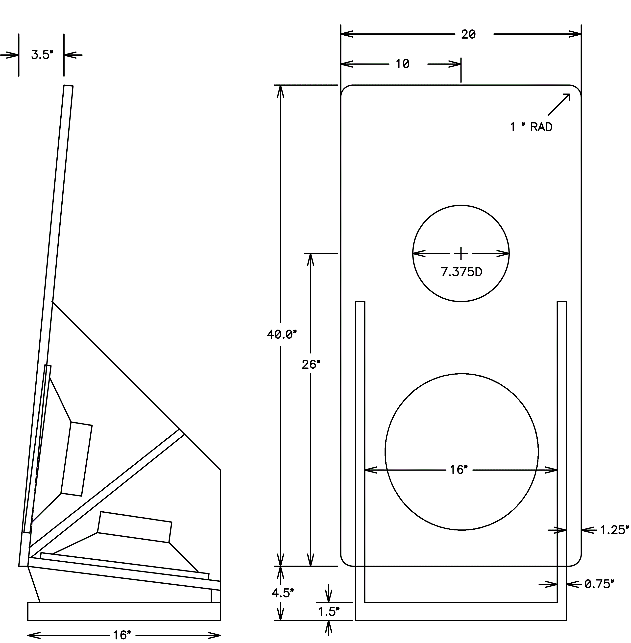

I have not given this up, maybe there might be separation between the two loudspeakers, something like this:

However, the point I was trying to make was slightly different, my english was probably not good enough. What I meant is: is there any chance that the slot loaded woofer in a configuration like the one just posted by Guyri need to be opposite phase to the other one in the main baffle for having a correct response?
I have not encountered this. Can you describe your drivers and such?

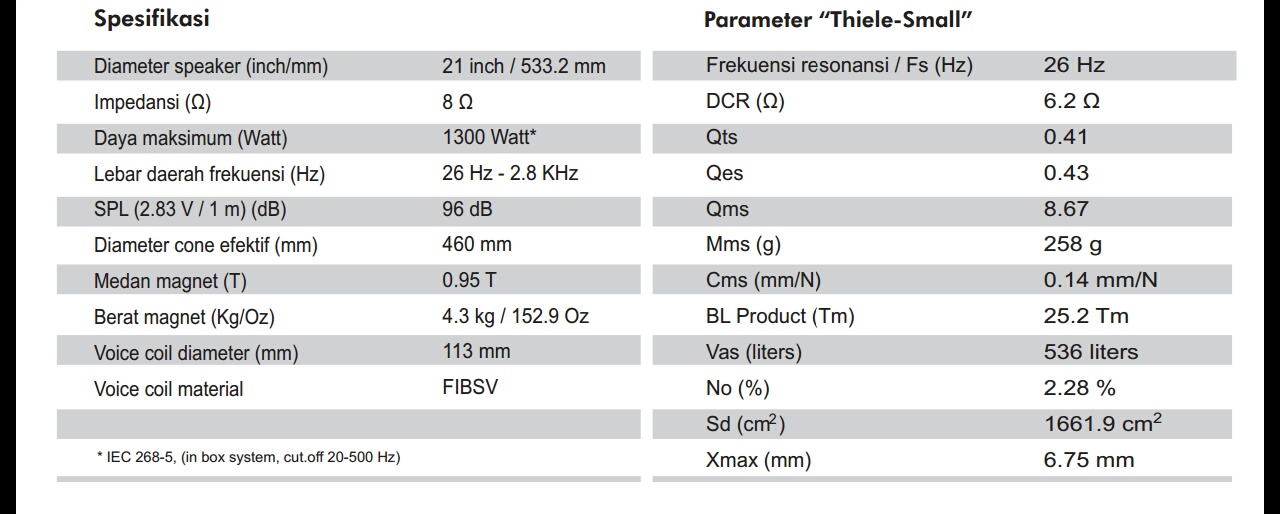

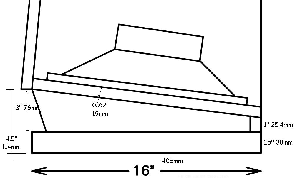

my understanding was to use 1/3 Sd of mouth opening, and the troat height is also 1/3 of the mouth height. I used same dimension with original drawing but only differ on its width 78cm.
if my calculation is correct:
Sd : 1660 cm2
front mouth : 78 x 7.5 = 585cm2 (35% Sd)
there is a part of me that want this stay as not working, so i dont have to buy another pair 21" :D

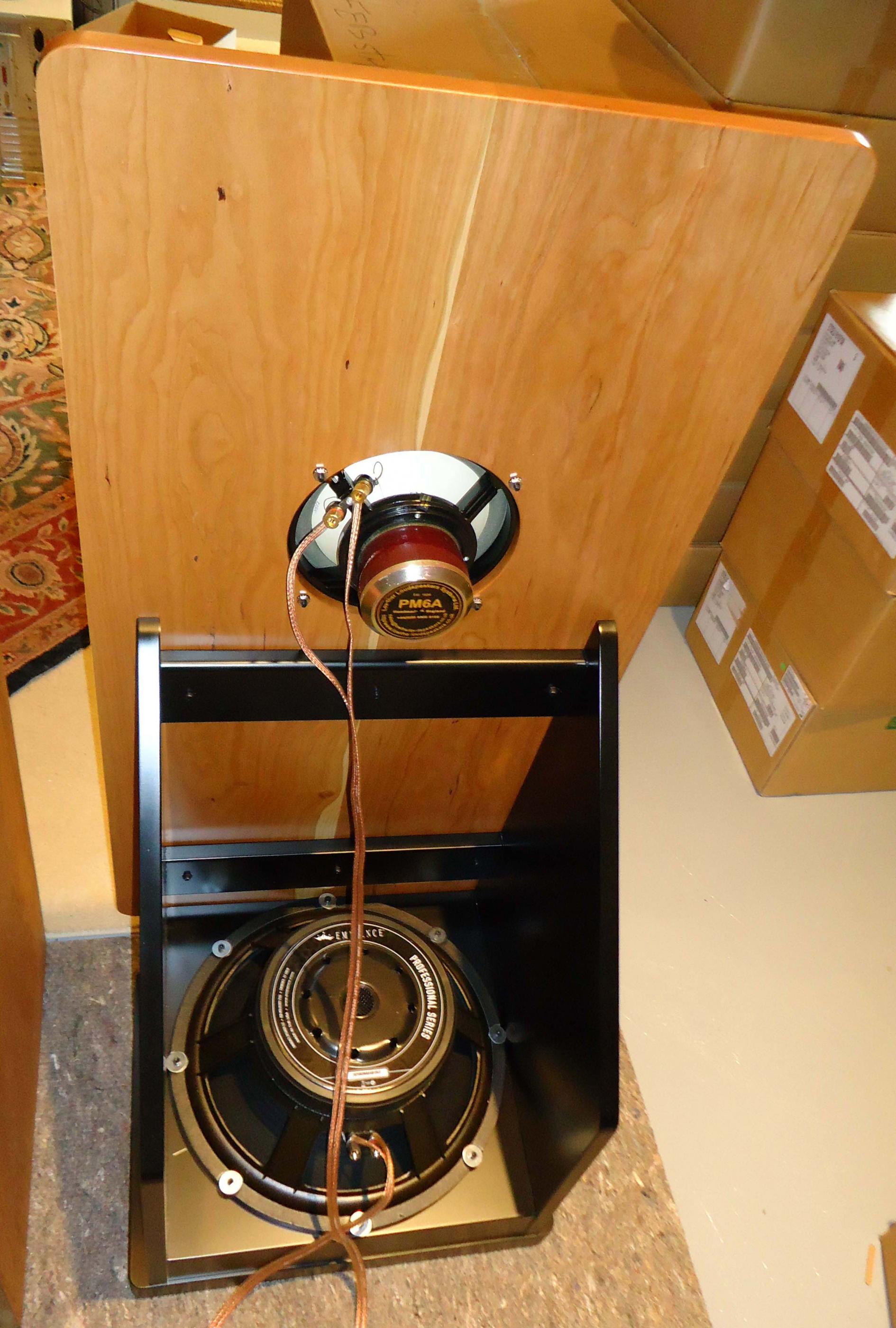

I played this afternoon with sloated bass reverse, without measuring the result, I'm in Summer mood....
Sound seems tighter that way, less muddy on particular recording, giving less output so I slightly increase it through the potties on B5....
It deserves a measuring session....

I didn't have that last picture. But it is clearly that there is "Professional Series' written on it. The Delta and Beta are 'American Standard Series'.
