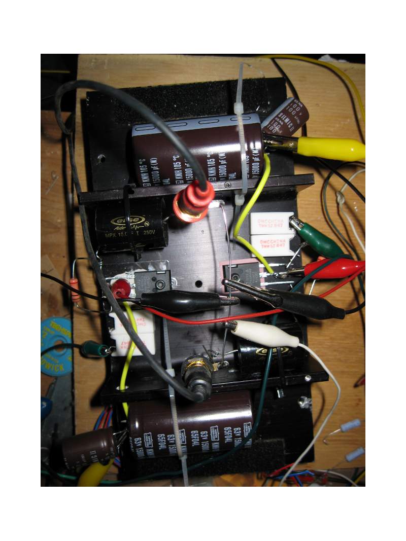

okay, maybe better picture of what is going on. Two channels working.
Takes about 20 minutes a channel to build the amp, 20 minutes for power supply. 10 minutes to clip lead.:D

I played with the Delite again last night. It had a slight hum to it, with my ear 6 inches from the speaker, and more noticable with headphones.
I ended up curing it by adding another CRC to it.
So now its 2x 15k->1ohm->2x15k-2x5k->.5ohm->2X5k.
I seem to have lost a bit of low end when I did this. But the hum disappeared. I might reverse this configuration to see if it improves bass response. I am still skeptical if the supply resistor should be using a 1 ohm or a .1ohm, at 1 ohm, it looks like 50 watts of disappation to get the temp under control.

Think about the life time of the electrolytic capacitors! Mounting on the heatsink is a very bad solution. Please note:
Per 10 degrees increase of temperature causes a halving of the lifetime - even by 125 degree high professional versions !!!

I hear you. The output caps were put into place there because I simply was tiding up and running short on clipleads. A note, the sink doesn't heat up much in it's current implentation. This is just playing around for now.
I am thinking charging cap after or before the bulbs, with a 1-2.5k resistor to ground, from what I see in the F2 circuit. The bulbs themselves take a second or so to lightup at turn on, but its not enough to stop the thump.

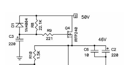

To avoid any transients after switch on (turn on, as you say) please use the electronic inductor solution as used by Andrea Ciuffoli's "Power Follower" about
the Power Folllower
Don't forget the serial diode from source to the actually +Vdd, if you choice large value of capacity from +Vdd to -V resp. GND to protect the MOSFET while switch off and while the discharging of the mentioned capacity.
