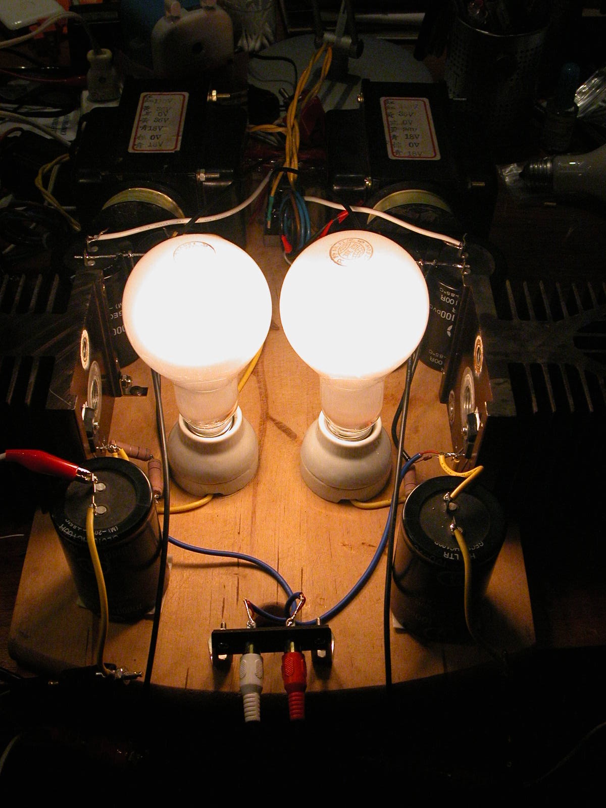

I finally got back from the in-law's (or outlaws) and had a chance to delve into the microphonics problem more. I let everything power up and get to steady state and then tapped a bulb and I got a nice distorted buzz. I get this with our without music playing through the amp. I still have to do any test with a signal generator to look for the "singing" you talked about NP.
I would suggest that anyone building these position them well away from speakers and possibly dampen the bulbs in some way. That is what I am going to look into next.

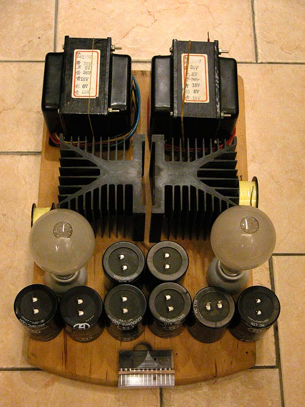

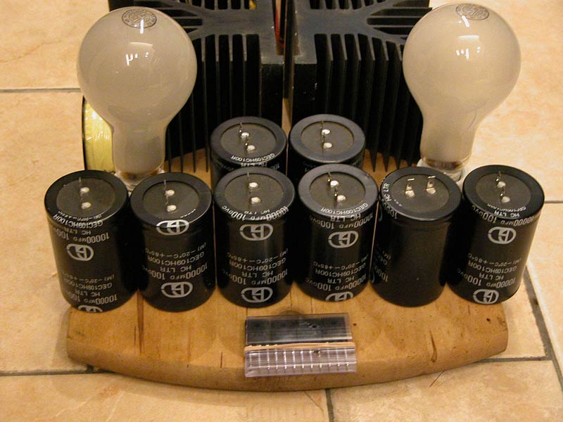

I'd received my GB's MOSFETs today!
And Elko caps had arrived, too! They are 10000u/100V, NOS, very cheap.
Soon will start this project......

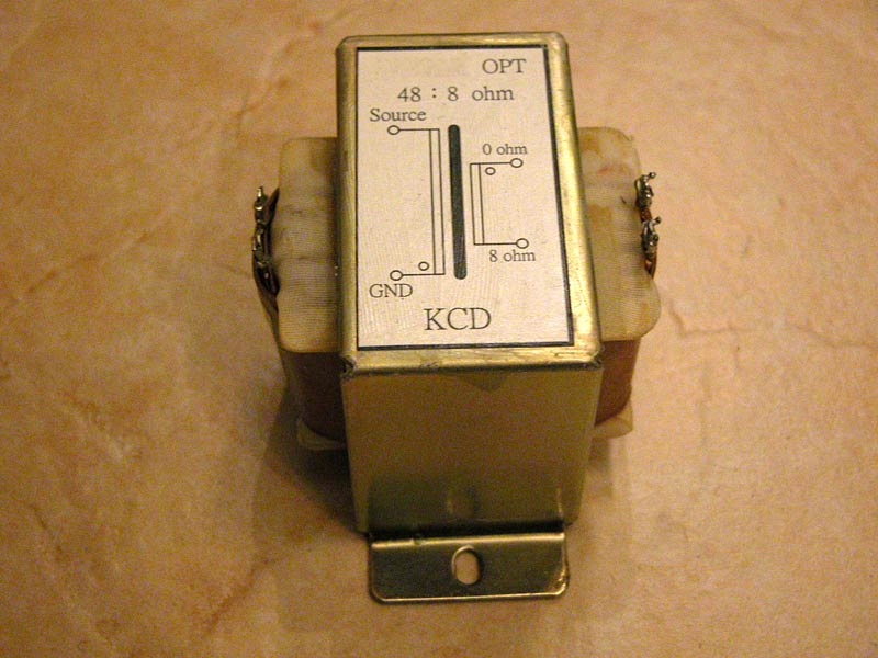

The last picture is OPT, but manufacturer told me it is rated at 1A-1.5A, so I cannot used on delite.....but maybe I can do something with LU1014!

Lamp microphonics are possible, although I haven't
encountered them. If you run the amp with an oscillator
up and down the frequency band, you will often encounter
some "singing" in the lamp at around 1 KHz, but it's pretty
minor.
Yes my bulbs whisper, too.

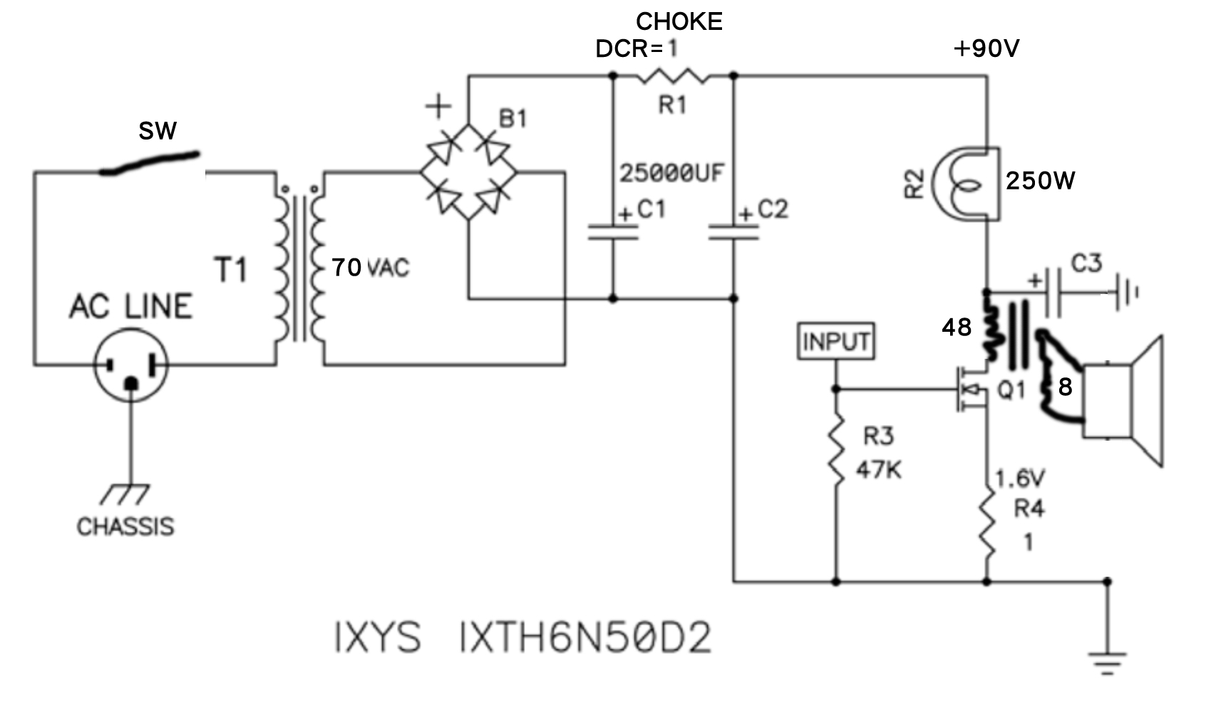

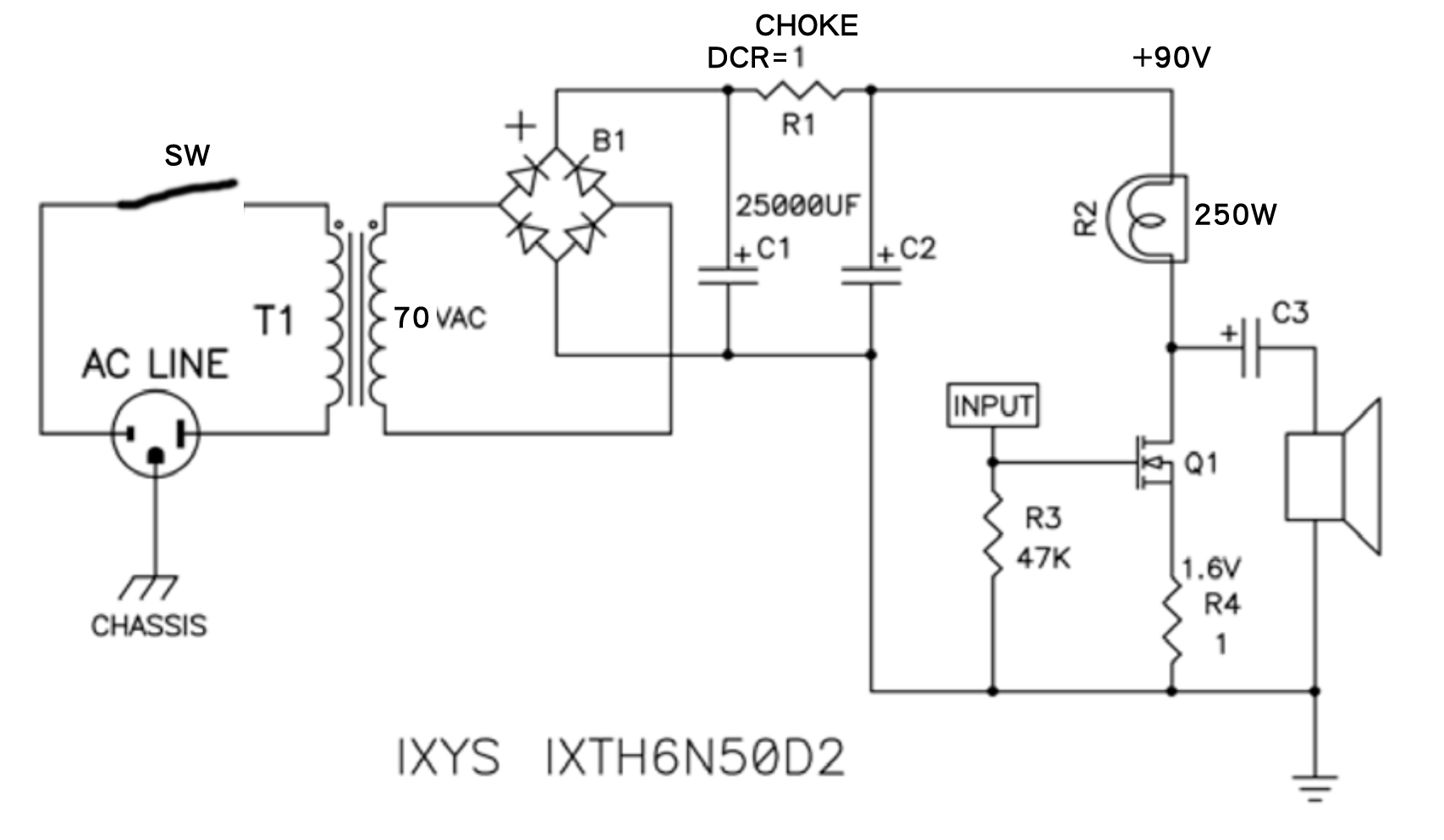

the first version is using 6N50D2, but no input cap.
the sound is good, but by-pass cap on output cap is necessary, a little bit bothering......
so I swapped some wires, add the OPT I mentioned, well,.....It sounds a LOT more better!

With the output capacitor ,
I may be completely wrong about the following ,but, some extended listening and experience tells me that somehow the speaker likes to be connected with its negative pole to ground . That of course remembering, if we do that ,to find an audio source where the polarity can be inverted .
With the transformer I am more incline to think that the distorsion goes a little toward the 3rd armonic . Can it be ?
Just to be clear. To preserve "proper absolute phase" requires that the speaker "+" be connected to ground for the capacitive coupled circuit. Correct?
cap or not cap - that's completely irrelevant .
amp itself is inverting , or non-inverting ..... output cap-less,or not
Umm..., I thought that the wiring of the OPT could affect the polarity of the speaker connection. Back to the books for me.
well - you didn't mention OPT in post #317
