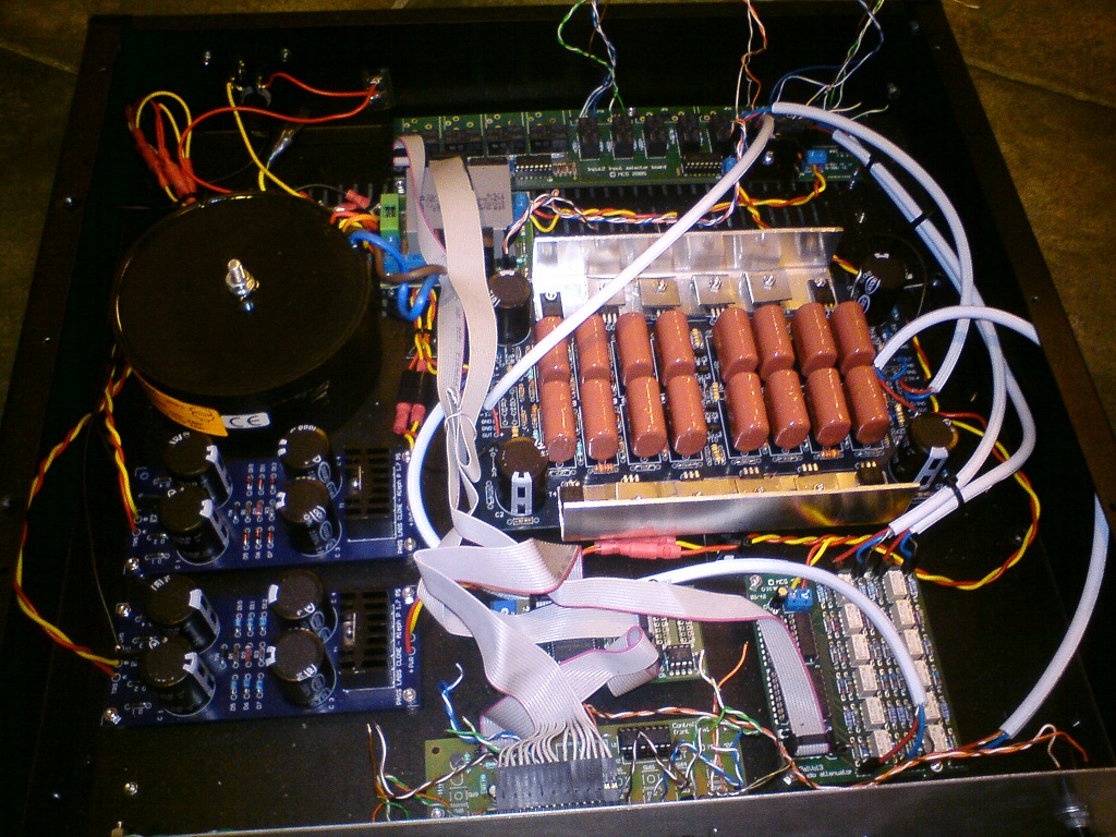

here is my layout of the P1.7. did someone say oversized transformer? :) ended up using a 160VA.

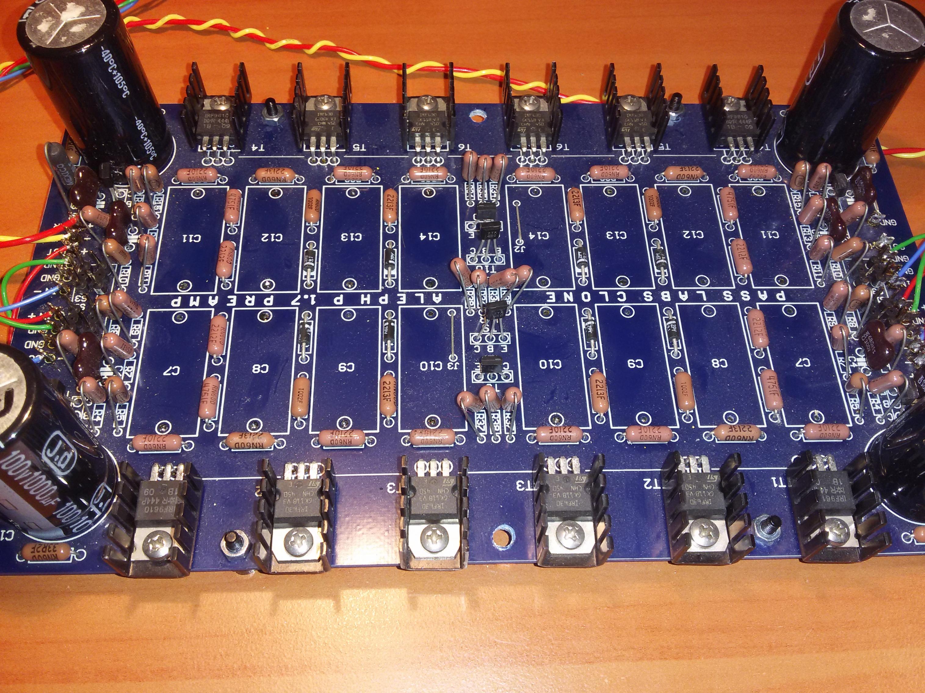

A friend of mine started on a P1.7 build years ago but never completed it. I got the boards (KK amp + psu boards) but only have one functional channel (when I put a 1KHz 1Vpp sine on input, I get a 1KHz sine on output of channel A, but nothing on channel B). It turns out to be more difficult to find the error than I had hoped.
The PSU boards (dual mono setup) are in a separate enclosure and I have just under 60V on both boards, also when amp board is attached, so assume that there is no problem with the PSU.
I noticed that my friend had used IRF630 rather than IRF610 and understand these give a darker sound but should work in this amp (I will leave them on the board for now and may change to IRF610 sometime in the future).
I have measured some voltages (ref. to GND) and the non-functioning channel has some odd readings. I have checked all values of resistors etc. against KK's part list but have not found errors. My friend used Audyn-Cap MKP-QS 400V caps that are too large for the board. They are removed in order to check values (see photo).
As I had heard that ZTX450 and ZTX550 have caused problems in other builds I changed these but the readings stay the same.

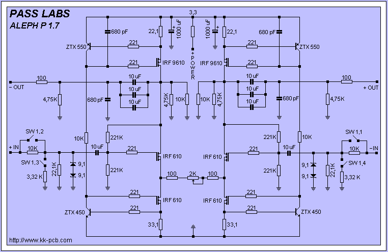

The readings I get (left is functioning channel, right is defunct channel) are in the attached PDF. Schematic below (no part numbers on schematic).
Anyone have any suggestions what to check?

It's a bit hard to equate your transistor numbers to the schematic I have. It looks to me that there is a problem with the circuitry around the Ztx450 and the bottom 610. The source of the 610 should be at the same potential as the base of the 450. There is only a 221 ohm resistor between them. Check the connections in that area. The voltage should be roughly .6-.7von the base and at the source of the 610. You have 5.26 on the source. check the connections with an ohm meter.

Hi Bfpca,
Just in case there was a bad solderjoint somewhere, I reheated all solder joints.
I have visually checked all resistors and then checked all with a ohm meter in situ and found no differences between the channels. I even took out a 680pF silver mica to check (it was fine).
I am wondering if it could be a faulty irf9610 or irf630. Any ideas how to check?
Thanks,
Albert
I just checked resistance in situ from ztx450 base to irf630 source and found all values on both channels about 221R as expected.
