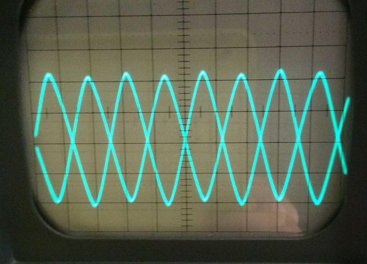

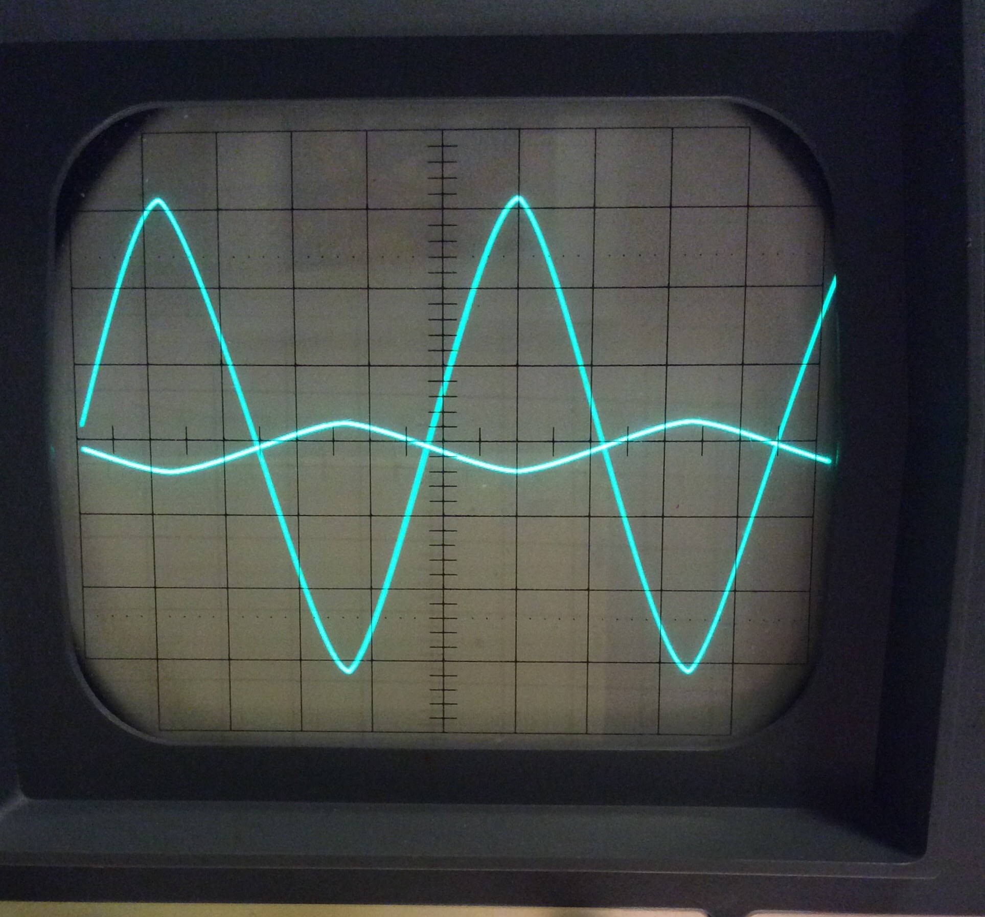

Is this the expected output signal from an Aleph P ?
I've completed the built so far. Started measuring on it.
Output signals look okay, but the level looks odd.
I've grounded the negative input, as i only use unbalanced sources.
Want to use balanced output to drive my Aleph J.
These signals look a lot like the BoSoZ output. I expected more symetrical signals.
So question to other builders, does my signal output look okay ?
The fets and ztx devices were matched, but not on microvolt level

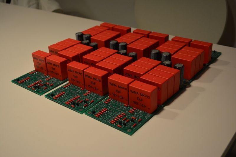

Awesome! Mine took about six weeks to break in, was a little edgy for a while and than that disappeared completely. Let us know what happens with yours in that regard... I used the same Panasonic film caps that were used in the factory versions. That may explain my long break in period. But I am very happy with how it sounds now.

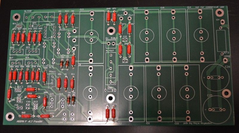

Hi all
I have start to build Aleph P1.7 with Koja PCB but have some question ;
I need a plain version to drive Aleph X and Aleph mini (XLR), and the source will be AYA II DAC (SE).
So could someone tell me what ohmit on PCB to get plain version of P1.7
I don't need no extra outputs or so...
I don't know the use for RLYINP, RLYOUT...
How to ohmit DIP SW4 and RLY1 and RLY2 ?
why do we need tham at first place ?

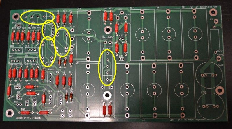

Here is the PCB look and it would be great if someone could draw what to ohmit on it (if that's not to much to ask...I believe it is , but any way )
