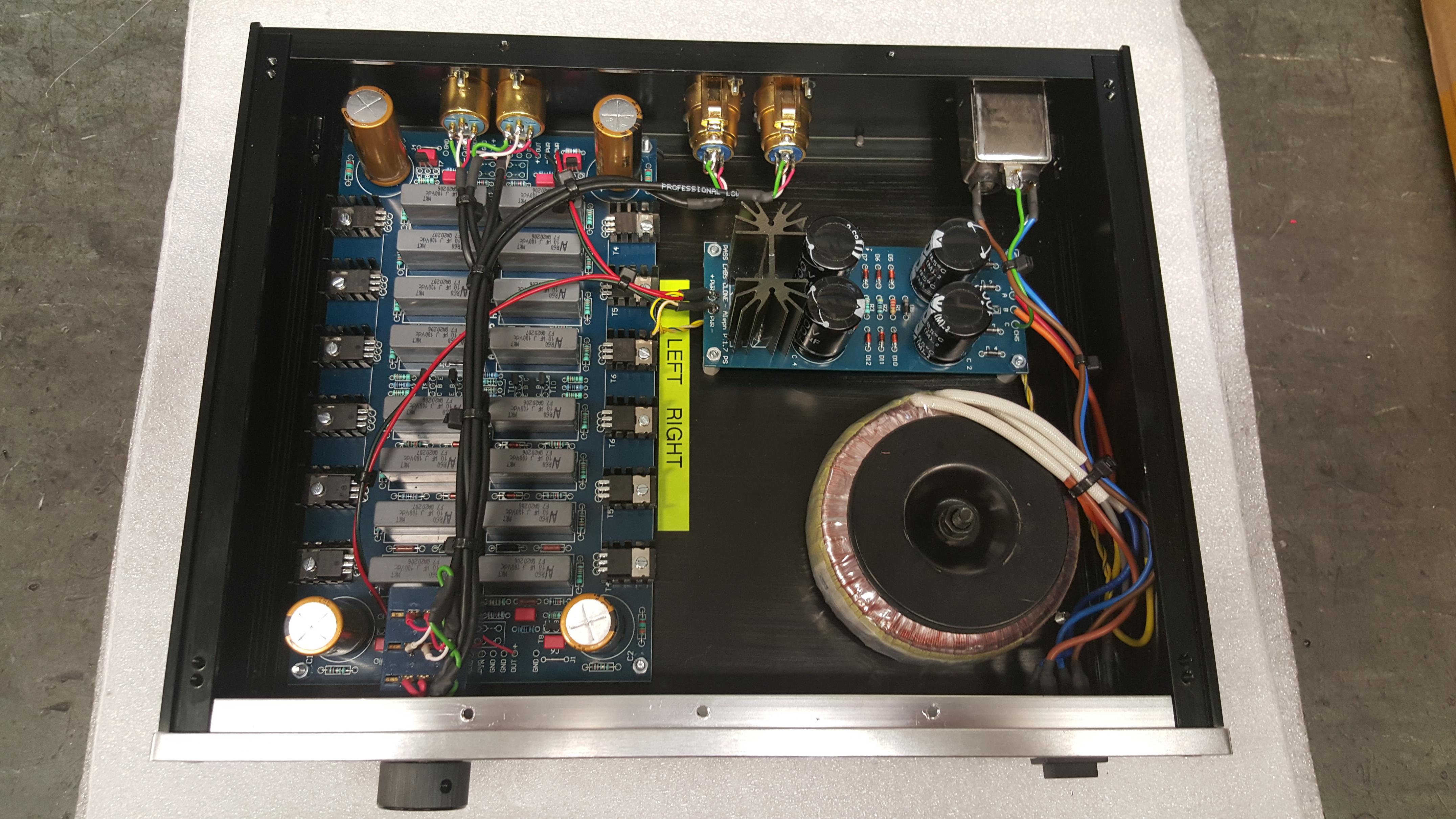

I did take the advice from those that offered it, the 10K pot is at the output of the P1.7.
Anyone using the KK-PCB PCBs be very careful with the PCB mounting as it is very easy to short tracks to the chassis through the mounting holes. Either use insulated pillars or insulating washers.

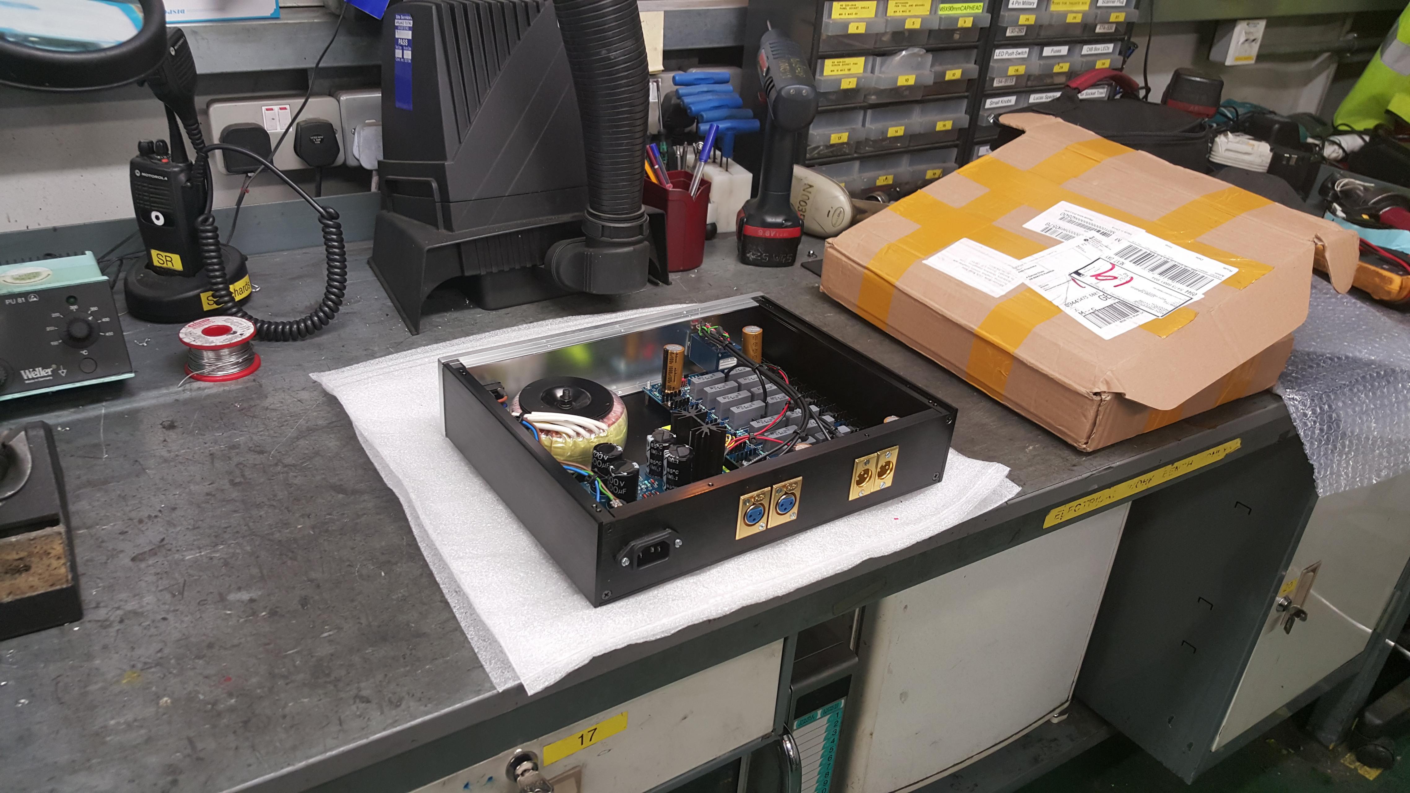

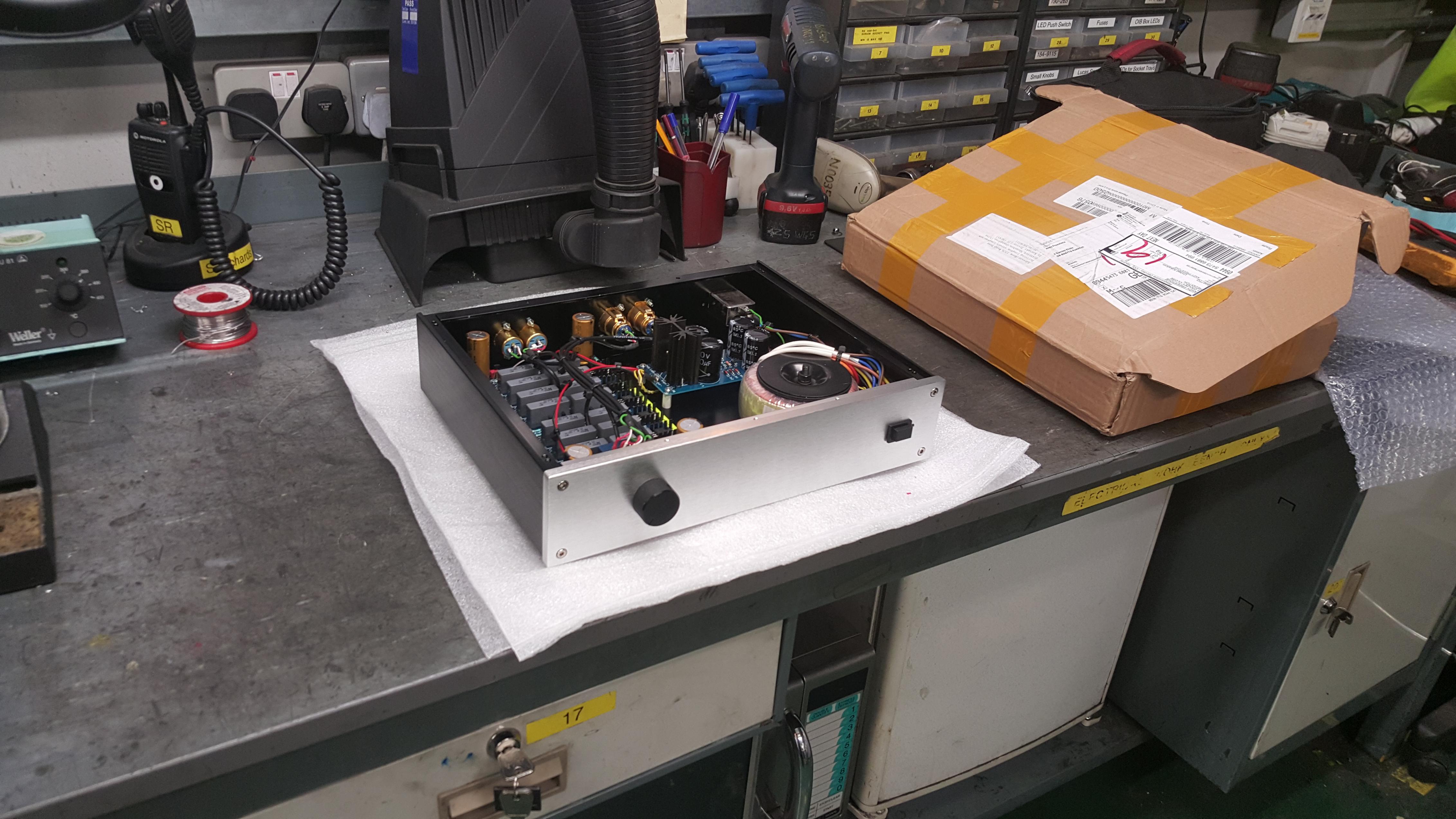

Those cases are being advertised on E-Bay, they are not too badly priced either.
They originate in China but we have a supplier in Germany.
215*70*228mm Aluminum enclosure DAC case amplifier chassis DIY BOX HIFI house | eBay
I bought three of them for my Pearl 2 build as well as this one, the link above might be for one of the other cases.
Incidentally I decided to replace the thermistor on the PSU PCB with a short as I thought 10R might cause grounding issues with my grounding arrangement.
The XLR sockets are all grounded to the case. No screens are subsequently connected to the PCBs. The main amplifier 0V has to connect to the chassis, this is done at the PSU.

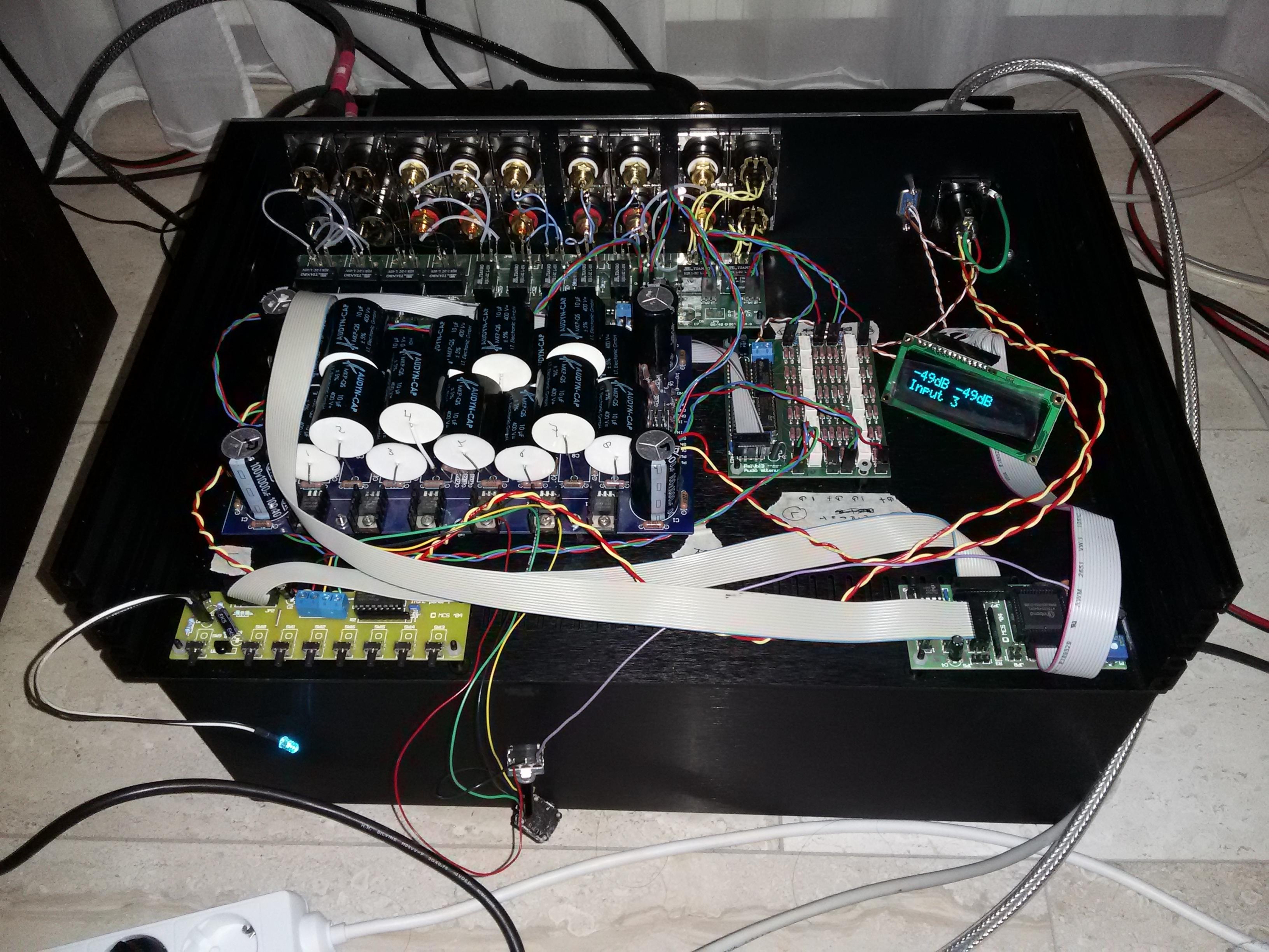

I used different types of wire to connect the various inputs to the inputselection board. This makes an easy way to test the influence of using different gauges and types of wire
I have been listening to the amp for a few hours today and it sounds great, although at the moment I am listening in my study setup with not-so-revealing speakers. The amp stays there till everything is finalised before migrating to the living room.
Something that needs solving is a volume related problem. When I change volume (up as well as down) I get some distortion (only during the actual changeover). Perhaps due to digitalgnd and audiognd connected through ferrite beads on Dantimax input and volume board? I have asked Mikkel if he is familiar with the problem before I start looking for the cause. Perhaps just removing the ferrite connection is all that is needed. Anyway, while I keep the volume constant it sounds great, so I hope it will be relatively easy to fix.
you should only have the ferrite beed on 1 of the boards. otherwise you get a groundloop.
Hi AudioSan,
Thanks for your suggestion. I understand about the groundloop but there is no hum or anything like that so I assume it is not a "loop" problem.
There is some distortion when the volume is changed but none once the volume stays the same. I am powering my Dantimax boards from a dedicated PSU (separate from the amp's PSU's) and left it floating. I had not realised that the Dantimax boards had a connection between digitalgnd and audiognd until I had a closer look at the schematic this evening. I never realised the significance of the ferrite beads when I soldered them ages ago.
I will try changing the grounding to see if it solves the problem.
