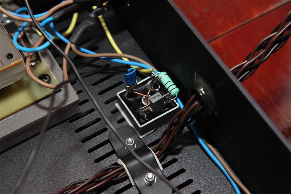

Regarding the DDRC, I use it but wired differently, according to a schematic found on internet, (can't rember the author). Not big difference but I'll try to stick with Frans implementation.
I put the DDRC in the pre reg case close to the IEC mains socket. Is it right?

‘’I put the DDRC in the pre reg case close to the IEC mains socket. Is it right?’’
Hi Emil
Yes that’s correct but I really would be tempted to use the exact implementation as outlined by Frans in the build guide if only to start from a known place.

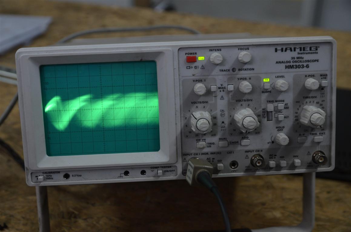

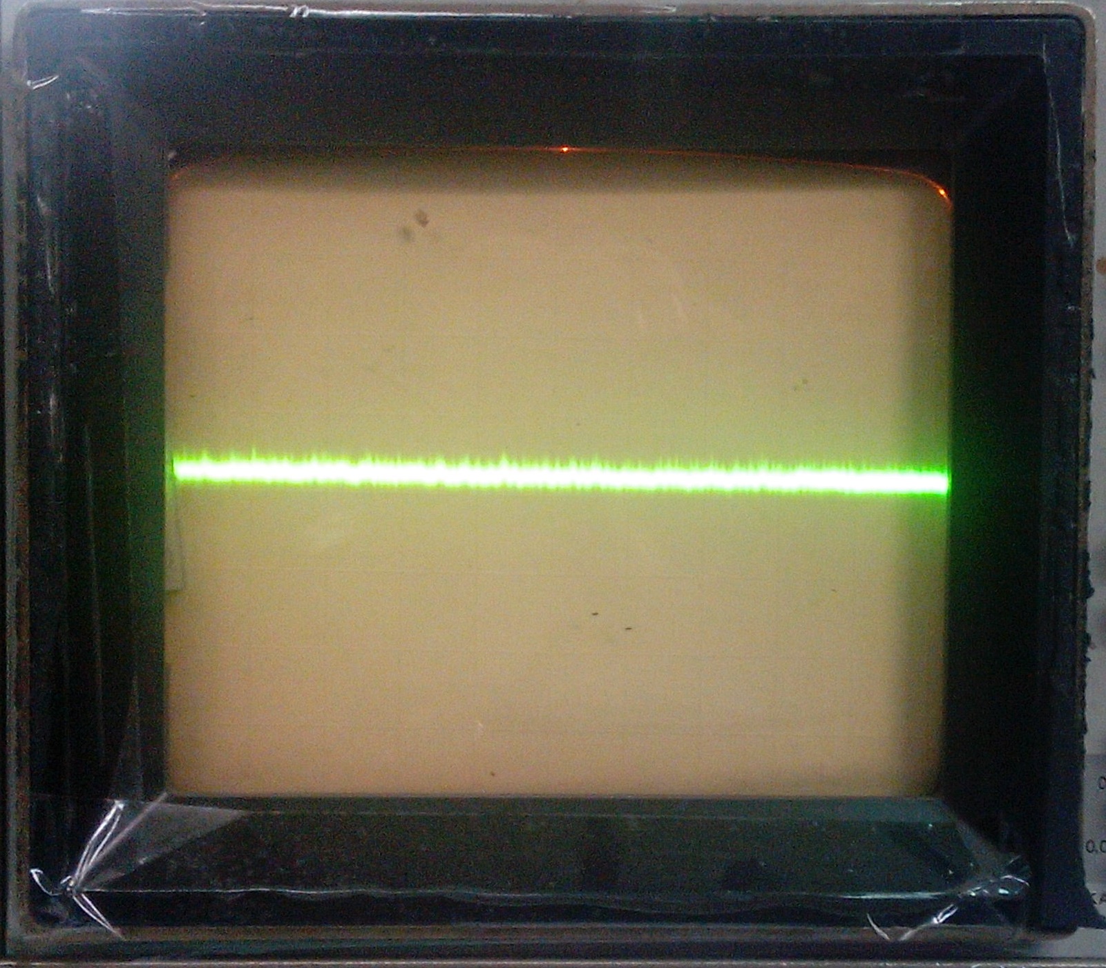

I'm the laziest of builders ever. These were the boards bought last year in April.
However, I come with one photo showing one 18 V rail on the scope. It was an ancient Russian oscilloscope but with 100 or 150 MHz. I may use another scope more recent but with only 35 MHz - it's better?
The amplitude of what you see is 25 mV.
Is this oscillation? Or just noise of the supply. Is this causing the hiss in the audio path?
I don't know very well how to use an oscilloscope, that's clear.
Emil

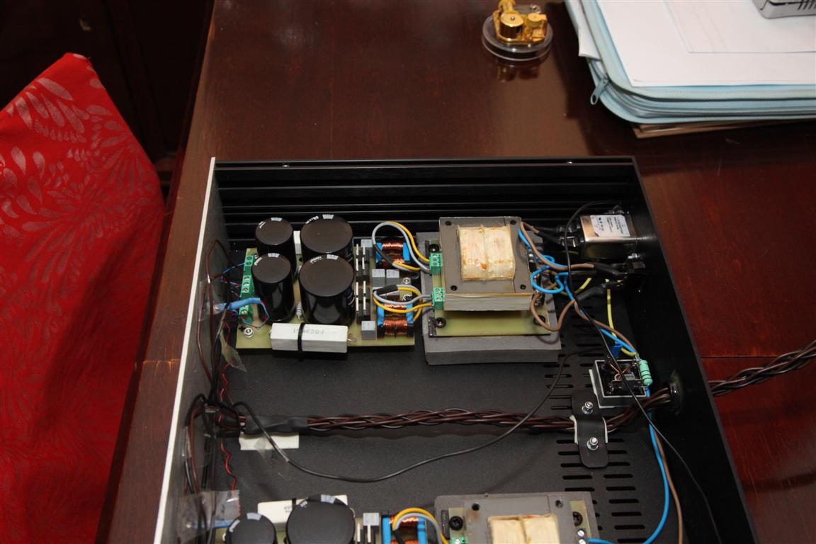

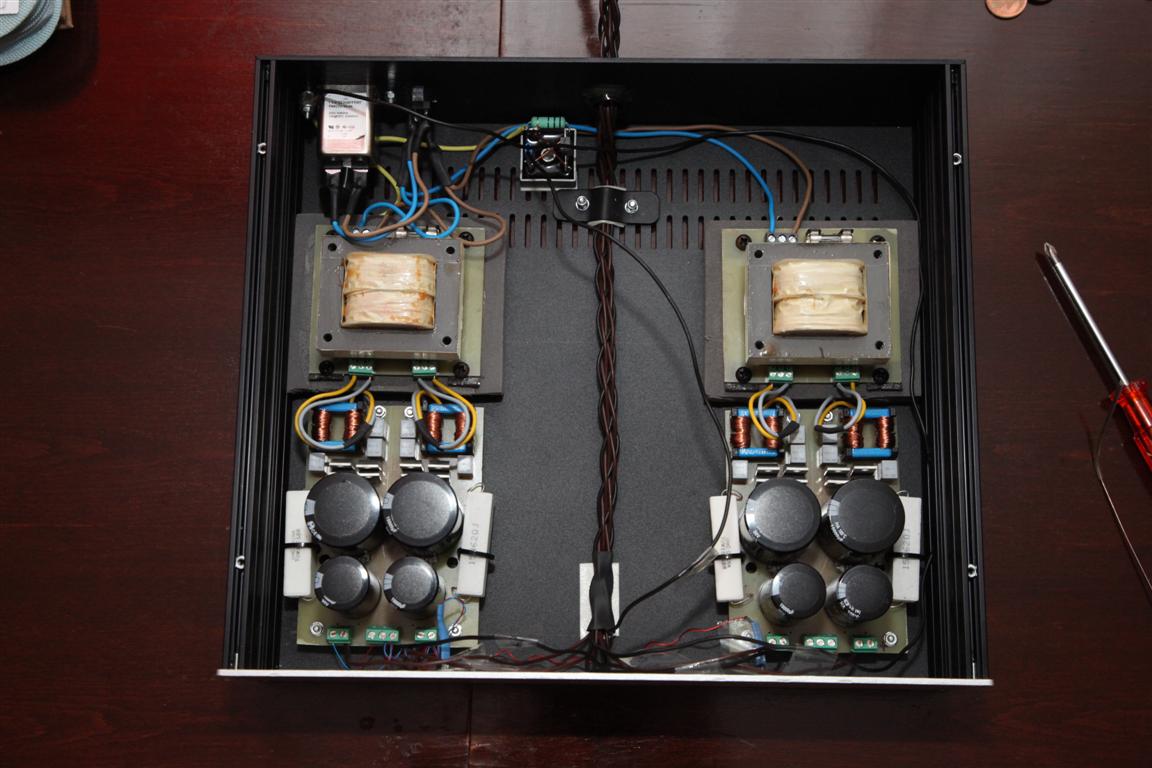

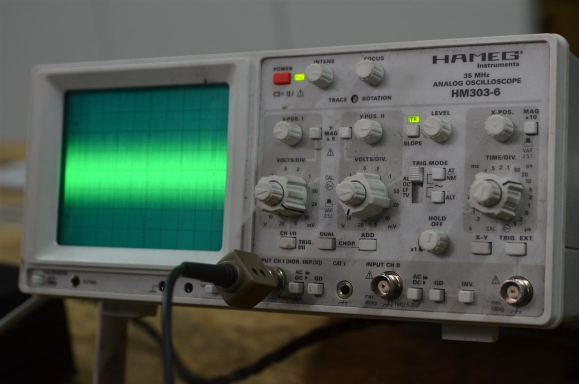

Hi
I come back with some photos.
First new measurements with another scope.
1. First screen: +/-26 V measured between pre-reg and shunt on the input power socket of preamp case.
2. Second screen: +/- 18 V measured between shunt and preamp
3. Third screen: audio output left channel.
You may read the settings of the oscilloscope in the photos.

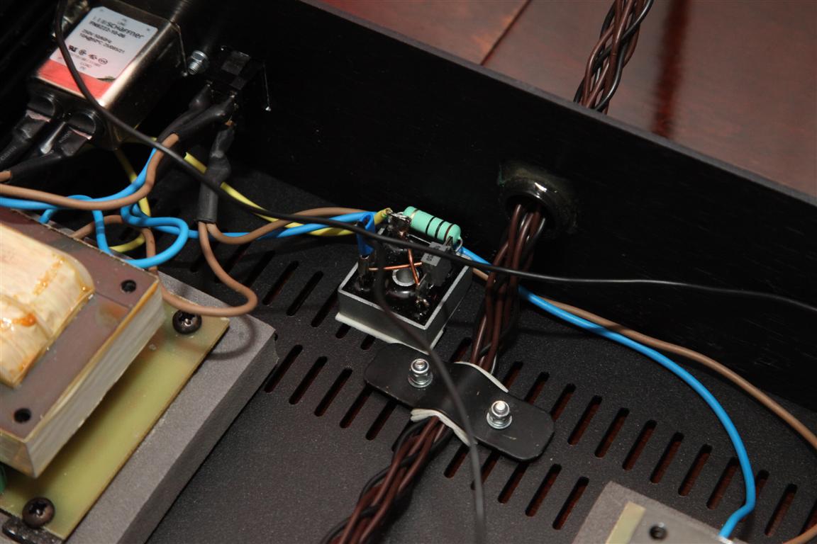

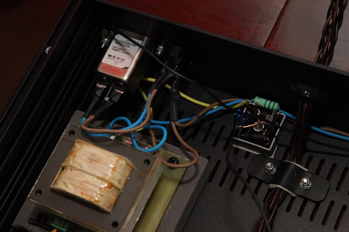

Second, some photos inside the pre-reg case.
Question: It's possible to have oscillation from the pre-regulator, as it seems to show the first screen? Unfortunatelly I didn't verifiy the pre-reg without the shunt connected, so without any load in order to see if the signal shape sown in the screen 1 is the same.
Is anything wrong with the way I buit the pre-reg or the parts I choose?

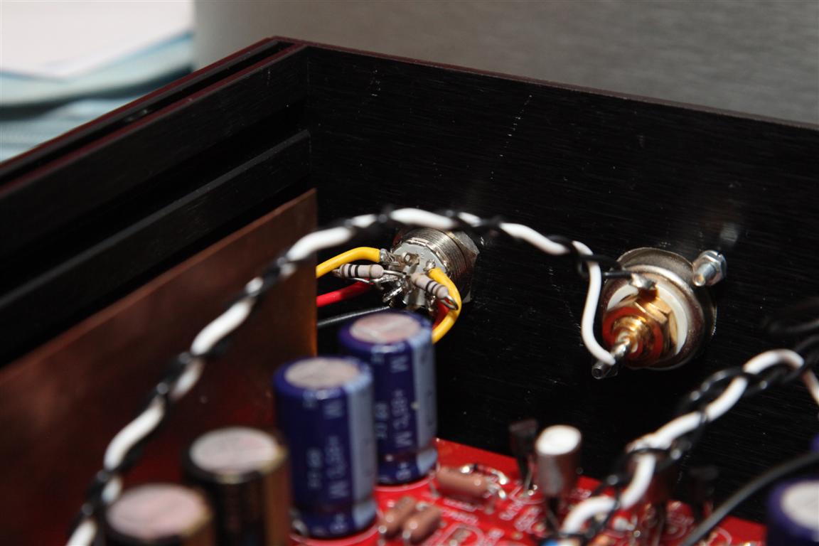

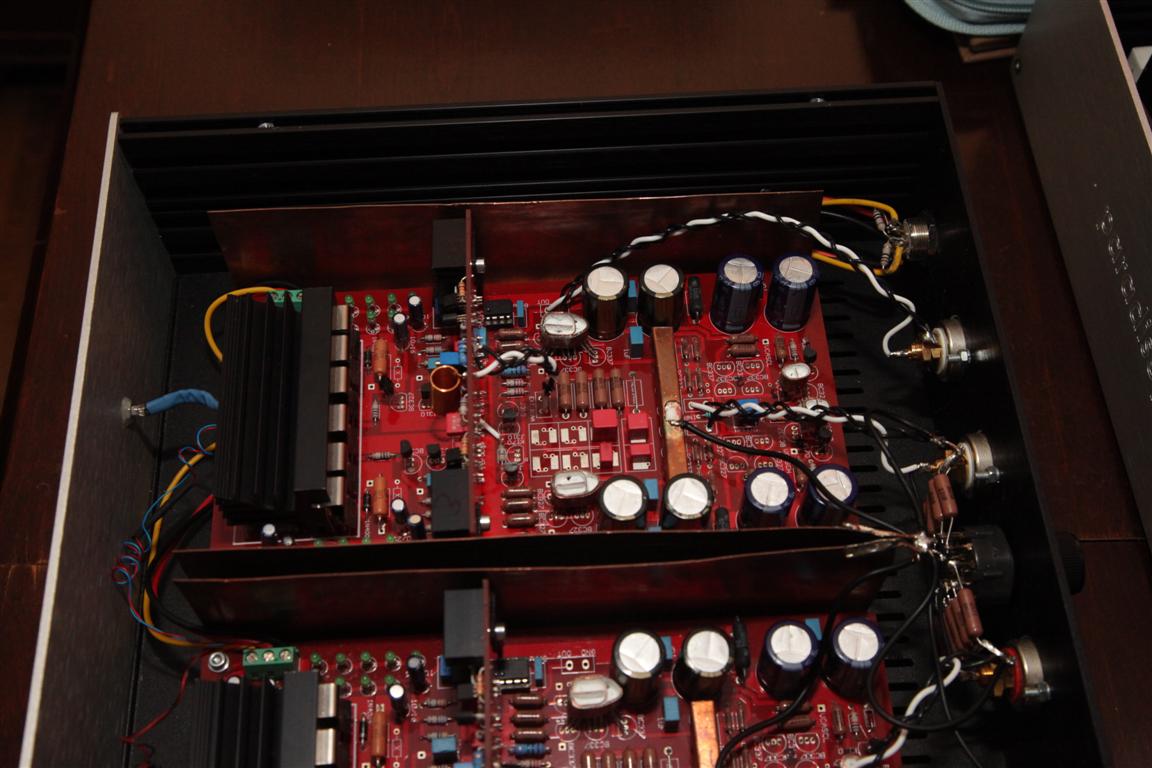

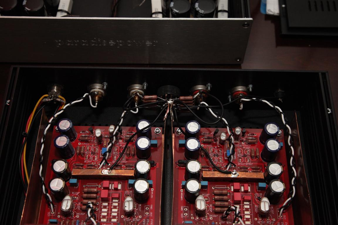

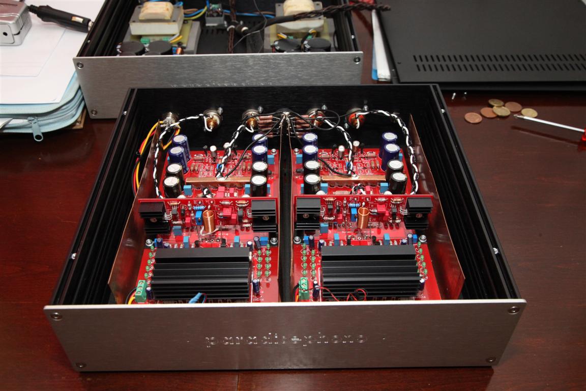

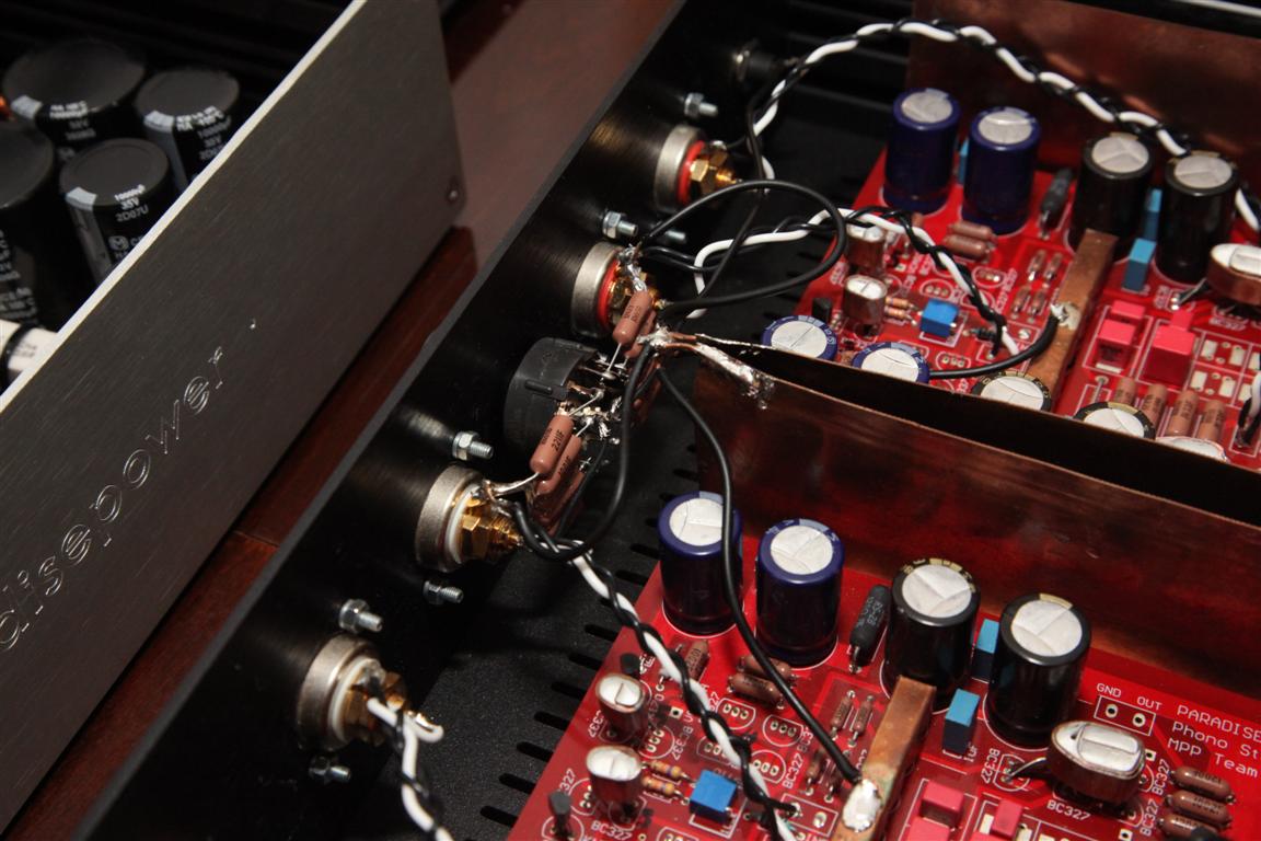

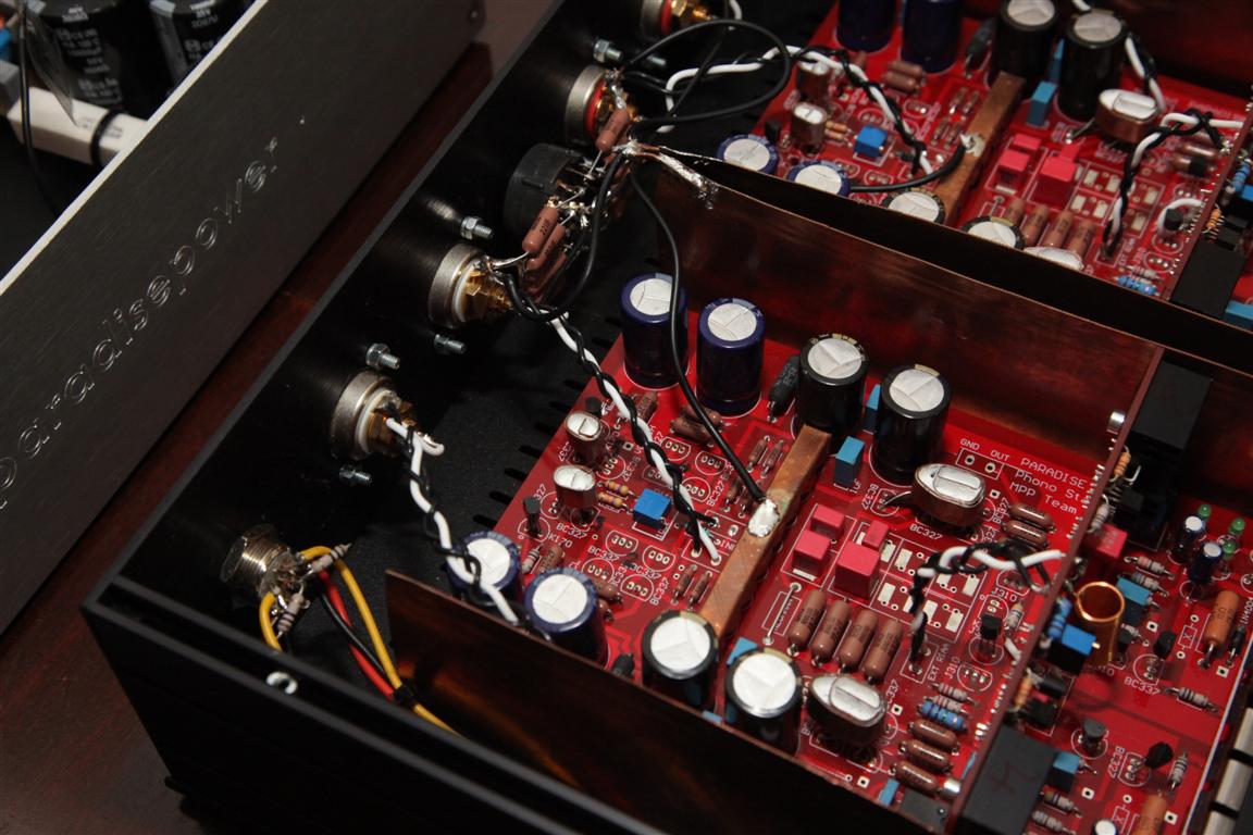

Second batch of photos.

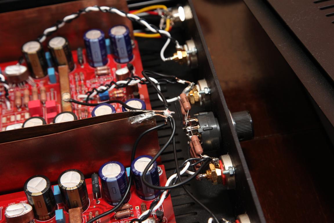

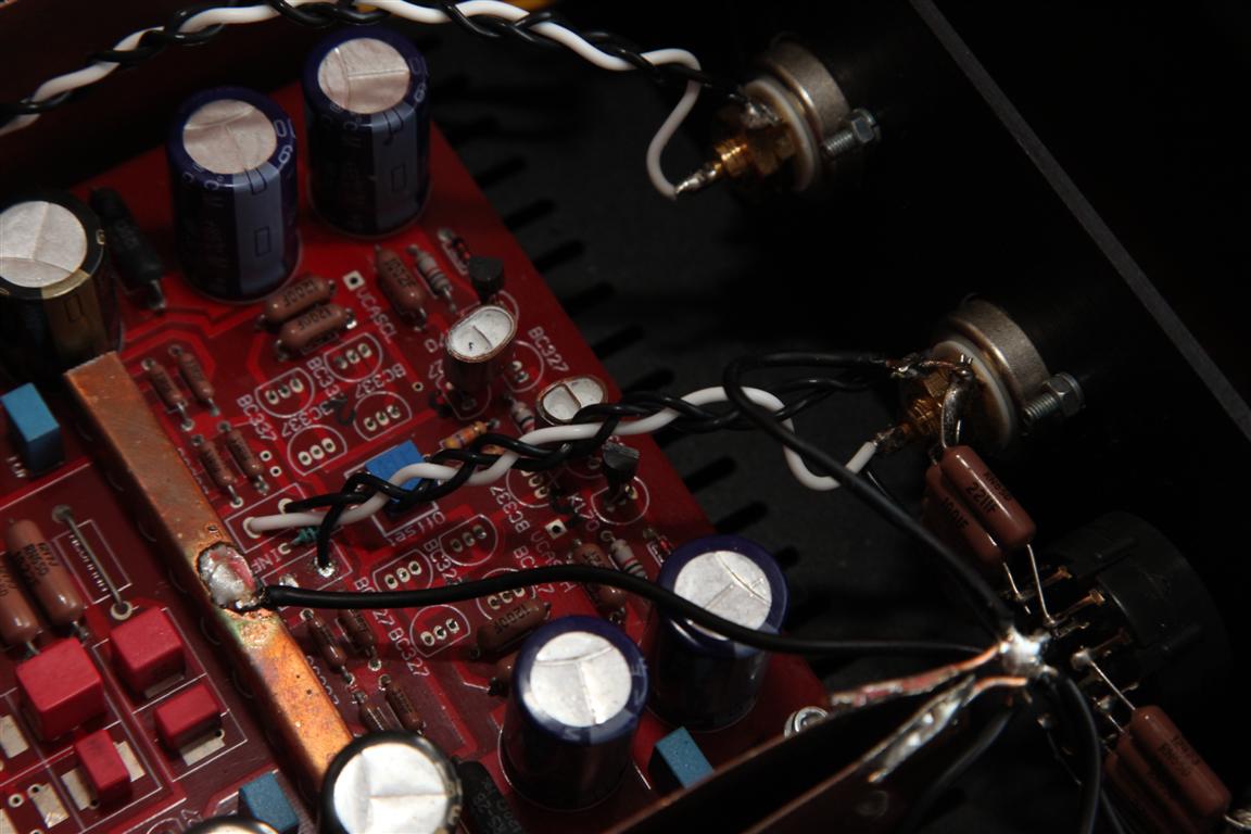

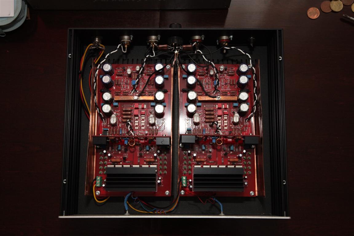

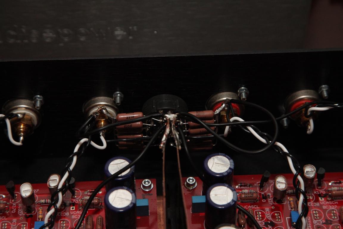

Showing inside the case of the preamp.
Is anything wrong? I didn't use shielded cables neither from the input RCA to the pCB, nor from PCB to the Calvin or to the output RCA. Wrong?
I tried to thermocouple the groups of transistors in a personal way, leading to longer legs of the transistors or crossing them. Wrong?
To the star point I came with the wire of the tonearm rounding, the ground of the input RCA sockets and this sort of shield/thermocoupling of the input transistors. It's OK?
I took the common directly onto the input power socket by the two 10 ohm resistors. Should I have took the common rather from the star point, or another point in the PCB.
Any suggestion or advise would be appreciated.
Thanks all for your support.
Emil
Emil

Hi Emil, your build looks fine, I could not spot any apparent issue. Also the grounding is looking OK (although I could not understand the phrase about the two 10 Ohm resistors).
You should try and play with the "TIME/DIV" setting until you can see a clear oscillation, and determine the frequency. If it is below 10MHz, it will probably be the CCS, and if it is 60-80MHz, it is the amplifier (athough I doubt it).
Please try and put a film cap of 1uF on the rail right where you put the oscilloscope probe, and see if the noise gets less. If it does, it would indicate that you actually have oscillations. If it does not, your test setup is not OK, and you have other noise sources in the room (think computer, monitor, fluorescent lamp, cellphone, .....)
good luck in hunting!
alfred
