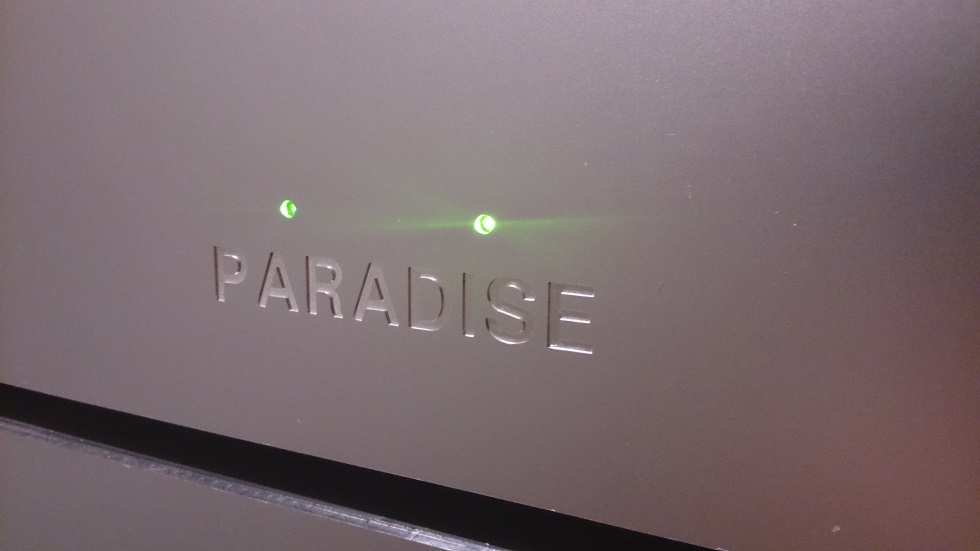

Hi Alfred. Is that that Paradise next to the TT?. My Paradise is doing great guns. The Calvin buffer is improving the dynamics and of course it is so quiet that you can hear every nuiance of the recordings.
yes, the big box right next to it. Here is a picture of the front plate, made by schaeffer-ag.de
glad to hear you are up and running, appreciate the sound comments!

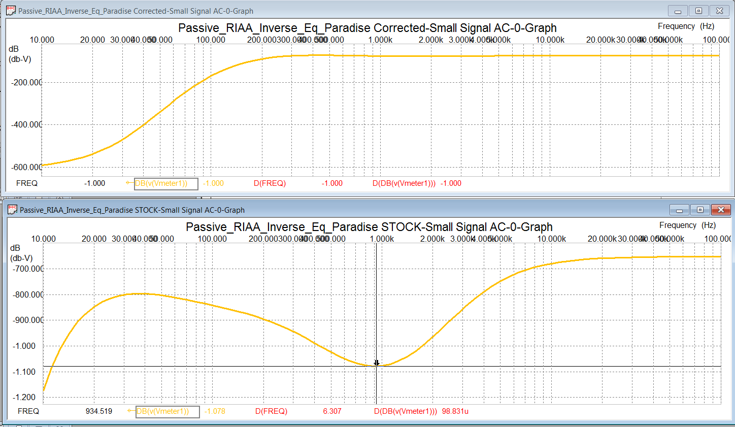

The stock riaa values proposed on the building pdf provide a more dramatic sound presentation with a slight recessed midband (-0.3dB at 1kHz) and a more present high band. It suits the majority of the systems.
My interpretation of the riaa values tend to give a more uniform eq and so the sound is somehow leaner.
A question of taste.
Please take the images with a bit of salt as these are purely simulations so the bass rollof you see here is not real.
Anyway, getting the straight line response riaa filter is not so important as matching between channels.
Both riaa filters must match really close otherwise you will compromise the very important gain / phase relationship between channels and corrupt the precious stereo image.
