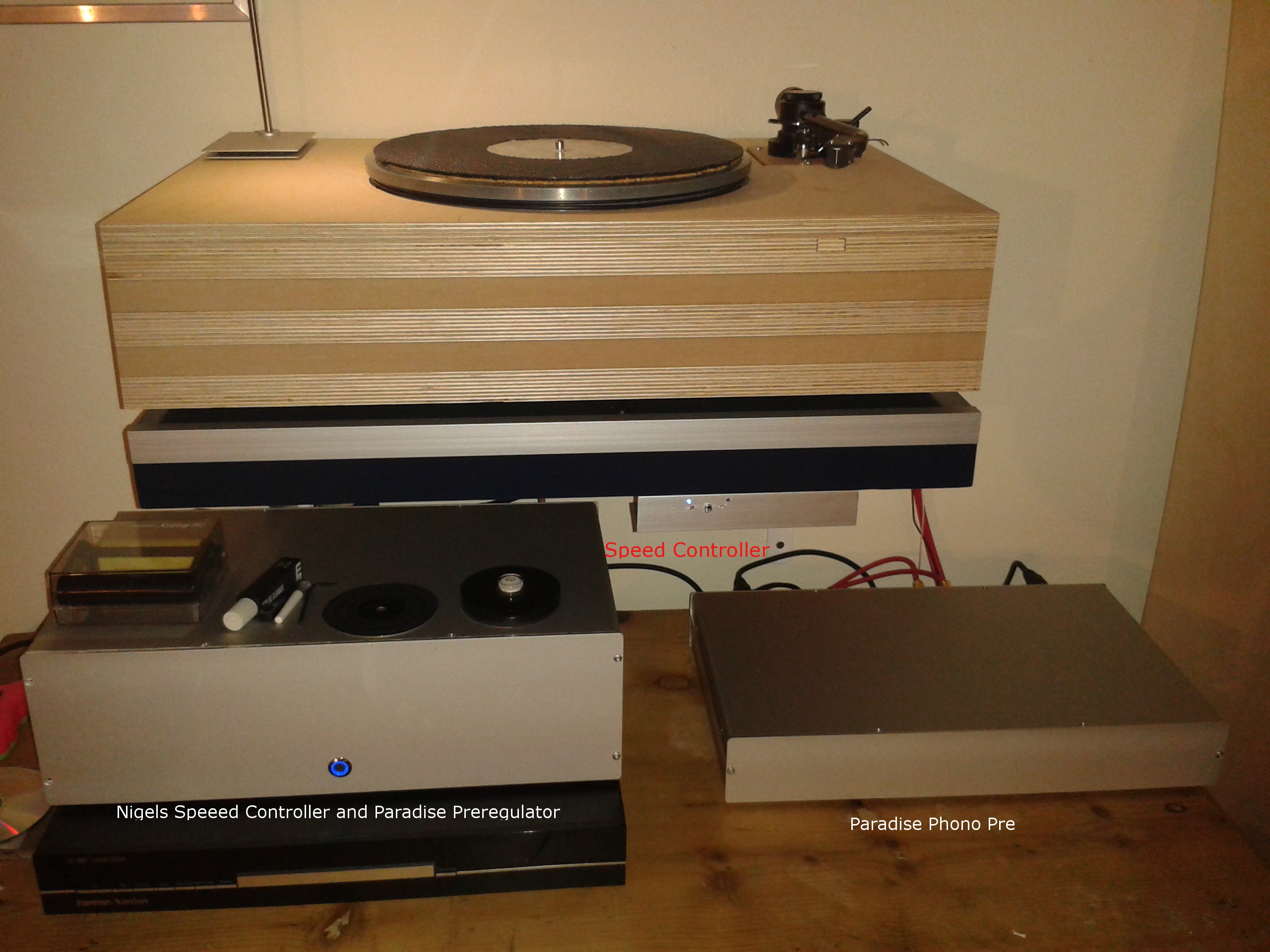

finally I finished my combined project:
Nigels speed controller an Paradise Phono Pre.
I put the speed controller and the preregulator for the paradise in one big box.
The phono pre is absolutely hum free (meanwhile)
Thanks for all your effort with construction and group buy!
@Alfred: Now the hearing session can take place!

Now that's a huge rebuilt classic TT, a nice speed ctrl, pre, and wall mount combo. Congrats. Do you remember the make of the silicon suction clamp resting on the controller's top right? Or you got a link where I can get one? Should be light under 100g. Is that one around 75g?
It is the Revolution soft clamp.
"The Revolution" Soft Clamp - Detailed item view - srm-tech.co.uk SRM Design
Cheers Reins, that is what I was looking for.
