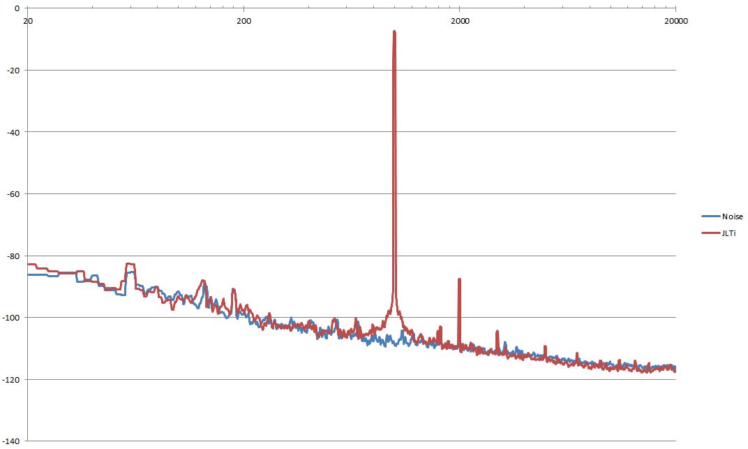

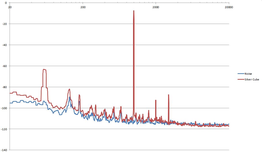

Ok. My setup seems to be not to bad now. I close every load, soldering iron, fluo lamp, etc. I use a 100:1 attenuator at the input (1K input, shunt to 10R at the output) going through an insulation transformer (1:1 Edcor Audio coupling transformer) to cut any ground loop. When measuring noise I plug a short at the input. I tried with or without a ground lift (two diodes back to back) with no change.
First this is the baseline I guest, one of my best preamp, noise wise with the JLTi, the Lehmann Silver Cube. I prove my setup is correct, noise floor is mostly lower than -100dBV. Preamp noise floor is in Blue, 0dBV-1Khz in red. THD measured at 1Khz is a very low 0.016%

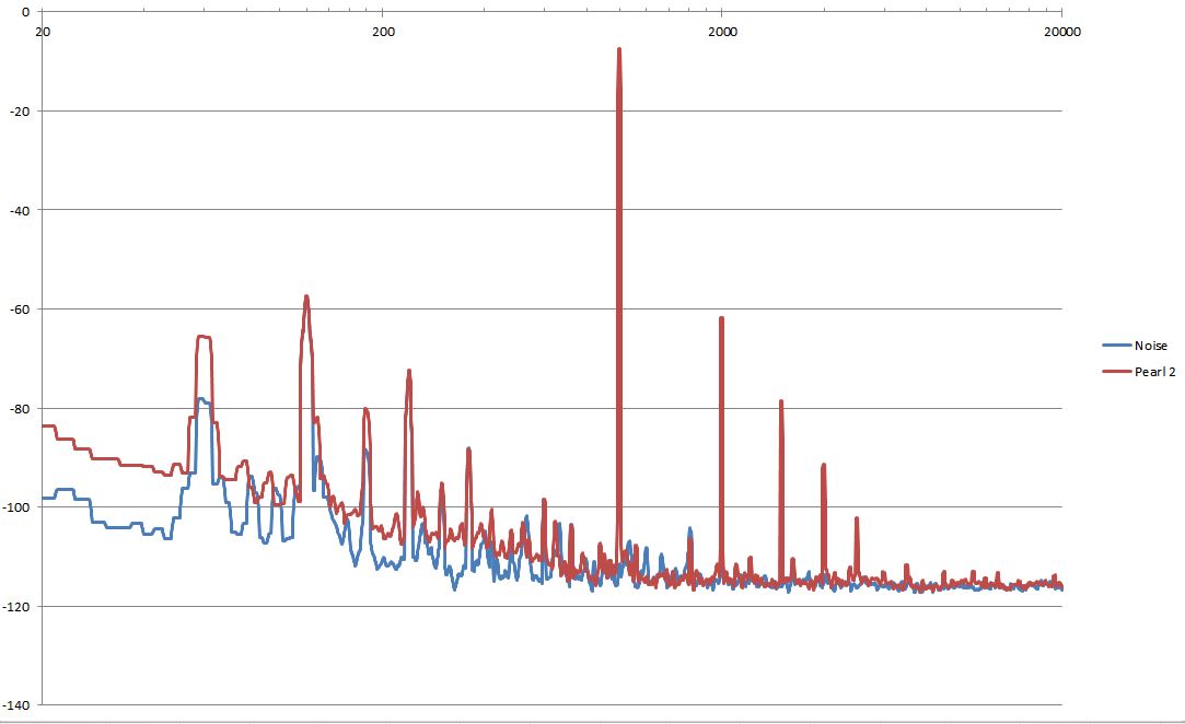

And my own version of the PassLabs Pearl 2. This one has the highest THD at 0.2%. The Pearl 2 may be more comfortable with a MM cartridge, hence the 10R at the input may be too low for its taste.. We can see it in the harmonics. In a few days I'll add some more preamp, the Vacuum State SVP2 (Tube), the K&K Maxeed Out (Tube and Step-up transformer), the PassLabs Xono & Pearl and the Graham Slee (MM only). Will see...

Its not the 10R , that is better as a noise source Johnson in any case, its the level. Run it at 0.5mV bcs it has a non NFB head amp.

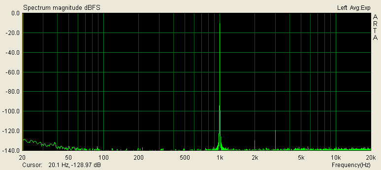

With USB external card like EMU, M-Audio etc. plus Arta software or alike and a cheap second hand notebook on battery its not unusual to get reliable enough results. Takes a little caution only. Here is a baseline with my old EMU tracker that sadly has good drivers only on Windows XP.
